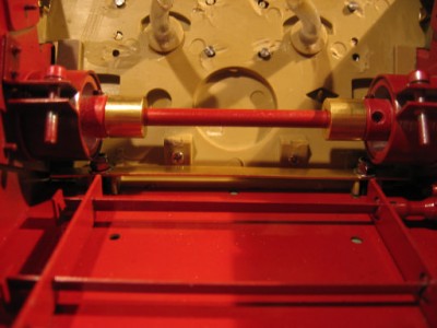

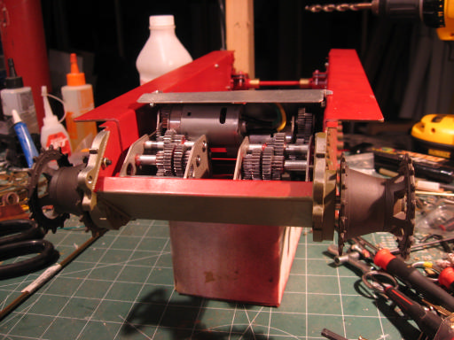

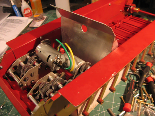

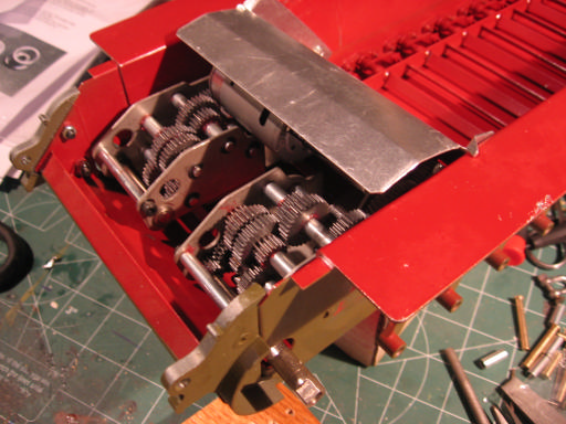

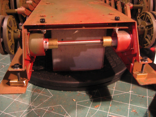

Got the motors placed best for now. They are slightly 2-3mm out of axial from one another but output shaft is perpendicular to hull so I'm happy. It is a combination of slight mounting spacer length descrepancy(Tammy variety), slight bend/flex in Tammy hull, and very slight misalignment of Impact mounting holes made alignment a PITA. I have to say that Asiatam gearboxes fit much better, but that's the hobby nature!

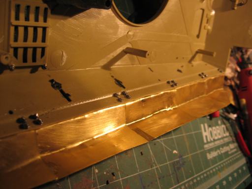

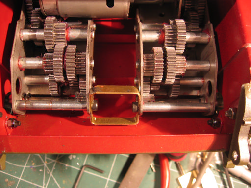

Anyway, to get the flex out (mostly) I soldered up a box brace and replaced two Impact philips head screws for allen heads. MUCH less flex and real easy to make.

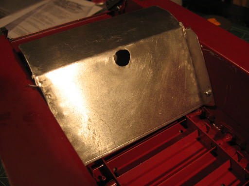

Also , I made splash guard out of aluminum. mounts to two of the tiny hull screws and can 'open up' as seen in the pics for easy motor access. Also, it has two little side tabs so that you can;t put it in too far and hit the motor gears! Nice!

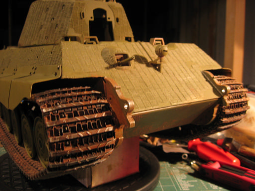

You can see some of the dark brown and olive on the drive wheels. much detailing to go but this forms a nice base.
olive and dark brown...flash kills it...looks better live.
'box' brace
'box' brace
pretty good alignment
another view..hole for wires.
'open'
'open'
closed
closed

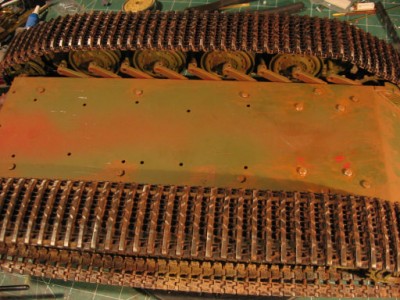

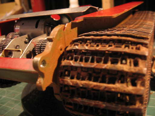

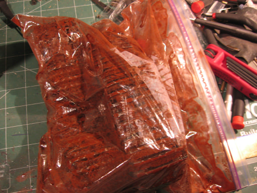

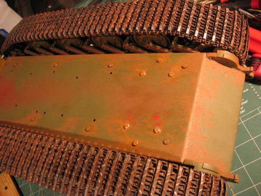

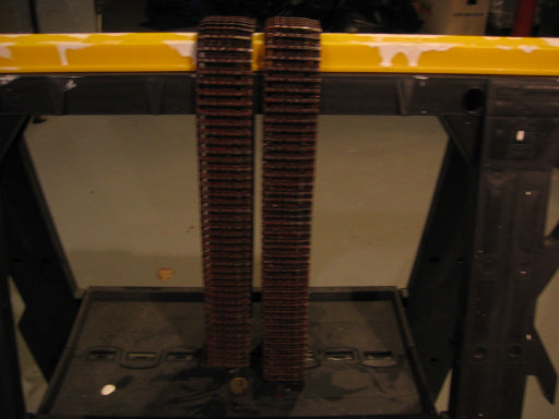

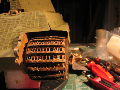

Tracks getting 'bagged' with alcohol, fine dirt and testors rust and some flat black

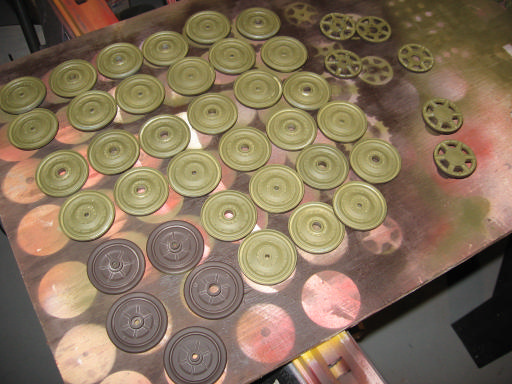

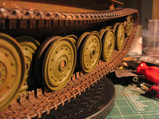

spray painting the wheels worked out well. you can remove the bearings so you don;t get paint inside the bearing bore. Emory paper the brass shaft so it fits easily.
Some of the wheels are cast kinda crooked and wobble. the best and smoothest wheels are palced at each end and the most wobbly ones in the middle. Less likely to toss a track.... I use one tiny drop of CA on the wheel halves (keep out of bearing!) and drive the two halves together between two pieces of wood using a small hammer. Then gently tap until gap is even.
Some of the wheels needed a little axel bore cleaning out with a smaller drill bit. Just kinda ream to fit the axel so it turns smoothly with no binding. be sure to remove the bearing before doing this!

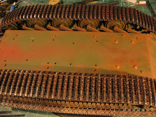

Backside of wheels are detailed up with some real dirt and dirt colored paint, and so is the hull before wheels and tracks go on.
To paint the metal tube axel spacers (stock Tammy) just string them all together on a piece of wire (like beads) and spray them all at once. works great!
I used some grease inside the idler wheels. nice and smooth.....

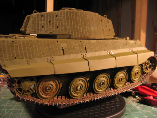

side view... got a spinning work pad from a german tanker net store. VERY nice..for ~10$.

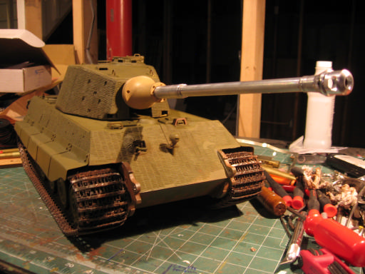

front angle
front angle
rust/dirt effect  (see 'bagging' above)
view down the track guards

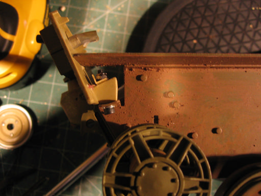

using beveled Traxxas allen head 'countersunk' for drive guards

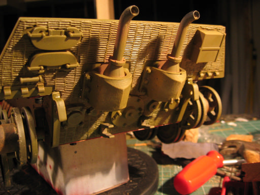

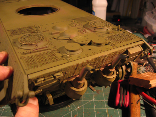

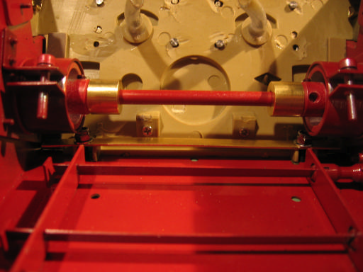

rear bulkhead almost complete. just some detail work like convoy light, etc...

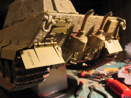

trimmed off excess track guard bolt length with cutting pliers then dremmel sharp tip. superglued nuts. Not completely tight so some panels move a little...more realistic. you have to grind down the mato hull posts about 3mm each so the hull fits flush.
test fit. lookin good.
nickle cast exhaust outlet guards. VERY nice quality.
upper mount. here is a good view of what I mean by 'keep the angle' of the mount.
inside mount view. Make sure screws are not too long..
rear bulkhead mounting screws..3mm with brass plate for extra support. A little grinding down of the matorro mounts (keep the angle so it does not fall off!!) works well. Had to redrill two upper mounts slightly inward. Usae 3mm locknuts. Even if the screws are loose, the bulkhead won;t fall off. allows for better fit with deck.

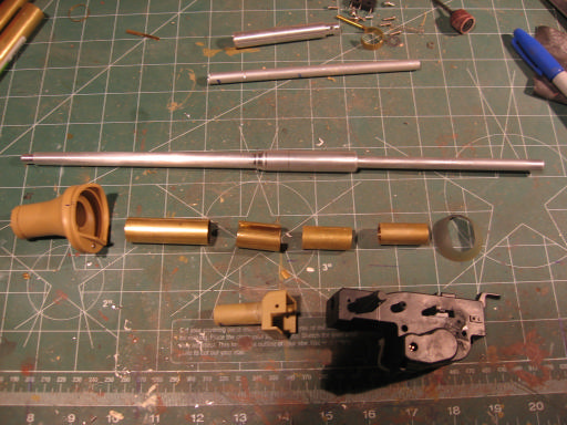

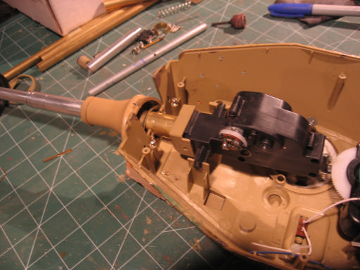

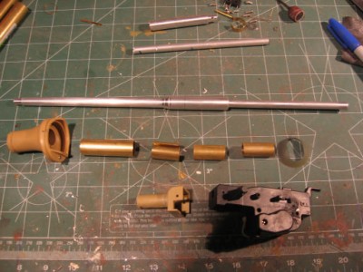

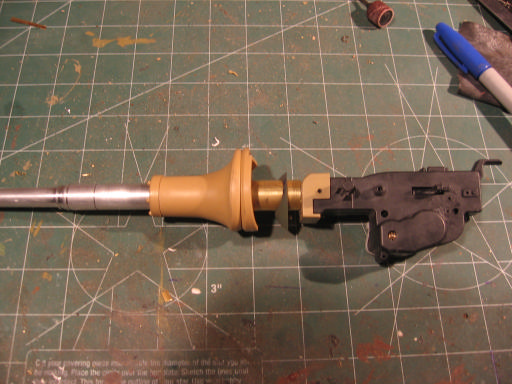

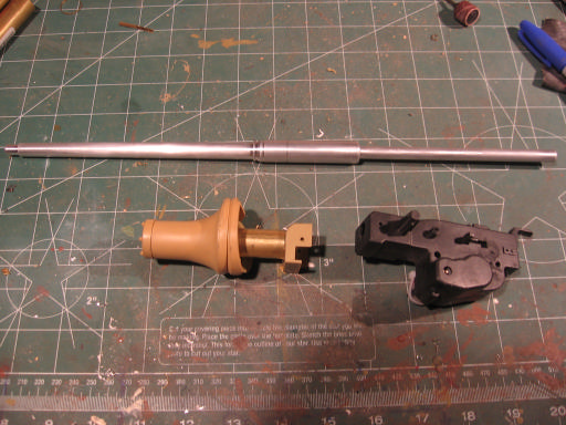

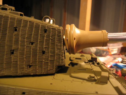

Main gun build.
parts needed:
brass tubing 21/32 and smaller
tammy mantlet sprue
matorro part that fits between mantlet and recoil unit (I call it the 'adaptor')
Tammy aluminum barrel
matorro inner aluminum tube.
one new HL style recoil unit to replace the matorro BB unit (fits right into place with spring and elevation unit and mounting tabs!!)
You need some brass tubing from hobby store. I needed at least four sizes which fit into each other snugly. You need the Tammy mantlet sprue which has three mantlet parts...the main mantlet, the barrel guide (front piece with bolts) and the rear ring (Found at Jason's store ebay)
Assemble the tammy mantlet. No changes needed. Then after carefully removing the 'adaptor' from the matorro barrel and recoil unit, a short bit needs to be trimmed off end and it has to be fitted to smaller of the 4 brass tube. tube slides nearly all the way on except for last 5mm or so...this creates snug fit. you don;t want this loose.
trim the tammy barrel removing the skinny proximal end (all the way up to the thickest part of the barrel) carefully drill down the center of the tammy barrel to accept the matorro aluminum bb tube. Trim the bb tube to appropriate length and it all fits nicely together.
remember: measure three times, cut once.
since the main gun is all hollow, I can add the HL flash unit!
aluminum recoil and main gun...it is big.
make sure to cut tubes to right length so mantlet fits close to turret
fits like a glove!
fits like a glove!
main pieces together
brass tubing together
trimmed tammy barrel and brass tubing
