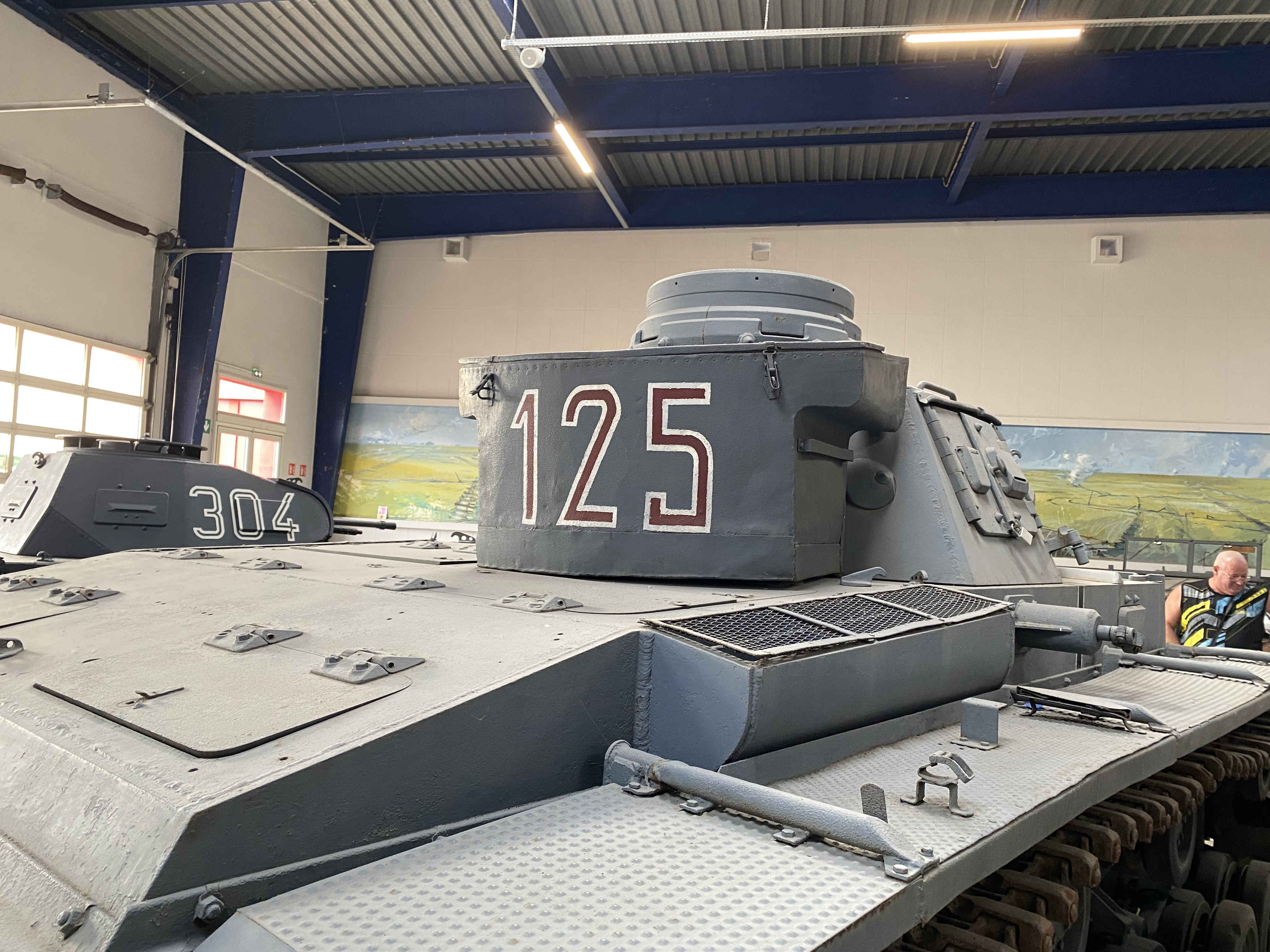

Saumur’s PZ III turret box, looks to have been repaired along the bottom edge, and apparently just resting on the upper hull roof…

Interesting.
Here's a walkaround for the same tank at Saumur.
The shape does seem a bit different but the bin is also not attached to the rear of the turret.
Here is a picture with the bin attached.
Looks to be a different style of bin.

To make it even more interesting-

kernewek wrote: Sat Jan 03, 2026 9:09 pm IMG_2232.jpeg
That looks like a Panzer IV bin.
