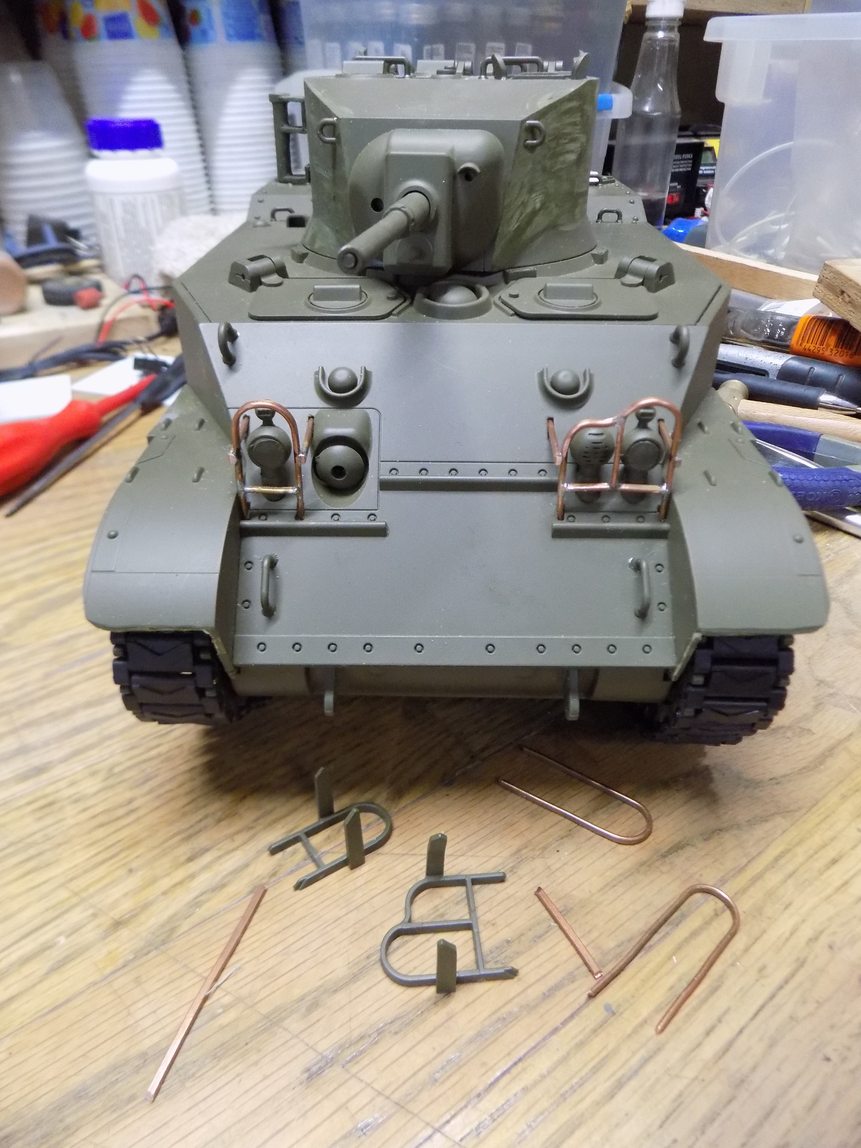

Not too much to show, light guards

- Stormbringer
- Staff Sergeant
- Posts: 888
Re: Trimmed M5A1 Stuart
Love the metal light guards
Alan
Nice work with the guards and springs. I'm forever thankful that Heng Long and TongDe leave so much room for improvement LOL.

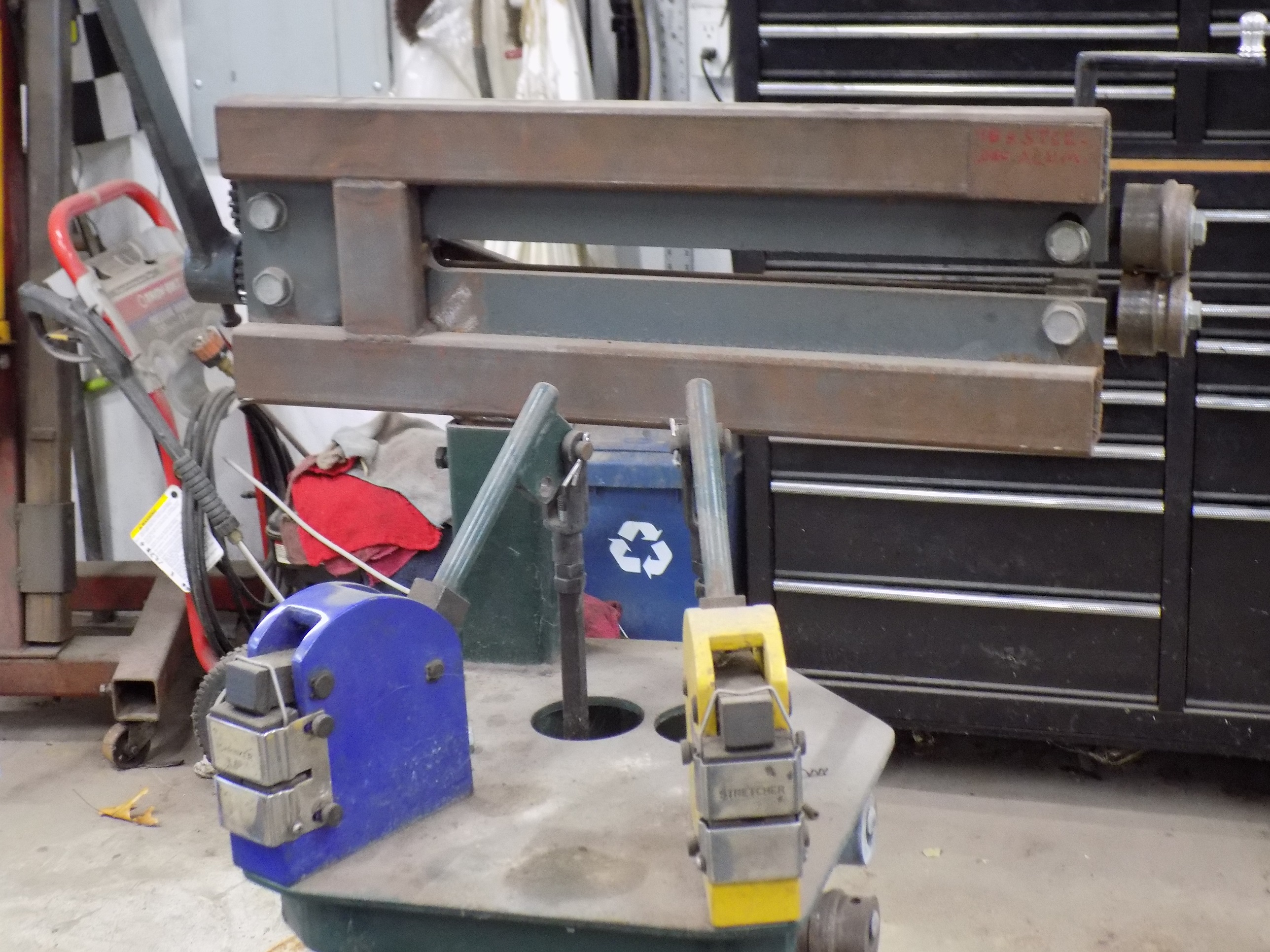

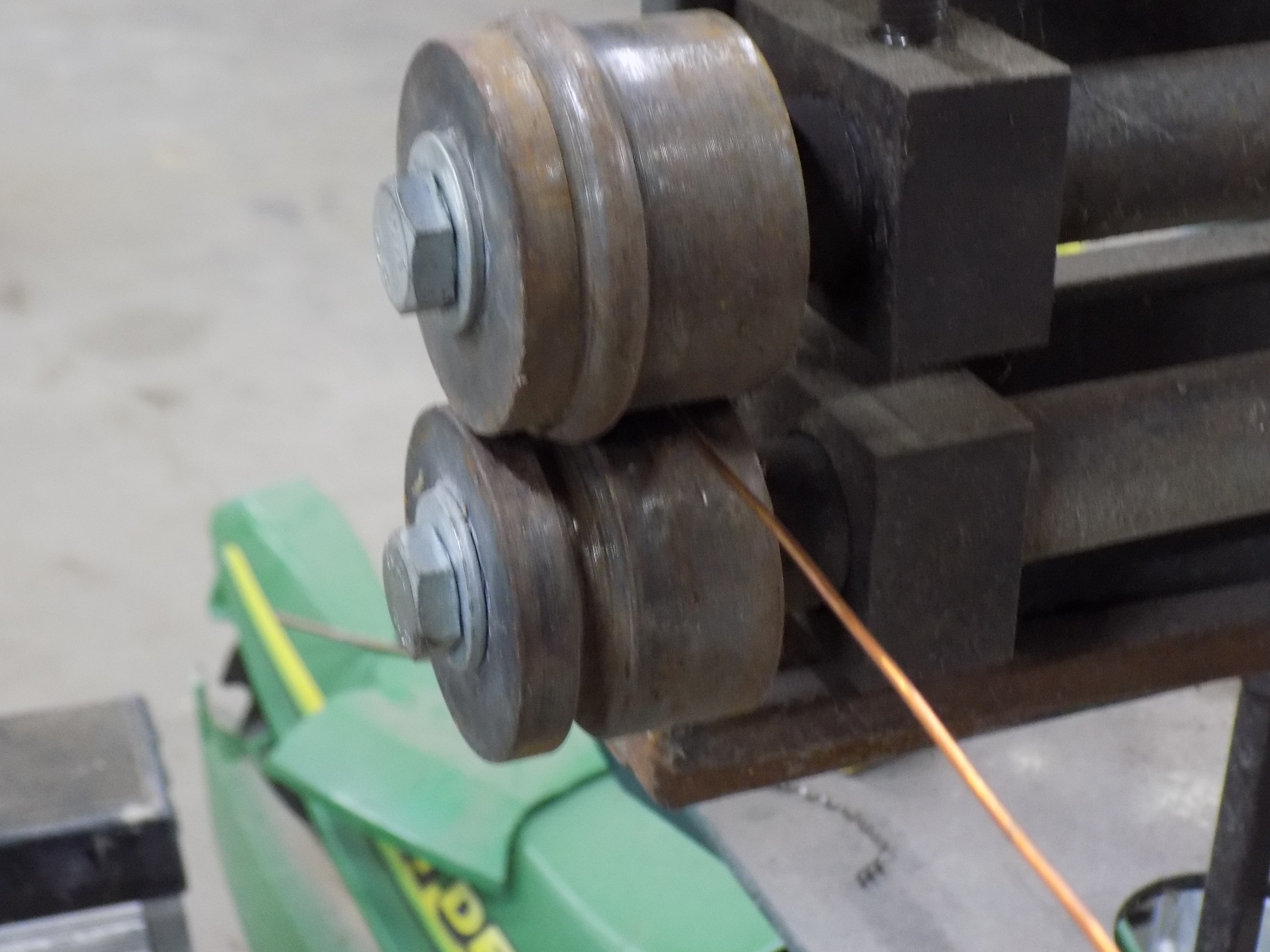

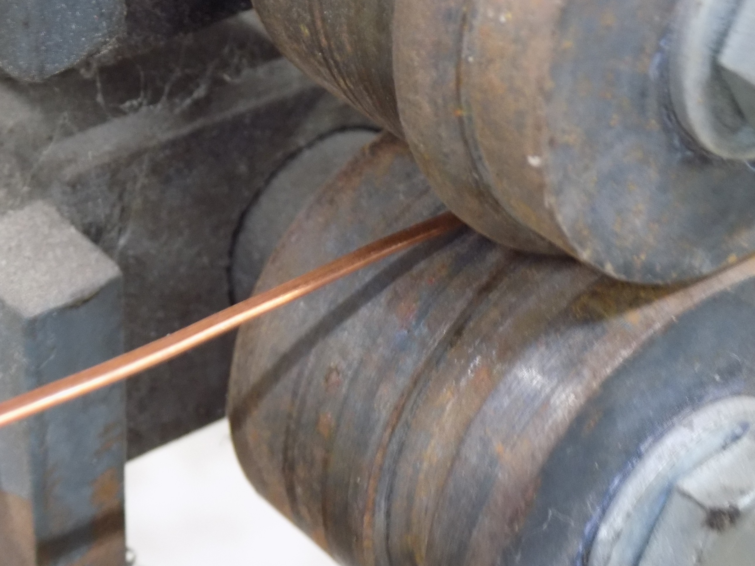

Sooooo, it's about the square sided bits of copper guarding-- are you sourcing that somewhere, or are you fabbing it up yourself with a press of some kind?
Looks righteous and financially prudent!
Mike.
Mike.
Elbows up
14/2 or 12/2 Romex household electrical solid wire with cover and wire insulation removed (giving three wires) and run through a bead roller. This build I used the smaller 14 ga. most of the other builds get the 12 ga. 12 guage was just too thick for the diminutive Stuart. Three pictures from page 13 of my M32 build:
