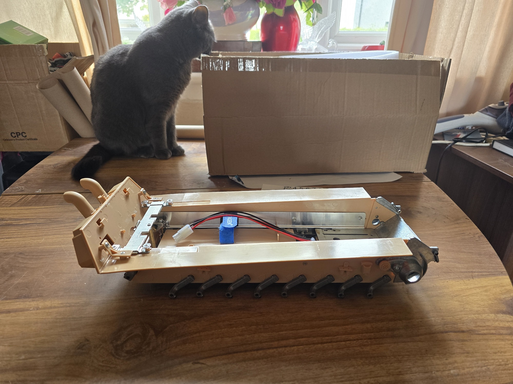

Re: My Jagdpanther
Posted: Sat Sep 27, 2025 7:23 pm
by Stormbringer

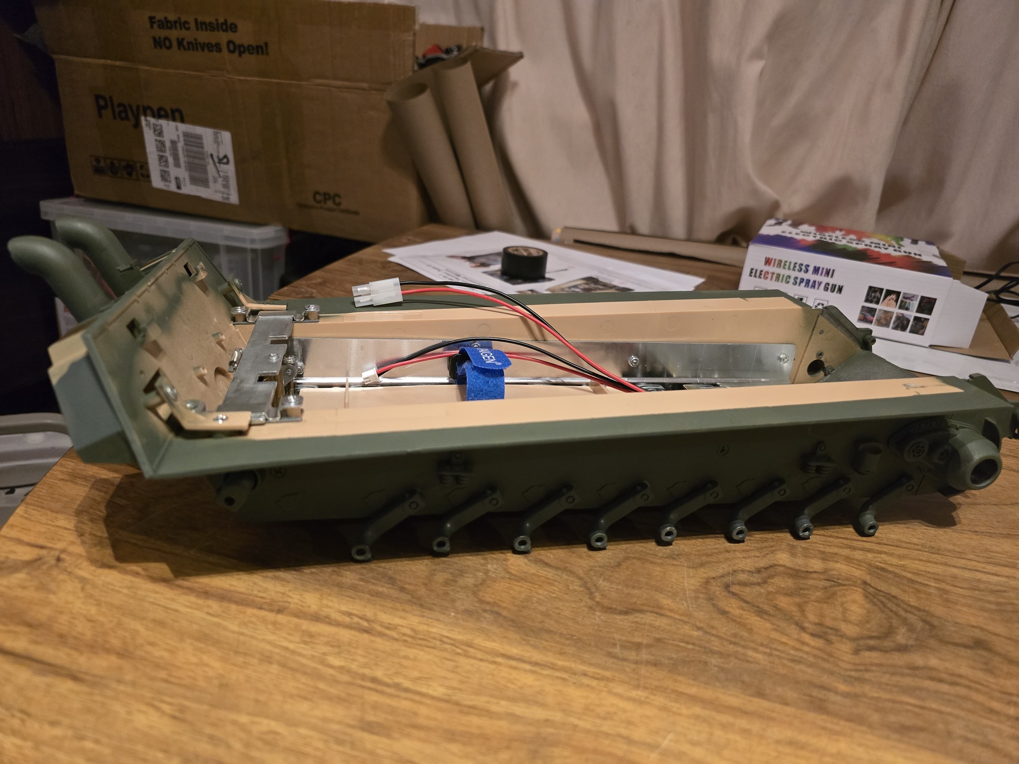

This arrived yesterday from Forgebear Tanks really quick dispatch
Elsa thinking Ohhh a new box thx Daddy lol
Thx Dave for answering my many questions about it :thumbup:
This is it painted up and ready to swap over the electronics etc
Just need to weather it up and matt coat it

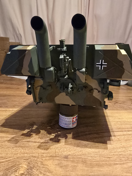

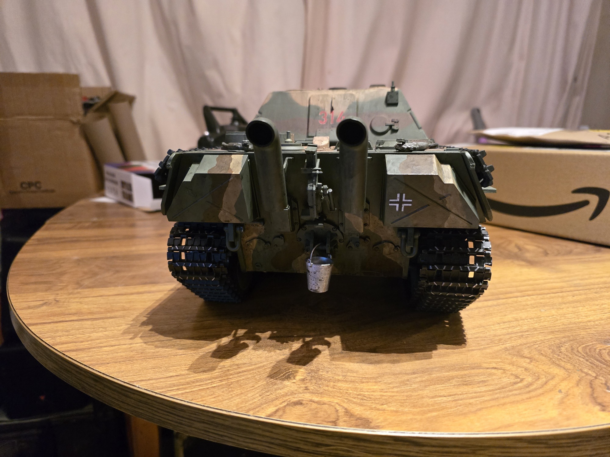

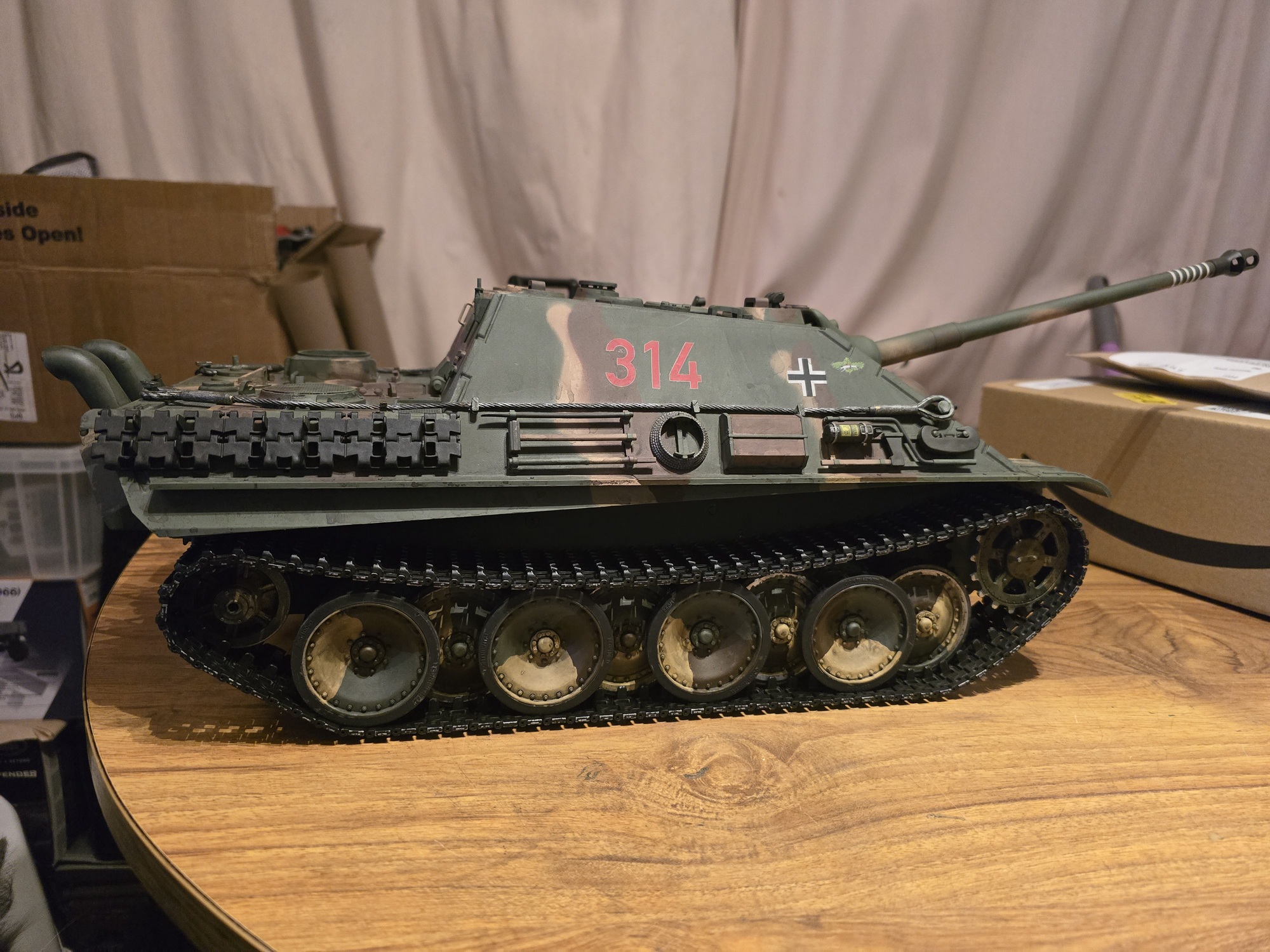

Re: My Jagdpanther
Posted: Sun Sep 28, 2025 9:07 pm
by Stormbringer
Ok weathered the hull and transfered all the electrics over
All up and running now and i dont have to remove an idler to adjust the track tension as theres 2 external screws on bottom rear of hull that does it

Re: My Jagdpanther
Posted: Mon Sep 29, 2025 12:12 pm
by Stormbringer
the wheels , sprockets ,idlers and tracks were already painted from being on the old plastic hull so didnt need painting
reason for changing the hull was the rear idlers were sitting with a fair bit of toe in owing to the adjuster or hull being warped
the idlers were trying to climb over the track guides then they would slip back making quite a clunking noise when driving it
i tried spacing with washers but it was throwing the tracks out to the side and it didnt look right
also couldnt find metal replacement tensioners apart from 1 from Germany but that was 47 euros
The Taigan hull had this adjuster and was less than £20 more so a few questions about it to Dave at Forgebear and new hull was duly purchased
really glad i did now :thumbup:

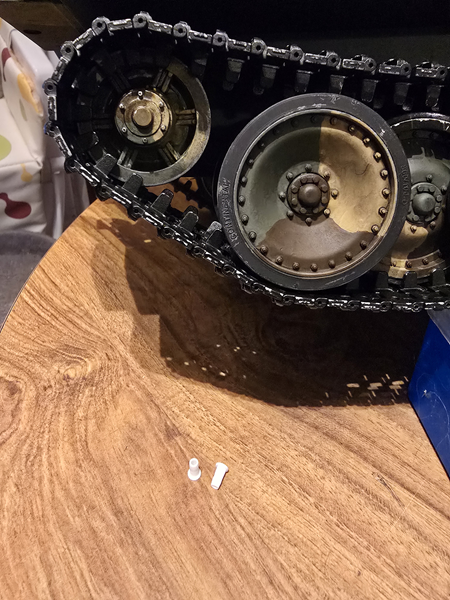

Re: My Jagdpanther
Posted: Thu Oct 02, 2025 11:42 pm
by Stormbringer
Got fed up with the screw hole in the rear idlers
Had a look in my bits bobs box and found some fibre optic connector covers so used them
After painting them up and weathering them it looks a lot better
