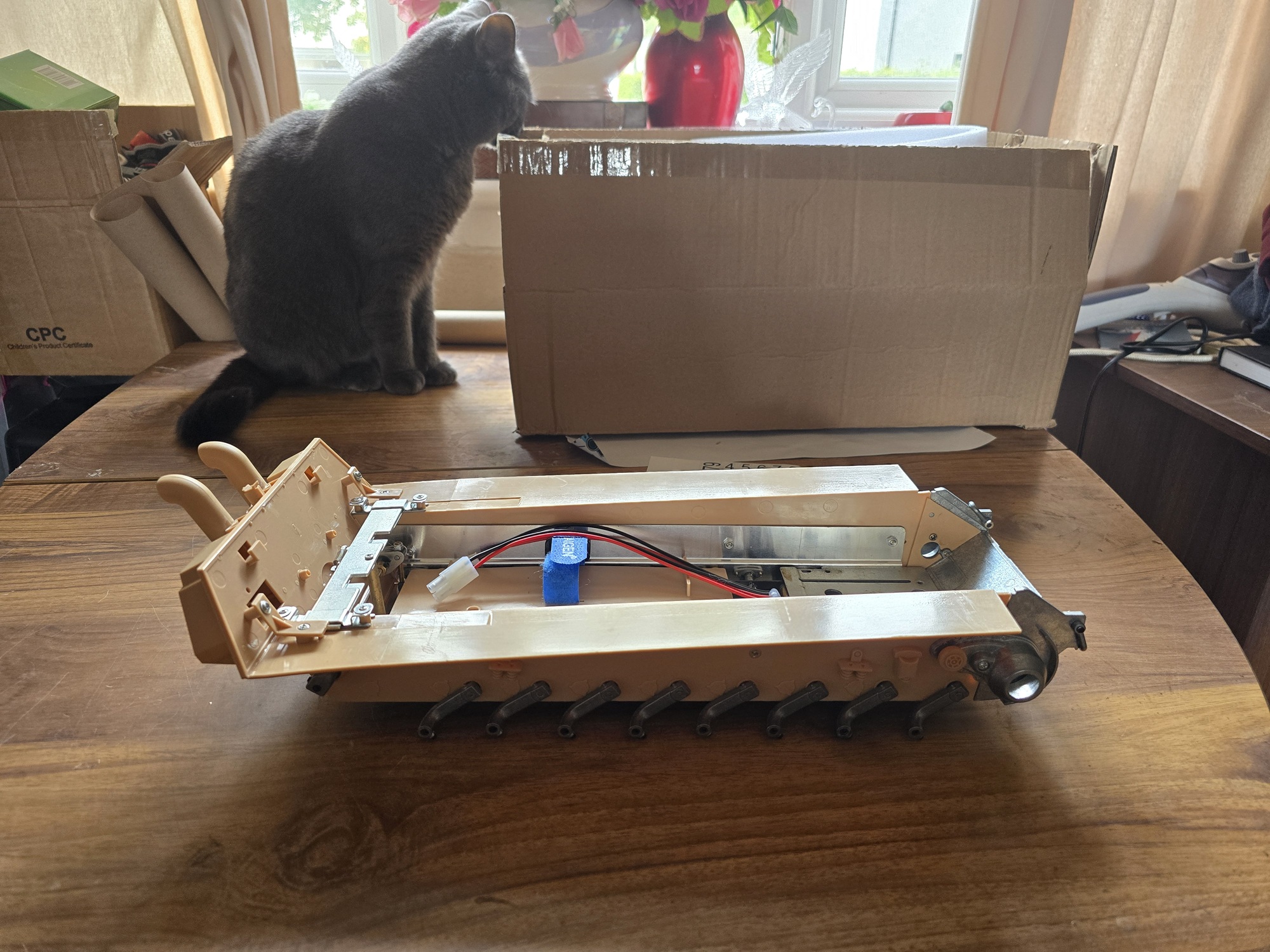

This arrived yesterday from Forgebear Tanks really quick dispatch
Elsa thinking Ohhh a new box thx Daddy lol
Thx Dave for answering my many questions about it

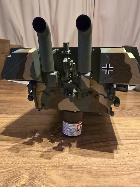

This is it painted up and ready to swap over the electronics etc
Just need to weather it up and matt coat it

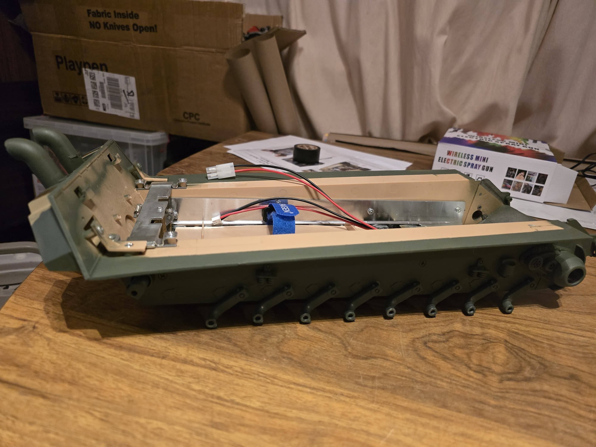

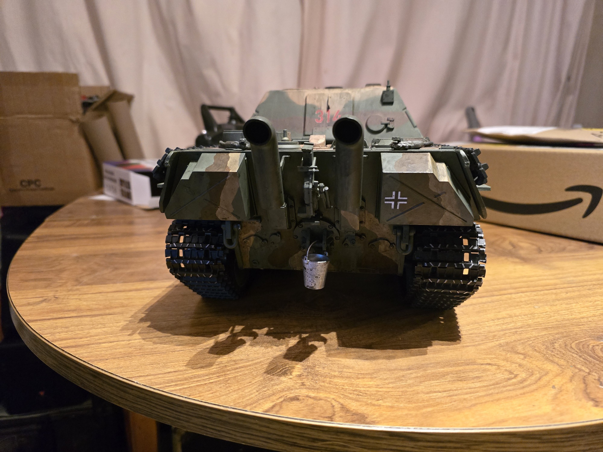

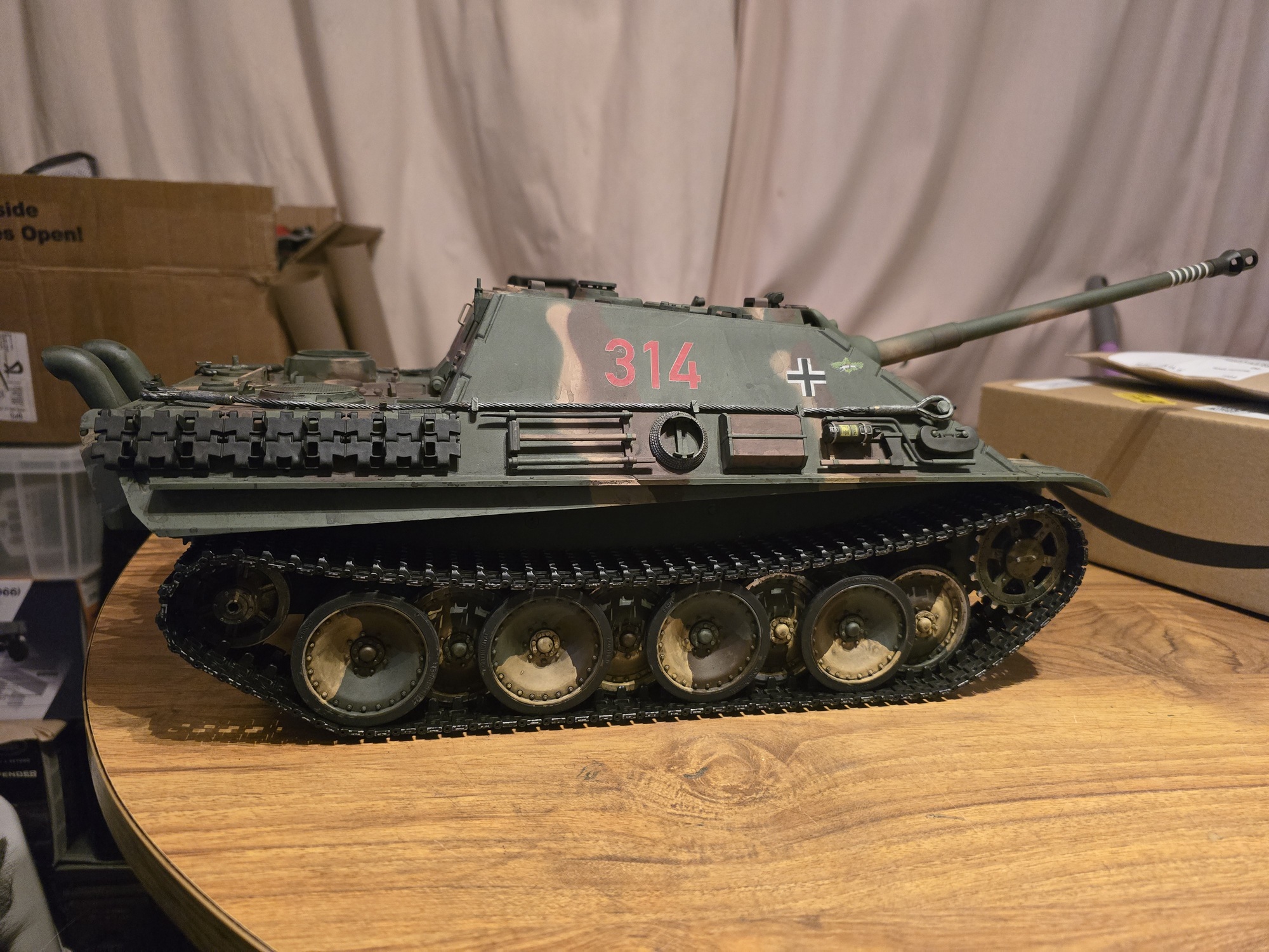

Ok weathered the hull and transfered all the electrics over
All up and running now and i dont have to remove an idler to adjust the track tension as theres 2 external screws on bottom rear of hull that does it
I had hoped to use the old rear panel from plastic hull but the panel was well and truly glued in on both hulls

Hell yes! My Tiger is built from parts from several manufactures (chassis, hull, turret, main gun, electronics, tracks etc) but that’s what you gotta do for certain tanks to appear prototypical. Your tank looks beautifully done.

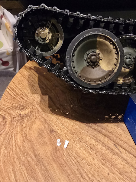

Got fed up with the screw hole in the rear idlers
Had a look in my bits bobs box and found some fibre optic connector covers so used them
After painting them up and weathering them it looks a lot better
