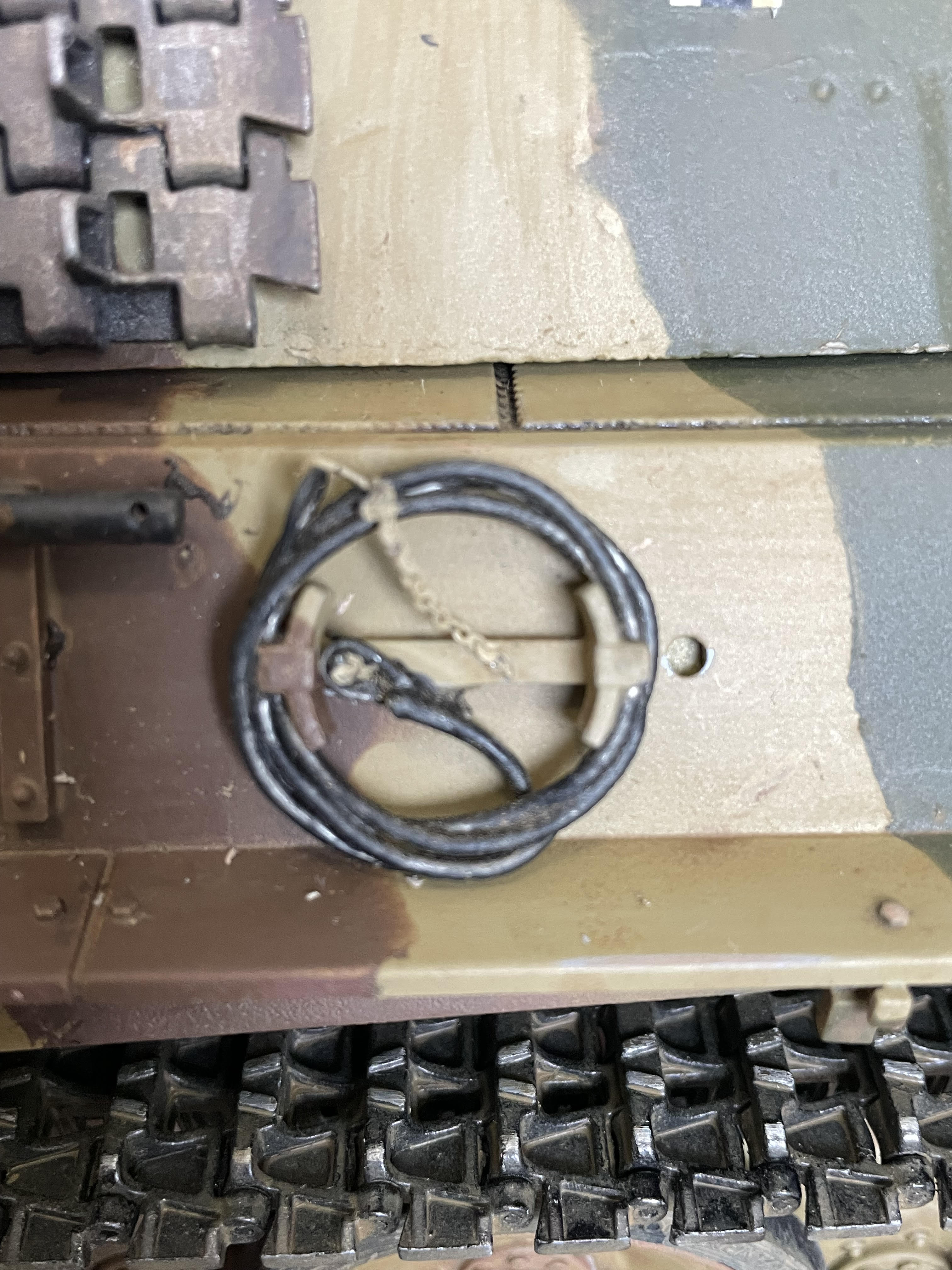

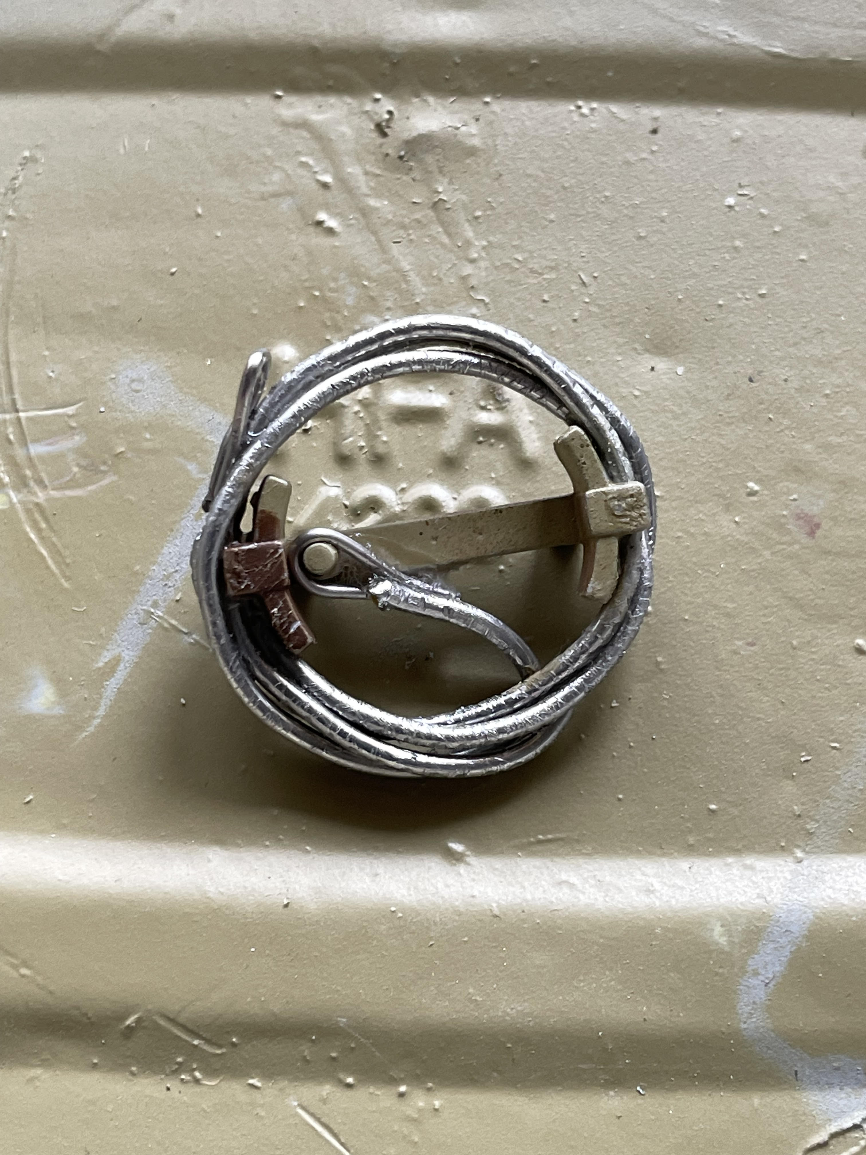

One thing that is always a complete pain in the ass with Panther builds is the track cable. While if you look at the ones in the field it isn't inaccurate to not even have it wrapped on it's holder or just a complete mess I like to have it sort of wrapped properly. The Heng Long thing is so perfect it's ridiculous and Tamiya's solution is to give you a piece of string :/. So I have used scale cable from the likes of Aber and Schumo but getting it to even remotely to stay rounded is almost impossible. So on this build I decided just to use some solder wire. It is much easier to wind it around the holder and and easy to shape. You can score it as much as you like to get rid of the smooth appearance and in my case I just used paper clip wire bent to make the loops. Out on the field it is really hard to make out the join anyway but it would be easy enough to solder the loops to the wire. Anyway here is an image of it unpainted.
and a picture of it painted and temporarily fixed to the tank

How I did it was to set each band up with camo putty. Spray a very light mist of TS-3. Then allow the camo putty to do it's usual glacier style move inwards and then spray the full coat. It was an absolute nightmare and expensive to do. The method had worked very easily with the TS-78 over the primer coat but the yellow bands took like 3 very stressful days. After doing the first band I wanted to just pick one of the other camo patterns that the Tamiya sheet showed but I figured I would try and complete it and if I messed it up I would just do a repaint. I managed to pull it off but I would never attempt doing something like that again with a rattle can. I'm done with tri colour German tanks anyway so any German vehicles I do going forward will be early war grey or Soviet tanks which can easily be done with Vallejo cans. It's easy to do some pre-shading with them and then various ways of weathering produce a good result. Too late now after 25+ paint jobs to invest in an airbrush
