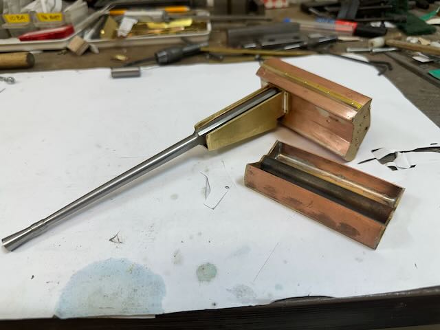

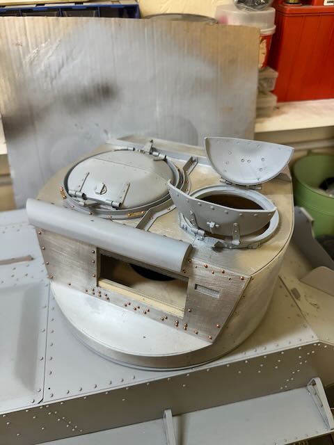

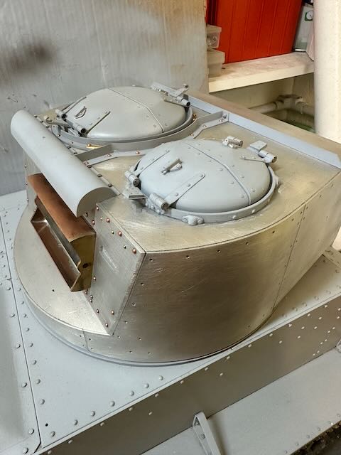

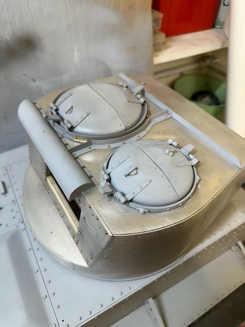

Made some progress on the hatches (blooming hinges seem to take forever to make / fabricate), roof facing, and rain shield.
Just started on the inner and outer mantle fabrication in brass and copper.
Couldn't find any significant dimensioned detail drawings of the mantle and hence have scaled these from photos.
Similarly have made the Besa 15mm gun from scaled drawings and photos with a bit of artistic licence on how it fits within the support locator.
Getting close - so have already started work on drawings and getting info together for next project ...........find this part of a project so absorbing doing research and reading of exploits etc.
