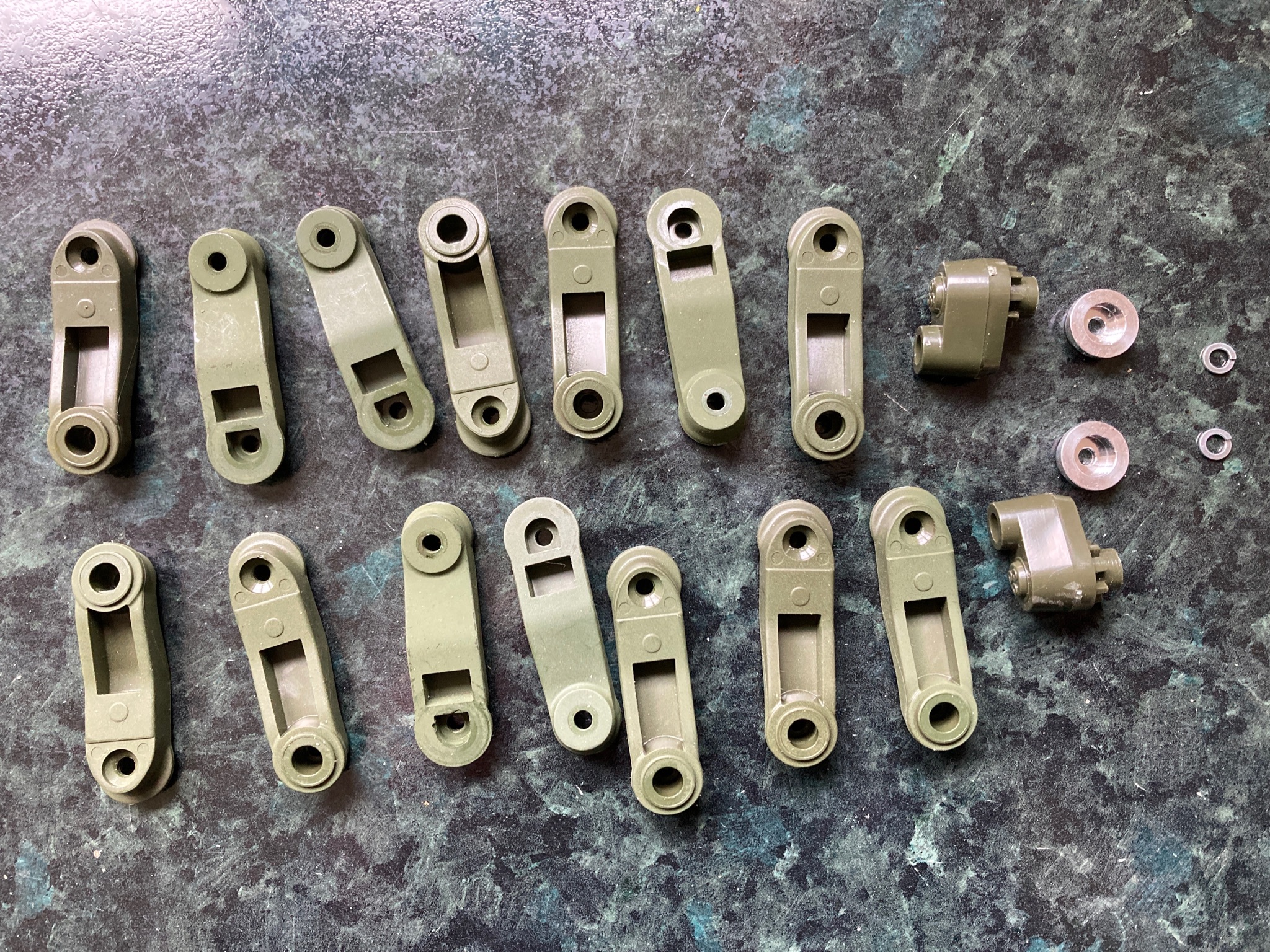

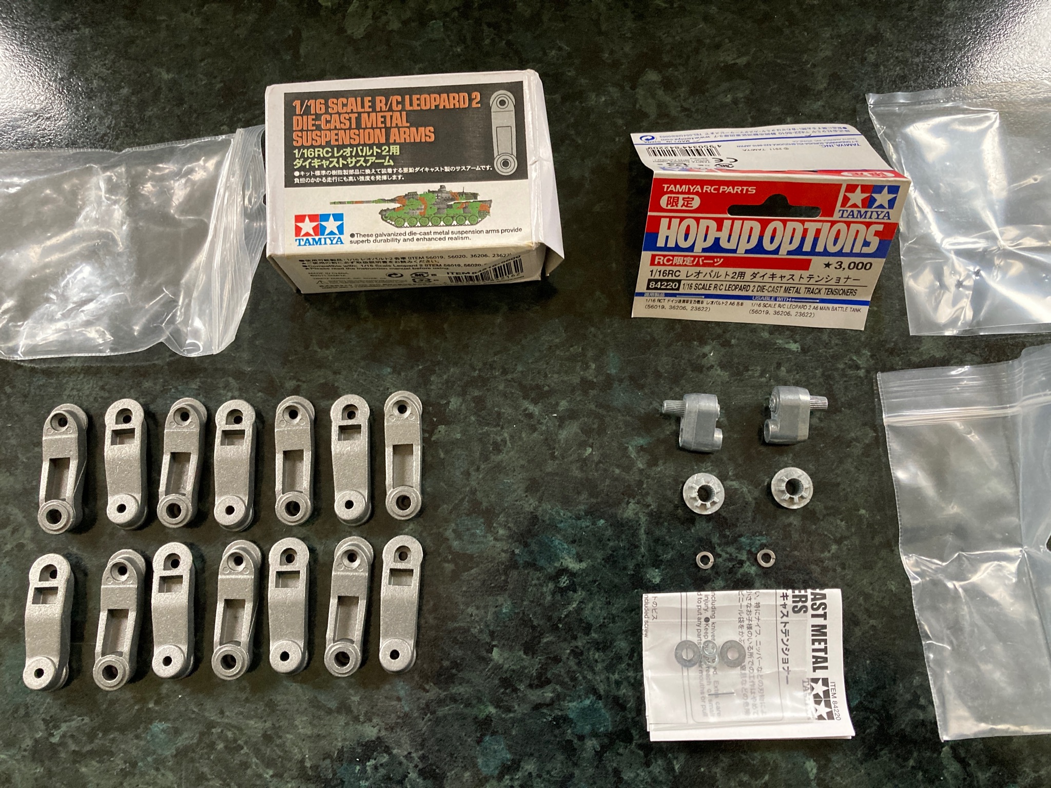

Here are the unused discarded kit parts, and the picture below shows the metal parts from the two Tamiya upgrade kits that replaced them.

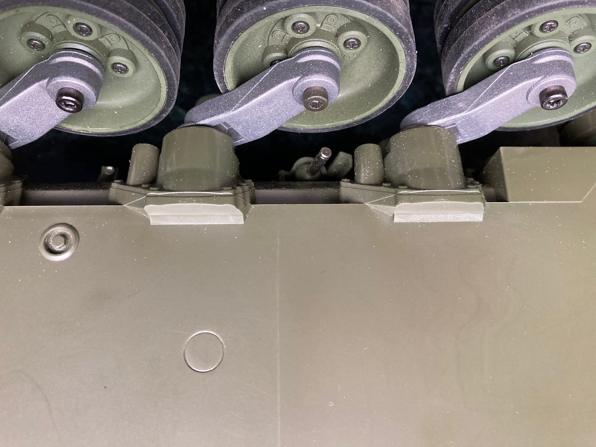

All of the Tamiya metal upgrade parts fitted perfectly on the new build that I am slowly putting together from an unboxed kit.

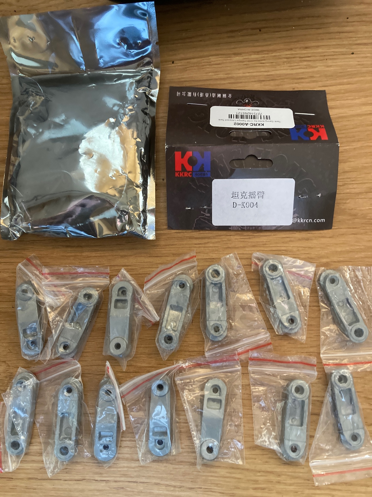

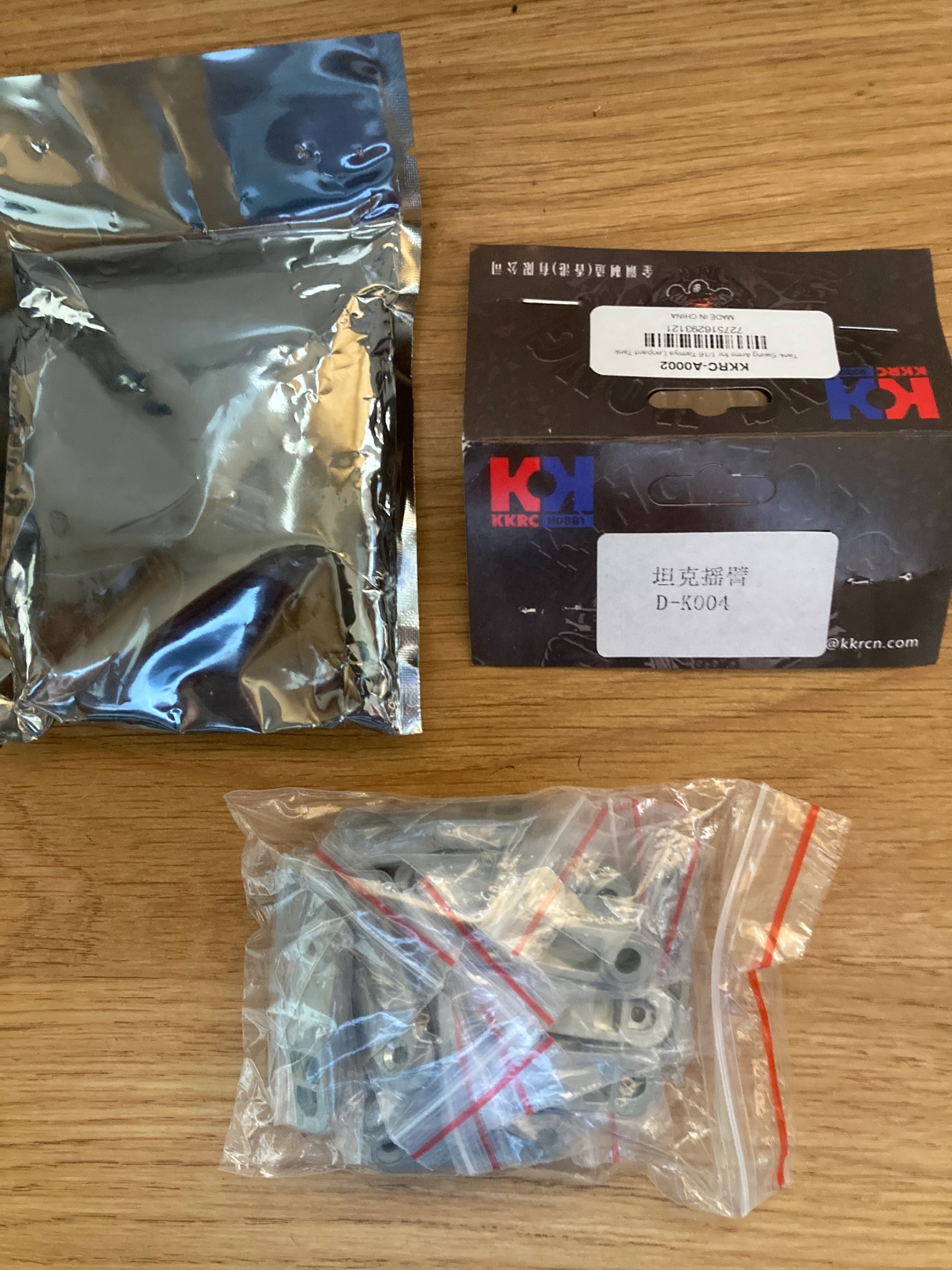

KingKong metal suspension arms have arrived 👍
t
[attachment=2

I hope the KingKong arms work out as the Tamiya arms not available. With your experience with the different brands, this will be a great comparison.
Eric
