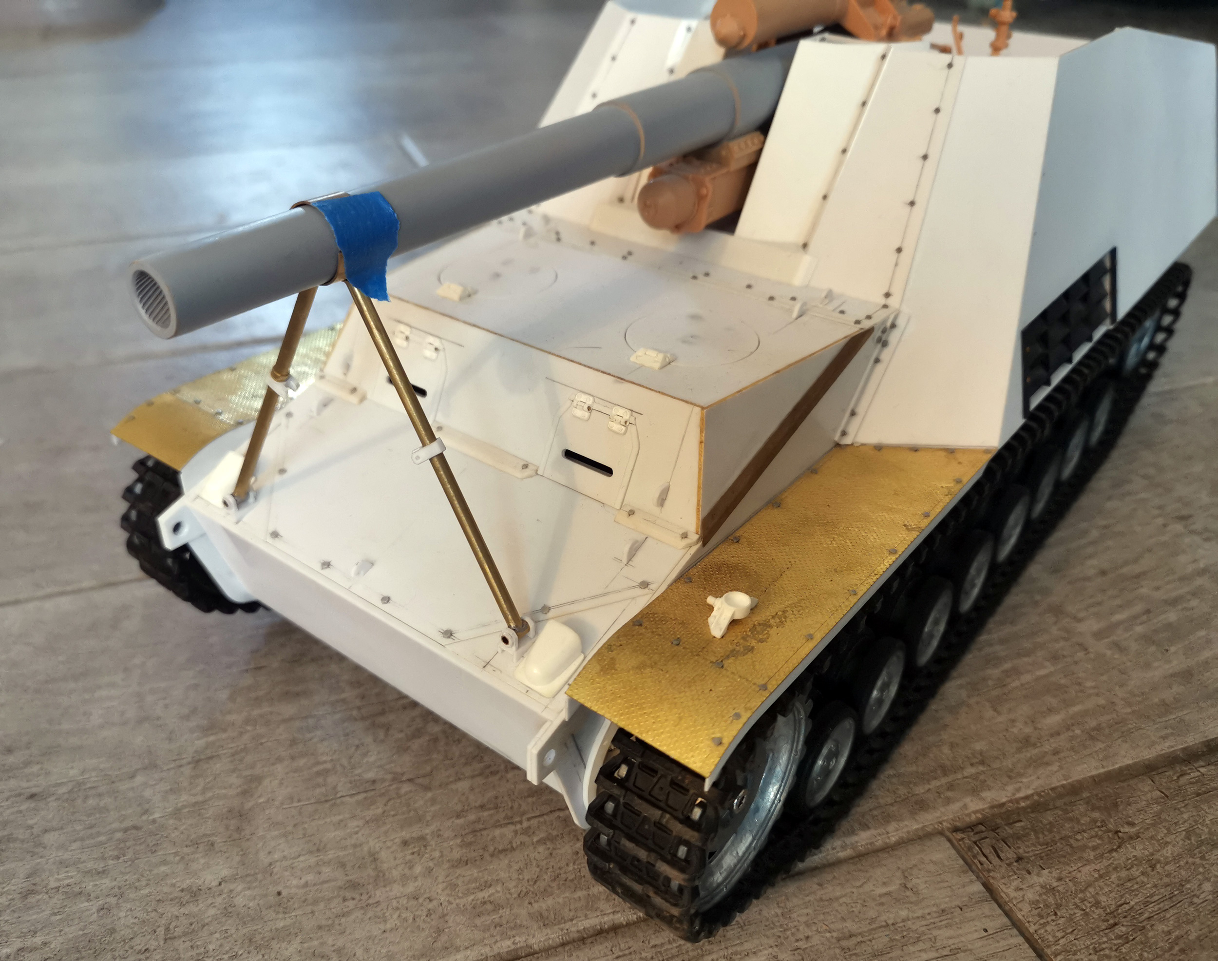

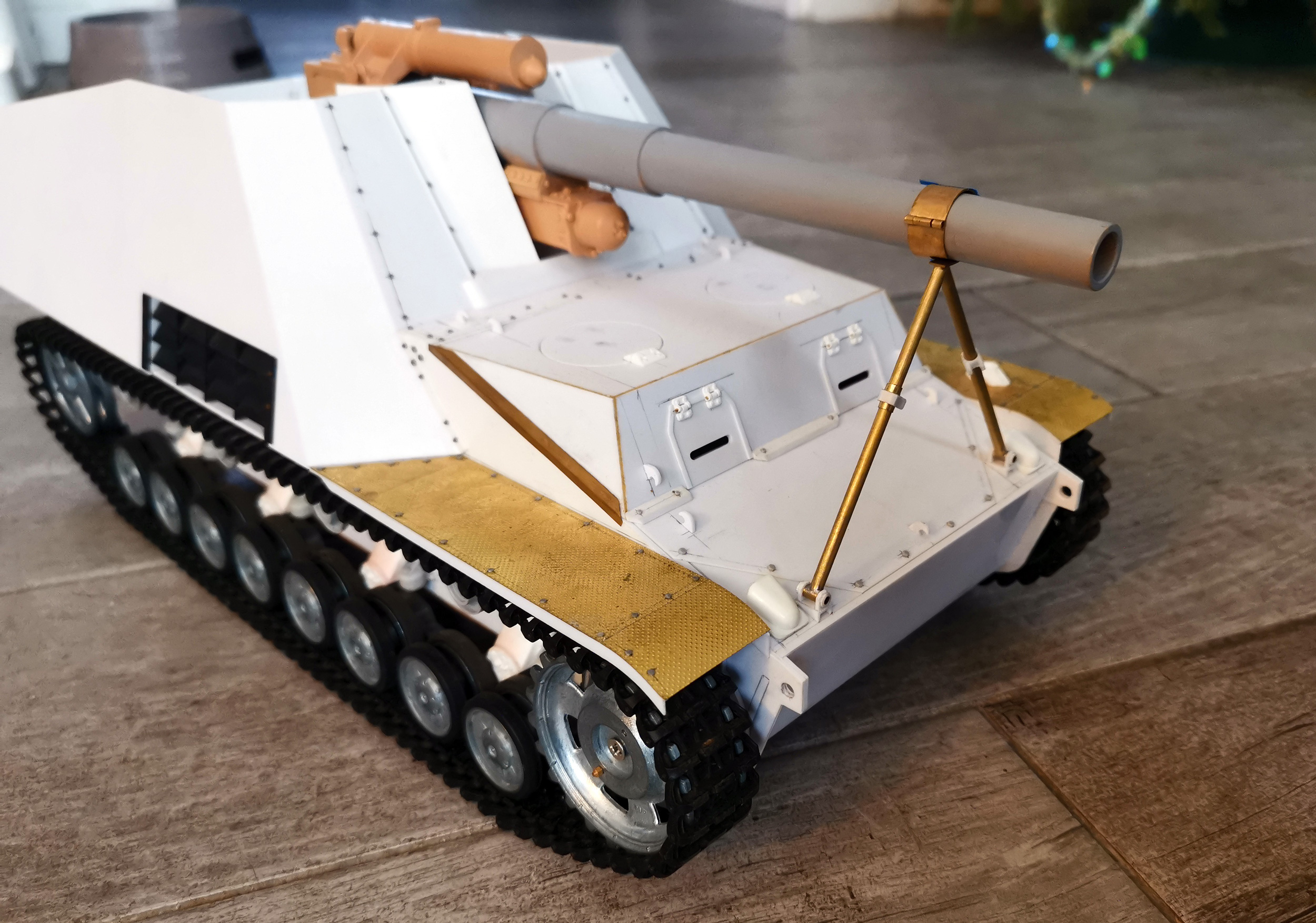

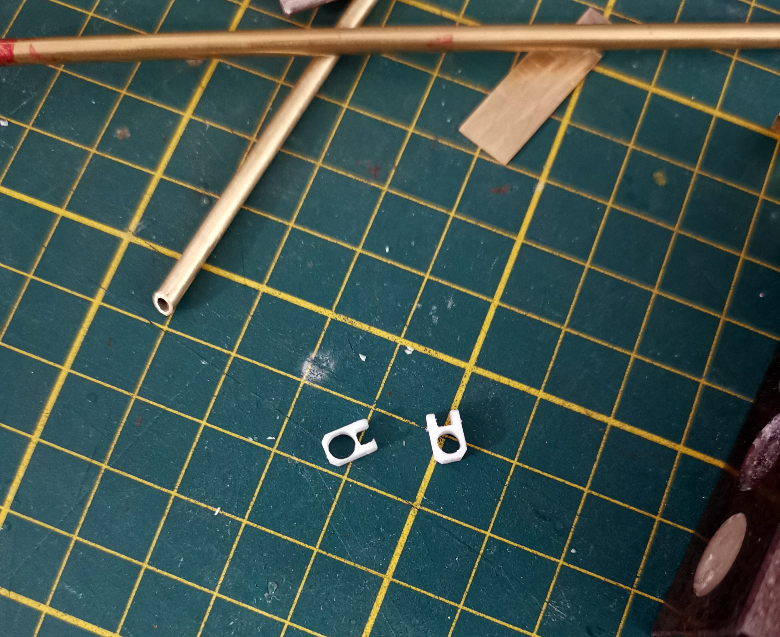

I did the travel barrel support. I wanted it to be movable. I used mainly brass for it, I still have to add some details on it !
While I carefully designed the parts I did a huge mistake regarding the barrel diameter leading to a too large diameter of the folding round bracket. I've been able to shorten the parts except fot the lower one with a hinge, so the hinge is not on the center line of the barrel but slightly higher. Not a big deal, I'm still pleased with it and it was too much work to start over !
The working hinge :
I used tape to hold it, I havent build the locking system yet.

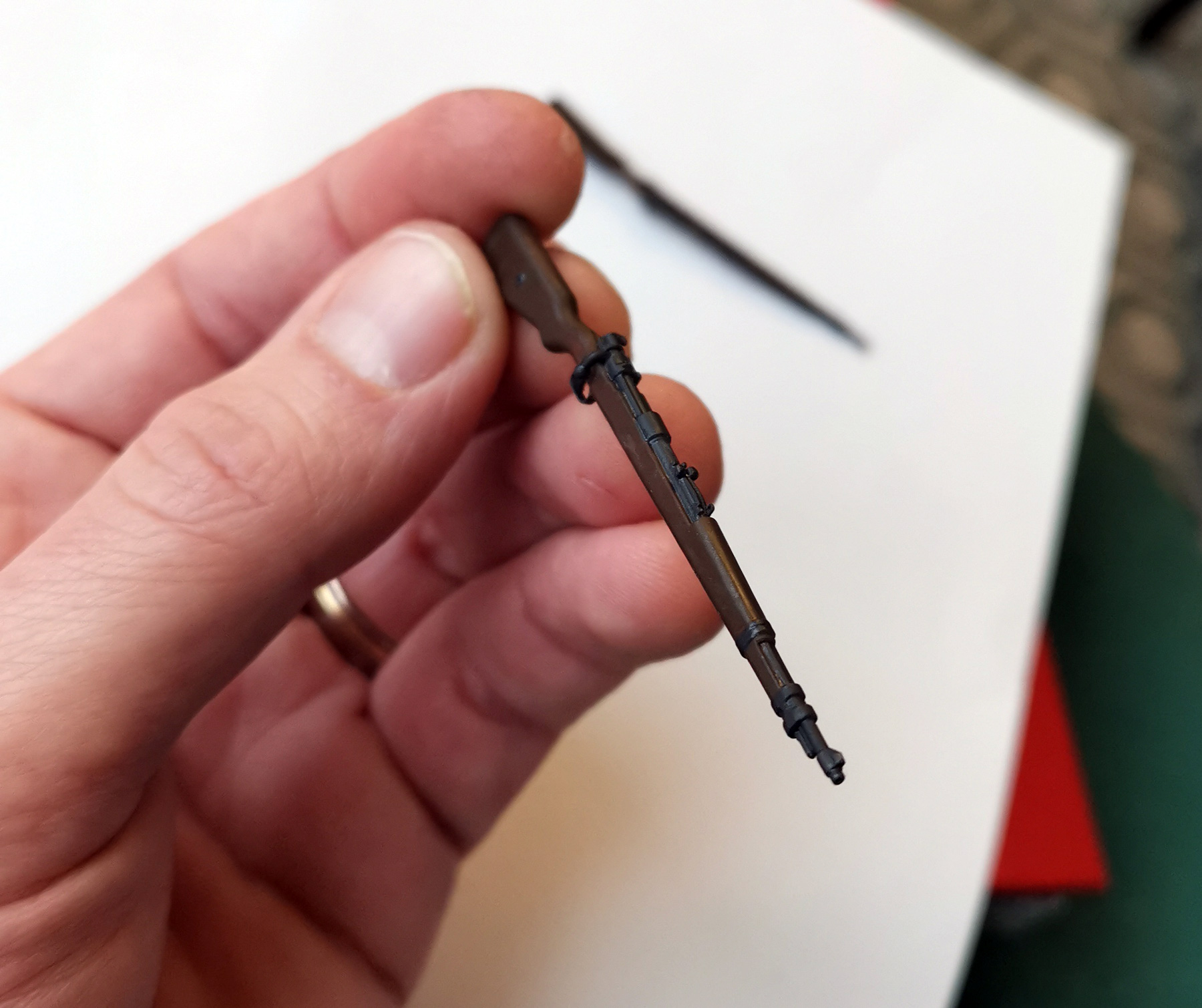

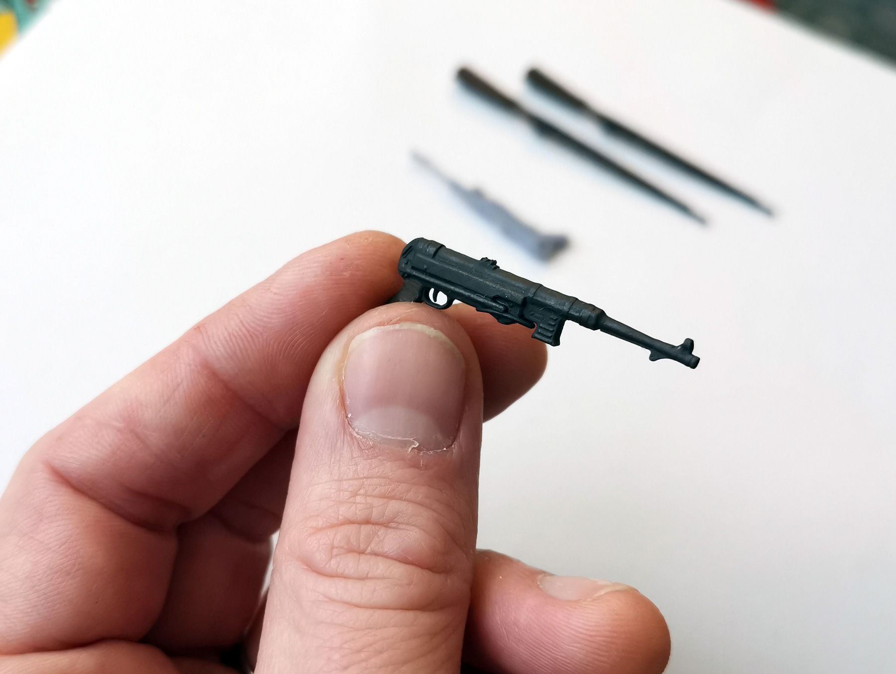

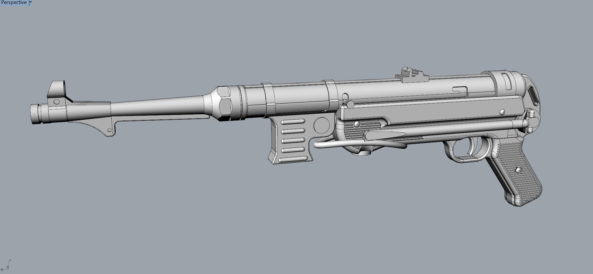

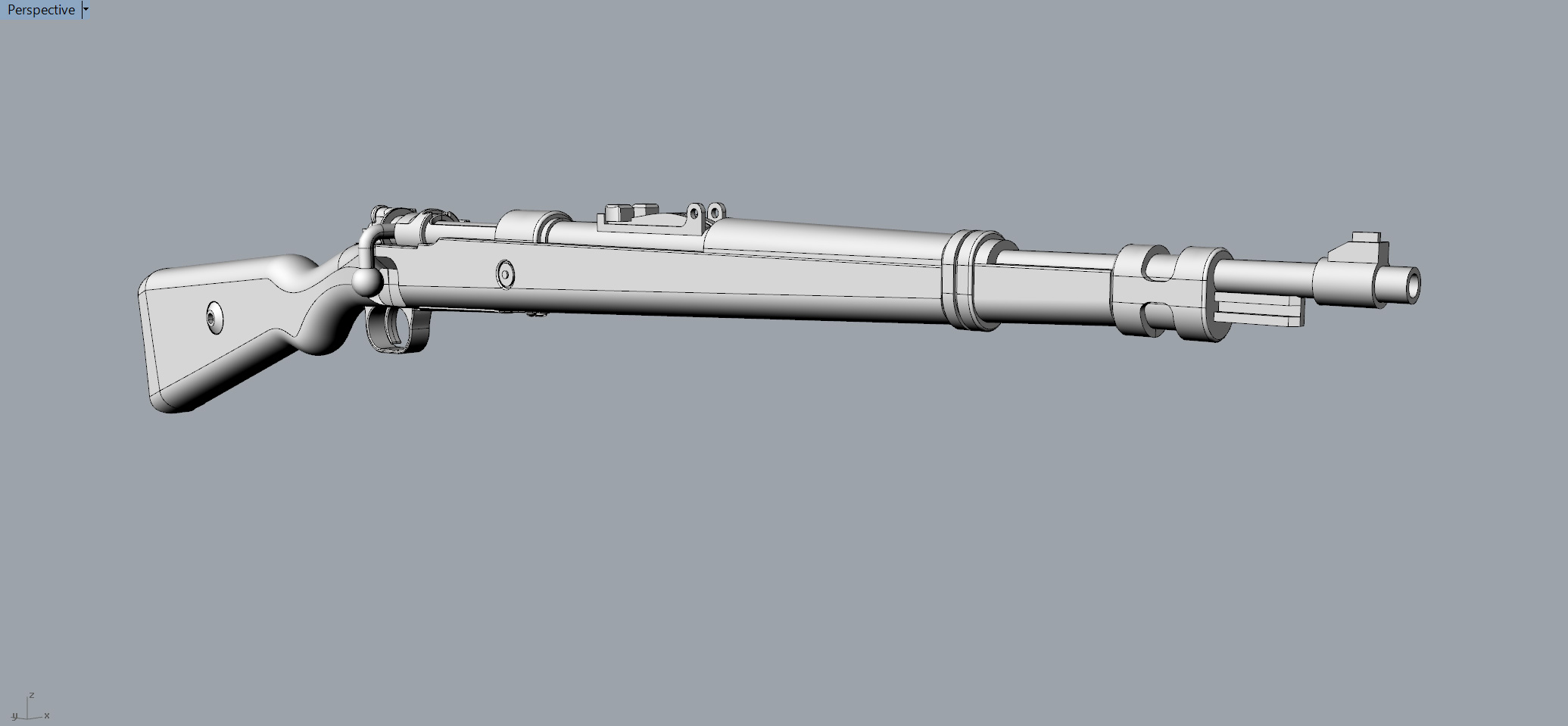

I've also been distracted with some stuff to populate the inside of the fighting compartment. There a lot of MP40 all around it and 2 riffles.
I 3D modeled them and 3D printed them. Not happy with the paintjob but I've printed plenty of them so I will paint new ones -maybe- :haha:

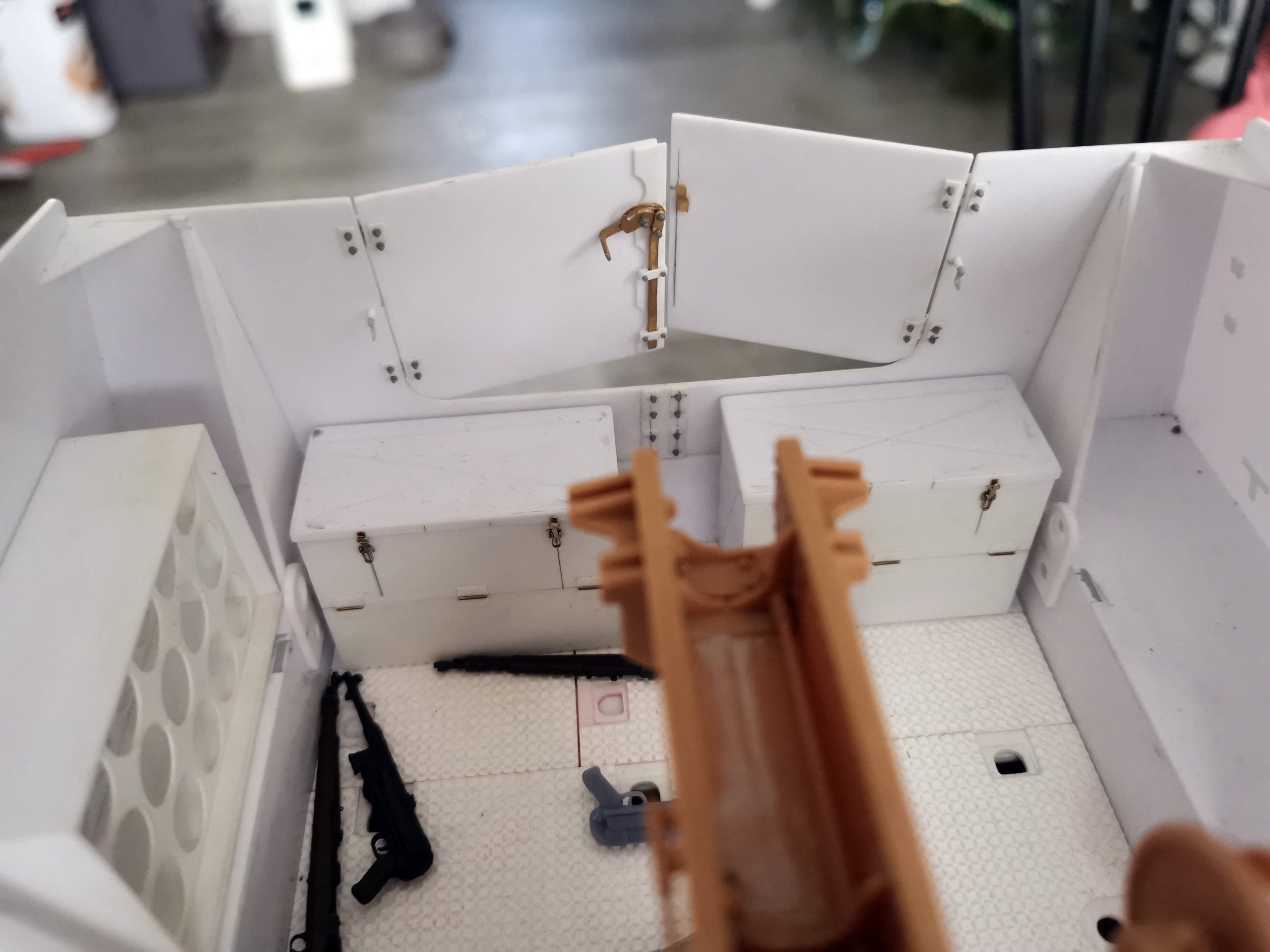

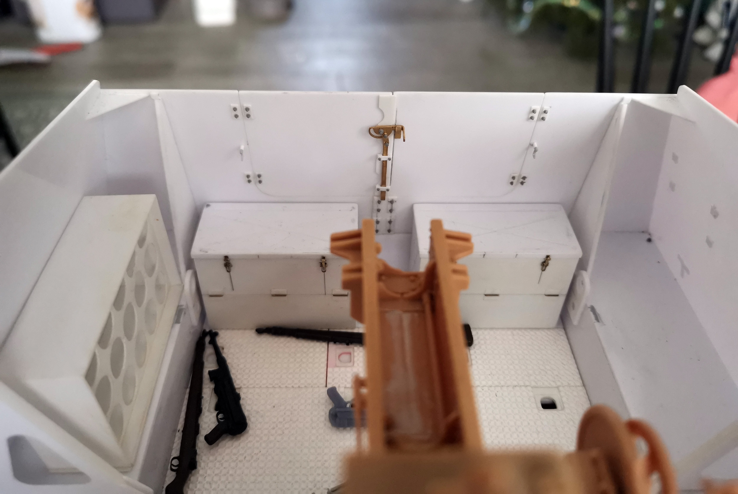

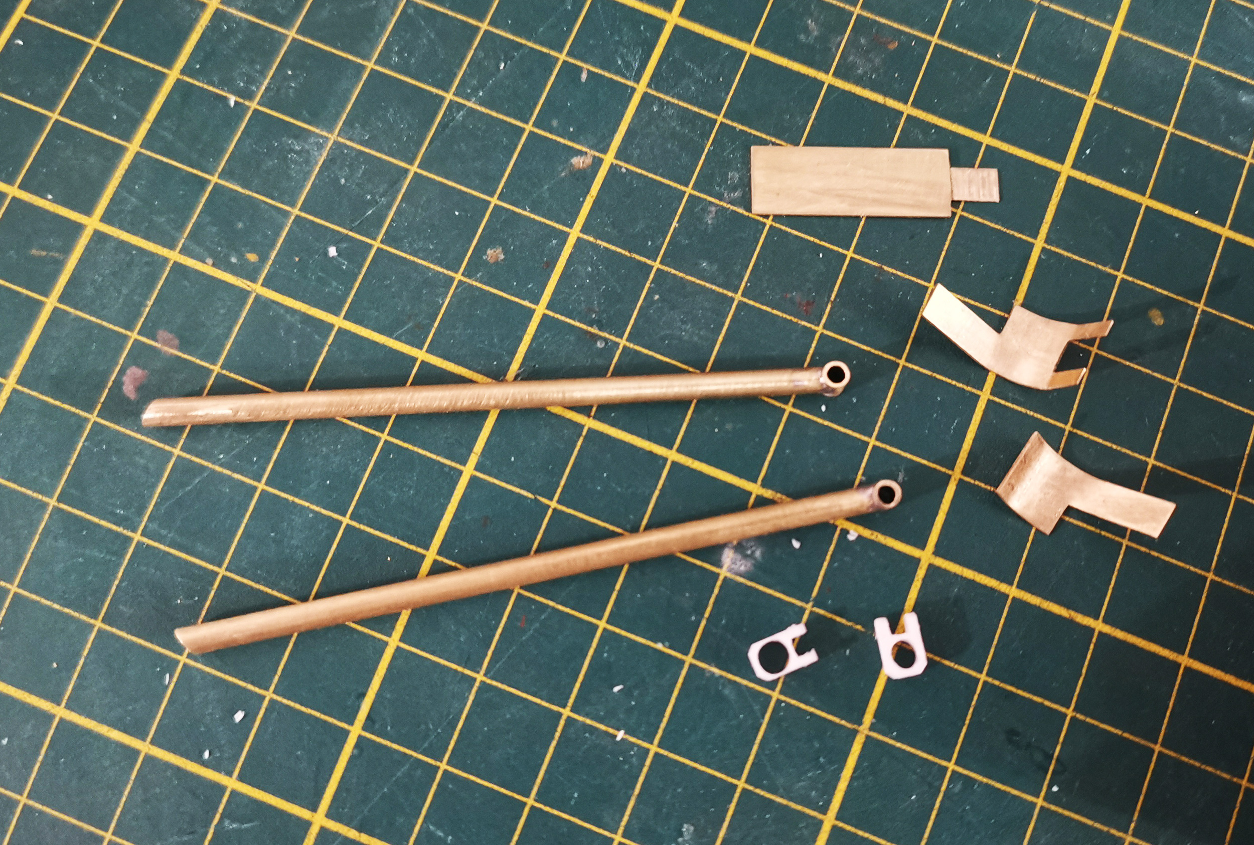

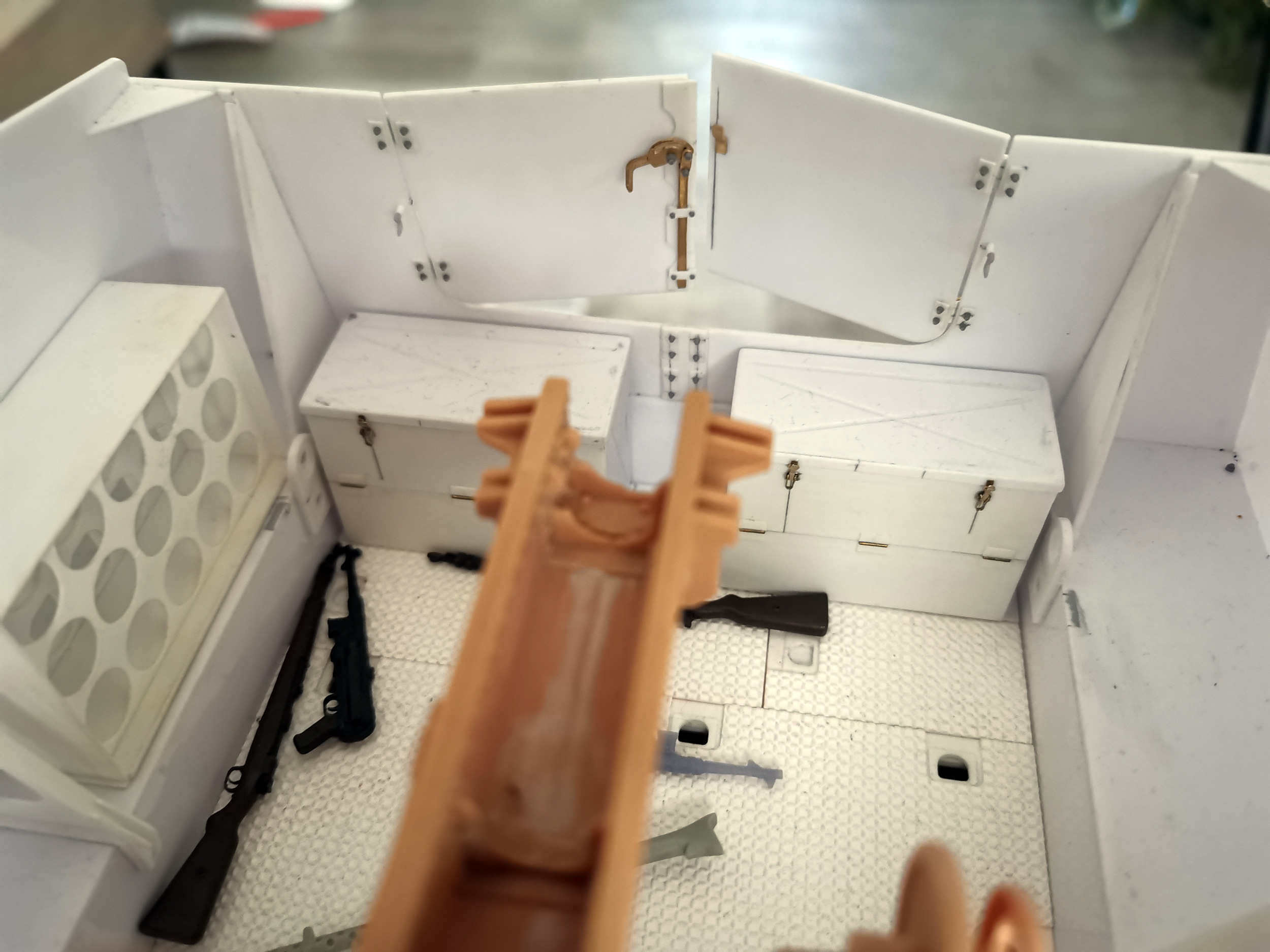

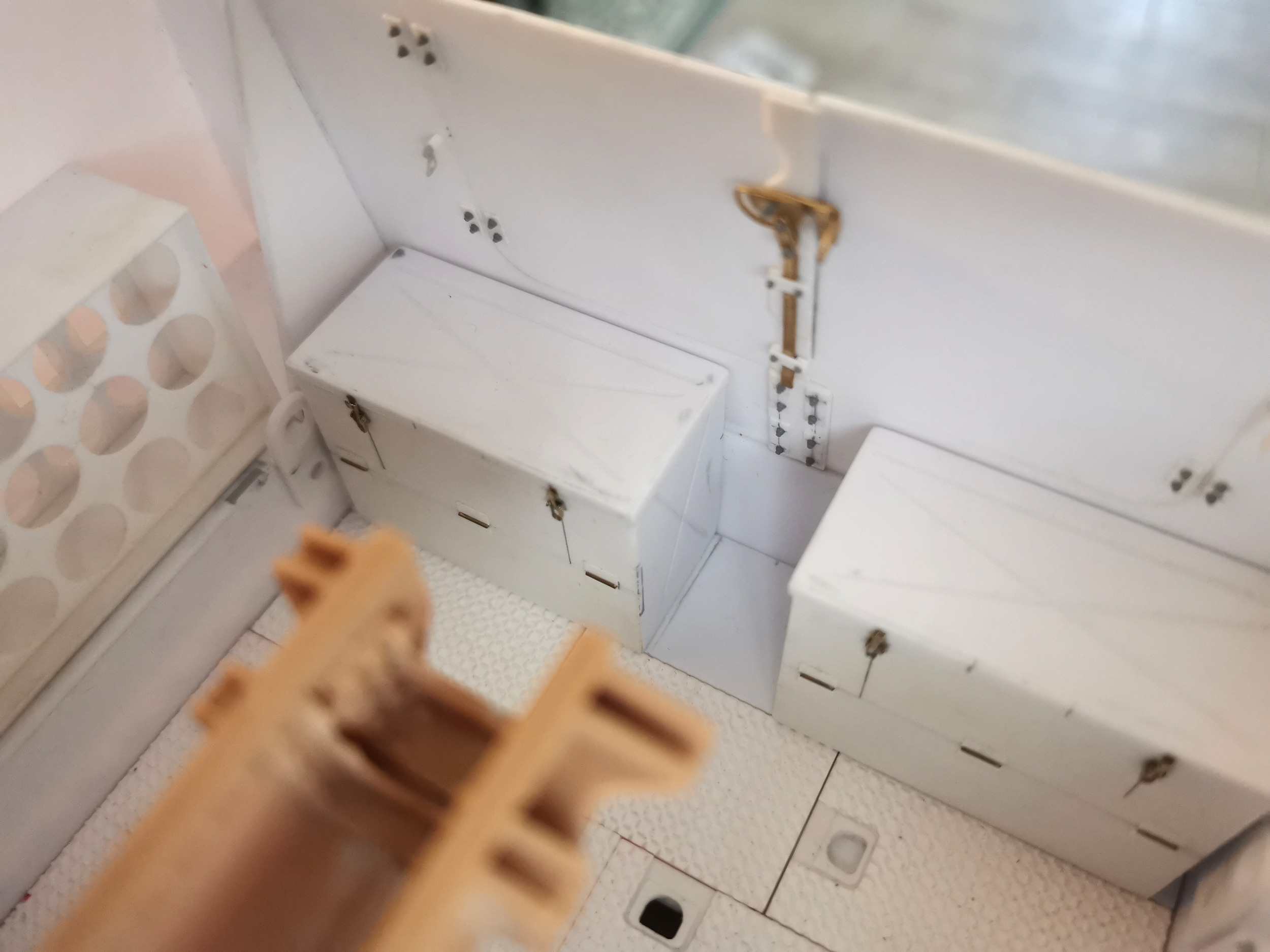

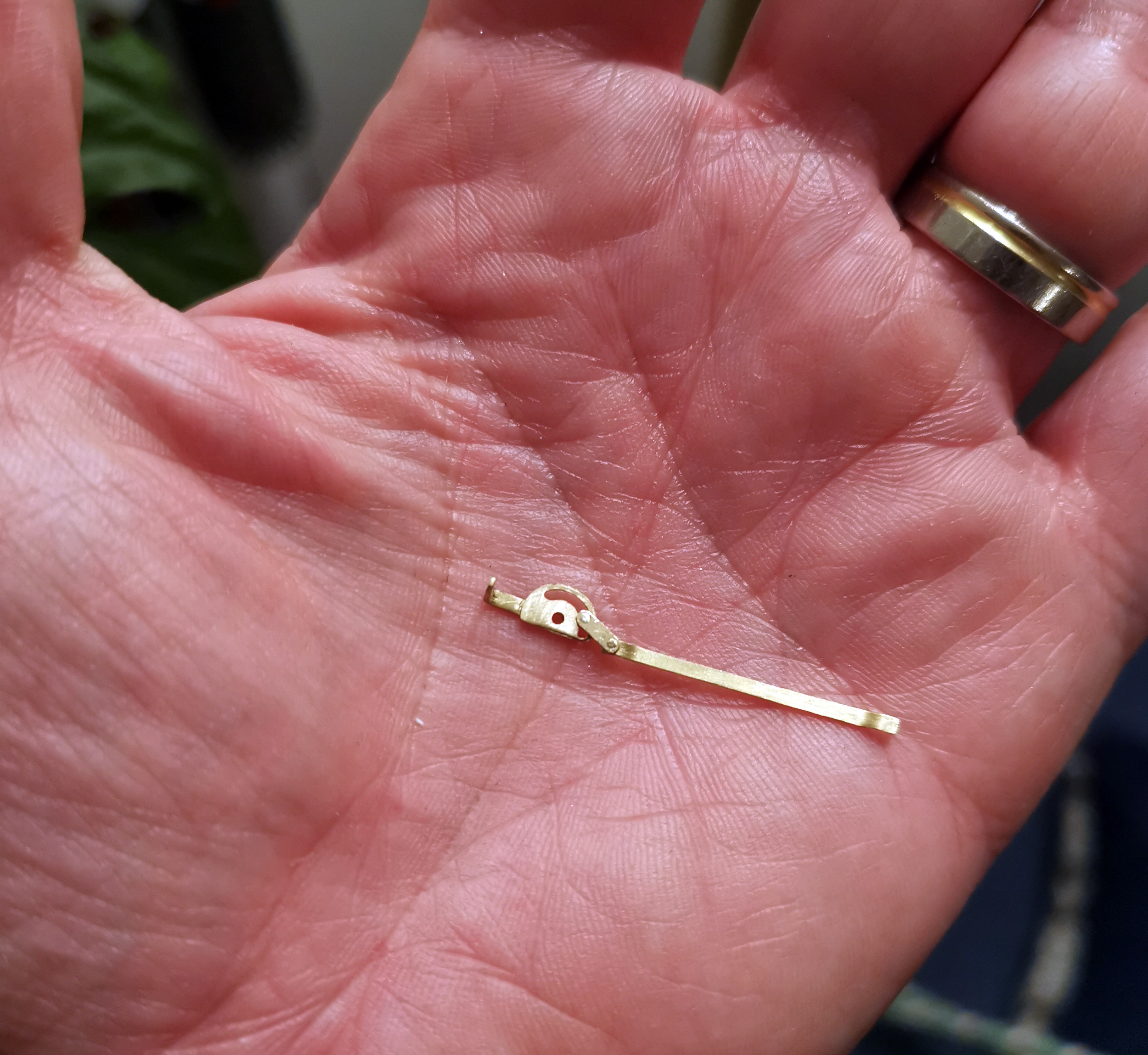

I build the locking mechanism of the rear doors. I wanted it to be functional. It was not easy to work with such small parts and even harder to stay in focus while photographing them :haha:
The main parts :
Assembled :
Doors closed and locked :
Doors open :

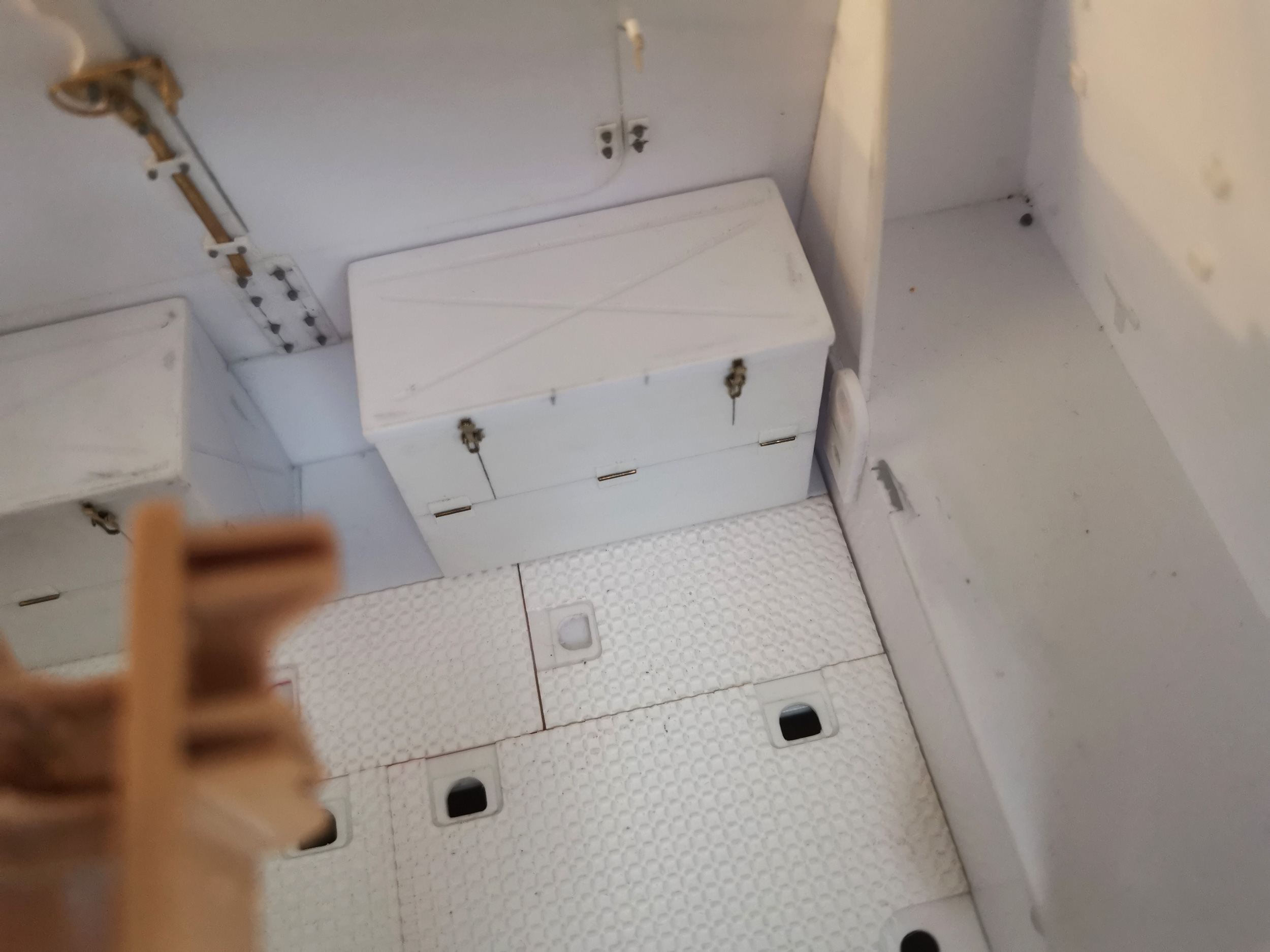

I also built the rear ammo boxes. I still have to add 4 hinges for the top lids.

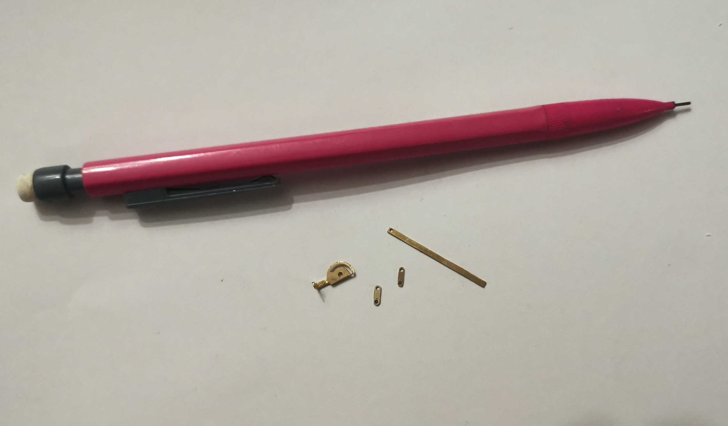

I built the lifting hooks. 2 types were used all over the Hummel, I designed and made those 2 types :

Now that's some impressive brass work! Fine job.

Thanks Eric ! The locking system of the rear doors wasn't easy to replicate, why Germans had to overthink everything ? :haha:
