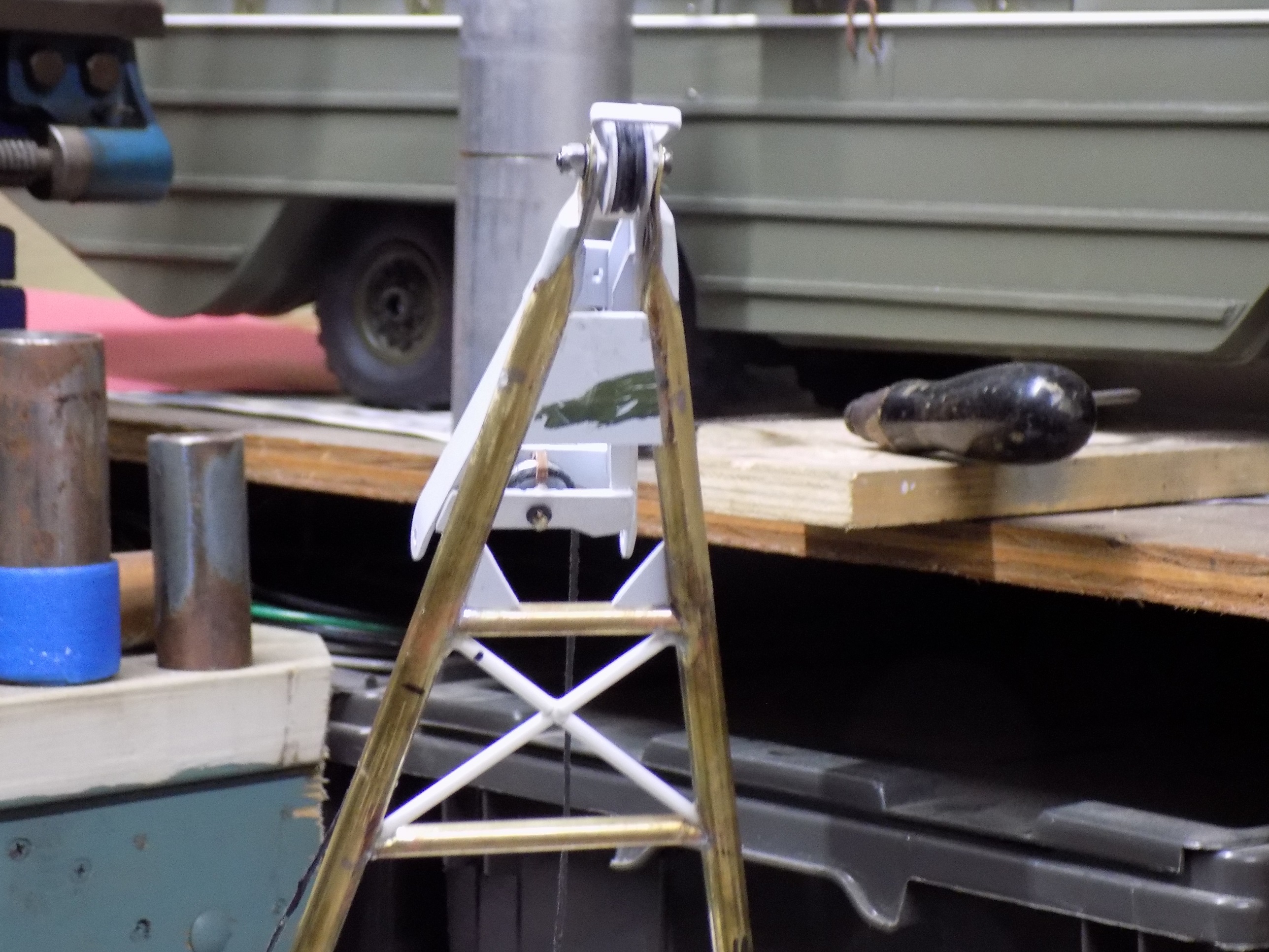

Picture hanging wire/cable did not work out. It is easy to form, but it stays bent, so unless there is significant weight pulling it would never be straight. I occasionally work at a small engine/mower shop in town. I live two miles (1.2 miles dirt road) from a town of 200ish. The only reason I mention this is the cord I am using is what is left over from a shredded mower deck drive belt. It is a string but has vulcanized rubber in it. It seems to "lay" as I was hoping for, "scale steel cable". Down side is it only comes up every so often... Belts don't usually come apart like this one did. It got hot (slipping) in deep grass before letting go.
The boom's bracing: There is a third brass rod hiding behind the triangle with the green paint swab. It was so rigid with those three, I decided to make it easy on myself and do the rest in styrene. I hate trying to solder multi piece creations together. Heat the next part and the first one falls out...

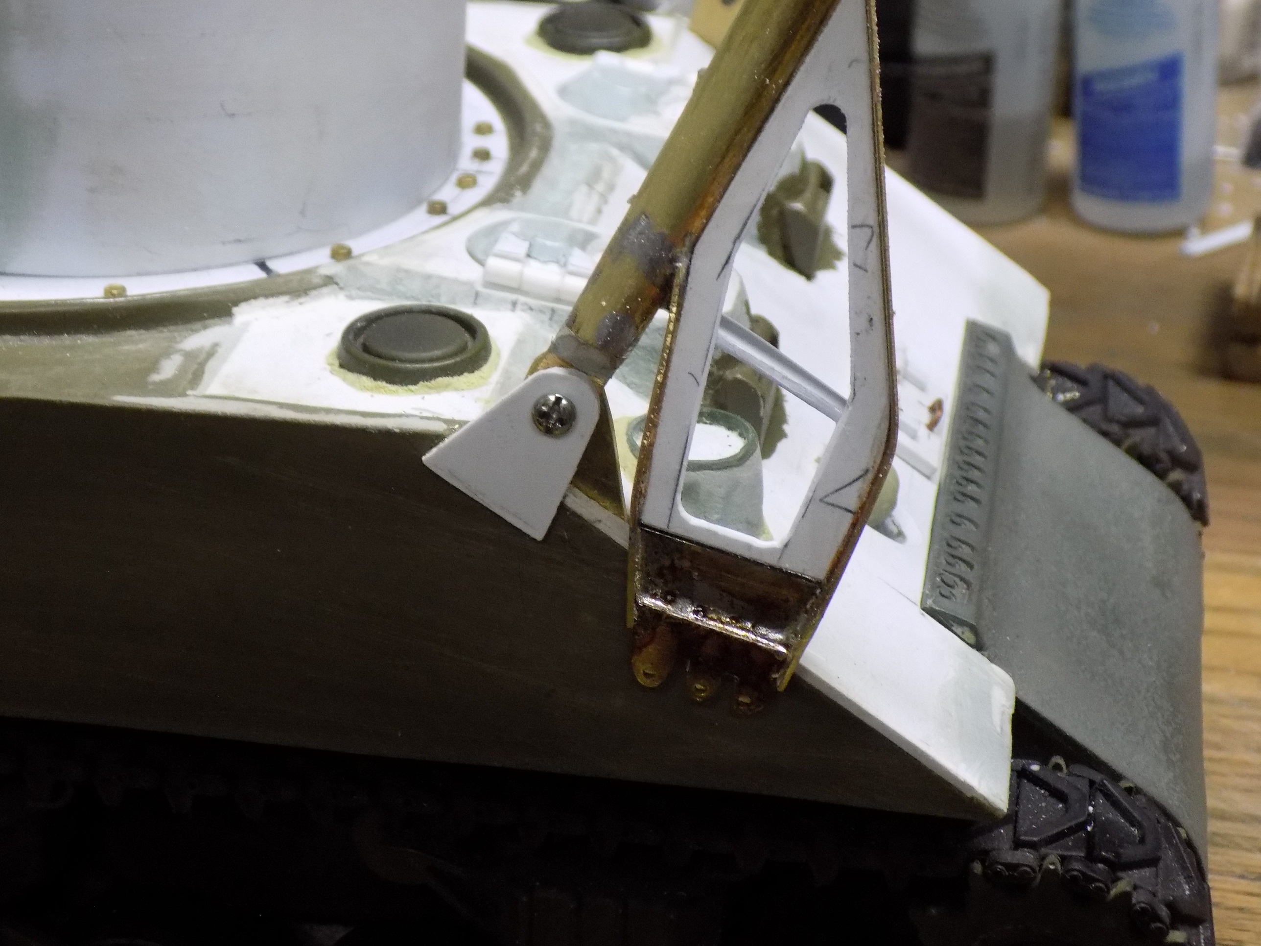

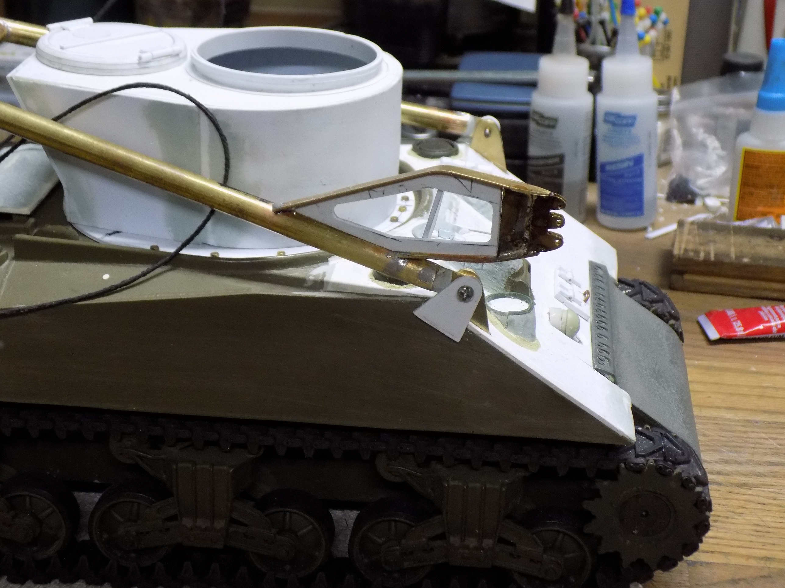

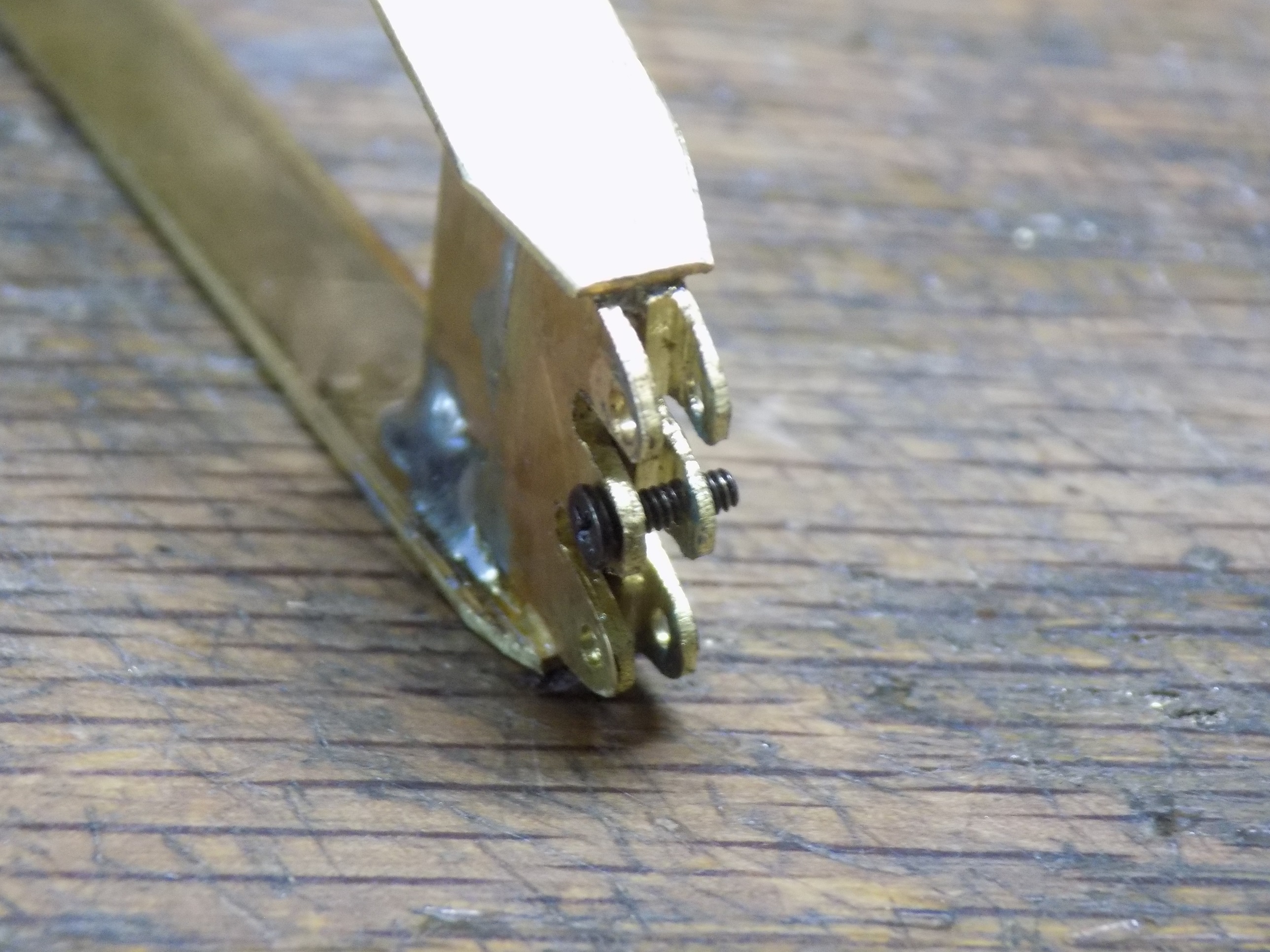

A little Bondo work to clean up my gorilla tube smashing. Also finished the link between the boom and upright, it allows the support to swing out to the correct position for the travel rest (and it works!).
M32 32.JPG (1.12 MiB) Viewed 94 times

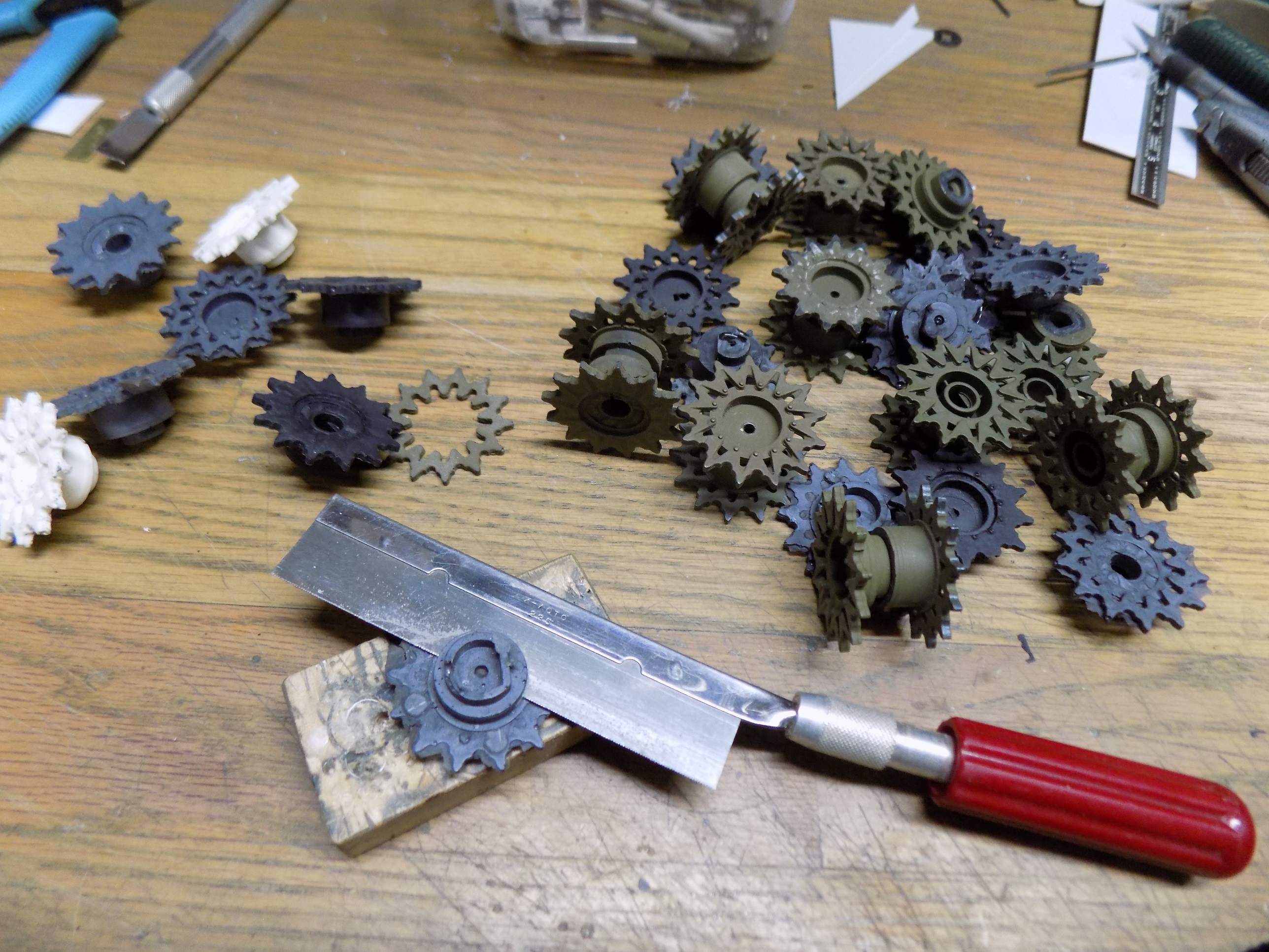

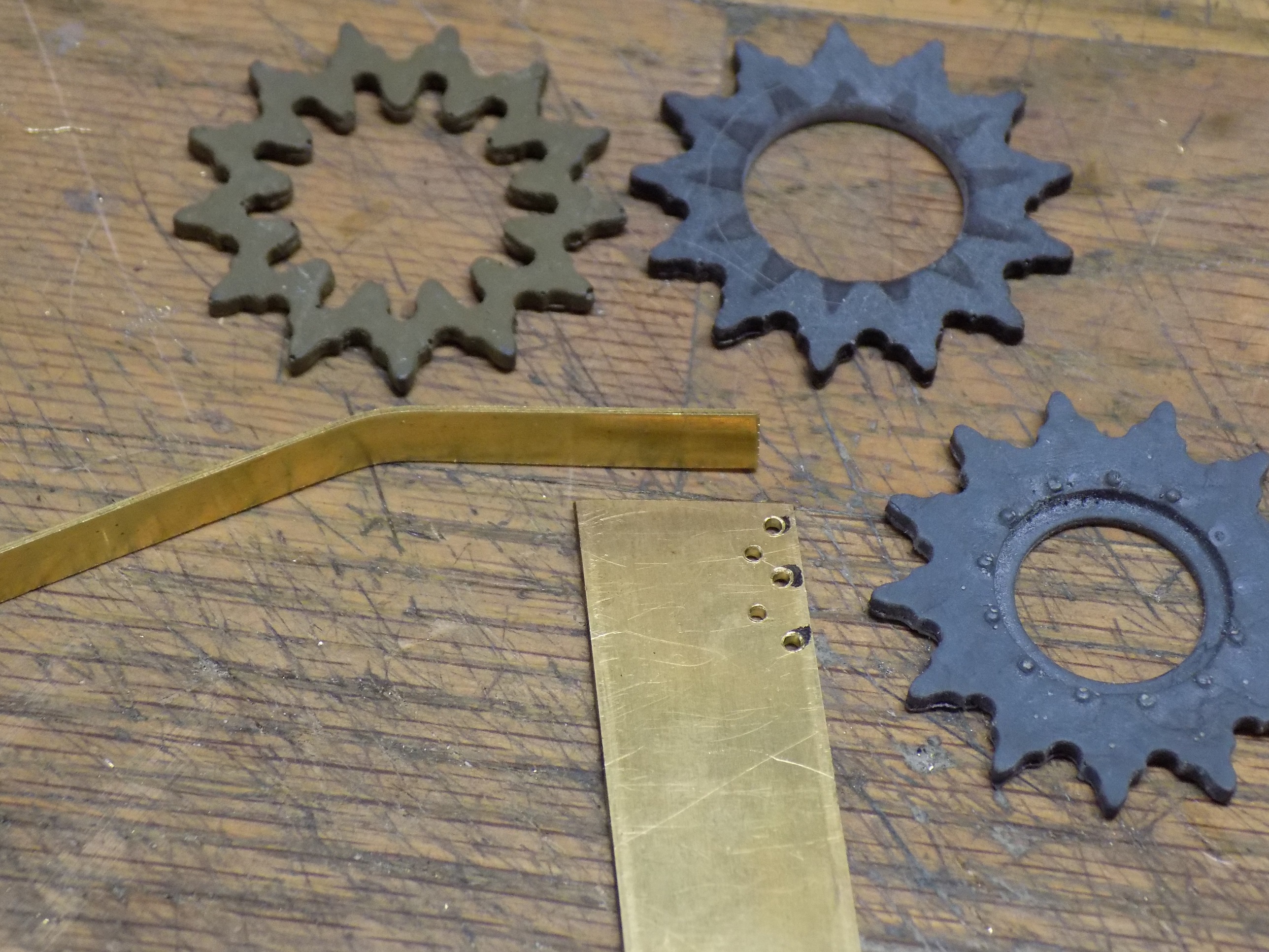

I am starting the pull arm that lifts the boom, but I am also gathering and making some of the parts that will be on board. Have extra road wheels and idler rollers, but need 4 sprocket gears...
M32 33.JPG (1.39 MiB) Viewed 94 times

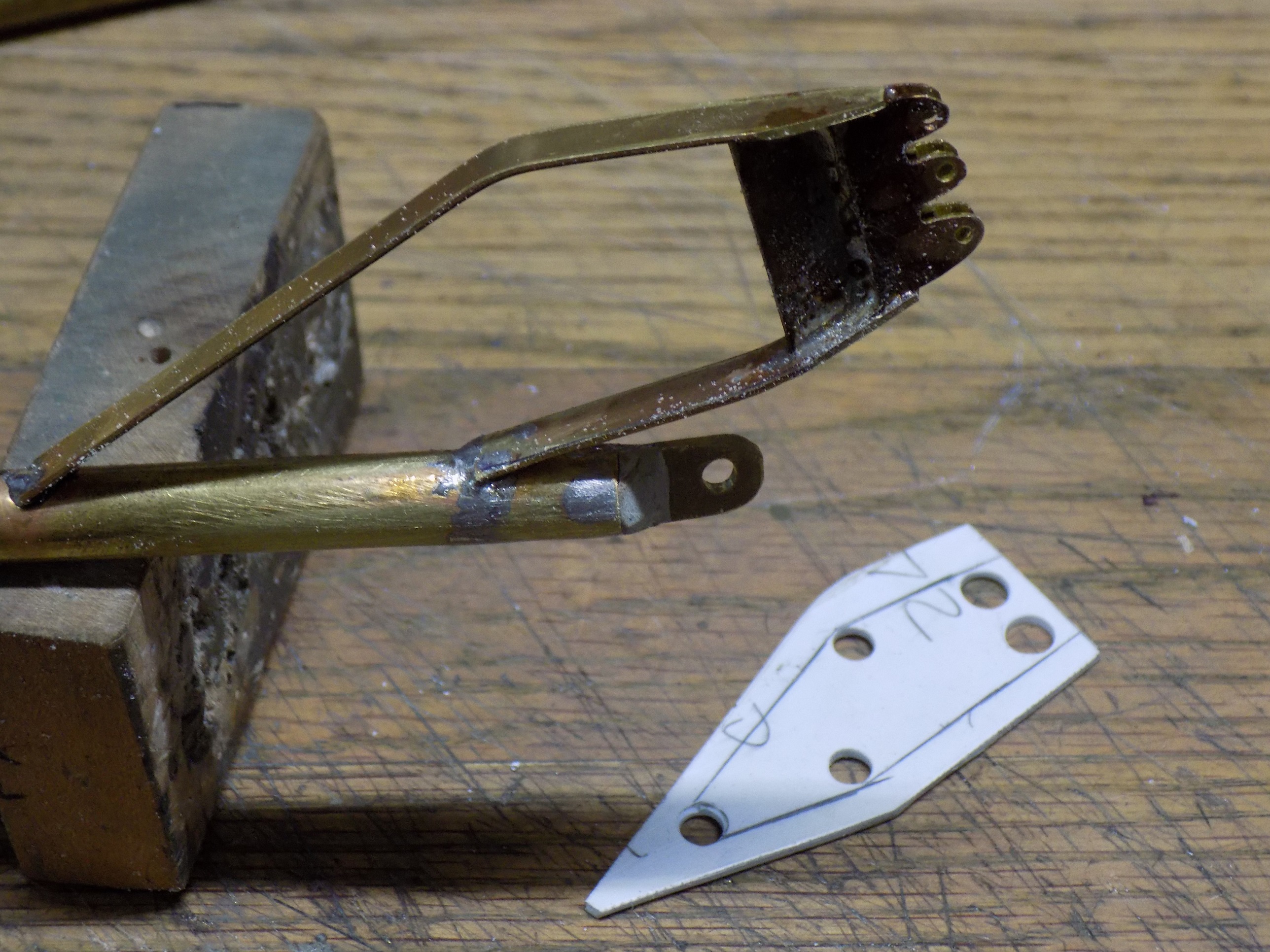

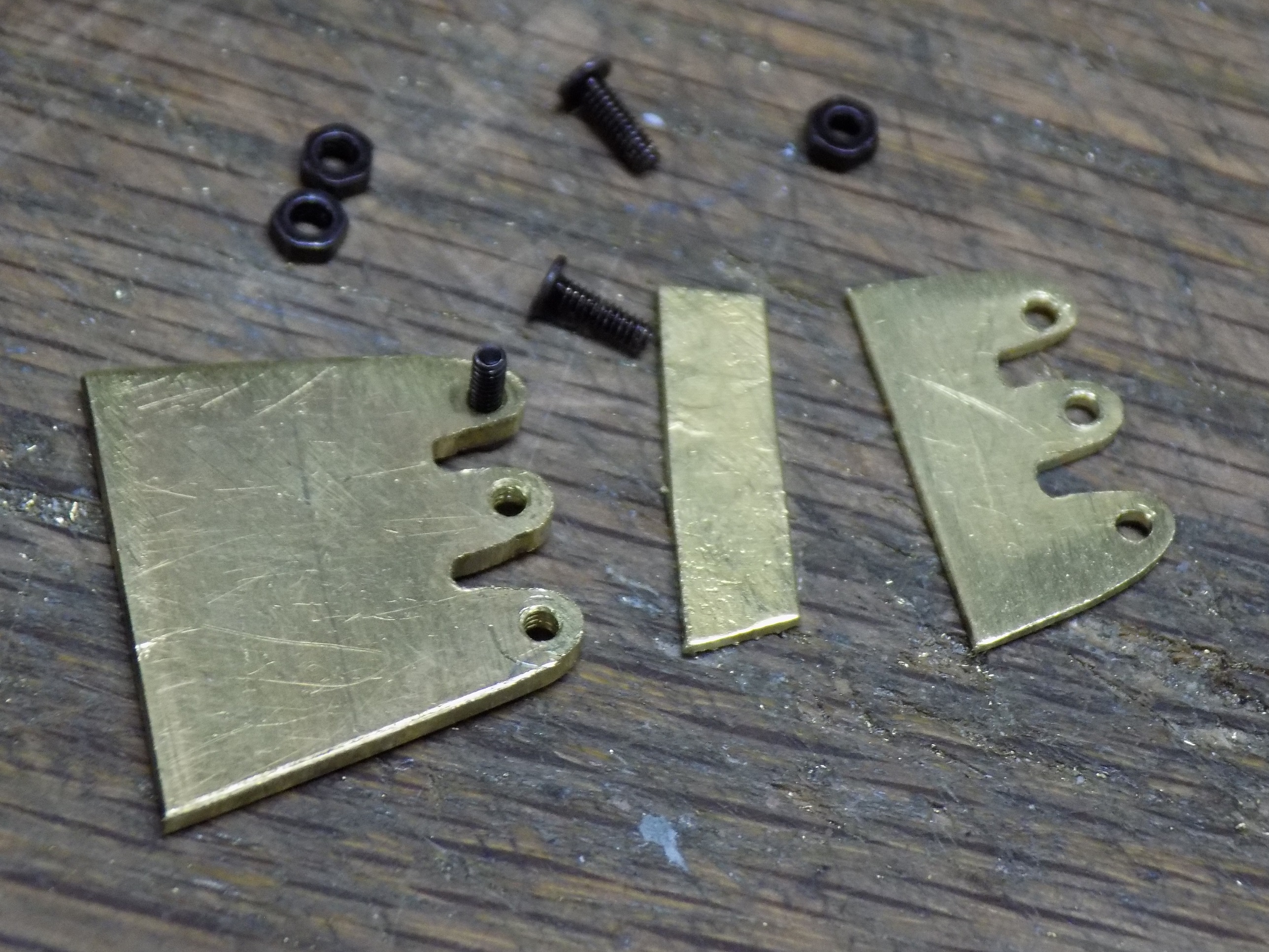

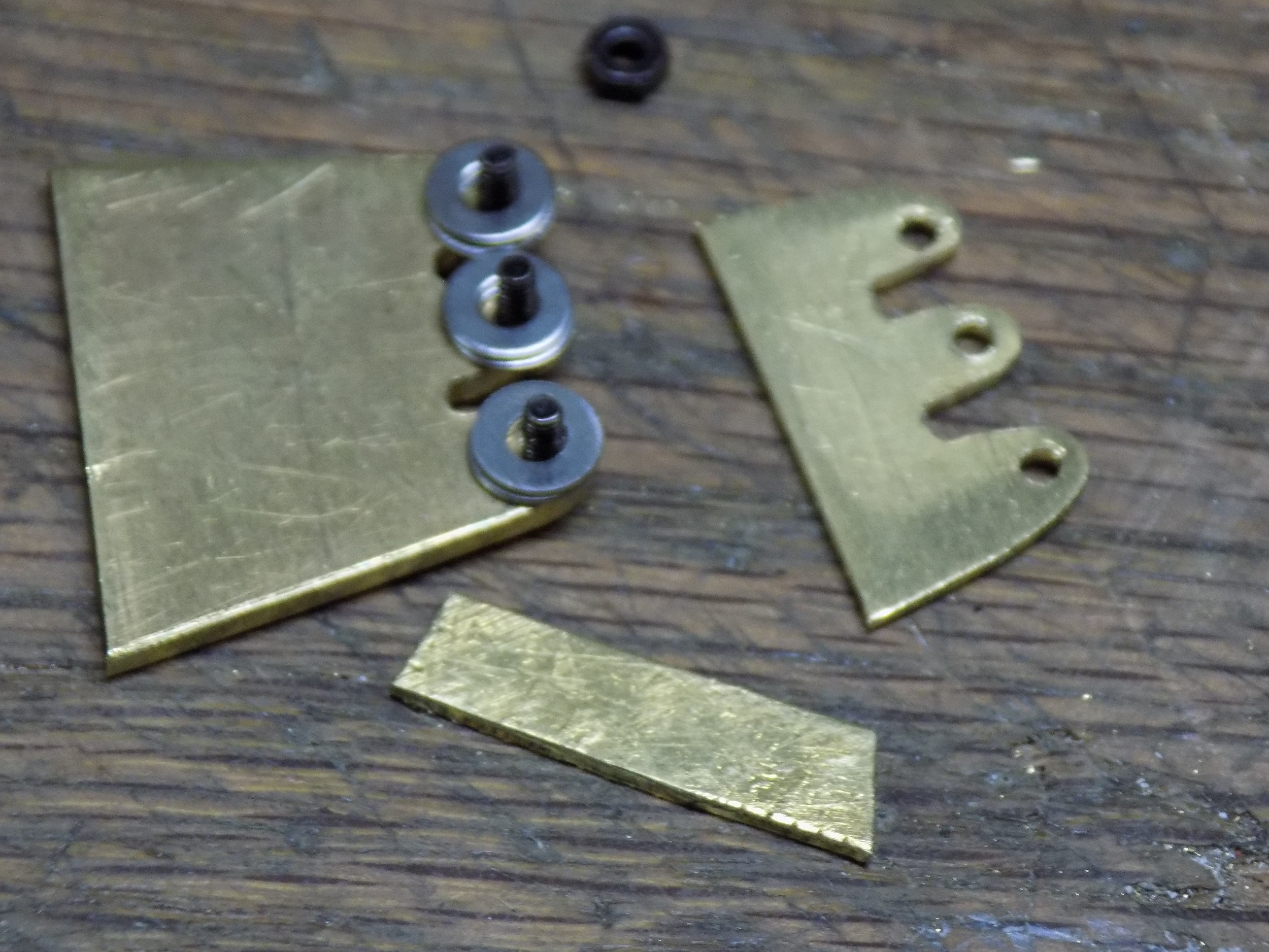

Weird lever/arm time...
M32 34.JPG (1.5 MiB) Viewed 93 times
M32 35.JPG (1.48 MiB) Viewed 93 times
Wanted to keep things aligned whilst soldering.
M32 36.JPG (1.38 MiB) Viewed 93 times
Probably hard to see in this picture but the head is angled inward to compensate the boom angling to the center at the rear.
M32 37.JPG (1.26 MiB) Viewed 93 times

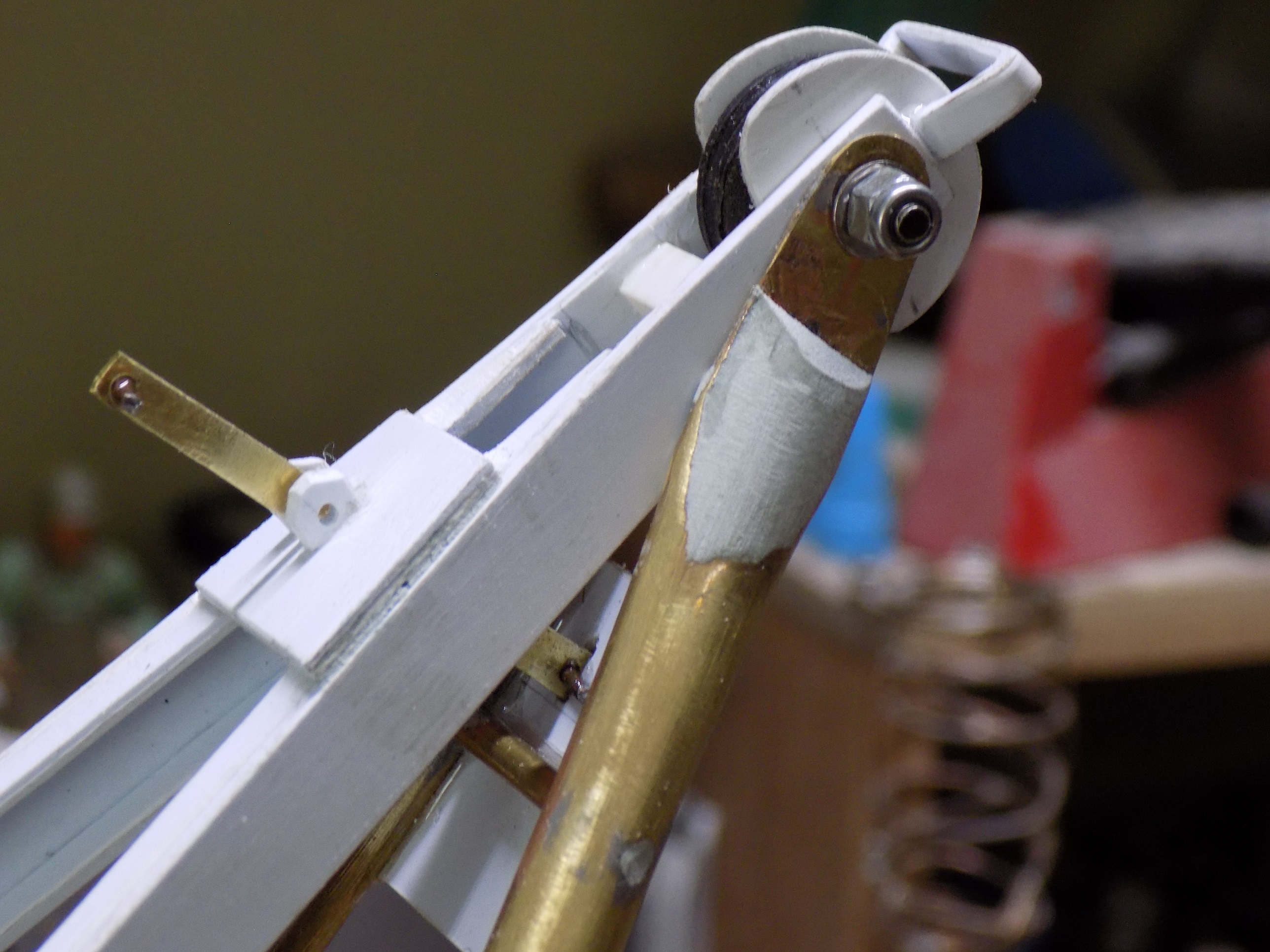

Again, the brass work was stiff enough, here I am starting the gusseting.
M32 38.JPG (1.29 MiB) Viewed 93 times
M32 39.JPG (1.16 MiB) Viewed 93 times
M32 40.JPG (1.24 MiB) Viewed 93 times
