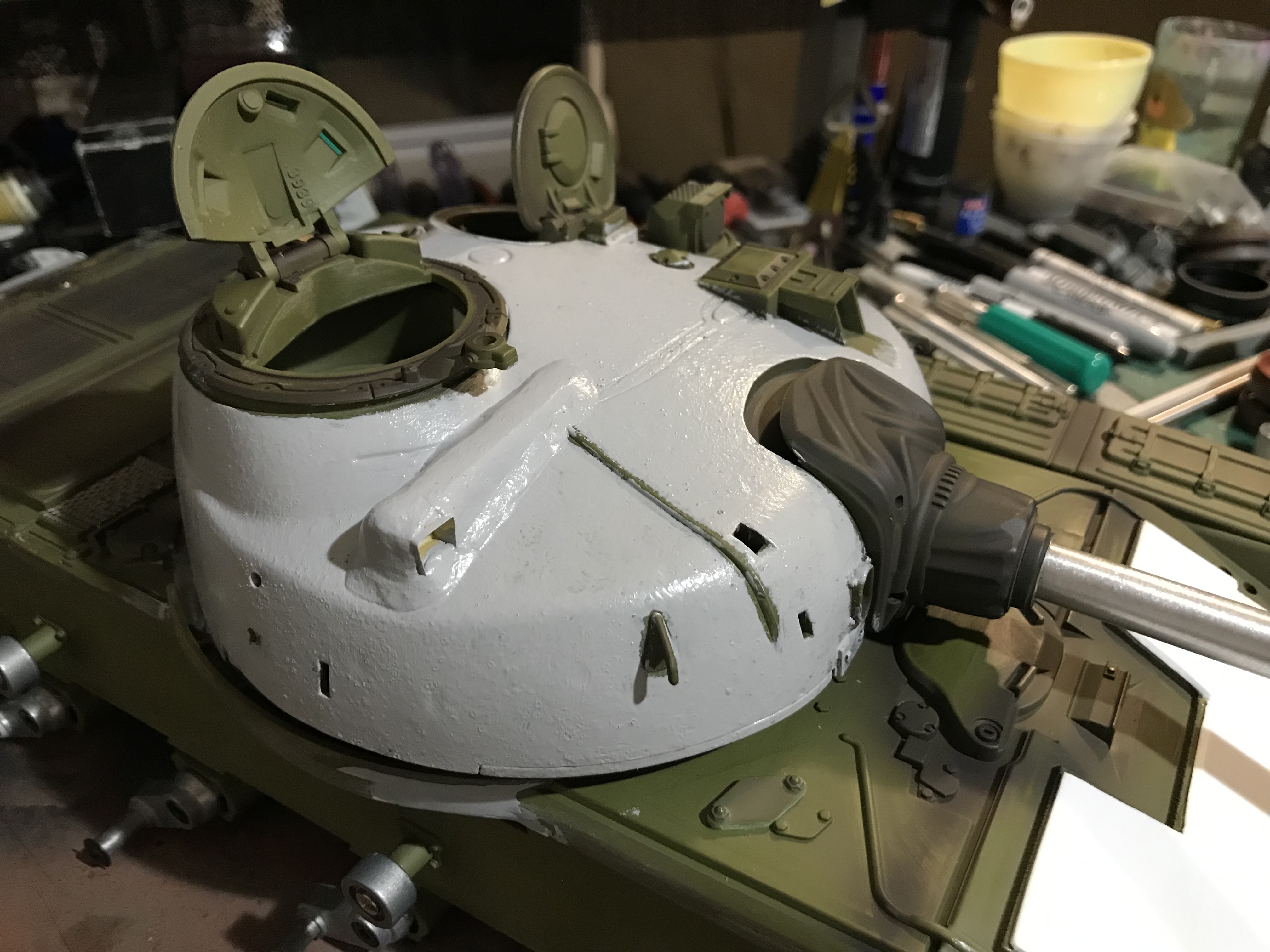

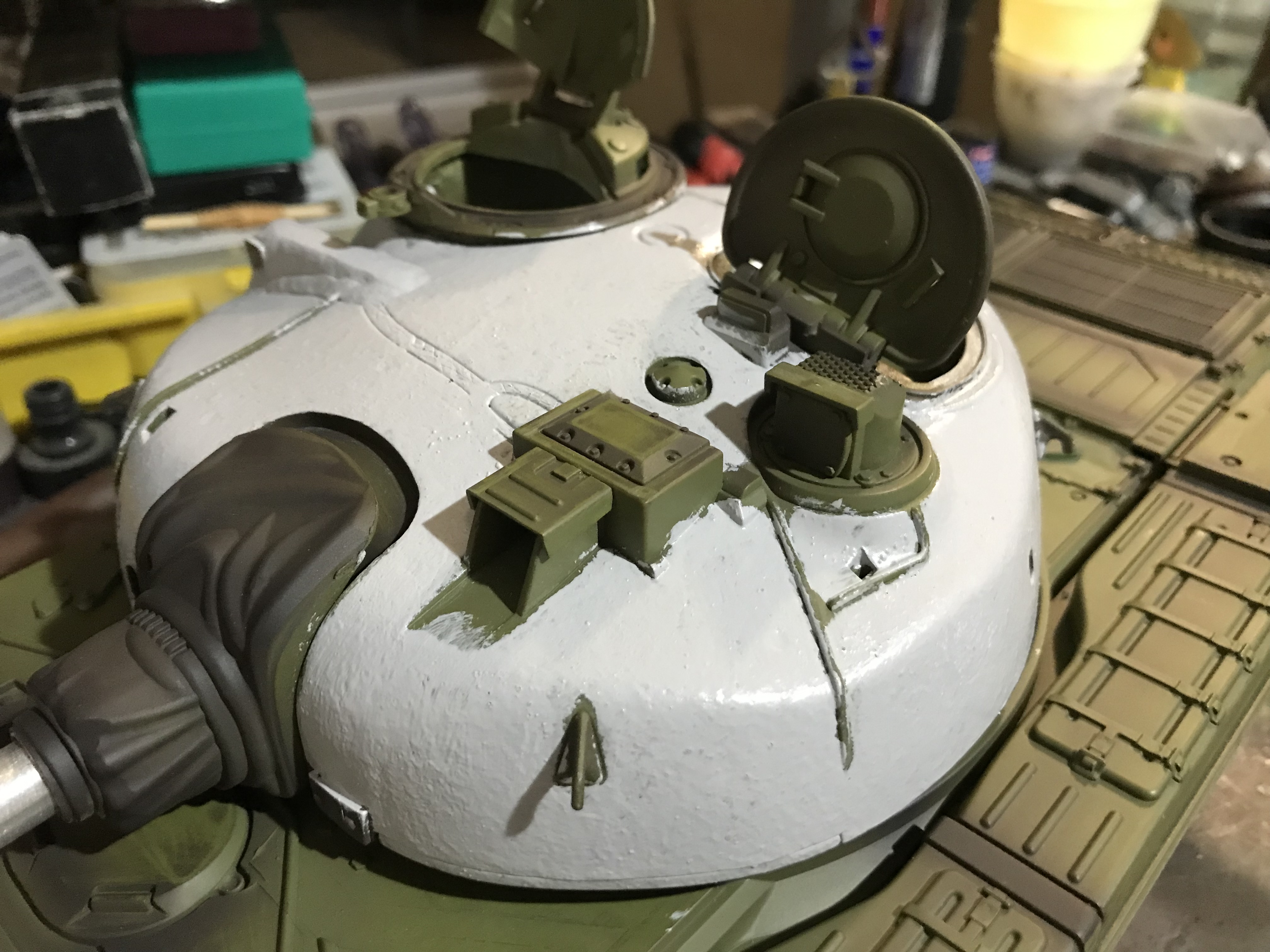

I decided to add the commanders coaxial sight casting.
Using styrene and something tube, secured to the turret with plenty of gel super glue.
This will form the support for Tamiya epoxy putty to make the cast shape, which I will blend to the rest of the turret with a thinned mix of putty and Mr Surfacer 500.
Just got to get the new barrel sorted before that can happen.

Once the putty had set I will sand it off to improve the profile.
After the entire turret is coated in texture this should looking like it’s supposed to be there.

Today has been one of those days that you look back on with a smirk & certainly a lot of satisfaction mixed with relief.
I went out looking for material to make a barrel, that was the entire mission.
Found lengths of aluminium in 1M sections, I needed 310mm long @ 10mm diameter, and 15mm long of 12mm diameter.
The barrel measured up as 10mm diameter which meant that to get a sleeve for it, I needed 12mm diameter but had to open the I.D. out to accept the 10mm barrel. I did consider a fishing rod section, but the dimensions were not quite right. Now I have a pink fishing rod with an LED lit up reel on it that I have no use for :/
After a bit of thinking and dry fitting I got the balance right.
Cannibalising the old BB unit to enable the new barrel to attach to the thing was not an easy task but I did have a win.
Lots of drilling & reaming to get the parts to slide & have clearance but without anything excessive was at least 4 gin & tonics and 5 Jack Daniels....... :shifty:
Over all while not perfect, its a fair representation of the barrel with its thermal cover torn off and best of all I have recoil and flash & smoke from the barrel.
I regret not doing this to my T90 now................. :headbang:
Chucked a first coat of Mr Surfacer 500 on and I will probably go over it again in the morning. really could have done without the extra hassle of needing to fill the holes that were for the ERA that I didnt want, the dimples still show. More Mr 500 should sort it.
Mucked around getting the barrel smoker tube and all the wires run & tested, then banged the hull securing screws in place.
I'm on for the outer detailing now :thumbup:
