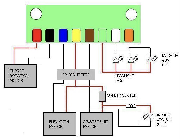

Re: Jagtiger in need of a reboot
See her, no malice, no annoyancejohn1970 wrote:Easiest thing to do is fit the taigen board into your tiger to test it as it will be a straight swap.
If you fit it back into the jagdtiger then your starting from the beginning again as not everything is wired up and you wont be able to test all the functions
I don't understand what would go wrong? Tiger I: 2 headlights and turret rotation, Jagdtiger: oneheadlight, and no turret rotation, tell you about the absence of the switch on BB firing? I would be surprised that absent? view that no photo of the side concerned, and all the BB shots removed from my tanks (same as the photo) had one!!
