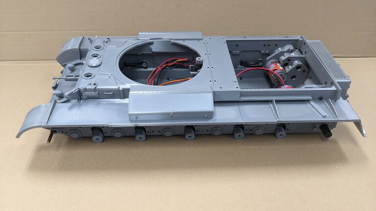

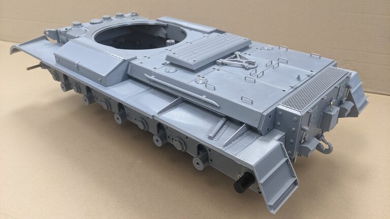

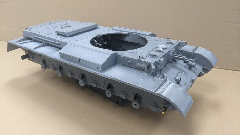

Fenders and the rear of the hull done. Onto the top cover.

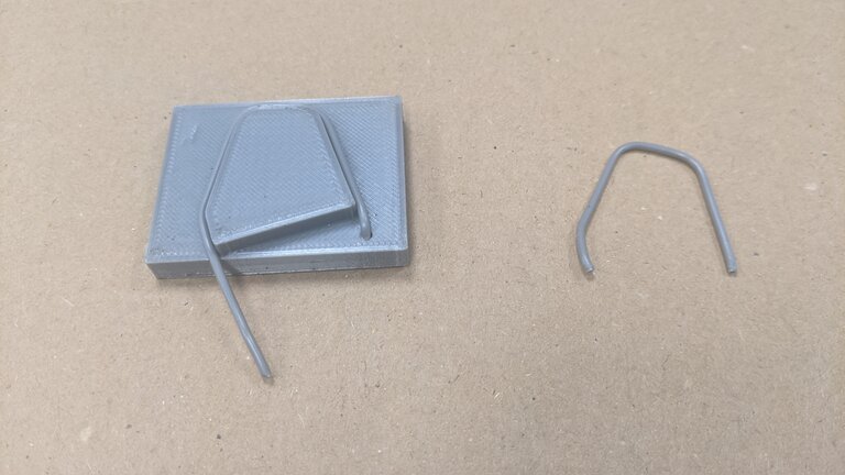

There are 12 handles and 4 light guards made from the filament. There are 2 formers that are printed and then used to form heated filament around them. I drilled a 2mm hole in the former to act as an anchor while the warmed filament was pulled around the former.
