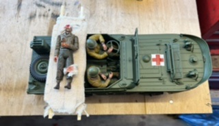

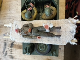

Ford GPA is currently being converted to a medical vehicle. It now has its first casualty. Hand made stretcher.
