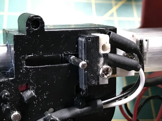

Elevation, Recoil & Flash all function and only when connected to the transmitter. However, the RECOIL function still does not ‘park’ and the FLASH stays on too long. Could it be the microswitch?
The microswitch has 3 poles, with 2 connected. When closed it has continuity between the 2 wires, Black & White

Microswitch #2
Microswitch #2
Microswitch #1
Microswitch #1

:) the microswitch sends only one pulse (stealth contact) to control the flash or flash led between J / K on board, in principle only need two wires (it is an inter)

Yes, I agree. I too believe it should make contact momentarily, then release, that is ‘pulse’.

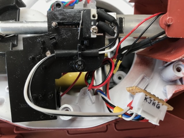

I have a spare simple spring steel, airsoft style microswitch, either to add a second switch OR replace the WSM microswitch, because I’m now doubting its correct functionality.
Aiso, I have searched out a Taigen/Aisatam recoil/elevation unit from my spares. The two microswitchs are different to each other in design. The simple type that I think connects in to CH3 pins G/H, the second a true microswitch that is connected to the negative? of the recoil motor & the battery (-) at the power switch.
I’ll experiment more tomorrow.

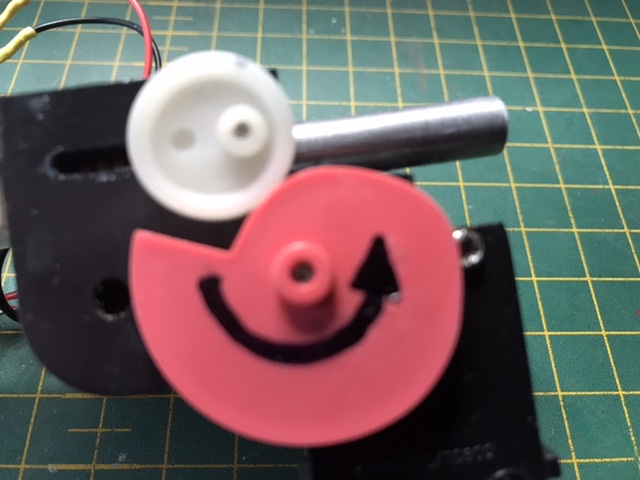

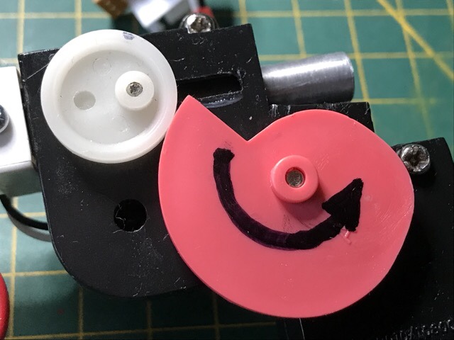

The WSN microswitch tested OK. I reassembled it to the recoil and this time plugged in the speaker. This is the result:-
1). The recoil cycles but still does not ‘park’.

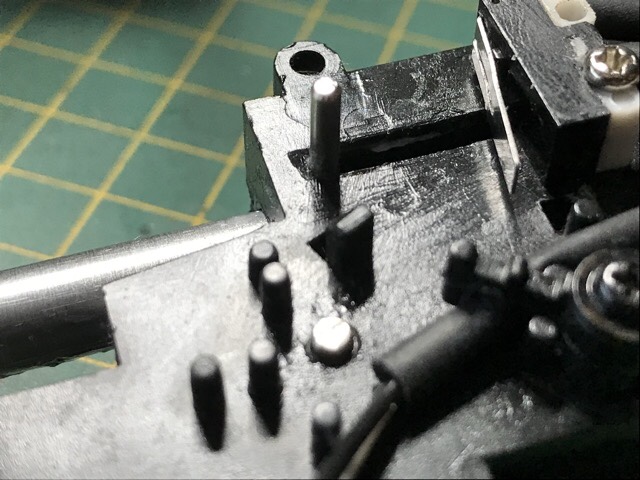

2). The new clue is that that the cannon sound keeps repeating when the cam is at its peak, and stops when indexed to its low point. Therefore, the microswitch is closed and not briefly making contact, ie. a quick make and break contact ‘Pulse’. I am going to try to adjust the microswitch position a little, before trying to mount a simple Heng Long / Taigen type microswitch.
Attached are photos of both sides of the recoil, fully extended and fully recoiled.
Best regards,
R/H Side Extended
R/H Side Extended
R/H Side Extended
R/H Side Extended
L/H Side Recoiled
L/H Side Recoiled
L/H side Recoiled
L/H side Recoiled

That is the WSN microswitch connected to J & K and the other simple microswitch to the Negative of the motor & battery ‘Ground (-)’.
