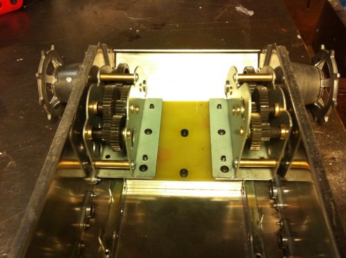

:) if can help? find this on the net, sorry if in French? but think more understanding
https://www.vintage-rc.net/viewtopic.php?t=20332
to fix the Heng Long motors, 2 aluminum squares have been added in width, between the two suspension rails, fixed from below, and the boxes from above, you need a little mechanical, but it works.

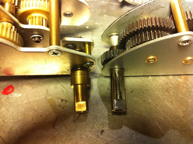

I think our friend wishes to make it functional, in memory and homage to his wife's father, which is to his credit. Finding original Tamiya parts, used on Ebay becomes very difficult and in the end, more expensive than a tank new, am in a good position to know it, having experienced
below two photos of what is achievable
left, Tamiya engine
Right engine Heng Long, or Taigen, etc.
adaptation of HL engines, Taigen, etc. in a KT Tamiya, but remains the same for Tigre I. After I only speak of what I know and know how to do,

Be careful, I don't want to cast any doubts, but be careful :(
there are different lengths of output shafts on the gearboxes, especially here, make sure that everything is properly aligned, undercarriage level, that the toothed gears (sprockets) do not rub, etc.
