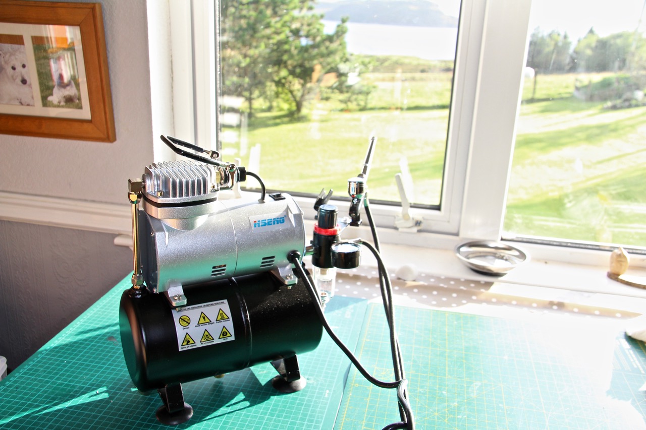

The Chinese have a knack of giving the same product any number of different names- as if to disguise them. Mine, for example, is 'Hseng' (perhaps a corruption of 'hissing'
) but it looks identical to yours, pretty much. It does knock a bit, and the hiss comes from clearing the airbrush (Harder and Steenbeck Ultra) from all the usable pressure it builds up; but, all in all, it performs very well. It's also turned out to be fairly robust, as it has had to contend with a fair amount of physical and verbal abuse in the last 3 years.. I'm a born cynic, but will say that I have been pleasantly surprised with mine. If the clanking bothers you, just put some cotton wool in your ears.

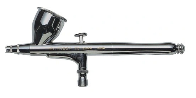

Recently I've bought MR.PROCON BOY PS-274 0.3mm (Iwata like). It is a pleasure to use it.
