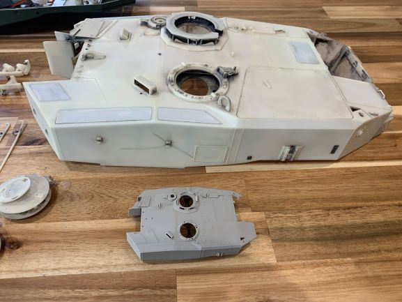

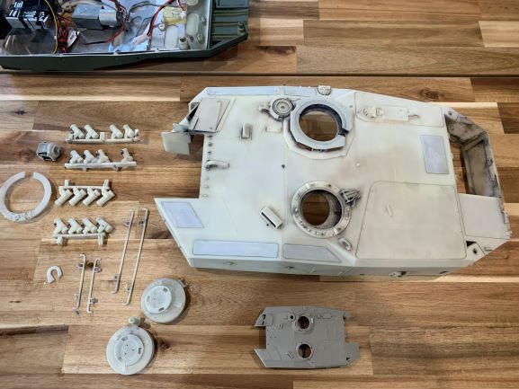

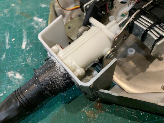

While waiting for the turret armour parts to arrive from the printer, I have started to prepare the original turret parts for modification. This involved removing grab rails, smoke-dischargers and the like. I had assumed this would reasonably simple and quick process. However, Hooben used a unusual adhesive that was completely impervious to acetone. I had also assumed the adhesive used was a type of cyanoacrylate which readily de-bonds with acetone. Eventually, I tried some D-limonene solvent and that seemed work turning the adhesive into small grit-like blobs. Even applying great deal of care, I did manage to crack the left turret wall trying to remove a grab rail. Nothing serious and easily fixed with ultra thin super glue.

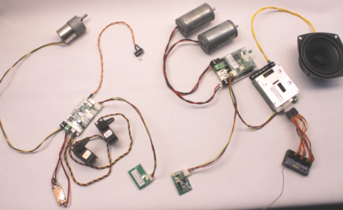

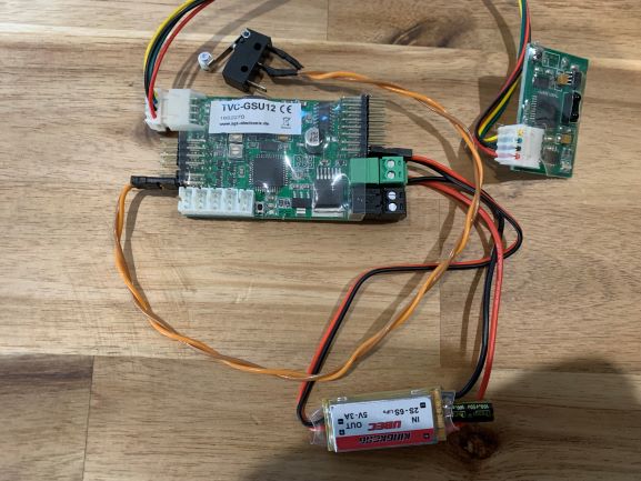

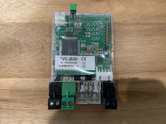

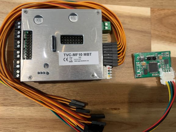

Once all the parts, were removed, I striped away the factory paint job. Aside from wanting to undercoat and repaint the model, I also want to make sure the new parts are bonded directly to surface of the original parts, not a to the paint layer. Earlier in the week the replacement electronics arrived form SGS in Germany. I ordered these boards in late April and they spent close to two months holidaying at Frankfurt Airport. The following image shows the general arrangement of the electronics in the hull and turret. Communication between the two is the via IR boards at the bottom of the image. I also thought I would spend a little bit of time on the hull.

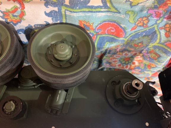

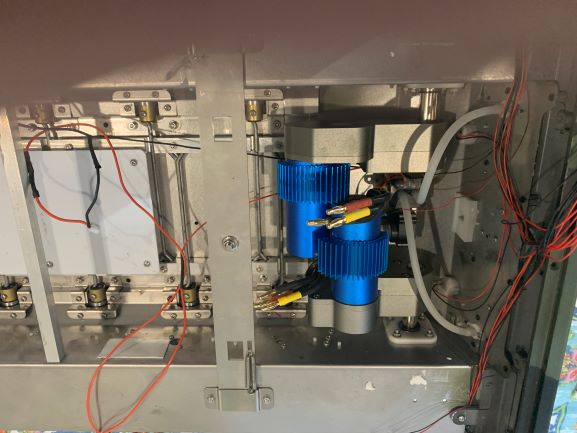

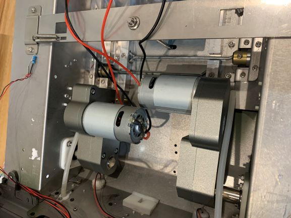

When I ordered the model form Hooben, the motor and gear box options were not terribly clear, and I ended-up brushless motors. In my opinion brushless motors don't perform well on tracked vehicles at low speed and also require an ESC for each motor and a separate mixer.
I ended ordering replacement brushed motors and gear boxes from Hooben. I spent a bit time swapping out the motors and gear boxes and removing the original smoke generator.

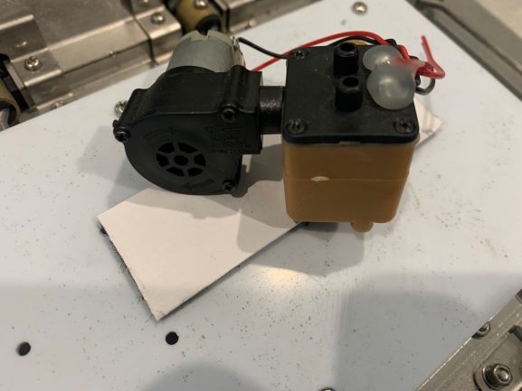

I also removed the original smoke generator, which was the standard Heng Long/Tiagen etc type.
I will be using a more powerful, home made, smoke generator that will produce a more realistic stream of exhaust. The output of the generator will be controlled by the FO unit and will be proportional to the acceleration of the tank.

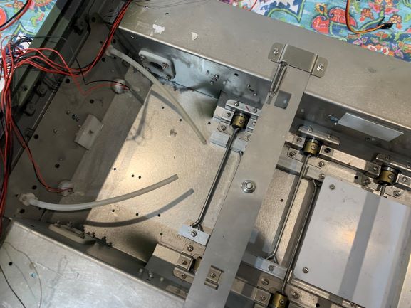

The are a number of gaps in the lower hull that are a result of the way the hull has been cut and folded to accommodate the suspension. Although I don't intend to run the tank in mud or water, I don' t like the idea the lower hull filling with huge amounts of dust and dirt. I will be blocking off all these sorts of gaps with a two part metal putty.

Wow, that SGS German electronics look complicated and expensive. Glad you seem to know what you're doing. I would be so scared of frying the board with my limited electronic skillsets. Amazing build.

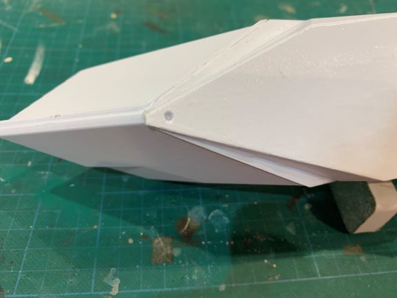

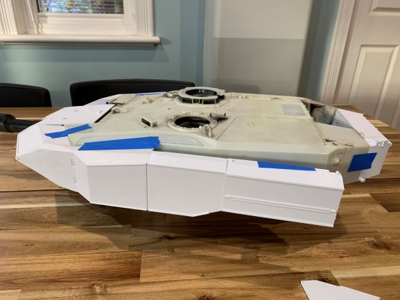

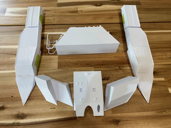

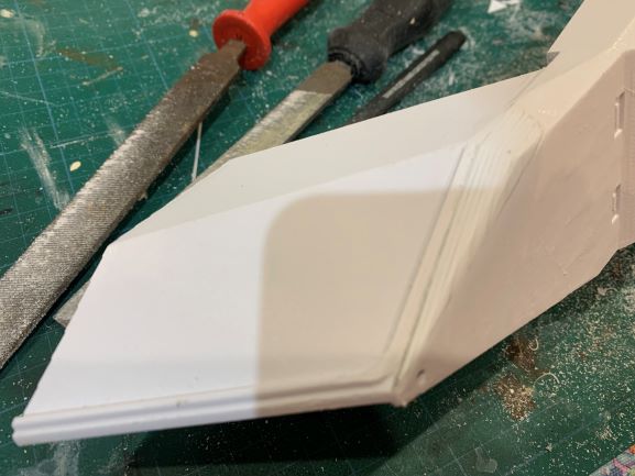

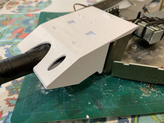

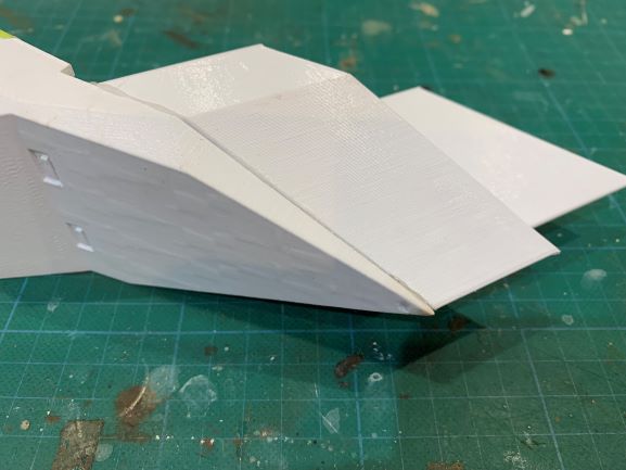

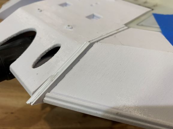

I had a good amount of free time this week end, so I able to make some progress with the turret conversion. I wanted to get to the point where the spaced armour and extended turret bustle were ready to to permanently fixed to the original 2A4 turret.

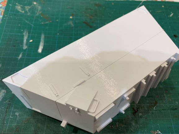

During the week the first batch of printed arrived from the printers. The parts, less the basket have been printed in "draft quality" to cut down on the cost of 3D printing. This level of print quality results in fairly a rough surface texture but given the majority of the parts will be covered in camouflage panels, the surface finish is fine. Where the parts are exposed, the the surface will be sanded smooth or where sanding is difficult, covered with thin styrene sheet. The side armour pieces were attached to the separate front pieces with two part rapid set epoxy adhesive.

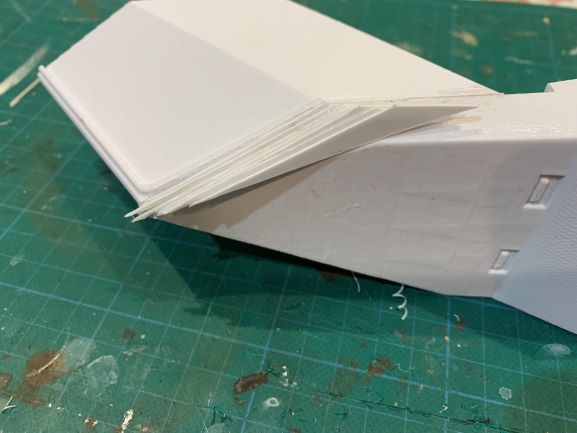

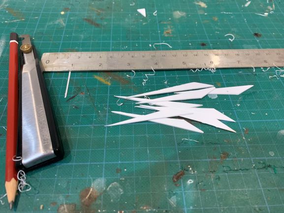

Despite having measured and re-measured and then measured again, there was an annoying error in the angles and mismatch of the left side armour and left front armour. The solution to fix the miss-matched angle was to use styrene sheet cut roughly to match the correct angle and file and sand to size.

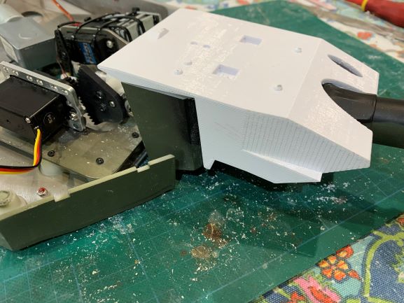

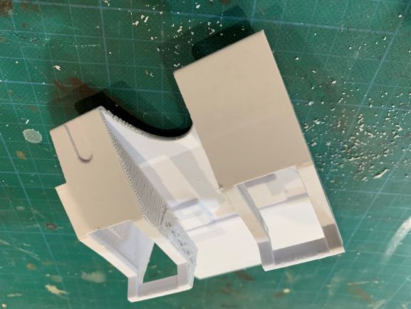

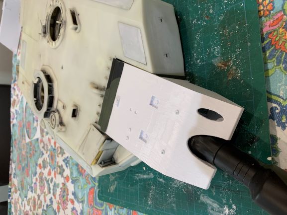

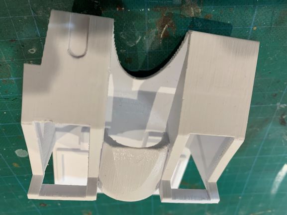

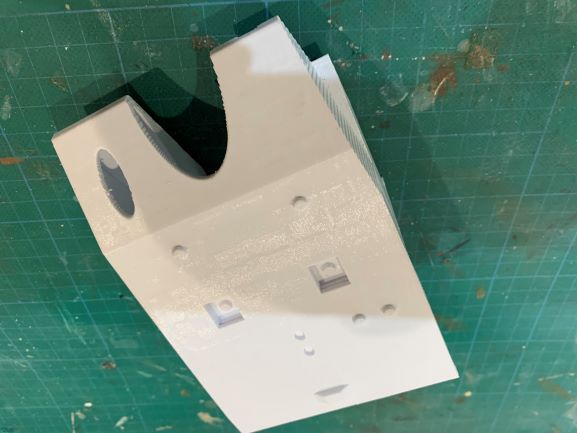

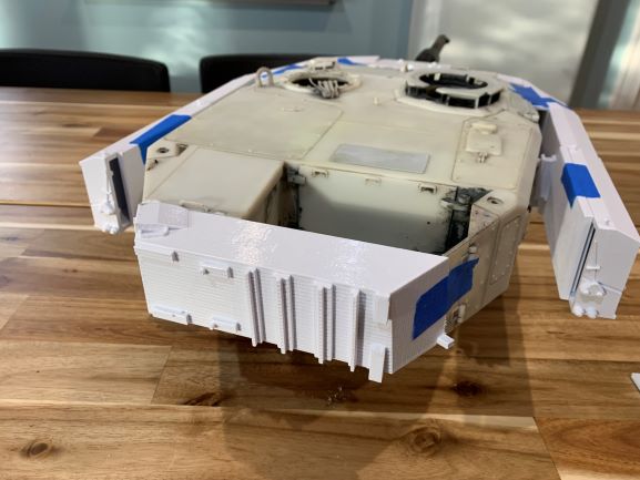

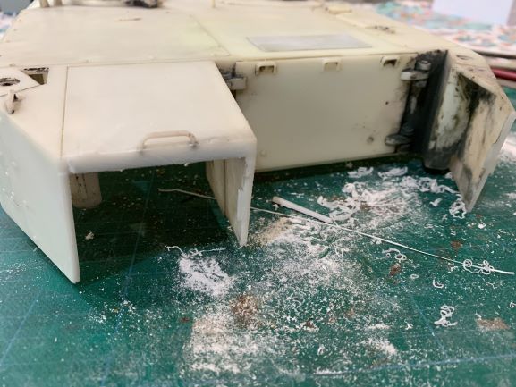

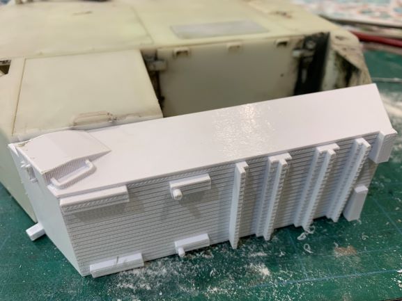

The next part to be tackled was the turret bustle. When I originally planned this step I wasn't sure if I would need to replace the entire rear of the turret or just add the additional storage. The original Canadian Leopard 2A4s came from the Netherlands with an extended rear turret and Leopard A5/A6 style baskets.
Ultimately, I chose to add just the extra storage rather then the entire 3D printed turret bustle. This meant cutting the extend turret storage away and fixing it to the original 2A4 turret.
Once again, what looked like a simple straight cut wasn't that simple because of the angle of the turret rear plates.

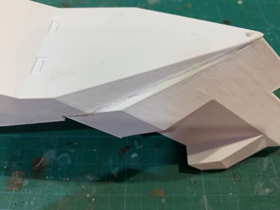

Cutting through the large 3D part was also more difficult then first thought. Aside the general toughness of the printed plastic, the interior honeycomb support structure was also hard to cut through, even with a new razor saw blade. The next step was very much the point of no return for this project. To fix the extended turret bustle to the original turret meant cutting of the back of the turret. Up until now I had not touched the original parts of the tank, or anything that I had removed could be easily restored. Now I needed commit absolutely to this build! The next part for surgery was the extended spaced armour mantlet. Based on a 1:35 part, it turned out that I had included the assembly structure for the 1:35 model - entirely redundant on this model. The 3D part has the top of the original turret mantlet incorporated. Again, a choice to be made about what part to cut away.
I choose cut the top off the original part and fit the complete 3D printed part.

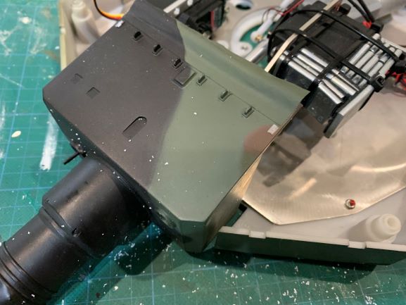

- Turret mantlet with the top removed.

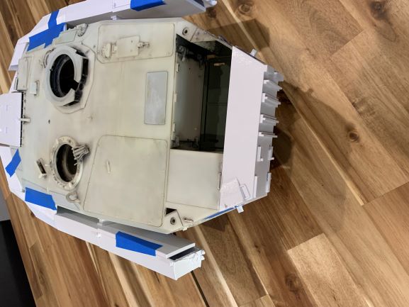

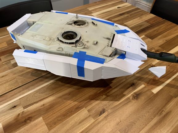

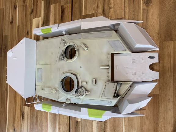

The following images show the printed parts dry fitted to turret.
The next step will be to permanently fix the parts. This will involve adjusting the side armour so that it is parallel with side of the turret while leaving sufficient space for the smoke dischargers.
Re: Hooben 1:10 Leopard 2A4 build log
Good progress, minor issues and some rework are to be expected. Turret add-on armour is so complicated and risky. When I did the Mexas on the Leopard C2 build, each side of the turret armour had 25 asymmetrical facets that need to come together in 3 dimensions. One bad angle somewhere means impacts to many other areas, and rework. When you do plasticard, there is the benefit of being able to see issues and correct on the spot, and integrate the armour with the vehicle in a telescopic fashion with constant checks and dry fit. With expensive 3D printed parts, it’s difficult to plan and see everything at the design phase. Looks like you have only a few minor issues... it’s very good.

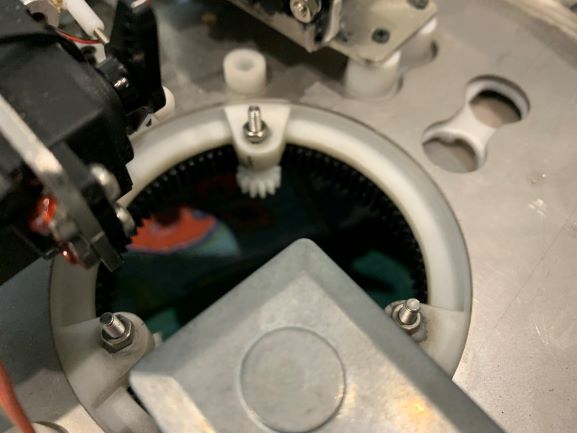

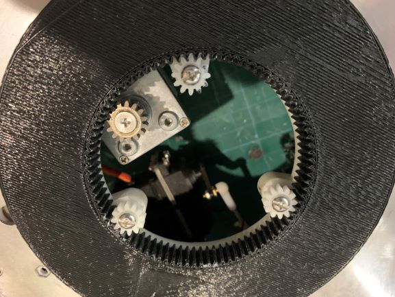

I have solved the turret mounting issue by installing three pinion gears on to the attachment points for the original turret drive gear. The pinion gears create enough friction to hold turret in place while at the same time allowing smooth turret traverse.
