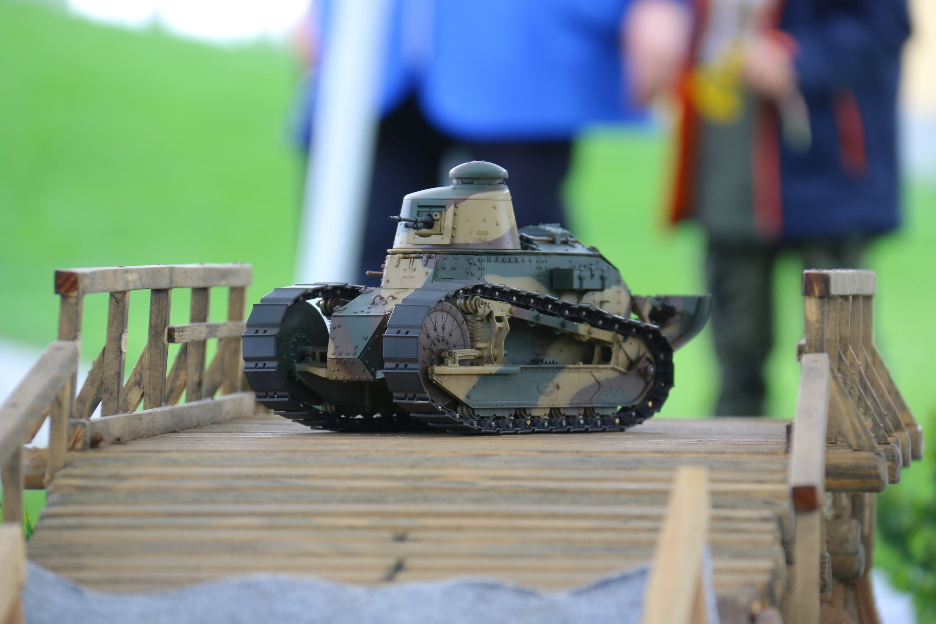

Test drive:

That is just excellent Kaczor :clap: very well done on a great looking little tank :thumbup:

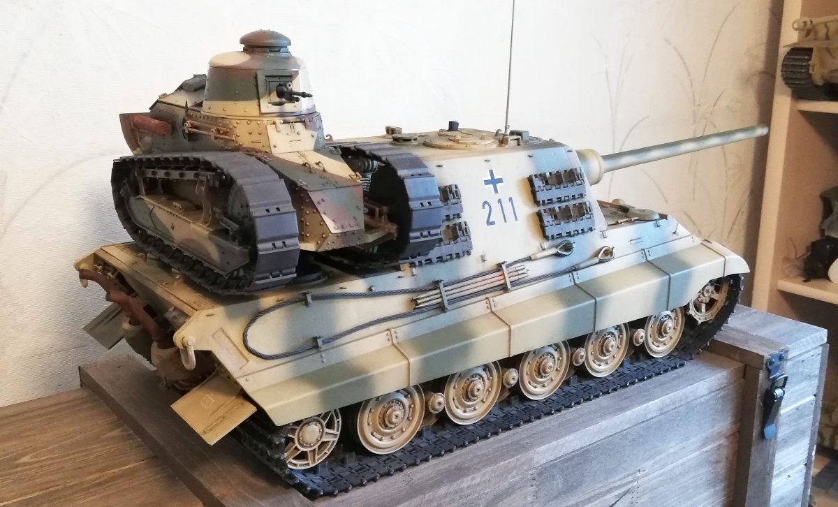

Bonus ;)

That’s a hell of a picture mate!
Just highlights the evolution of AFV’s in a short time

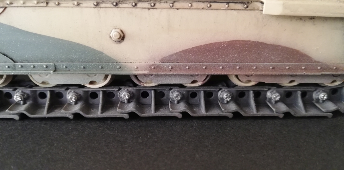

After several meetings where the trak links broke, each link has a pair of small screws on both sides, 130 in total ;)

Great fix Kaczor :D especially for rough terrain as the tracks do seem to have a lot of side movement play which doesn't help with the stress on them. What size screws did you use ? may try it myself :thumbup:

Those are from some glasses repair set from Aliexpress ;)

I just did the same thing for my printed M18 Hellcat tracks. 80 track links per side and two screws per link.... :crazy:

We had a little local meeting today and after the tracks were repaired it runs great.
