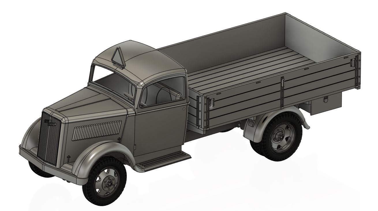

I have a 1.5t Blitz at the test print stage, but whether Will thinks its up to his standards is another matter...
