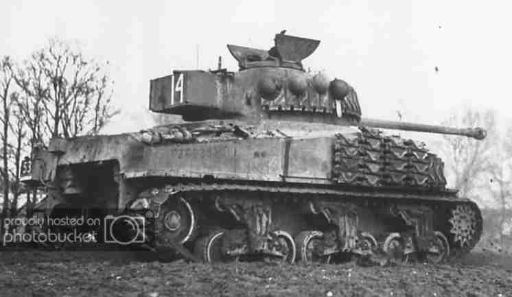

firefly high bustle.jpg (30.81 KiB) Viewed 1769 times
FYI Vandra and forgebear are out of kits and won't have anymore. I only have a couple left and am attempting to put together some more put prices just keep rising and rising. I have sold over 100 kits now so perhaps it has reached builders saturation point for now...

dgsselkirk wrote:oh, oh.... :D
Oh, that is a very rare picture of an M4 Ic Dean, although the top of the bustle looks sloped like a low bustle, the clearance underneath would imply a high bustle.
Well, I stand corrected. Although what Roy was saying about more high bustle than low is incorrect. And the earlier picture is still a low bustle.
