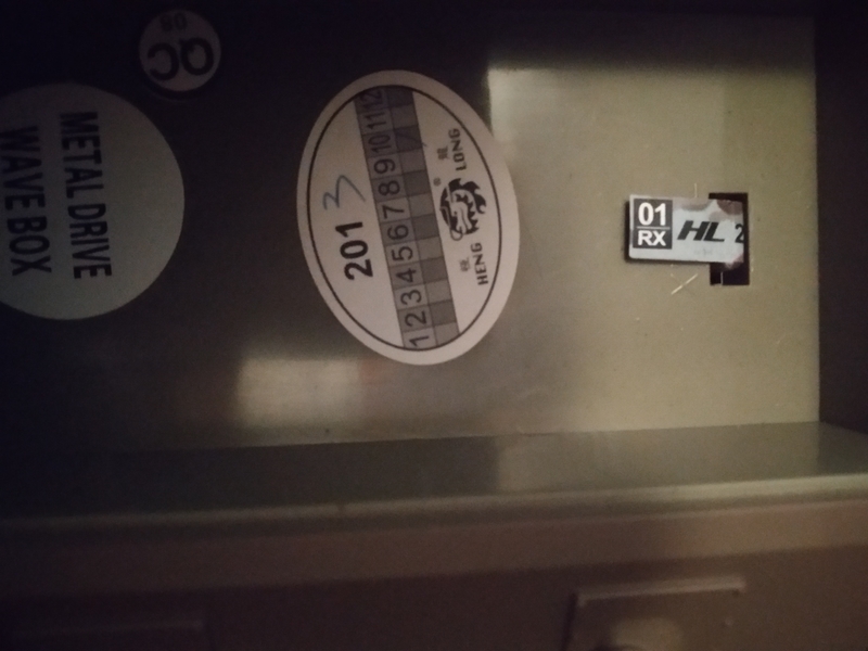

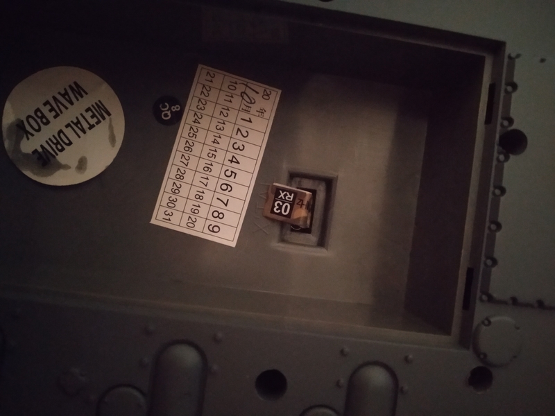

Son of a gun-ner wrote:Binding is for 2.4 gig equipment.
You have the older crystal and ABC set ups, they should always be compatible providing both the tank and controllers are the same, as in, both on same letter, or both have same numbered crystal, with the Tx in transmitter/controller, and Rx in the tank.
Thank you for the answer.
I know how the crystal look like its underneath the tank.
I need to check in the controller.

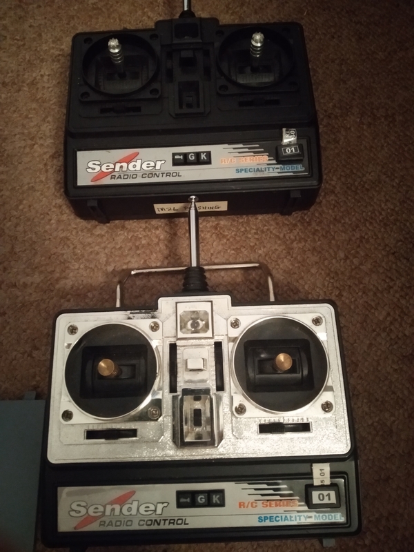

Son of a gun-ner wrote:Also, if that is the case about the panzer 3 and the Pershing controllers having the number 01 crystal, it would be a good idea to try the panzer 3 controller with the Pershing, that way we can find out if that controller is working.
Thanks.
Im working now and to this in the weekend.

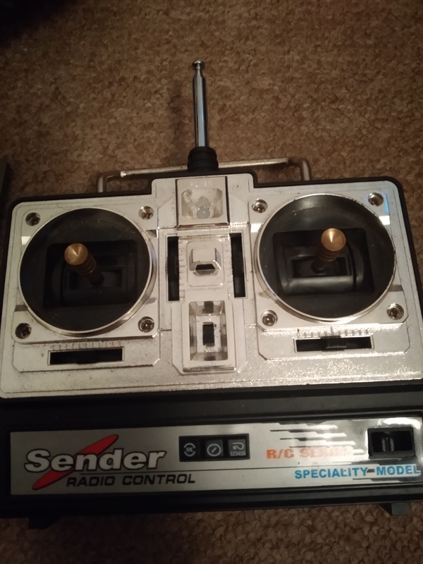

Hi
Thanks for the explanations. Thats more knowledge.
The tanks and controllers are from auction house and they can be mixed.
I know now I have to check the crystal between tank and controller got the same number so they not mixed.
Hi
Thats the crystal from panzer 3.
not a surprise its not working
who anyway work in auction house to give people wrong controlers

Does crystal 1 will work with abc controller.
Tank its not starting
