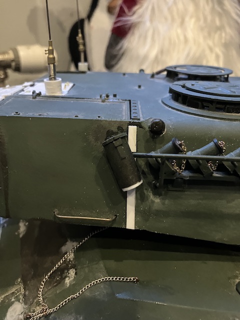

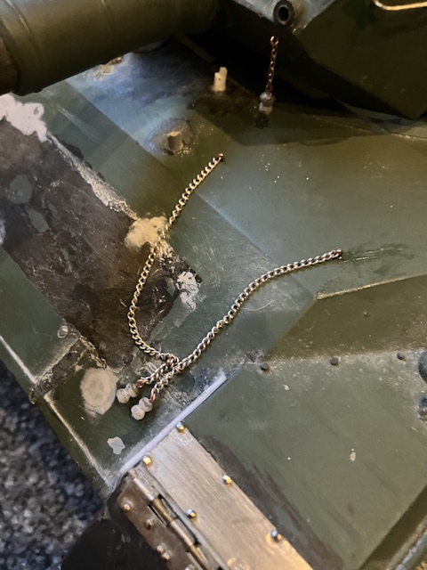

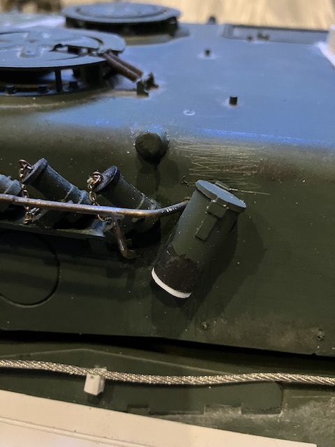

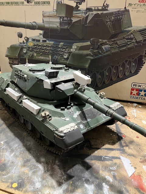

Had a productive week with the Leopard 1. Been installing some missing details, like the mantle lifting point and the deep wadding plugs for the machine gun, and gunners sight.
Also installed, by modifying the original parts, are the turret bins on the side for the flags. I have also have to install the tubes on the turret for the flags. Also seen are the turret lifting lugs, which I installed incorrectly thirty odd years ago, and finally made good.
Magnets have been fitted to hold down the top deck, which look so much neater than Tamiya’s original fixings with screws.

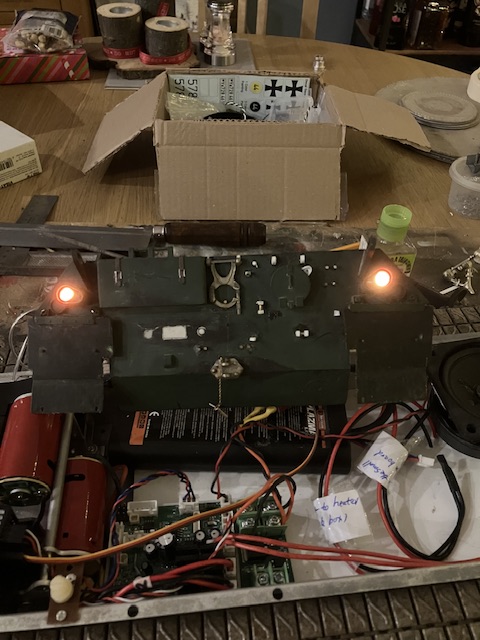

A job I have been putting off is the lighting. The rear lights have been mocked up. Tail lights, and convoy lights. I used some old Christmas lights,and fibre optics. By happy coincidence the lights can both work off the same circuit, but switch off the same switch on the transmitter. The back lights should be split into tail, and brake lights. But that is a bit too difficult for my mediocre skills.

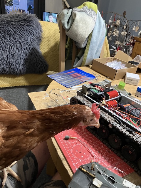

Assistance was not given in any way by our house chicken, Squeak. I don’t even think she was particularly interested in the work, more the food that was about.

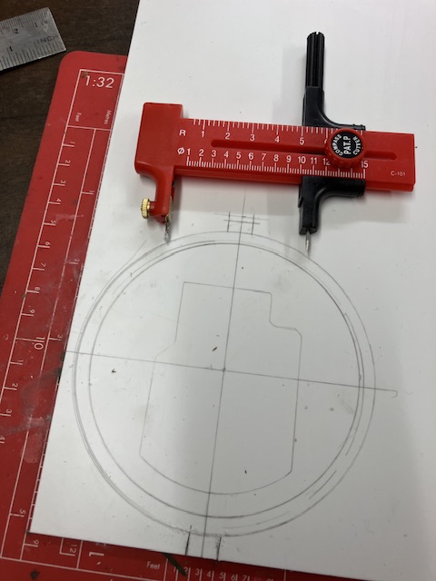

One of the jobs I had not been looking forward was getting the turret to rotate. First job was marking out a base for the turret to sit on, which doubled as retainment for the turret.
With careful measurements the turret ring was centrally positioned. This was carefully trimmed to allow for elevation and depression of the main gun.

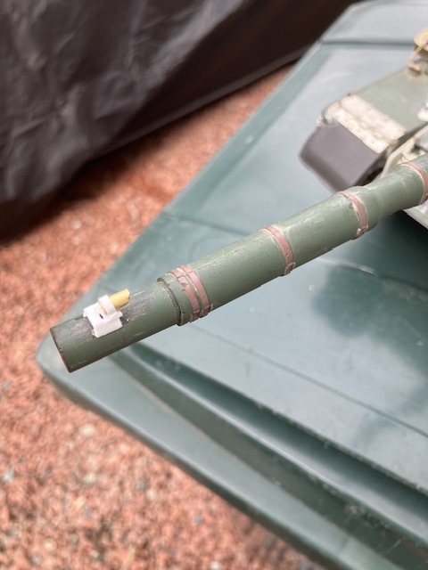

One thing I have found locally is a modelling group. Most are building plastic kits, and find someone building an RC tank, without the use of plans quite fascinating. This week I managed to build the spotlight for the gun mantel. This is a scratch build aid, as is a lot on this tank. Building this taxed my skills as the more I looked the more details became apparent.
It was finally attached.
This is how the model looks.
And this is the end goal.
It has been tested (played with) around the garden, and it performs very well.

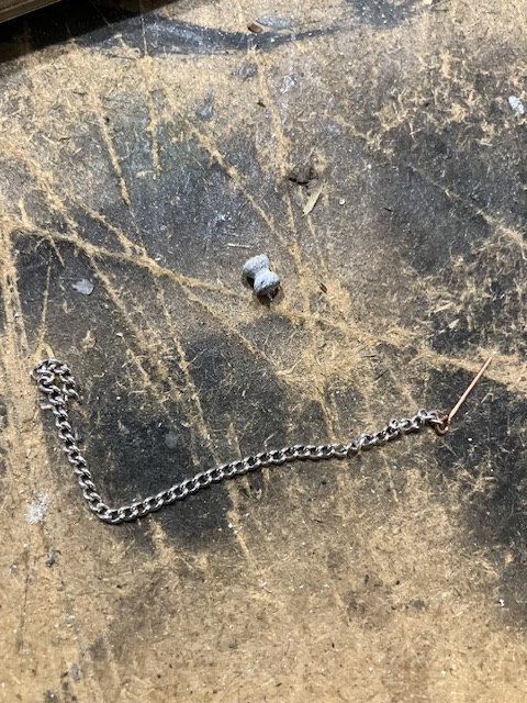

the chains on the details look a bit too thick...
There are thinner ones, wich look better:
Meter rat
Posts: 1968
Re: Another Tamiya Leopard A4
Post by Meter rat »
jhamm wrote: Mon Jan 13, 2025 5:14 pm Hi,
They will do for me. There will be a lot of inaccuracies, which can live with.

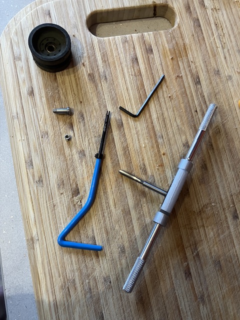

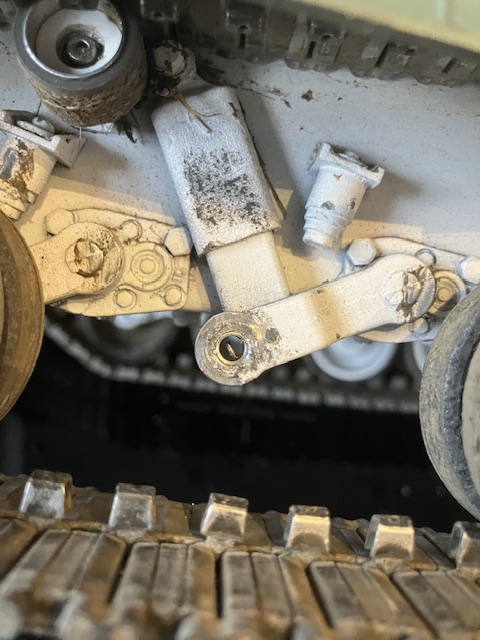

Some small problems have developed with this. First issue has been to repair a thread I damaged when tapping out to attach the wheel. Trusty thread repair kit came out.
Now the turret, and lights have stopped working as well.

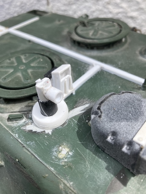

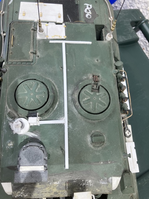

Had a bit of time away from the shed/workshop/garden room, so had a couple of hours on the Leopard 1. Scratched up the commanders surveillance sight, switch box for the searchlight, and periscope. Rebuilt the collimator, and installed the turret roof conduit.
