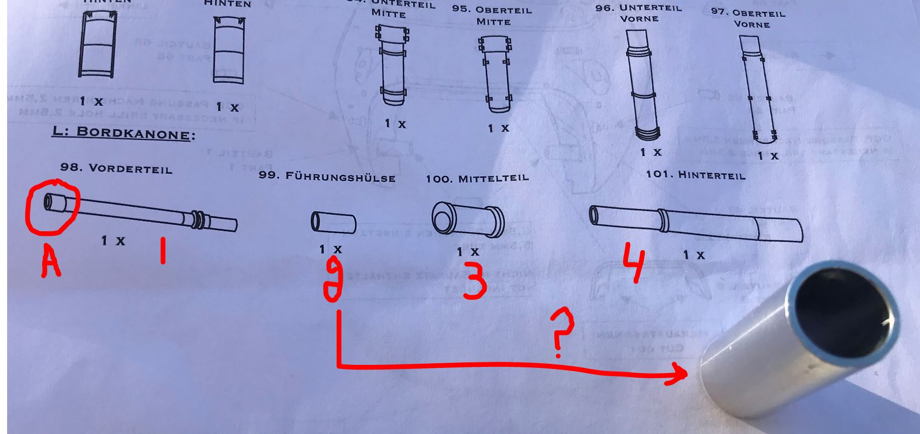

BarryC wrote:You missing barrel part made me go check my kit and all 3 pieces of the barrel are present.
Hi Barry,

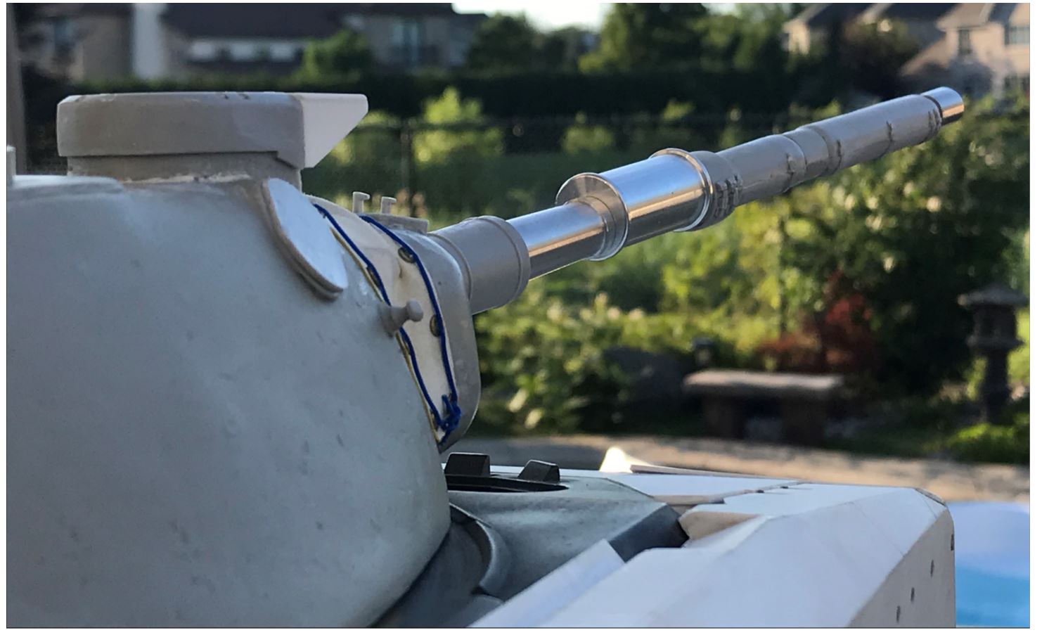

I have 4 parts for the gun. If we look at the picture below and the numbers in red, part 1 is there but is missing the larger muzzle at the tip (A). It seems that it should have been made when they turned the barrel on the lathe. I re-created the larger muzzle by overlaying a 10mm aluminum tube at the tip. As for part 2, a huge 40mm long cylinder, i never found a use for it, or a way it could be used to facilitate the recoil through the mantlet.

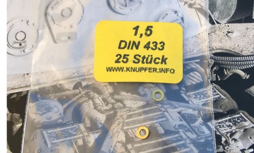

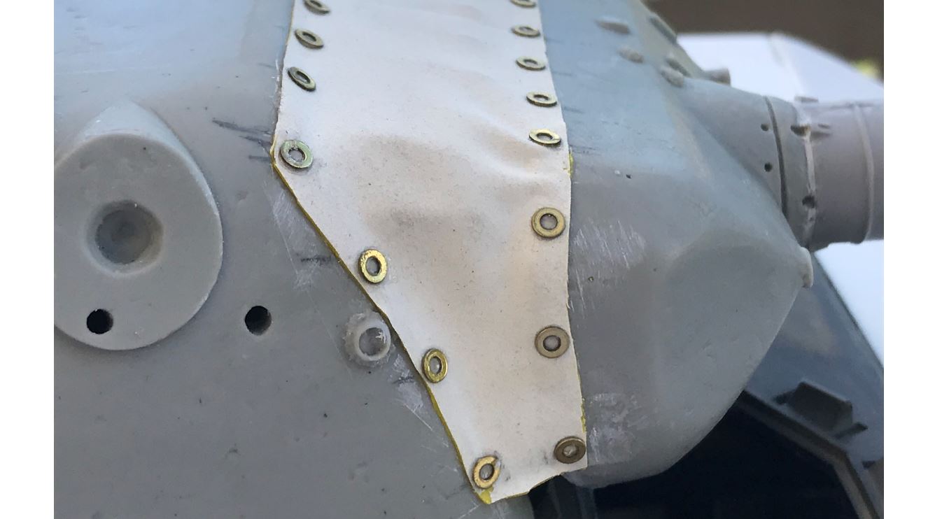

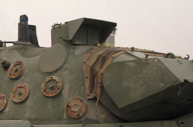

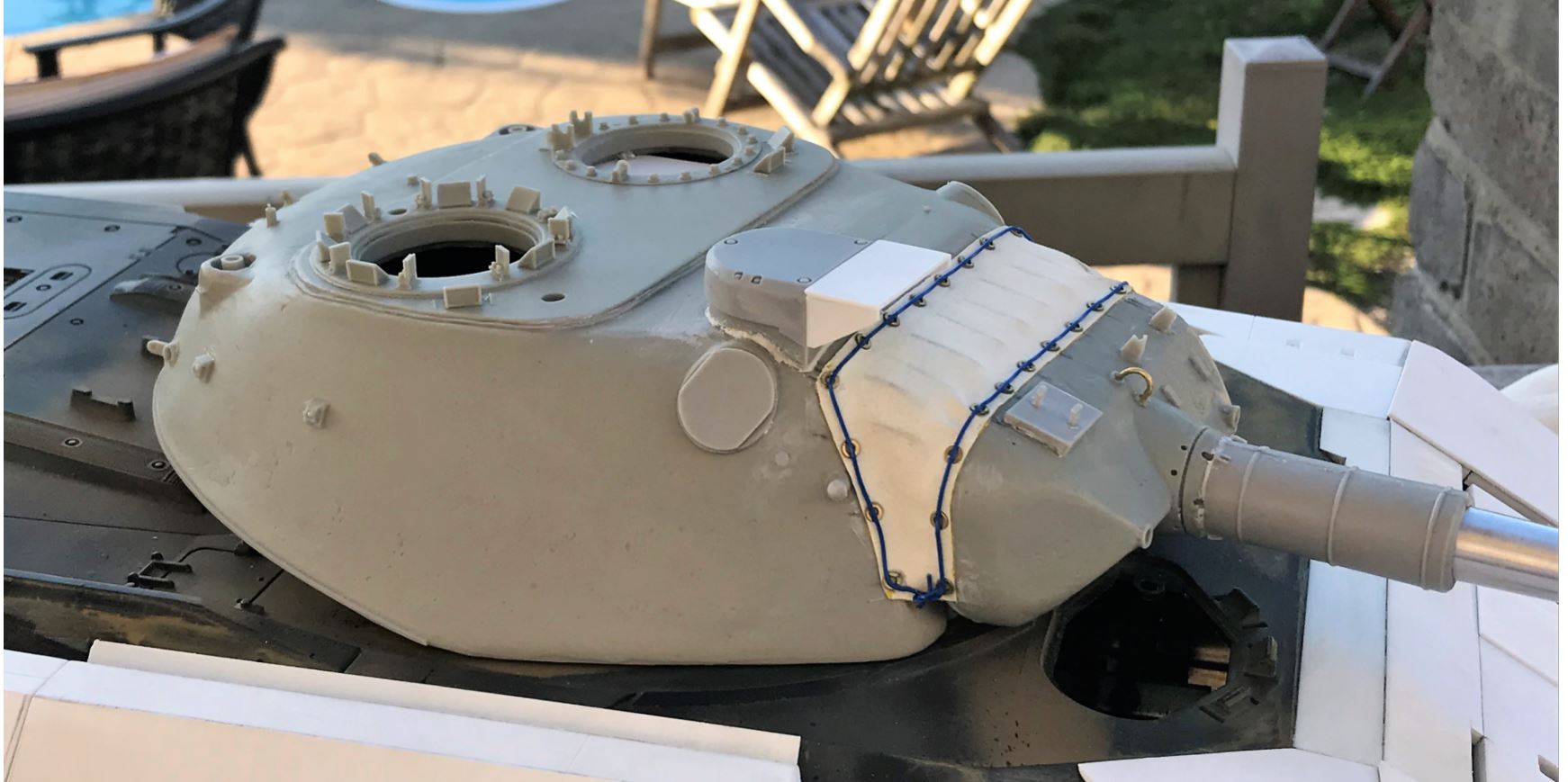

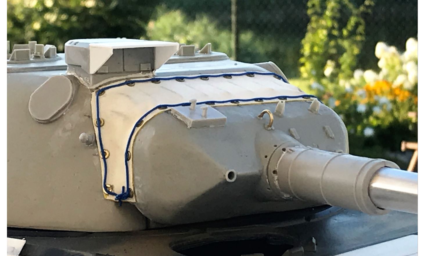

Here is another close up of the canvas cover. These holes should not be made on the canvas as it would weaken it. Let's use small washers instead to represent them.
RC 1/16 Canadian tank Leopard C2 Mexas - Afghanistan - build

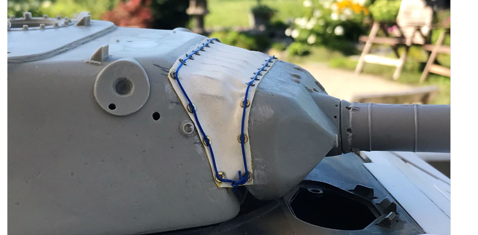

These are the Knupfer M1.5 washers that i had leftover from the TPZ-1 build. I could probably order thinner ones if available but it would take weeks. These are good enough.
They are superglued to the canvas.

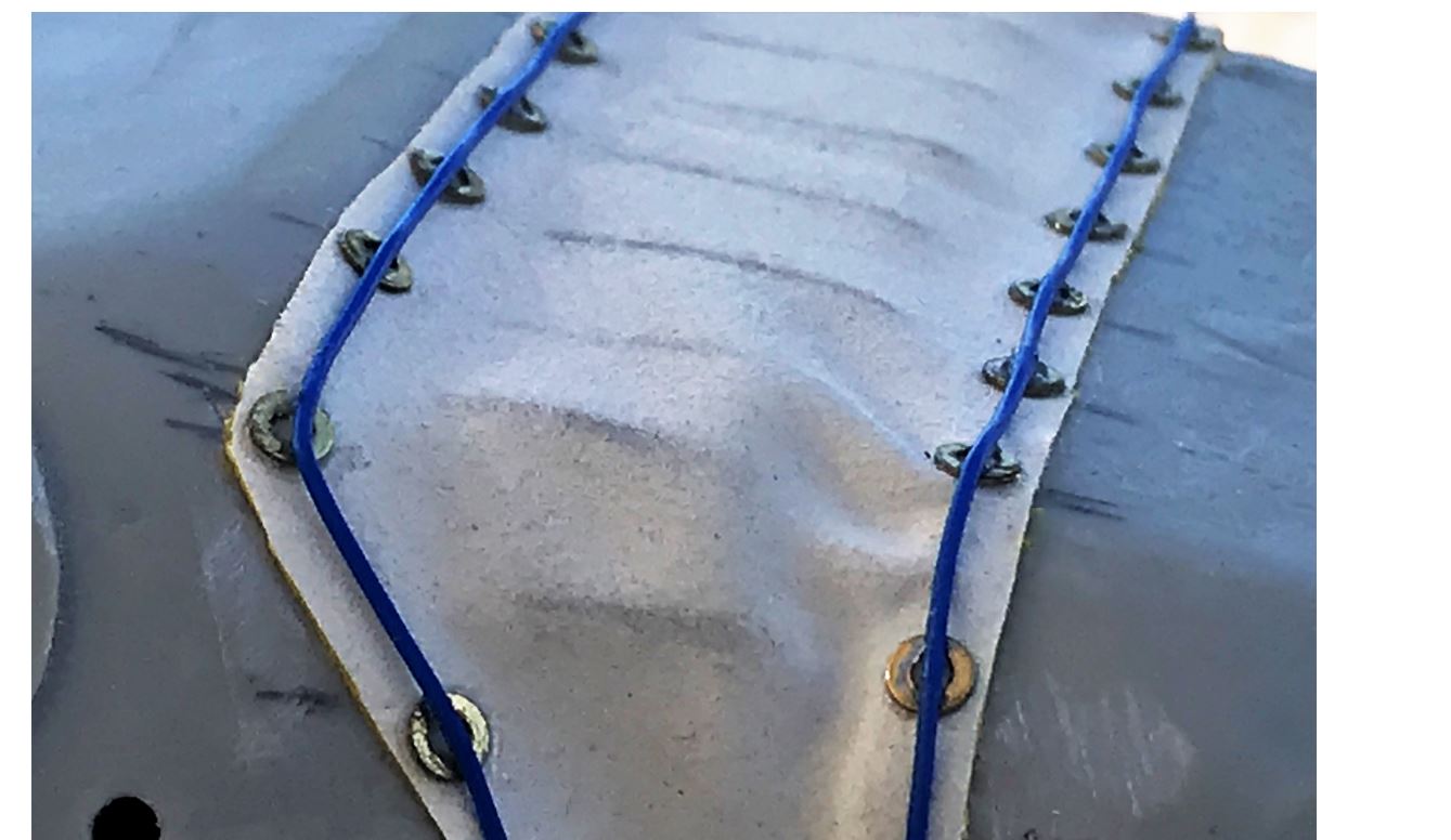

Then a small electrical wire is run across the canvas, and a knot is done at the bottom, as seen in the earlier picture.
I am still wondering if it is worth making the little eye inside each washers, they would need to be so small.

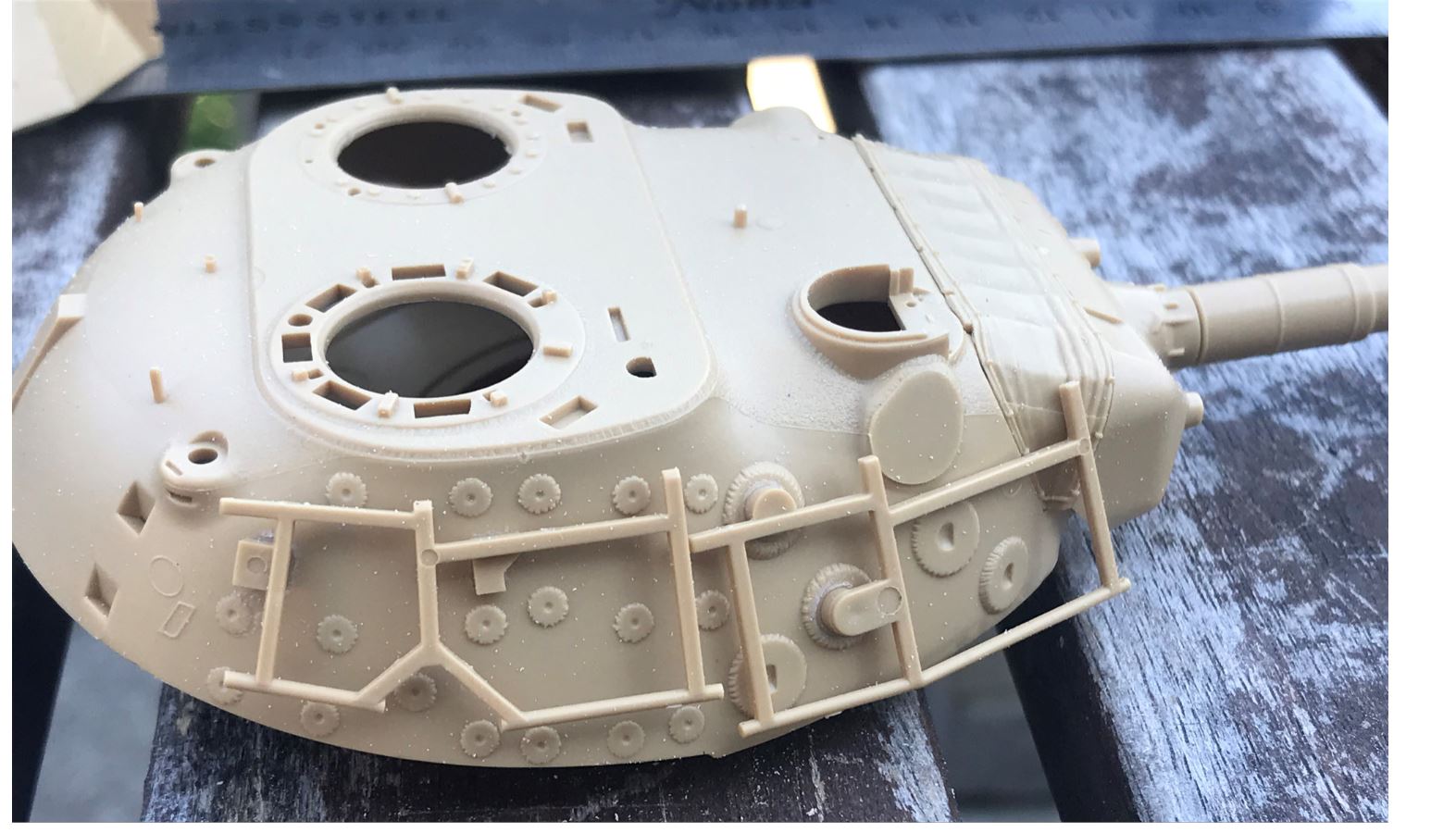

The 1/16 Perfect Scale Modellbau turret correctly features the plates over the bumps for the 1A5. However, the parts for the bumps are included in the kit for the modellers who want to reproduce the Leopard 1 A1A1 version. Its too bad, they are looking great. The sun shade for the EMES 18 housing was created with plasticard.

The work on correcting the malformed resin turret was done very smoothly. A mess like that would have made me seriously reconsider using the turret at all. You fixed it perfectly.
Hi Barry,
Regards, Louis
I understand now and mine is the same, missing the thickened barrel crown. Looks like I'll be making another note, add 10mm tube to list of needed materials. :thumbup:
regards and following along,
Hi Painless,

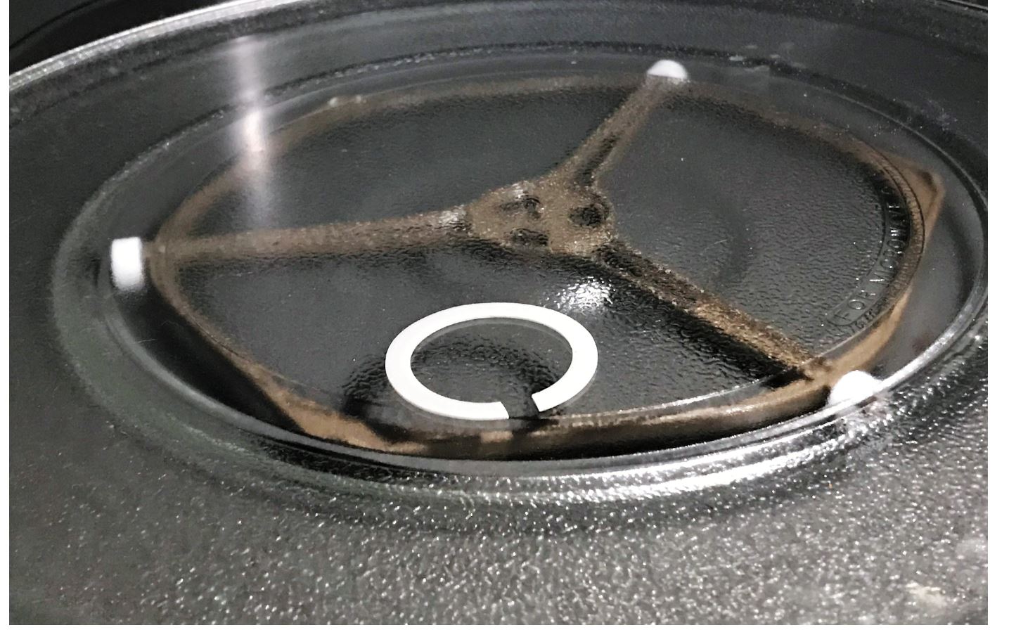

I'm used to resin and i learned how to take control of distorted parts. Its easy to blame the producer, complain about quality control and ship back items. But where does it leaves the builder. It is much more pleasant and easier to simply throw the part in the microwave for 30 seconds or more, fix it and install. The trick is to warm it enough to be flexible, not cook it. My fun out of a complex build is to get over issues whatever they are and move on.
Below is a Leopard turret cupola ring getting the flattening treatment in the microwave.

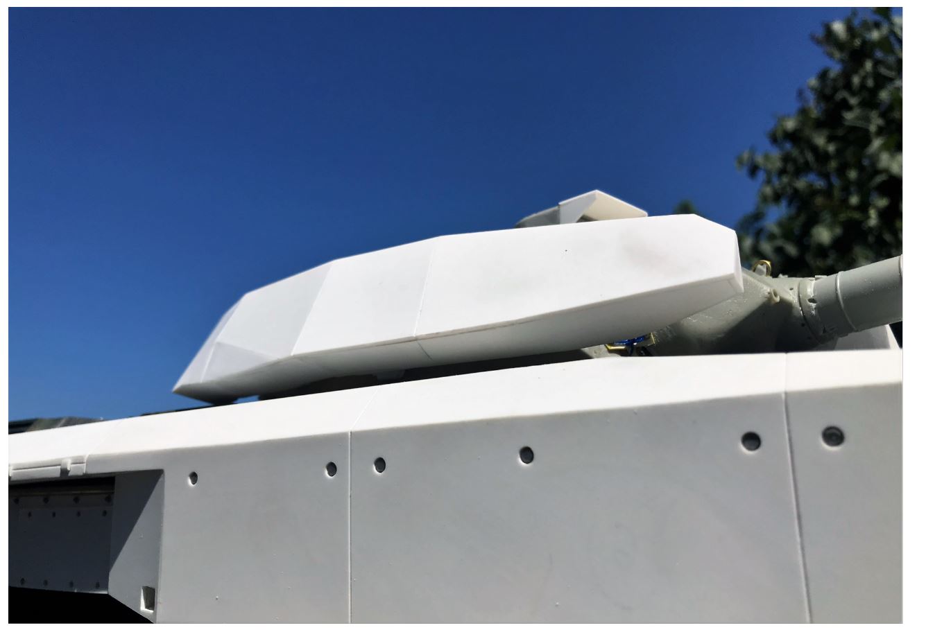

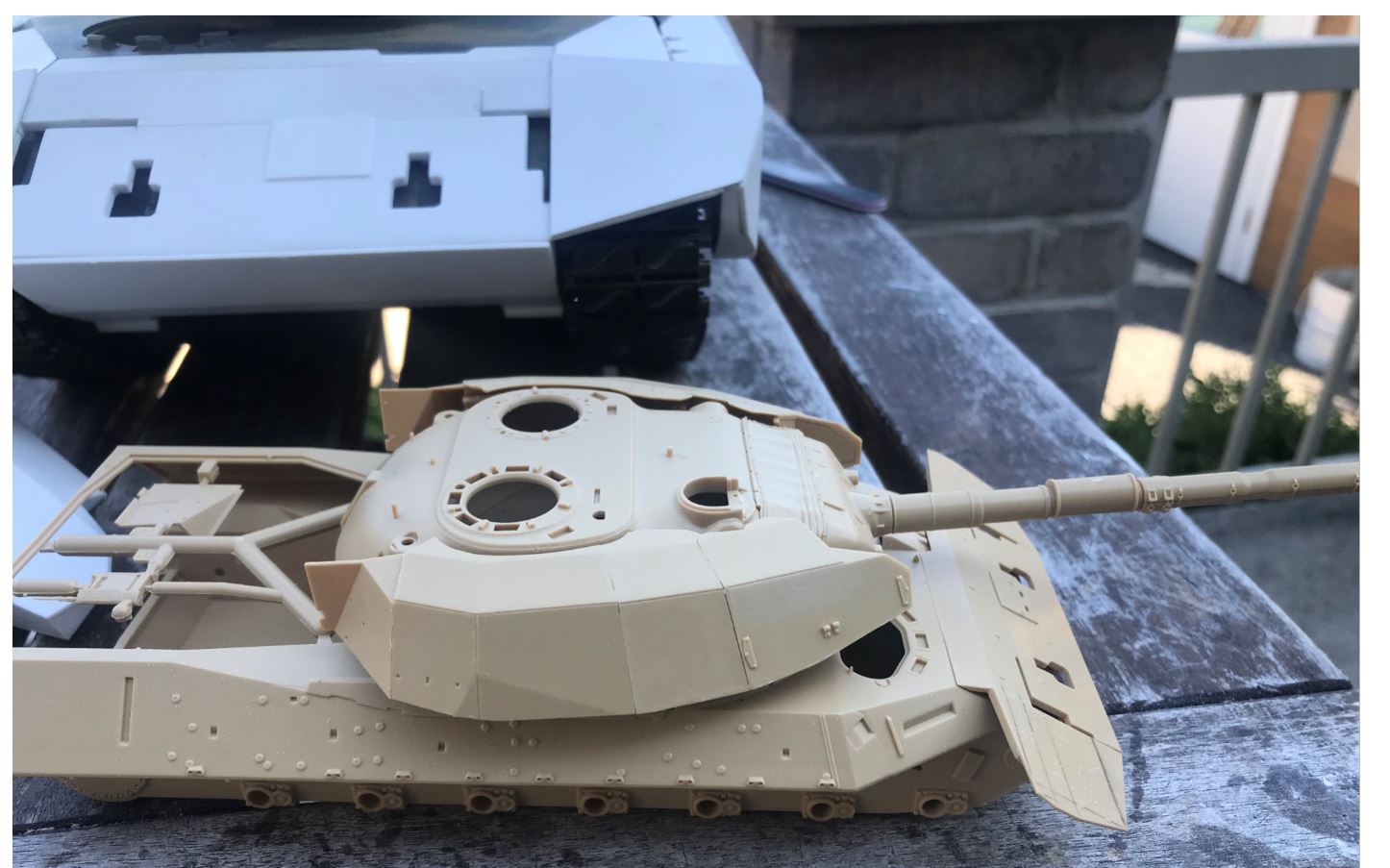

The dressing up of the Leopard C2 Mexas turret can be organized in 3 main components.
First, the MEXAS modules on the sides

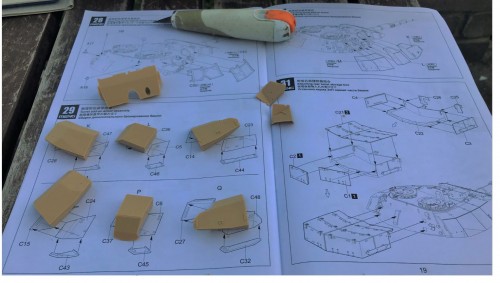

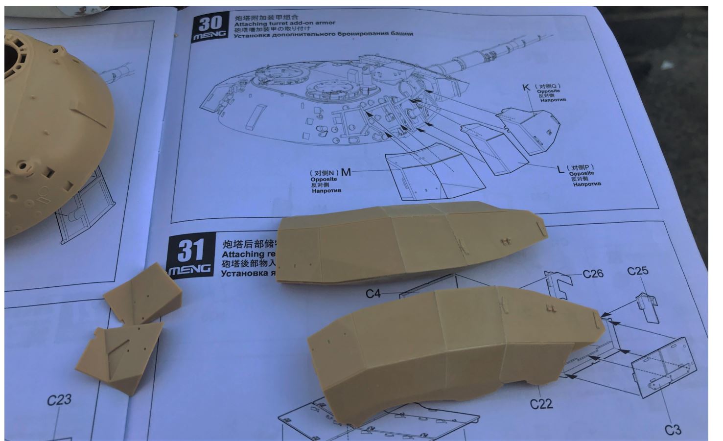

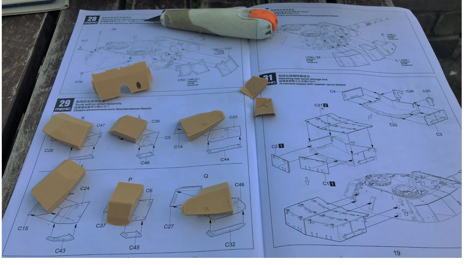

Let's start with the Mexas. Each side has 4 main modules. Construction of the Meng 1/35 kit is providing me with shapes and measurements.

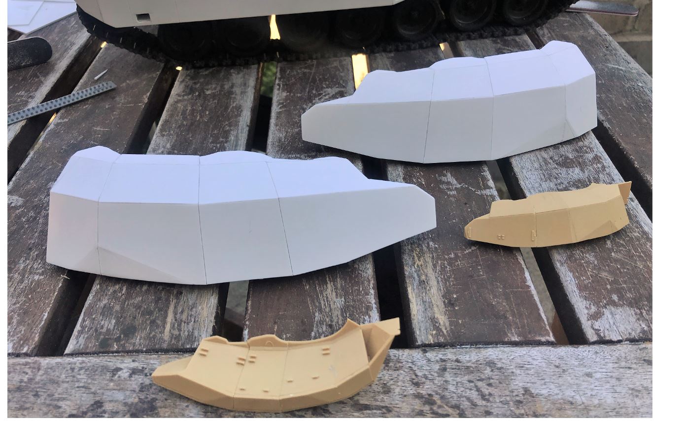

The Mexas is complicated. It is simpler to built the Mexas side as a whole instead of trying to recreate the individual modules with the hope that they will eventually come together. Each sides has a total of 25 visible asymmetrical faces, with construction and angles in 3 dimensions, and you have to make 2 exactly he same. Unless you want to spend months building this, redoing everything 3 times or simply give up, it is better to do exactly what Meng provides in 1/35 and extrapolate to 1/16, including following all angles during the assembly. The slightest deviation will cause trouble sooner or later in the construction.

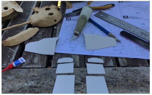

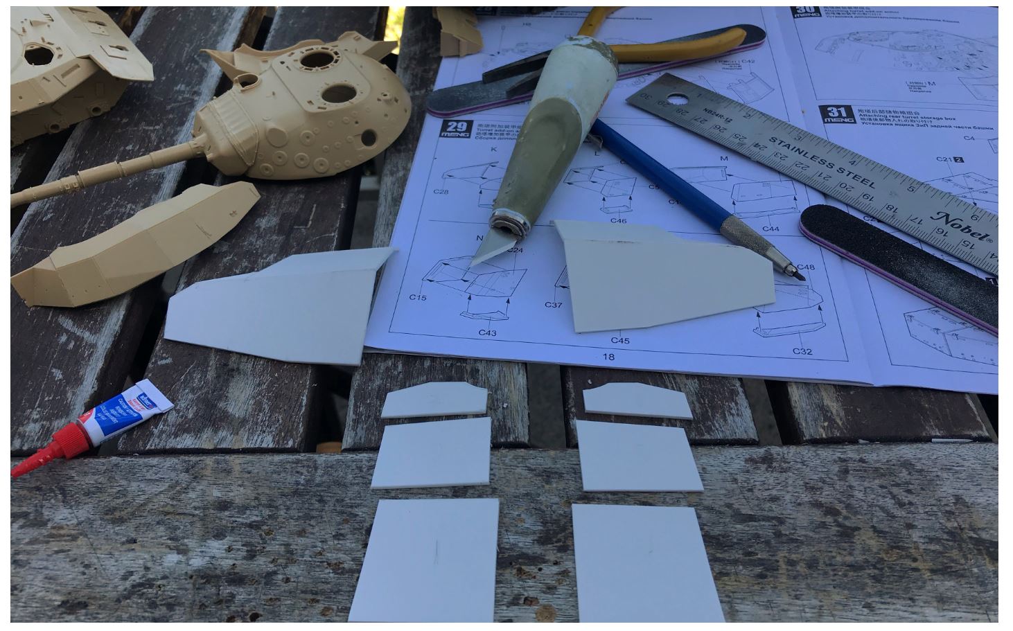

The construction is attacked in a telescopic fashion, from the front modules to the rear. Everything is done with 1.5mm thick plasticard which is a good compromise between rigidity, easy of cutting (snapping), sanding and gluing.
Once a part is designed and cut, an exact copy is made for the other side.
This is a messy operation with plasticard residue and sanded dust everywhere on the floor. It is done outside in the summer shade and the deck is water hosed after. Its not difficult to do, just need to sunk in the hours.
After 8 hours of construction, the Mexas side modules are ready. Lines between modules are scribed.
Meng did reproduce the way the Mexas is mounted on the turret, useful when showing the tank under maintenance. As it is all hidden, there is really no purpose in reproducing these mount points for an RC tank.

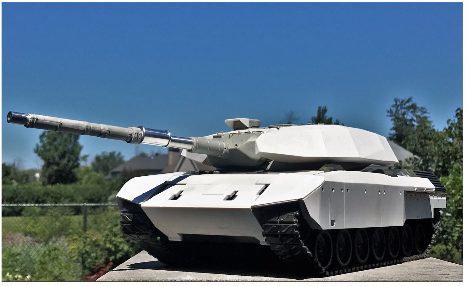

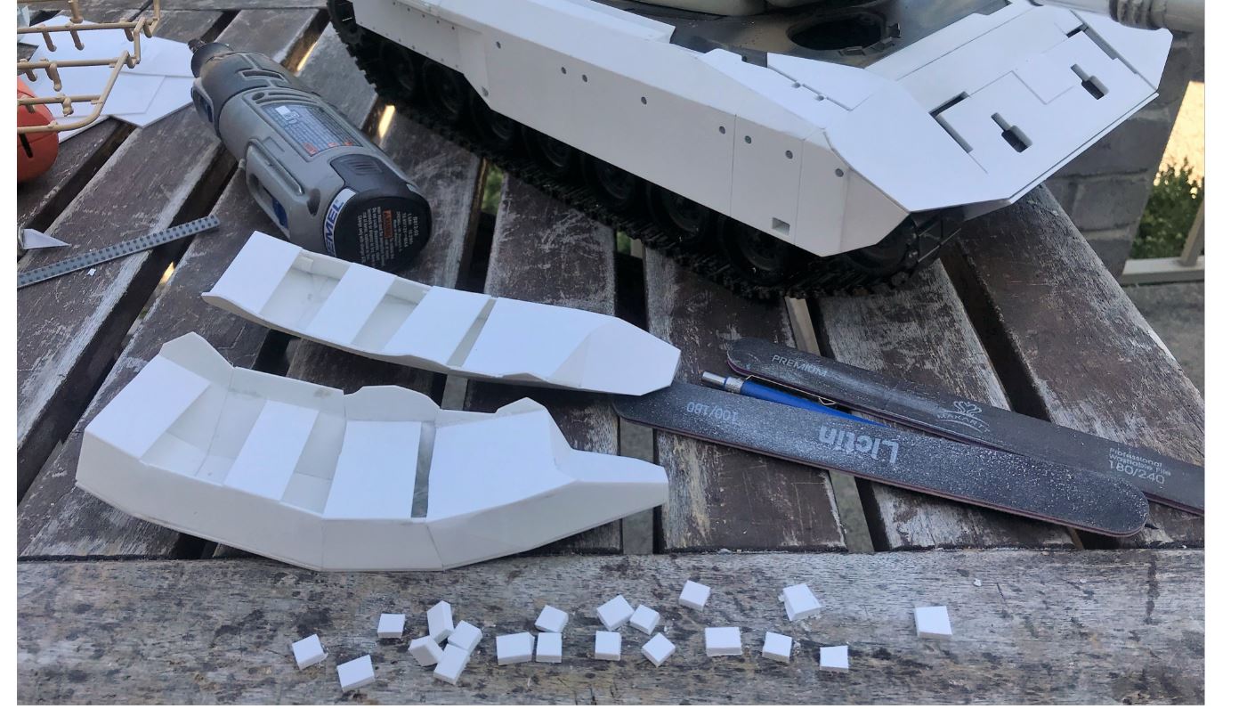

3mm plasticard squares are made and ready to be used as hidden mount points between the Mexas and the hull.

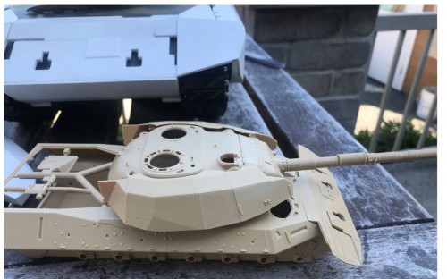

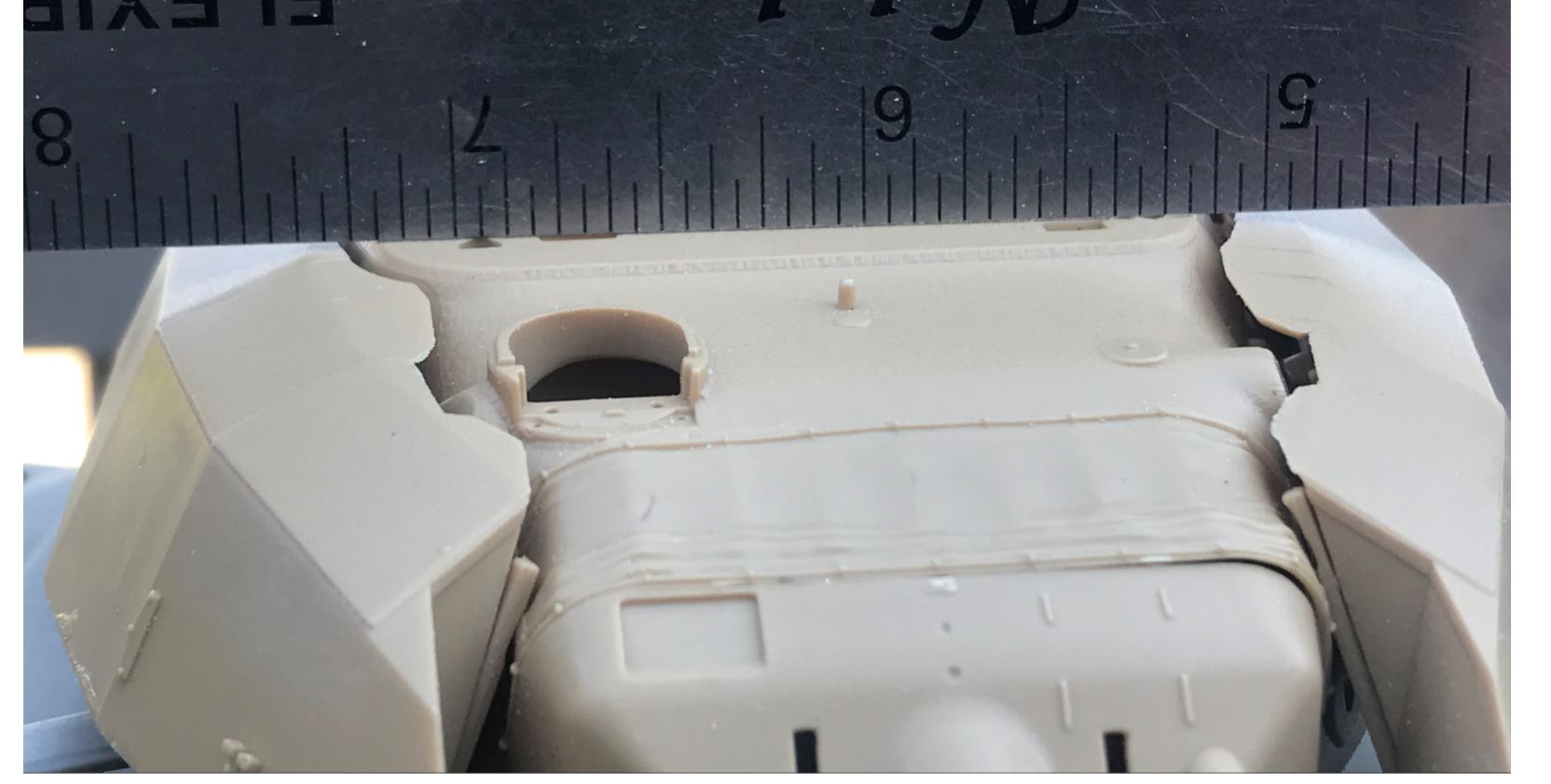

The Meng modules are mounted to provide positioning specifications.
The 1/35 model is studied and basic mounting directions are extrapolated for the 1/16 model.

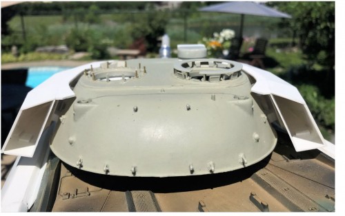

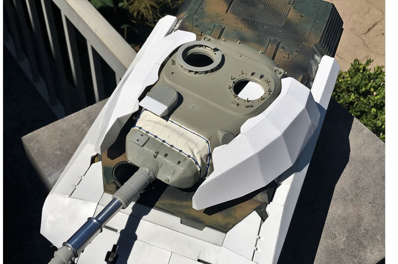

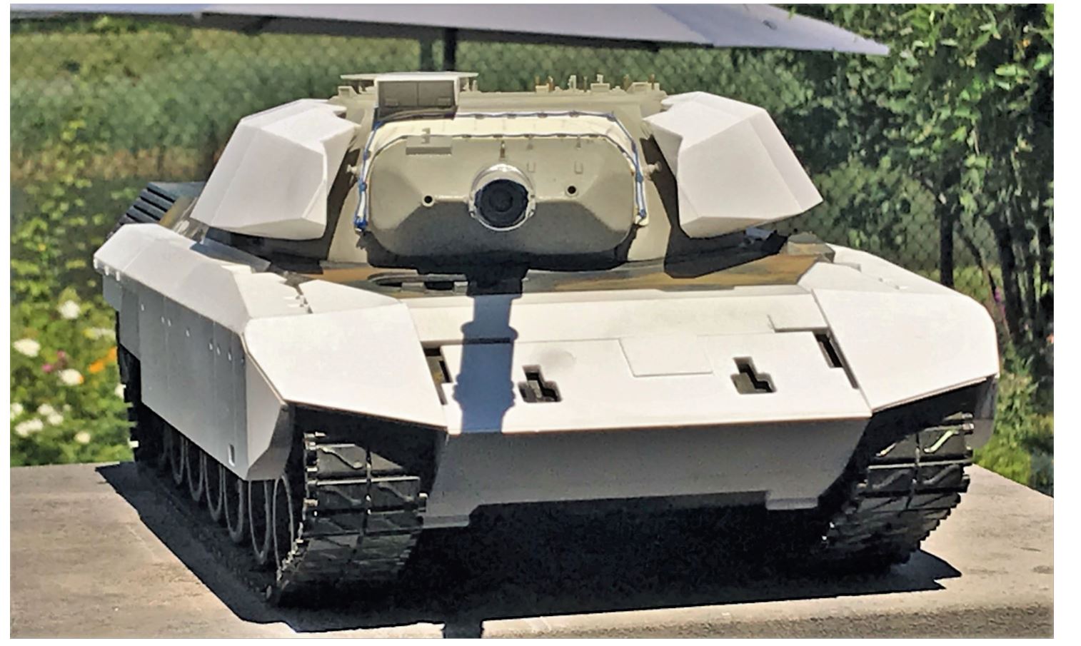

Here is the Leopard C2 with its turret side Mexas modules mounted. I made sure there was 105mm between the side tips for the mantlet.
The rear panels that connect to the rear bins will be done at the same time as the bins.

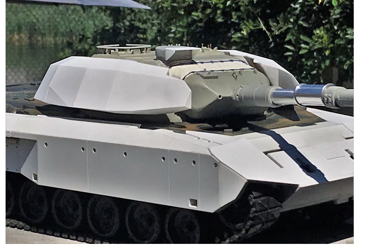

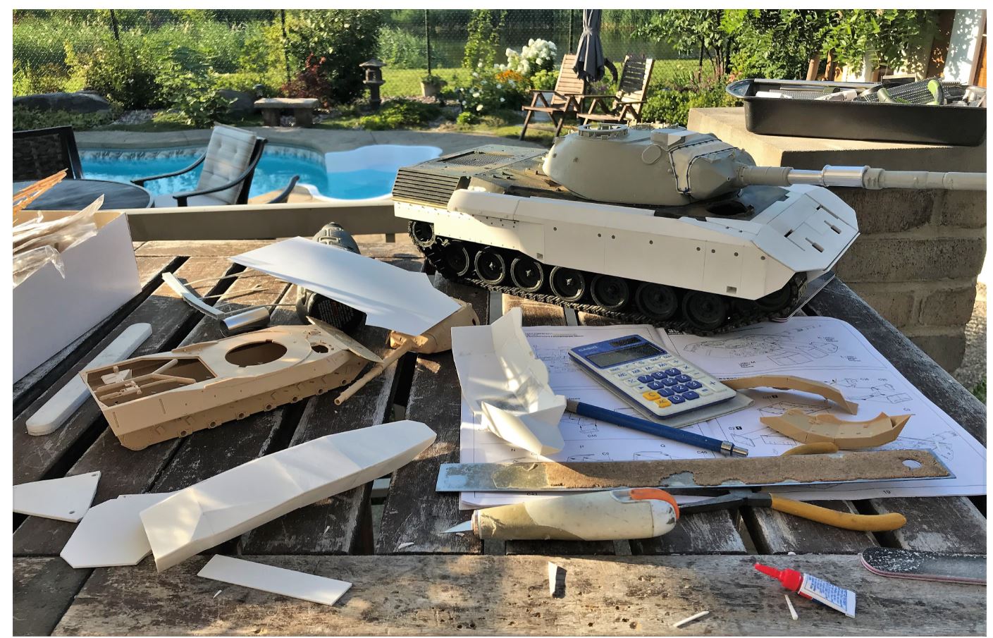

Overview of the model as it stands today.
Regards, Louis
