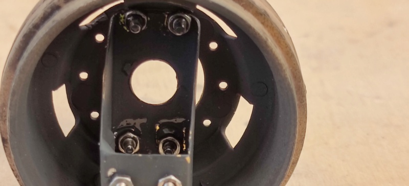

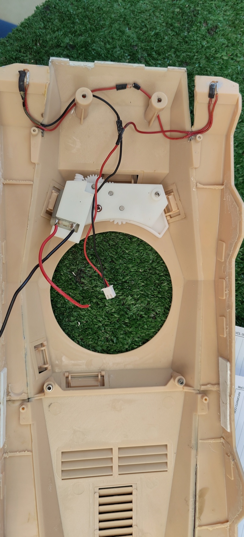

Hi Fabio,

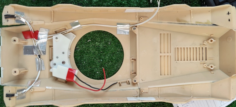

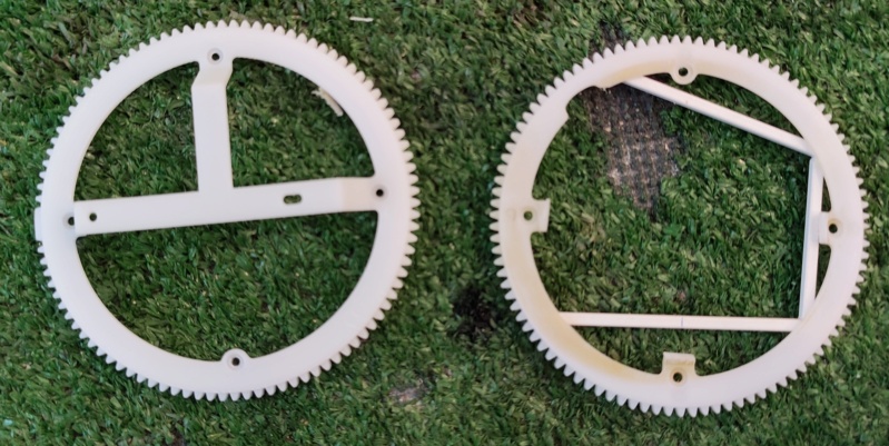

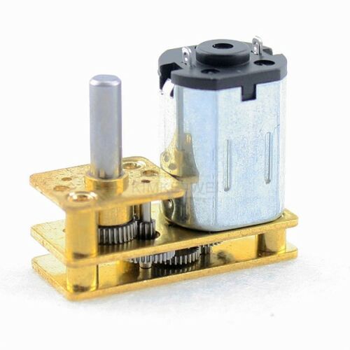

i replace the rotation Unit of my Puma because the motor is too weak or the gear reduction is too low...
use then a small gearmotor like this:
it works perfectly and use half of space
Met5

Re: Puma Sd.Kfz. 234/2 Metal Origin 1:16 WIP
Post by Met5 »
Old version (black) & new version (white).
the new version works perfectly and fits into the hull without interfering with the transmission or engine:

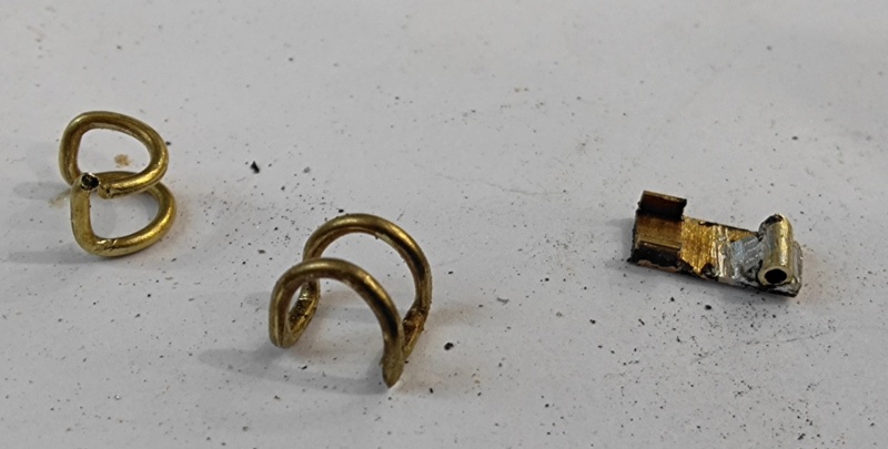

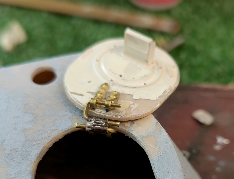

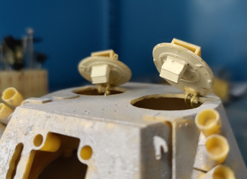

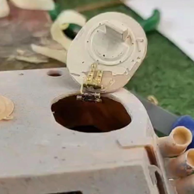

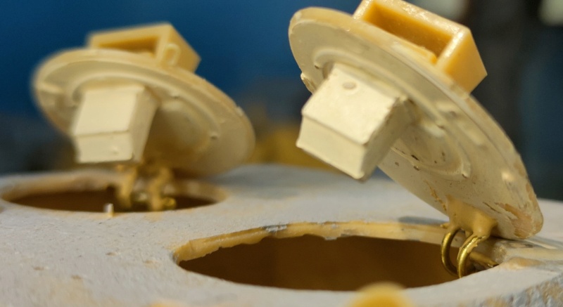

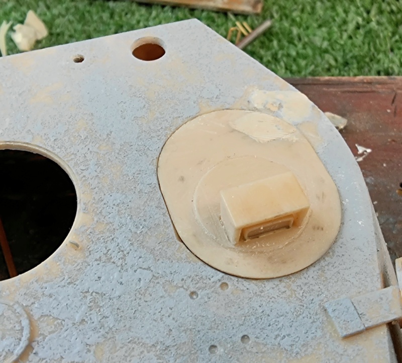

After the winter holidays we resume hostilities with the Puma. Let's start with the hinges. We restore the hatches by removing the external hinges and cleaning from traces of glue:
We build the hinges:
They are installed and:
They do not open.....
We switch to U-profile hinges (the first production had a C as an arch). But the situation is not improving. The shot is refined and we move on to an articulated hinge:
Image[/urlImage
A finishing touch: end-of-stroke bushings
Now we are definitely there:

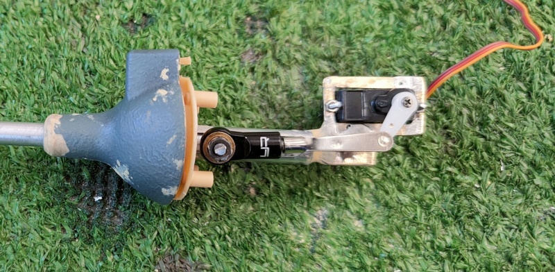

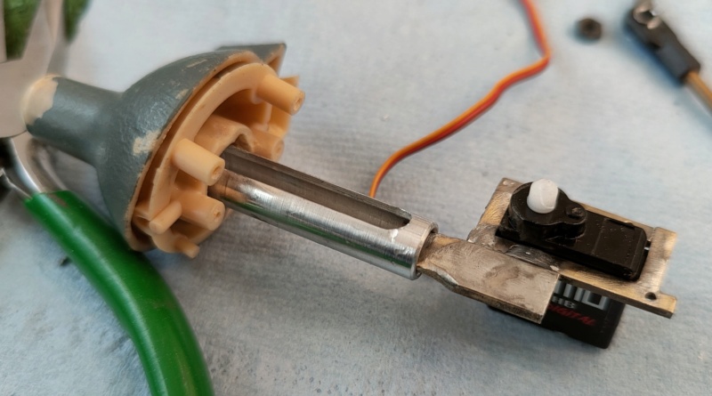

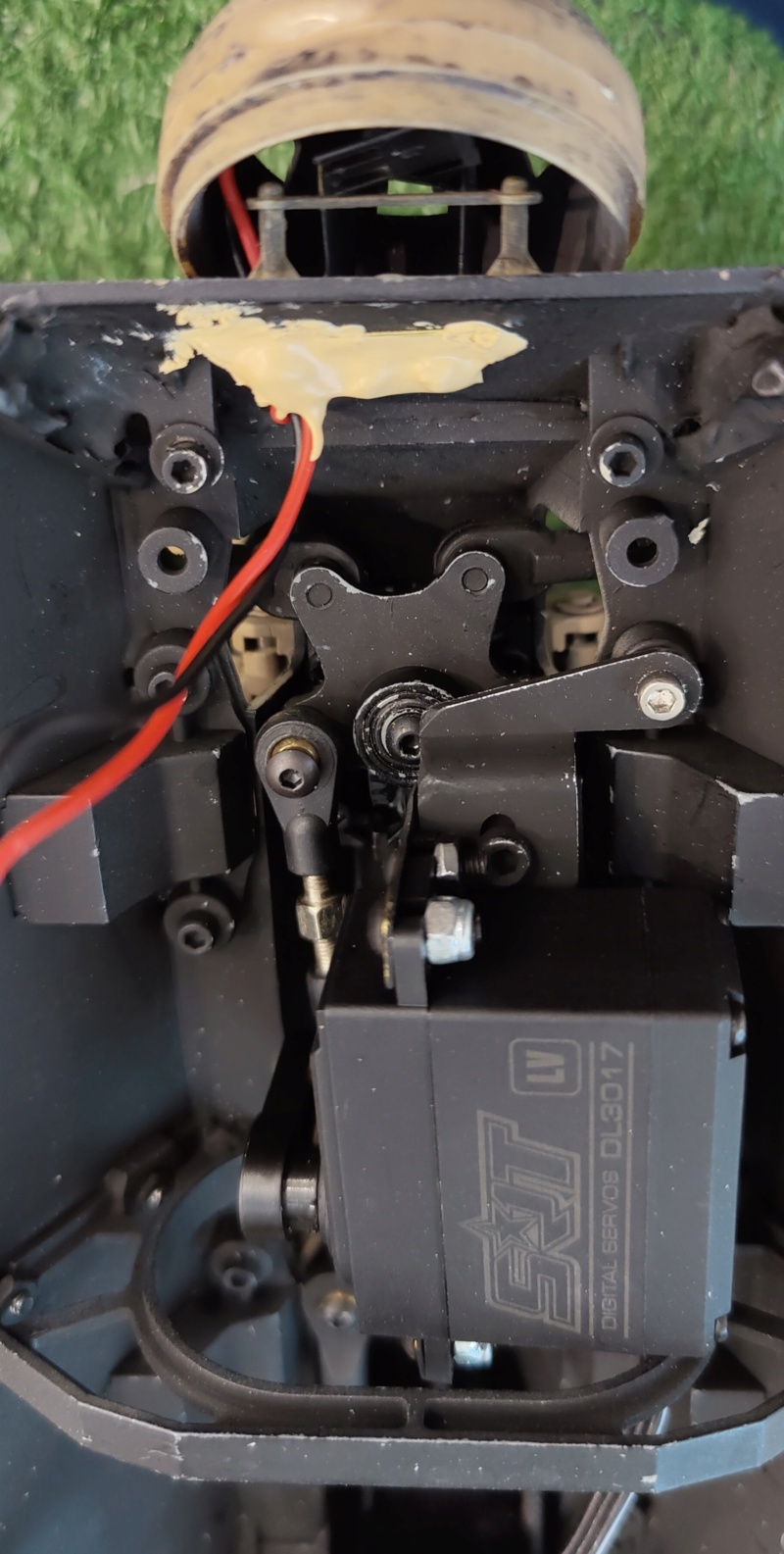

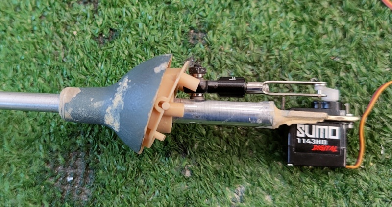

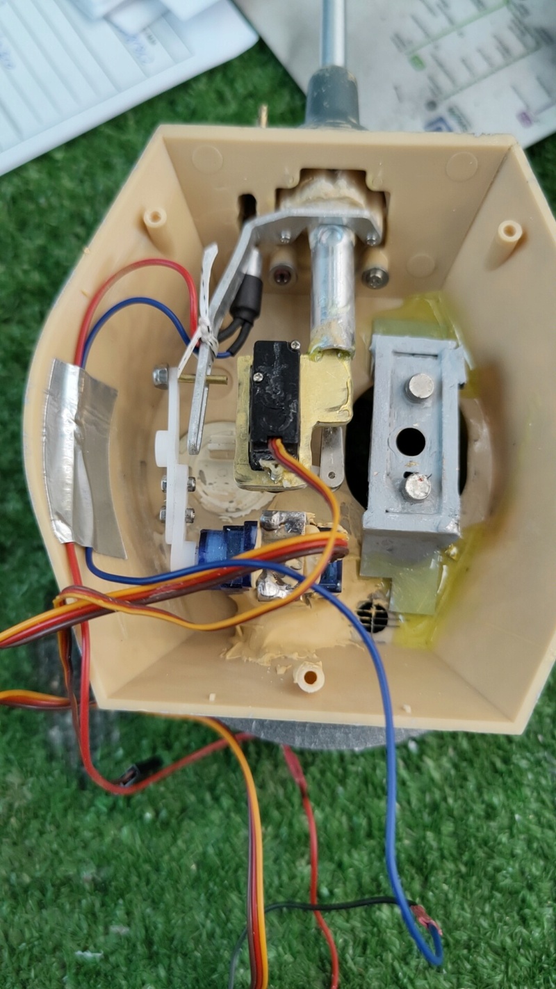

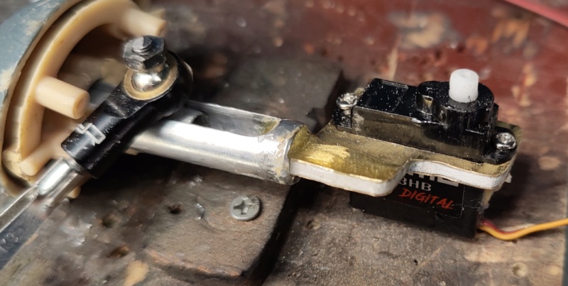

Then we move on to the construction of the recoil of the piece:
Self-supporting structure: the sleeve inside which the piece slides supports the frame that holds the servo:
Do not forget the space for the flash wires
Here it is in action:
The test boxes are very useful for these tests

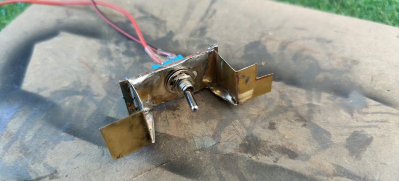

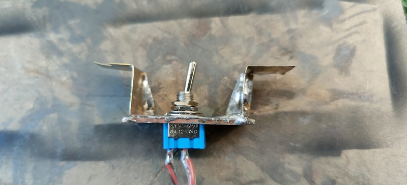

Then he built the support for the ignition switch of the vehicle, which will also support the foreman:
That is all for the moment. We go slow it's true, but at zero tolerance this is the best we can do: lol !:

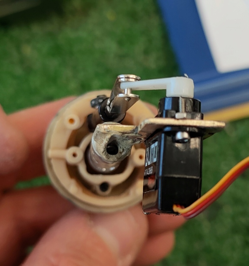

Aware of the fact that every three steps forward we take two steps back to Patrie Officine, we face the challenges head on with straight back, back shoulders and high forehead.

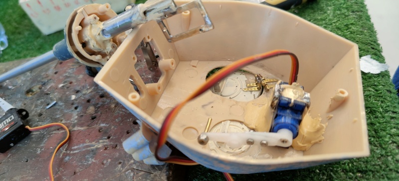

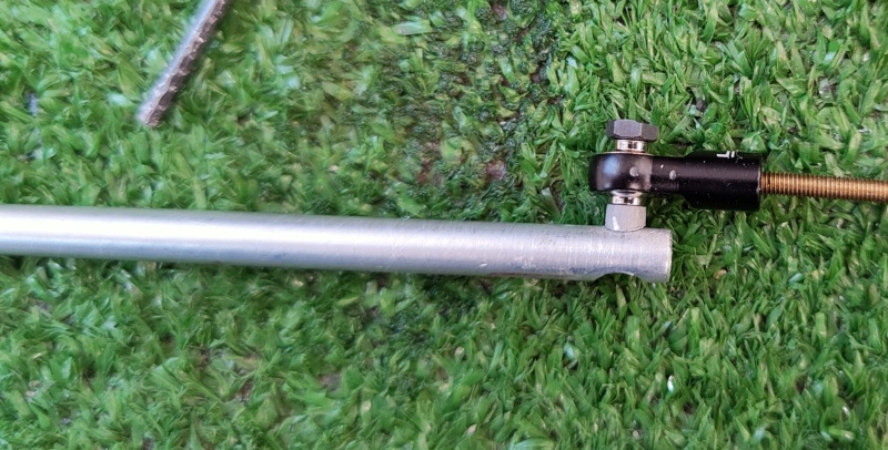

Let's see how the elevation system works. Franciscan, simplistic but the space available is limited and we must be satisfied:
Let's put it on the hull and see:
the servo drive is always given by the test box. The Elmod has servo speed adjustment, we should be able to have a realistic drive
At the end stops there is a small oscillation of the barrel caused by a play in the rotation mechanism (a tilting plastic hinge). It would be enough to limit the travel of the servo and not let it reach us. But we prefer to take everything apart and investigate. At least let's try to improve:
We proceed to consolidate the installation of the sleeve inside which the piece slides and we try to improve the installation of the hinge:

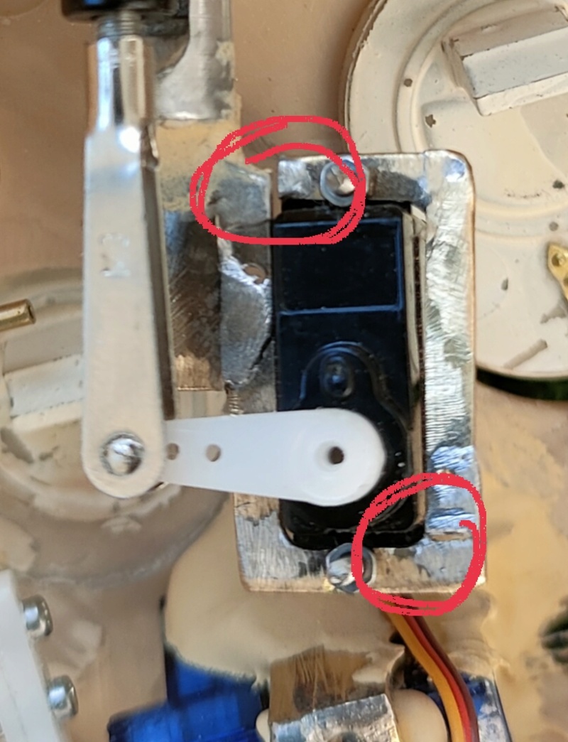

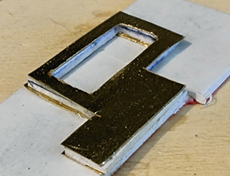

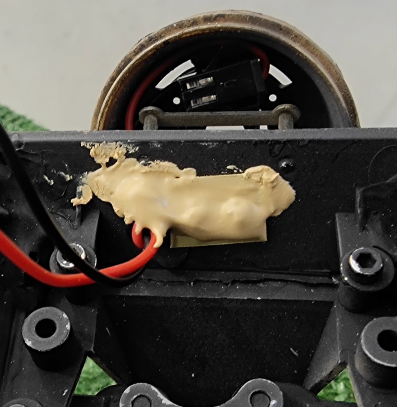

During reassembly, two tin welds of the recoil servo support fail:
After the initial discomfort, a new support is made, a sandwich structure: brass, plastic, brass. All glued with two-component epoxy:
It may not be beautiful, but it is solid as a rock and cost nothing.

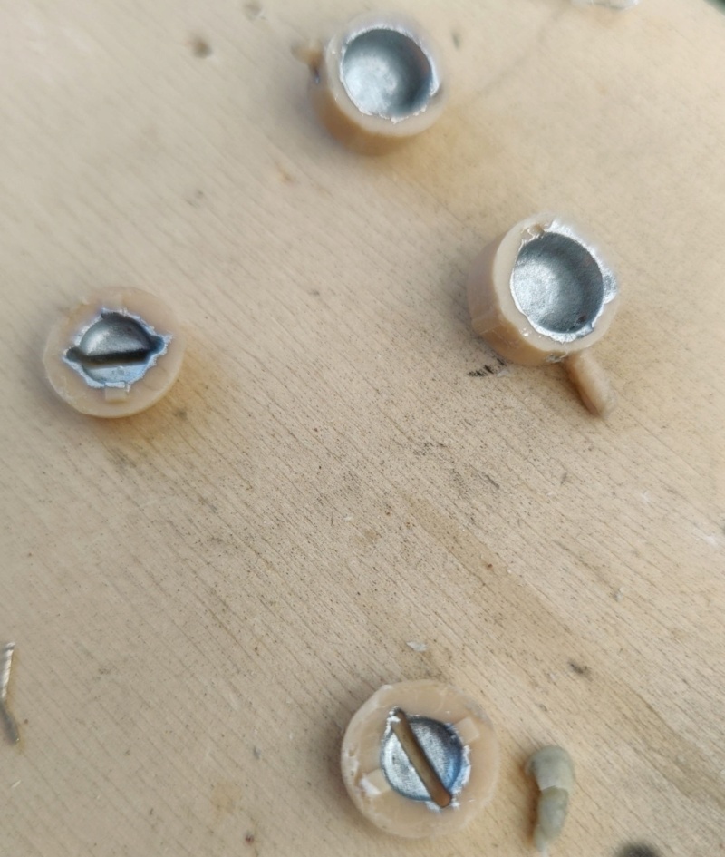

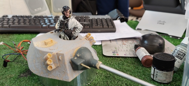

The support for the commander is installed, the coaxial machine gun is installed:
The upper magnets
It seems born to be there:
Now we proceed with the internal painting of the turret, then it is up to the internal LEDs of the turret and the power button

Let's start by studying the electrical system of the headlights. I see something that doesn't fit me.......
..... Not only are the LEDs put in series, there is also a resistance between the two. I try to feed them. They run on 2 volts, one burns out during the test. All that remains is to remove them and replace both LEDs.....
....Led so never seen. While we are reproducing the internal parables......

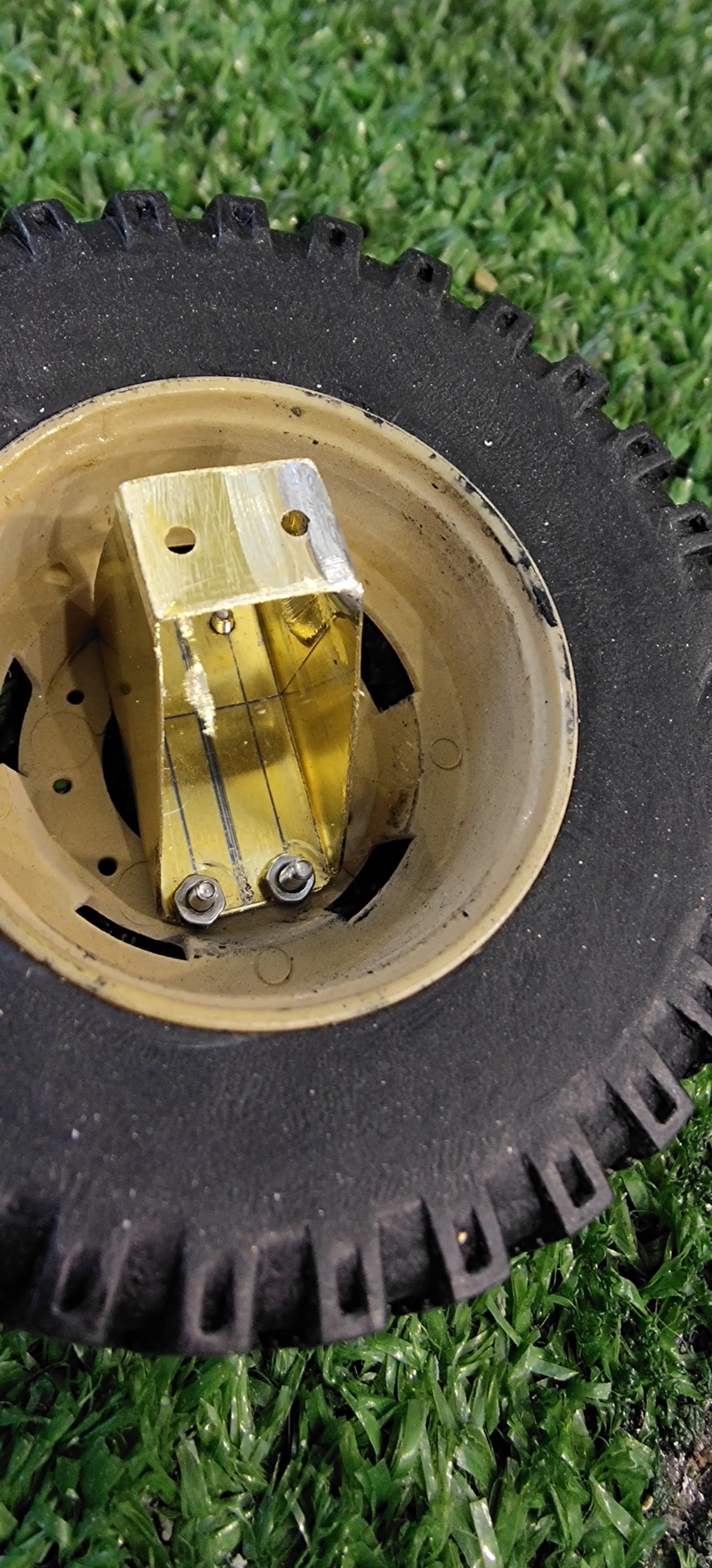

Spare wheel installation: The previously built support is installed with nuts and bolts:
....And with nuts and bolts it is installed on the frame. The brass support maintains a certain elasticity which should guarantee resistance to future impacts.....
.....There is no space for a wall charging point, we will have a flying charging point.....
....when not necessary, the connector is worthily concealed in the spare wheel rim:

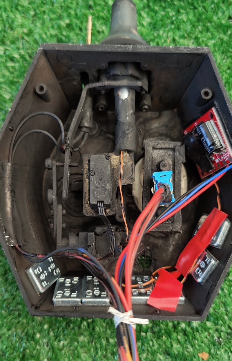

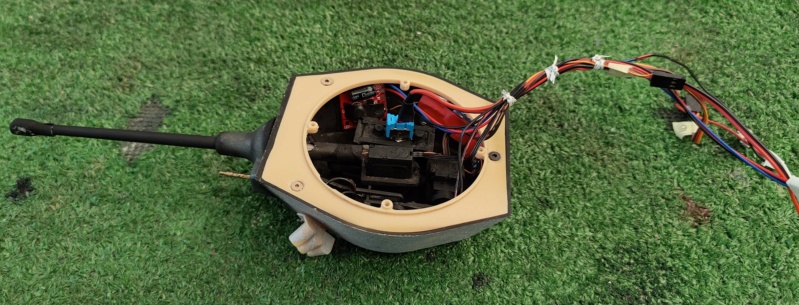

Let's move on to the turret:
....installed the balancing weights, the flash unit for the LEDs in the muzzle brake, given a coat of black to amalgamate that confusion that reigns supreme.....
....the flash unit LEDs have been replaced by a single LED to enter the microscopic muzzle brake .....
....the rotation ring is modified to allow the gun to rise....
For installation it is essential to tighten that allows the turret to rotate.....
the satisfactions are not lacking....
