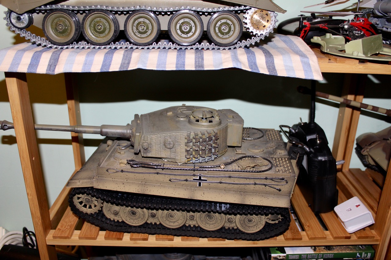

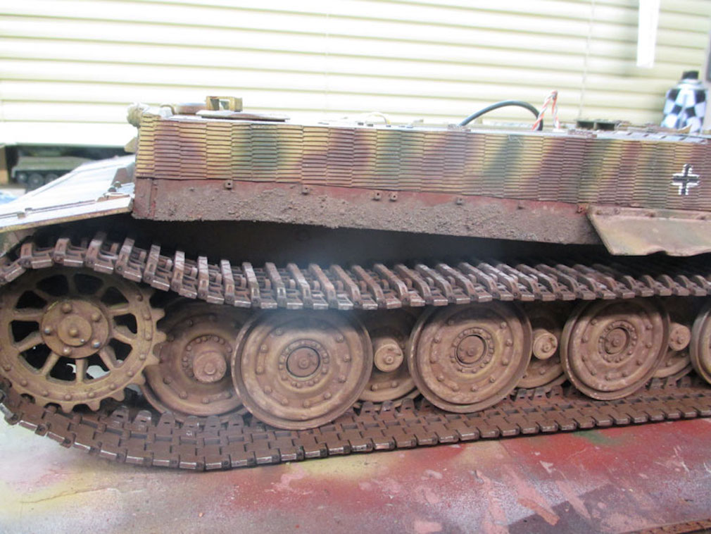

This is my (unfinished- what else? :lolno: ) Taigen late Tiger 1. This now sports a metal turret with the Airsoft Barrel recoil feature. It actually does spit BBs and recoil at the same time. :)
But right now, it's the wheels I'm interested in.

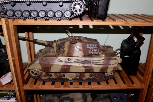

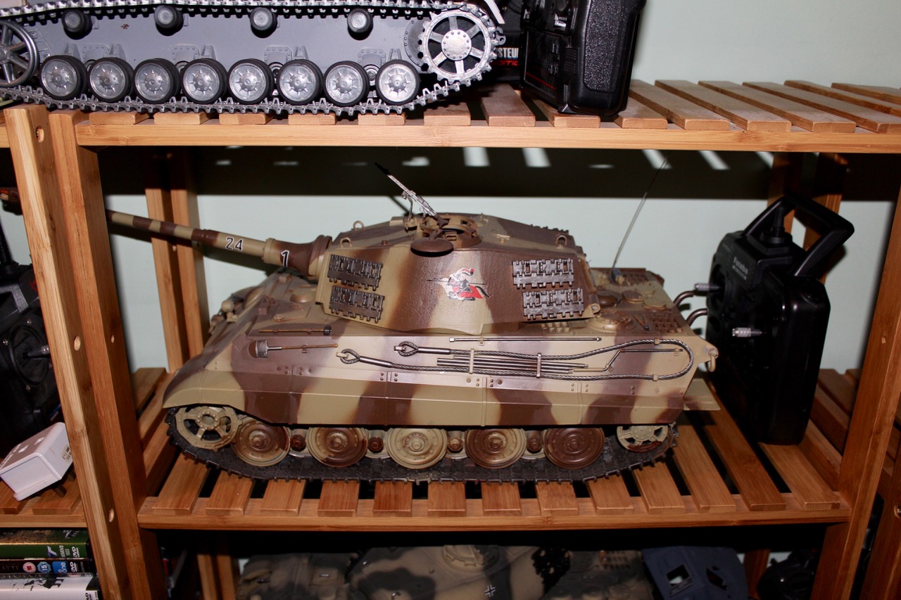

Here's my Tamiya King Tiger (almost finished- except for light weathering). The Tamiya wheels are plastic, and have a diameter of 50.3mm. This is virtually identical with the diameter of the Taigen wheels.
Maybe then Tamiya (plastic) KT wheels can be adapted to fit the Tamiya Tiger, and if not, then the Taigen set look like a decent match- given the possible pitfalls awaiting in other parameters. :problem:
Tamiya KT aluminium wheels are not obtainable currently at Axel's. Unfortunately, the ABS ones are also out of stock.
Since I'm in no hurry to begin yet another project, I can afford to bide my time (and money :D

Try the late wheels off the taigen tiger and see if they fit the tamiya tiger
Posts: 4257
Re: Tortured Tamiya Tiger...
That’s the easiest to try.
The Taniya ones will need the spacers adapting to fit the Tiger track spacing.

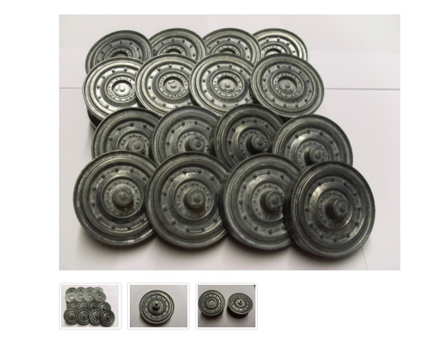

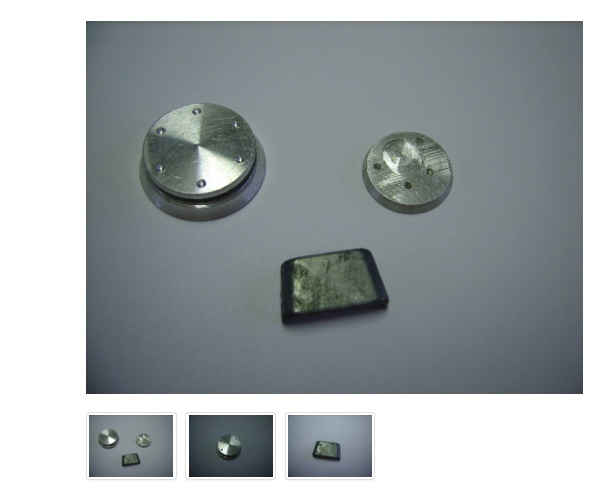

Tamiya Tiger 1-late version-the  wheels
edit: perhaps I should add that these bespoke wheels were supplied by Guido Henn (a member) of henntec.de

Roy, it has been some time since I converted a set of Tamiya King Tiger roadwheels to make a late Tiger I. And, as Ad Lav said, the wheels need to be spaced to fit the Tiger I track; which I found to be a pain. Buying the Taigen Tiger I late wheels will be MUCH easier for your build! The shafts for the Tamiya Tiger I are 4mm down the length of them, but neck down to 3mm where they go through the hub and are held by the grub screw. Other Tamiya tanks are 4mm all the way down. I have found that it is fairly easy to drill out the Tiger I hubs to 4mm, and they are thick enough to still leave plenty of meat for the grub screw. So, if you do need to drill out the hubs for a larger Taigen shaft, you can plan to do that without worry. And, if you off-center any of the arms, I have several spares you can have. -Mike

Many thanks for that, Mike! It's good to have the dimensions without stripping my Tam KT, Tam Tiger 1 and Taigen TIger 1 down, to get their respective dimensions. :thumbup:

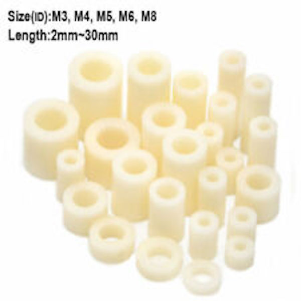

I have packs of ABS spacers in a wide variety of dimensions, should I need them (from the Comet and Cromwell projects). They're in all sizes, and in black and metal too. Cheap as chips. :thumbup:
Standoffs and spacers
