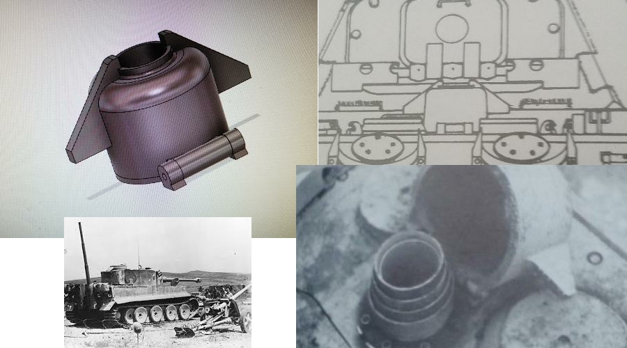

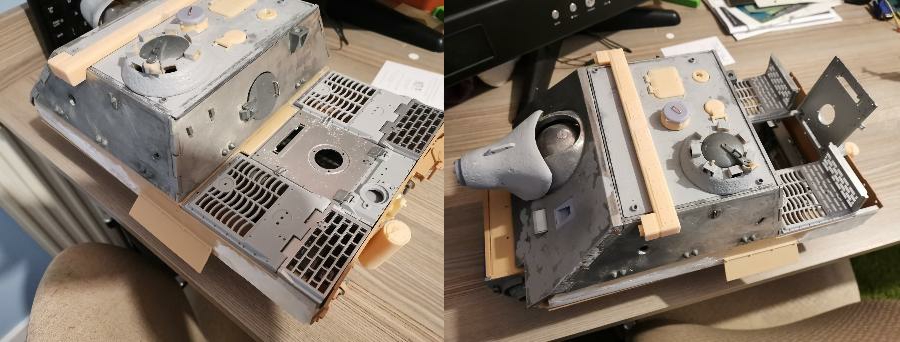

You never know what you'll find perusing the pictures posted by PatrickH. Ostensibly, here we're looking at parts for the rear deck of his Jagdsturmtiger build, but if you look carefully, you'll spy what appears to be Die umklappbare Schutzhaube fur den Teleskopschact (armored pot for the telescopic schnorkel) fitted to a few early Porsche-turret King Tigers. We're all ears and eyes, PatrickH?

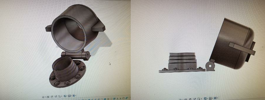

S.Panzer: Thanks and yes I wasn't a big fan of the asiatam's offering - it just looked so basic and needed revising. A good eye you have there I must say and you will be right, it is a snorkling equiptment for the KT Porsche that was shortly discontinued right after its introduction, a feature that peaked my interest and sadly I am a sucker for interesting features, a trait that often sidetracks me to other directions. What you saw in the deck of my JST was actually the first iteration - I have since made amendments to it to bring it more in line with my references. I have also decided to include the snorkling bit seeing as the housing is moveable. So i can either print the housing in a closed setting or print them in parts =) I was also made aware of a possible alternative to using IPA to clean my prints, 'Elbow Grease' from B&M for only 0.89p per bottle so i quickly went out yesterday to get one to test.

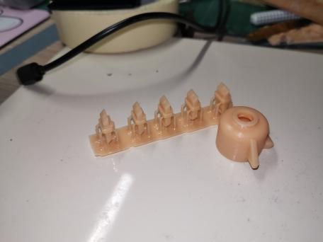

I still used gloves to handle the cleaning process of course - oh and def eye protection - I was being foolish before, only gloves and mask and I thought thaht would be enough and then one day as i was peeling off the prints from the build plate - the part fell from the plate and into the IPA causing it to splash and into my eye - panic!!! quickly washed my eye and it was fine - thank goodness! - anyway def eye protection!!! So i tested the elbow grease and it wasn't really dissolving the resin but when i scrubbed it, it came off easily. It does need good scrubbing to make sure all resins are dispersed from the part and a good wash in warm water afterwards. So it works but on the downside one has to really scrub the piece and it has made the parts rather shiny - so uhm, yeah not sure - for other prints and projects it might be fine but I think I shall go back to IPA for ease of use and also, it doesn't make my prints shiny heh

I haven't even opened the resin that came with my Photon, Anycubic green, when i purchased the printer I think i got the Elegoo grey straight away from amazon and that arrived well before the printer it self.
But flexible resin - i must try that one - which brand would you recommend for the flex? SO far i have used the Elegoo ABS like resin and anycubic grey/skin normal resin. I lke both but the ABSlike can be a bit sticky and will spoil a smooth surface - not sure what affects it - hot water?! dirty IPA!? not sure but it's less brittle than the normal resin one so I use it for certain parts, ie easily breakable pieces.
I also have the Tevo Tornado which i believe is the same as the CR10, mine is sitting unused at the moment as mostly I'm using the Photon - the vat on the Photon is empty and just awaiting to try the new water washable resin i recently got - i just don't have any pieces to print at the moment heh. I haven't actually dialled my Tevo, it prints fine, I'm happy with the outcome - it can do better I'm sure but I haven't the time nor knowledge to fully dial it in heh.

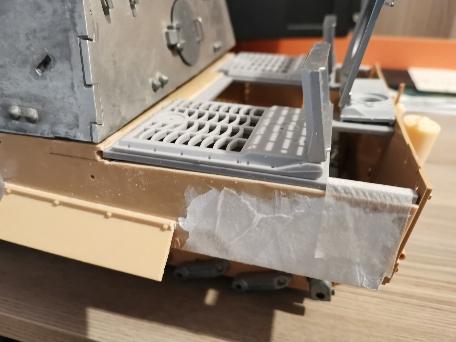

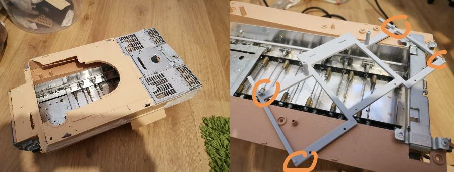

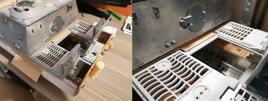

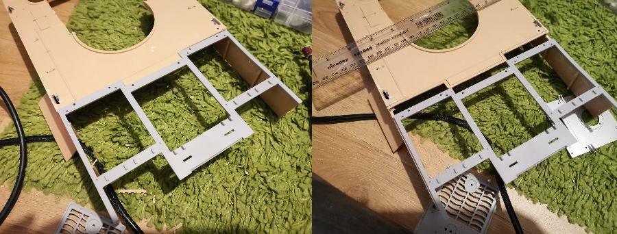

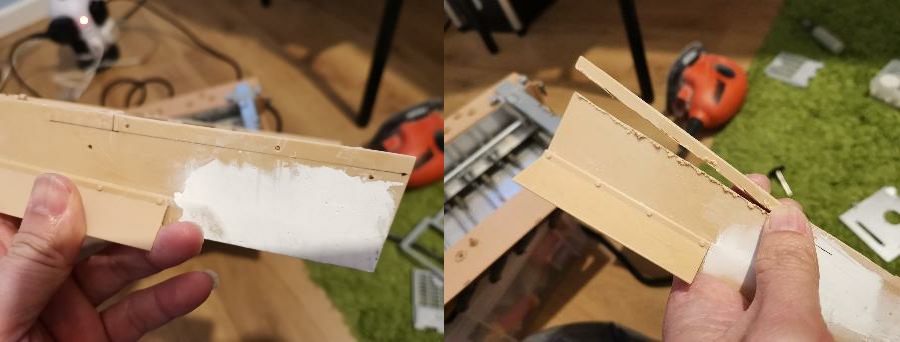

Now a quick update, my Heng Long deck order finally arrived much to my excitement but unfortunately, the Hachette deck guide is still a little bit too wide for it much to my frustration - admittedly the HL hull is a little bit wider than the Taigen hull but sadly not enough. I had thought of making my own deck guide for the Hachette pieces but the guide is the exact same width as the parts themselves so that wouldn't solve anything. So i brought out my Ludwig deck kit offering but those are much smaller in scale and the detail is not as good. I'll do a pic comparison later. As I've already cut out a large portion from the Taigen hull, the LUdwig kit will require a lot of work to make fit. I could use the HL hull but that would be a bit of a waste. Besides, I really want to use the Hachette deck as they are brilliantly made. So i went back to staring at the Taigen hull for a wee bit of time in hopes of getting a light bulb moment. In the end, I decided to cut a chunk out of the sides, about 6mm to accomodate the Hachette guide and pieces. But first i needed to cut out the tabs from the bottom of the Hachette guide in order for it to rest flat on the Taigen hull Afterwards I cut out the top deck to accomodate the Hachette guide Now this seems like an easy solution but one I couldn't see before as I guess I didn't want to cut the sides for fear of making it look out of scale but I think it will be okay!? I have some gaps to fill with styrene and plaster of course but the sides are the main issue - i just hope I've given myself enough clearance I love that i can open all the grills and the action is so smooth - these Hachette pieces are really excellent. Now next task is to make good the sides and upper deck and we shall see if I'm going to be happy with it.

Hell of a hack job mate !
I have a full collection of the Hachette Tiger editions all unopened, and Im not about to try a stunt like yours , but there are a few odd part sets around at times that I might be able to get hold of for parts as you have.
Sure is a quirky build

As Mr. Bix says so eloquently, "Sure is a quirky build." My emogees don't work, but just imagine a winking smiley face here. But, I will say, you've got more courage than the average bear, and a much steadier hand to boot. Seems to me you've arrived at the best solution under the unusual circumstances you've been faced with. The Sturmtiger is a boxy beast to begin with. As long as the rear edge of the deck sits in front of and not on top of the back plate, I see no problem of "scale." Terrific work.
