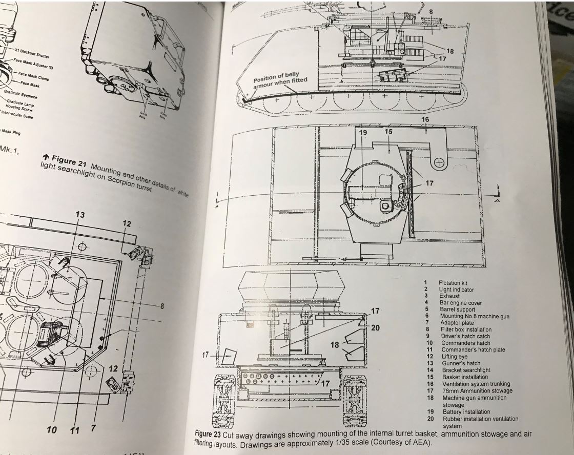

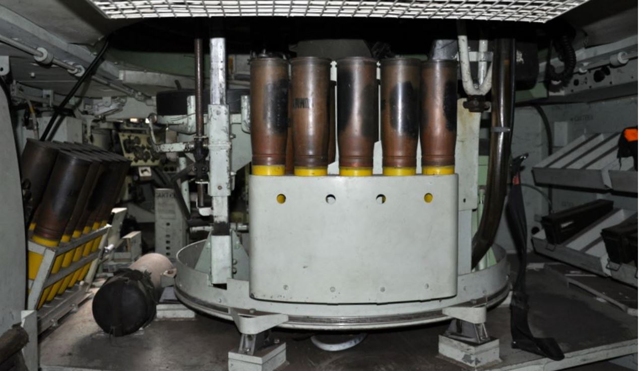

It is difficult to find pictures of the MRV interior. Most shots are from the same angle, seen from the rear ramp and always showing the back of the turret basket, which created some grey area that I needed to bridge with some assumptions.
M-113 M113 M-113A1 MRV 1/16 RC Scorpion Turret Australian Army build
This set of 1/35 graphs from the book Australian Fire Support Vehicles were highly useful, but not much detailed and with many grey areas.

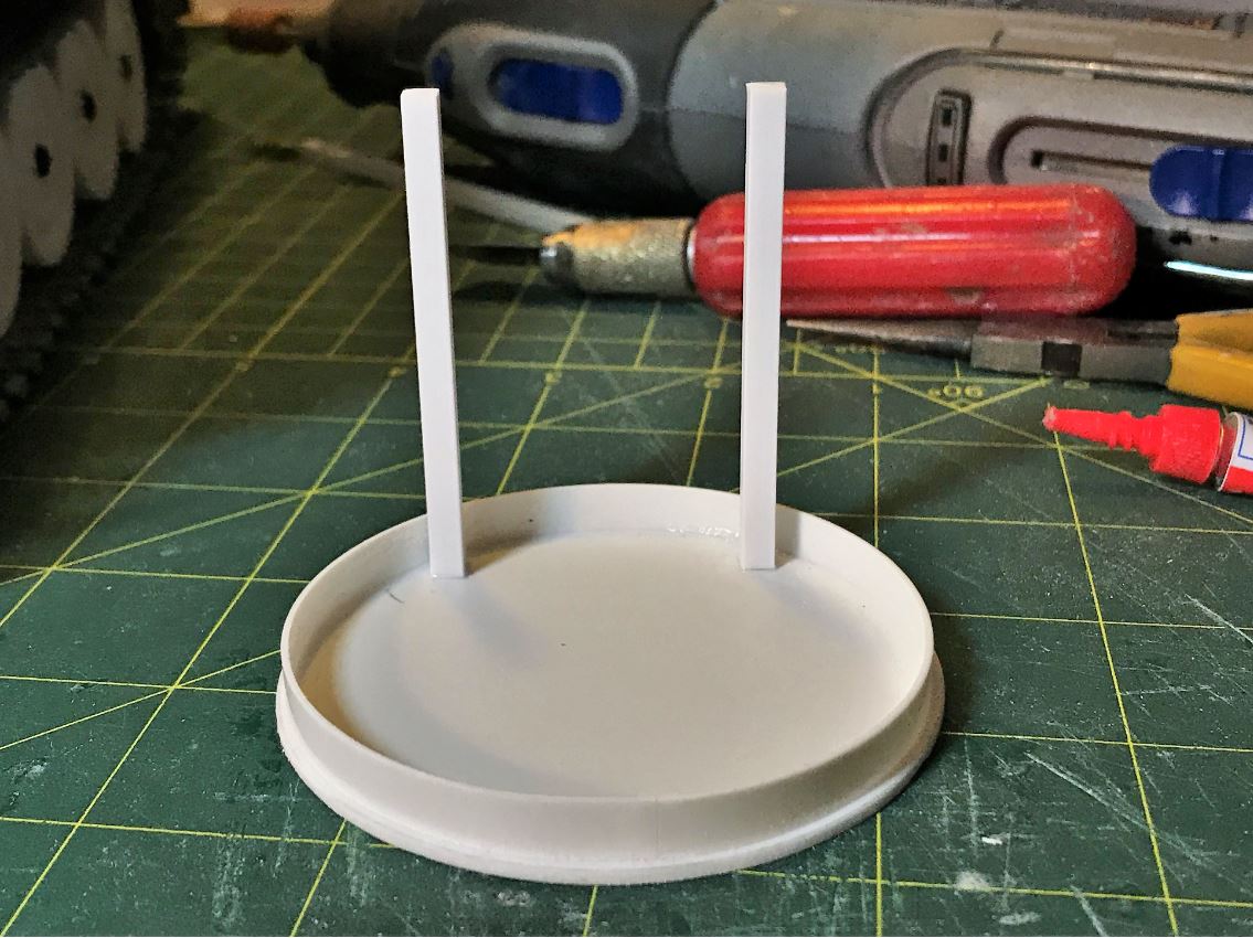

The base for the turret inside the hull is created.

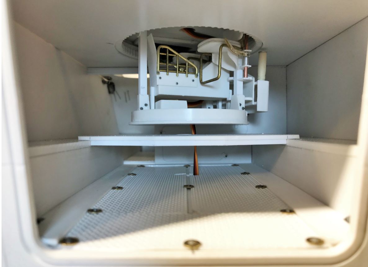

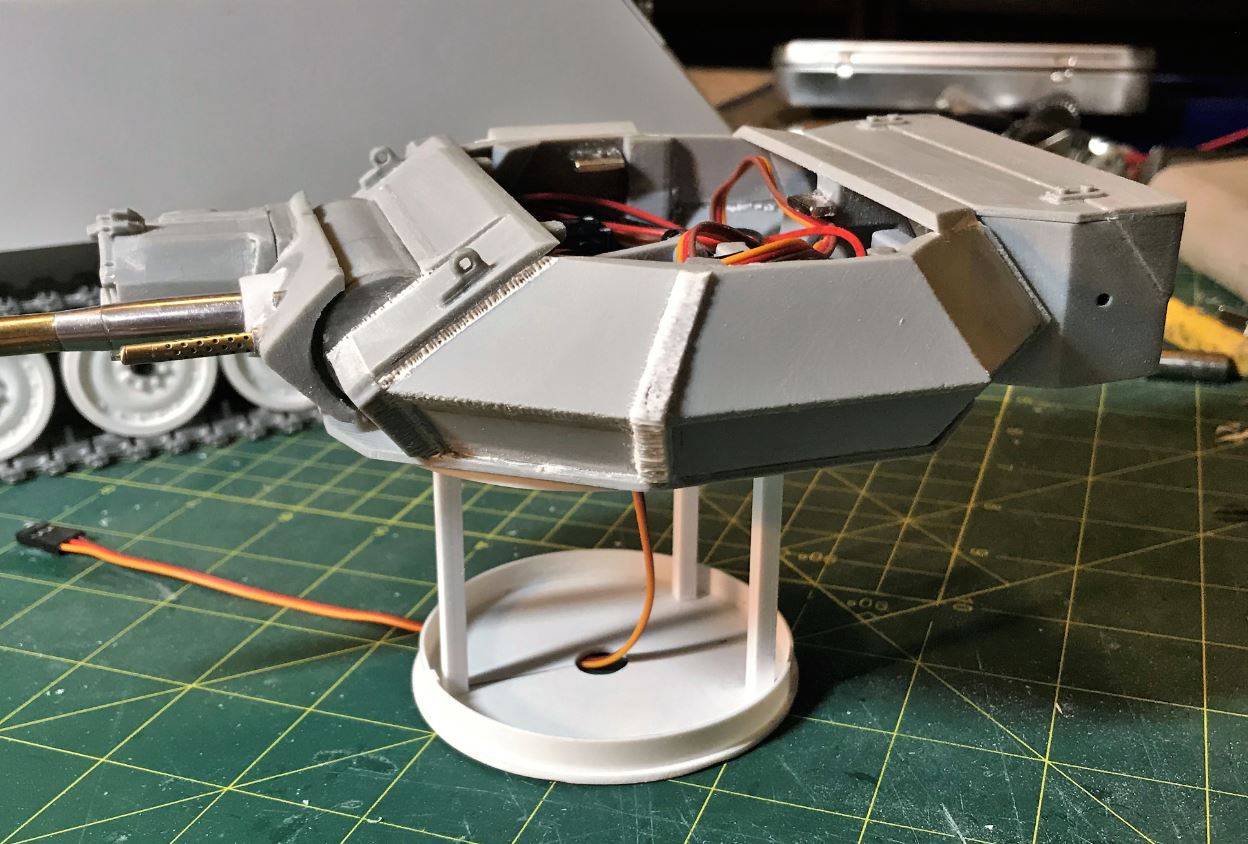

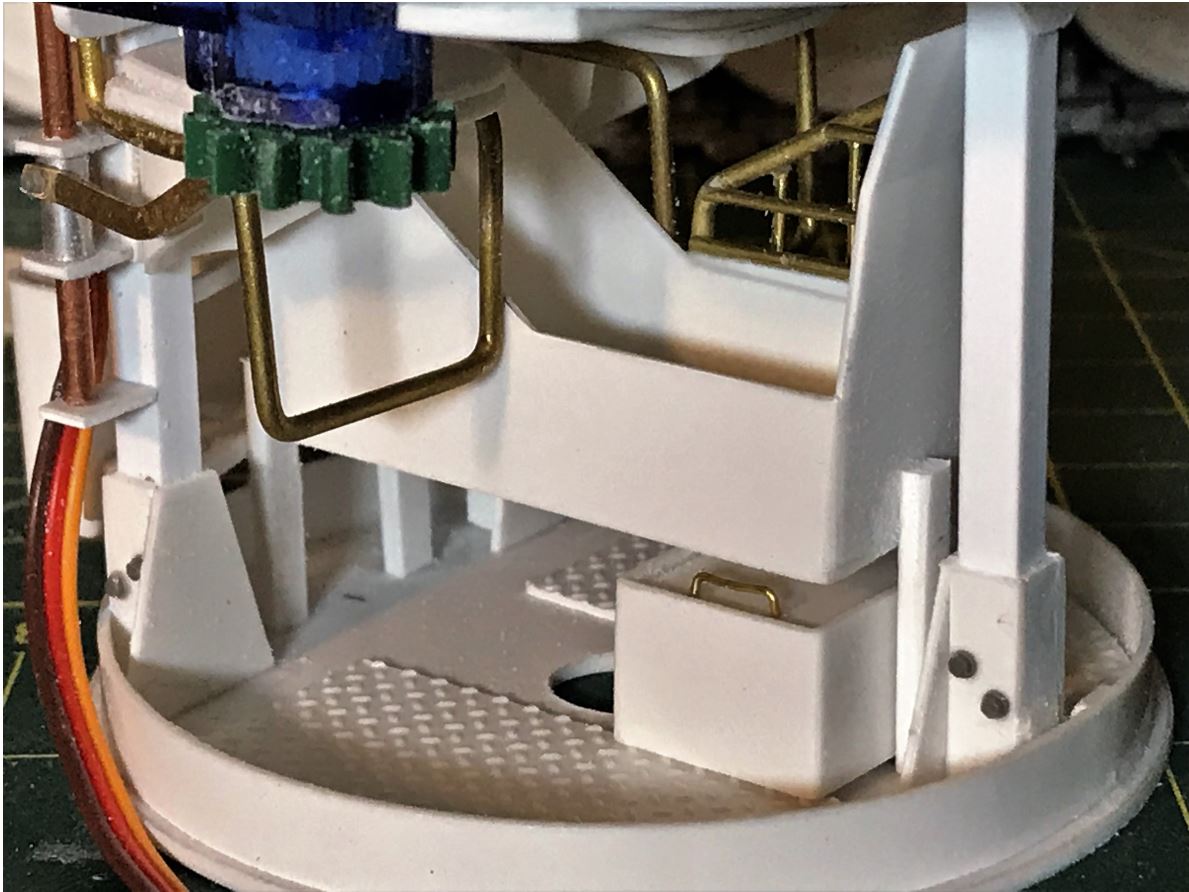

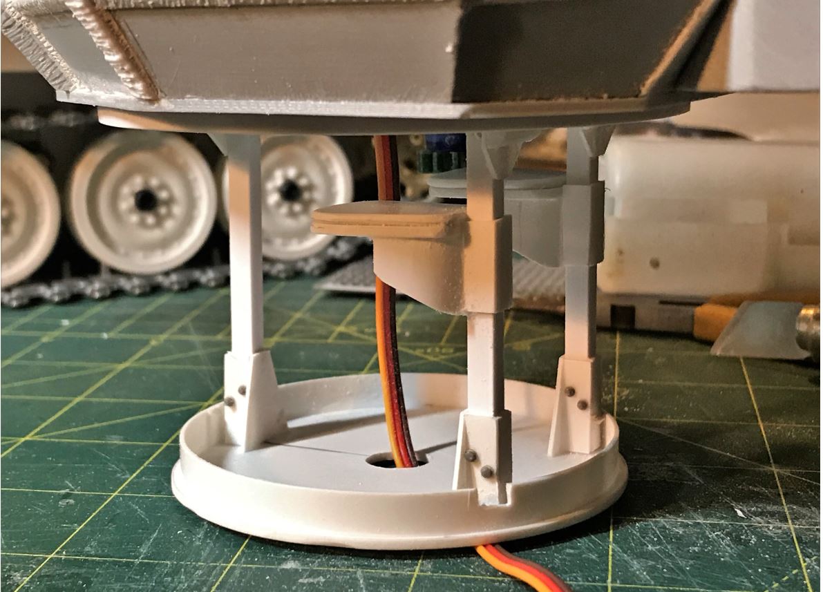

The turret basket was built in a telescopic fashion, one item at a time, through extrapolation of fragment of interior pictures and the simple graphs available.

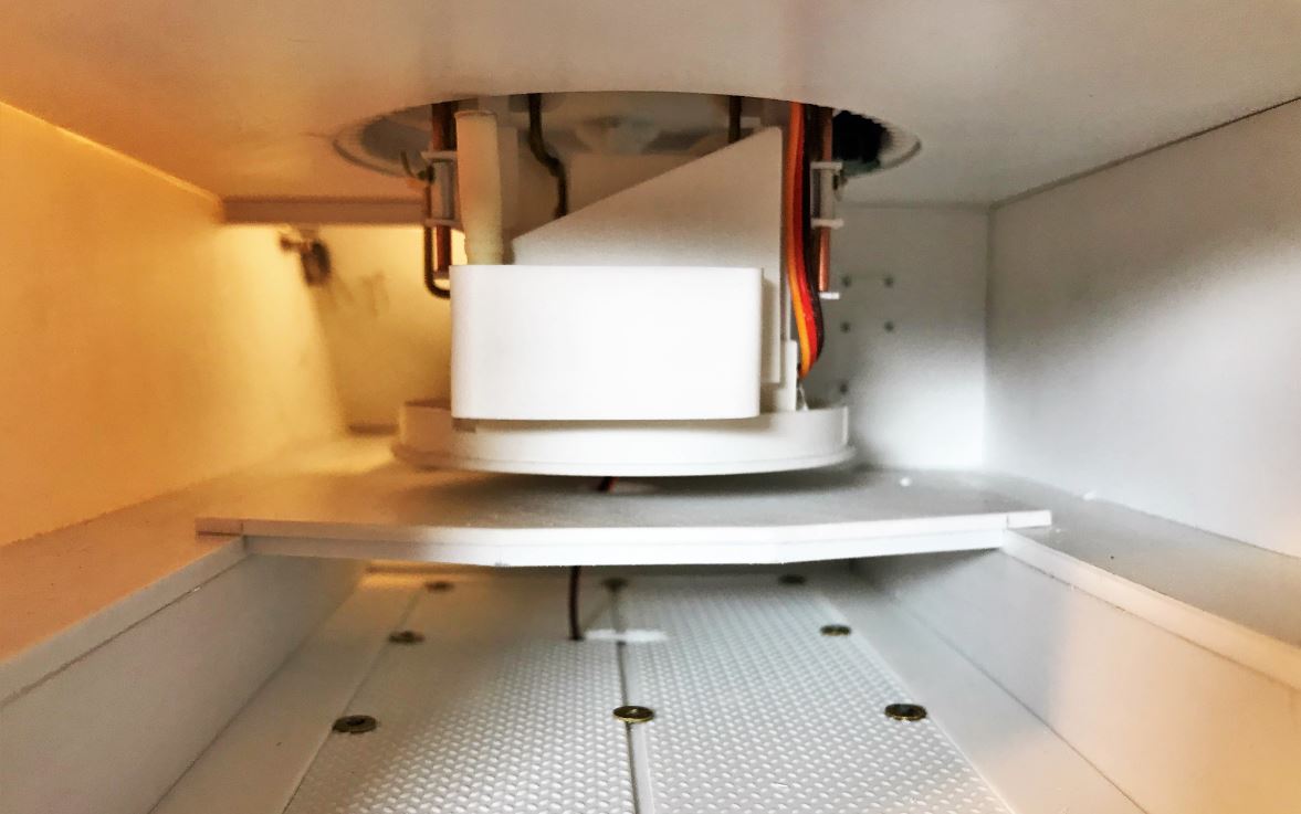

A beam was added at the front based on assumptions. The basket needs to be solidly fixed under the turret. It does not show but the positioning of the basket is one of the most critical step of the build. In order for the turret basket to turn correctly, it needs to be perfectly centered at a precision using tenth of millimeter. It was achieve through trials and adjustments using small drop of superglue. Once the optimal position is found (meaning the best I could), then it was solidly glued in place.

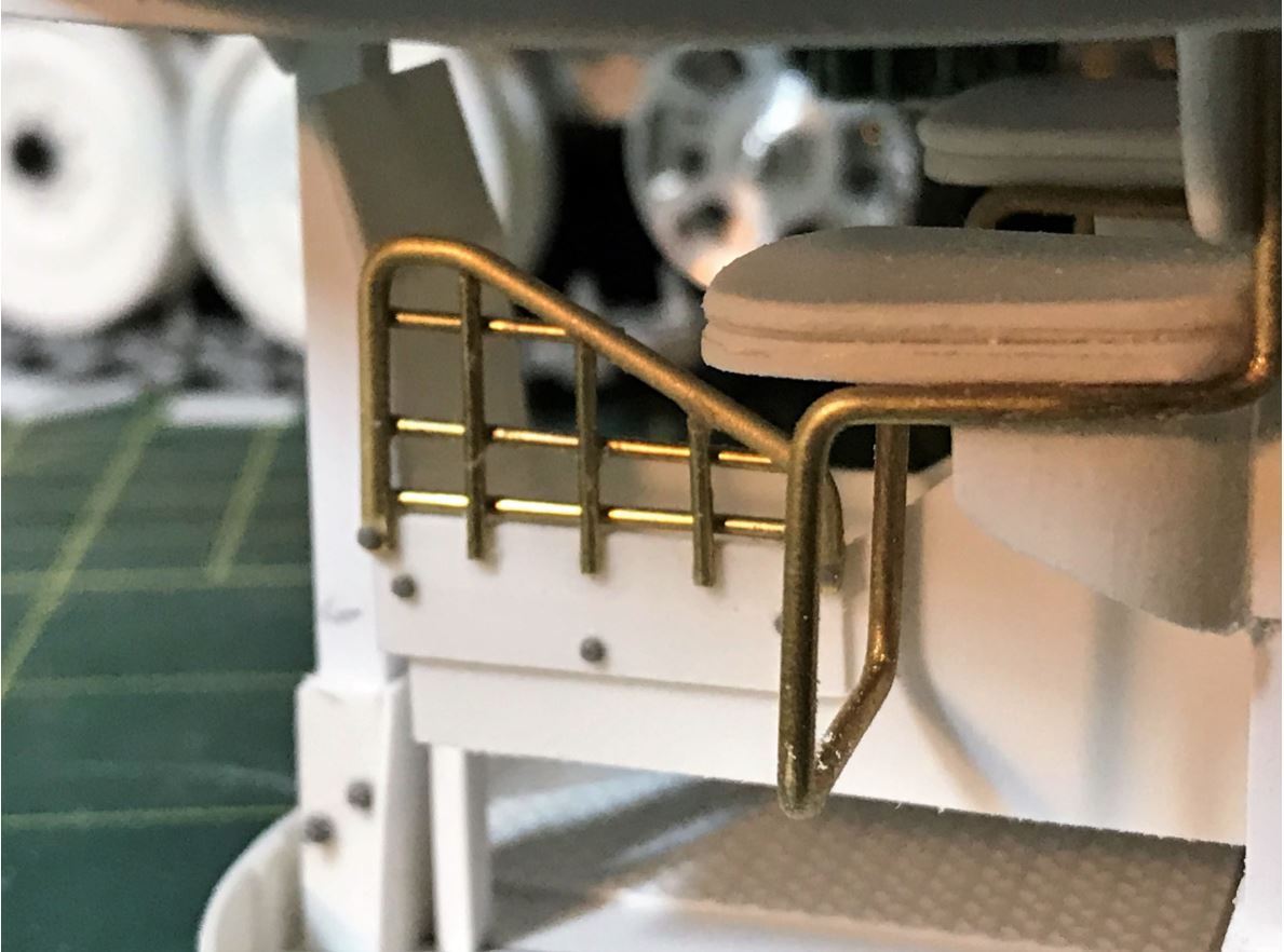

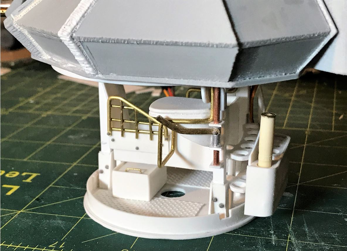

Seats for commander and gunner. Ince the wire for turret rotation servo is shown. The others are temporality store inside the turret while I am building the basket. They will be positioned later.
Close up of the spent shell bin and guard protecting the commander.

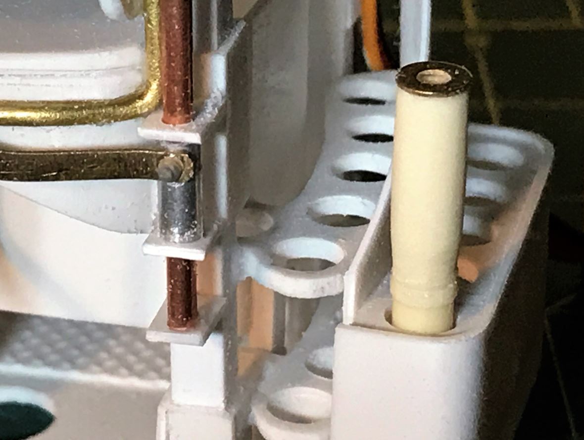

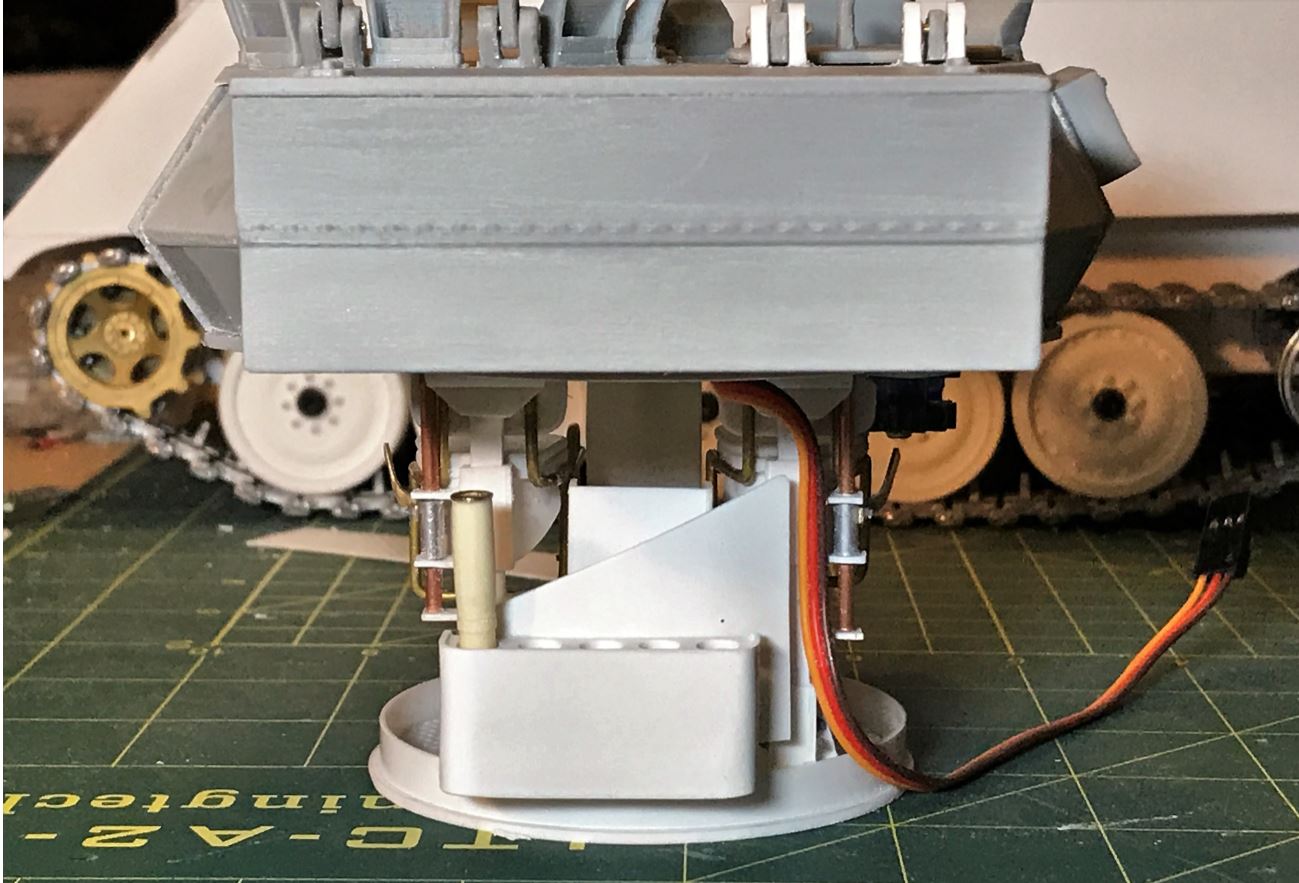

Rear view of the basket, with the ammo bins.

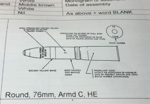

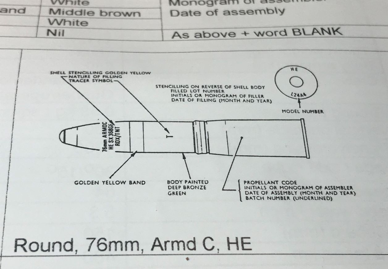

The MRV model will be given a full load of ammo. Seen here is the 76mm HE round.

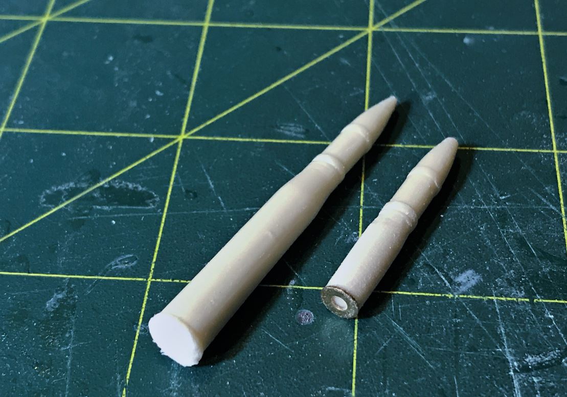

A lot of twenty four 75mm PAK resin ammo rounds were ordered from Dioramaparts. I have modified one as a prototype of the required 76mm HE round, which is much smaller than the PAK shell.
I used it for basic calculations for the ammo bins. Looks like it is still a bit too long though.

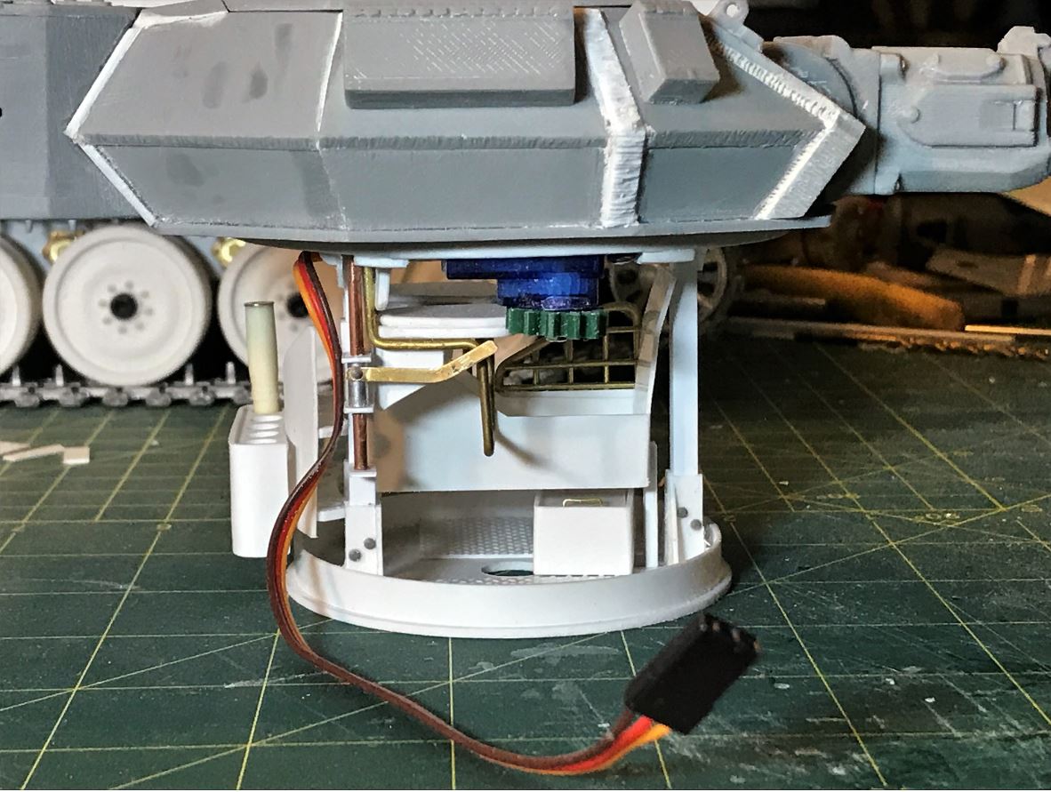

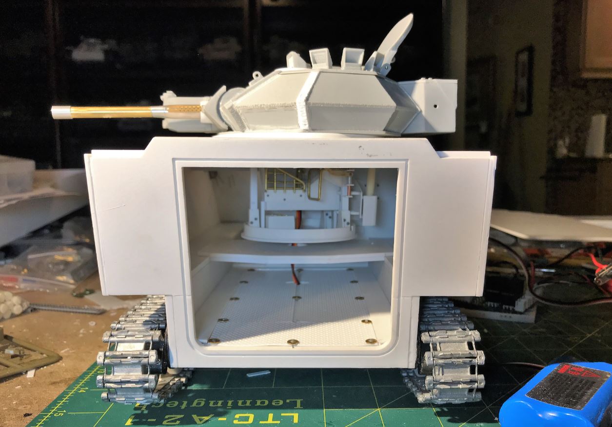

The turret is installed inside the hull for final turret rotation testing.

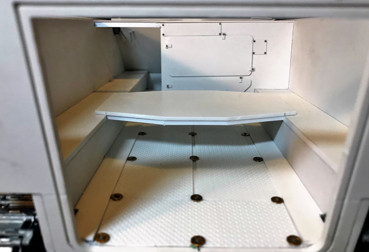

Next step is to build the interior.

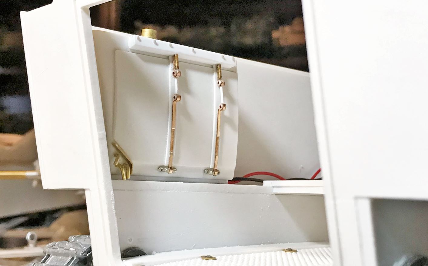

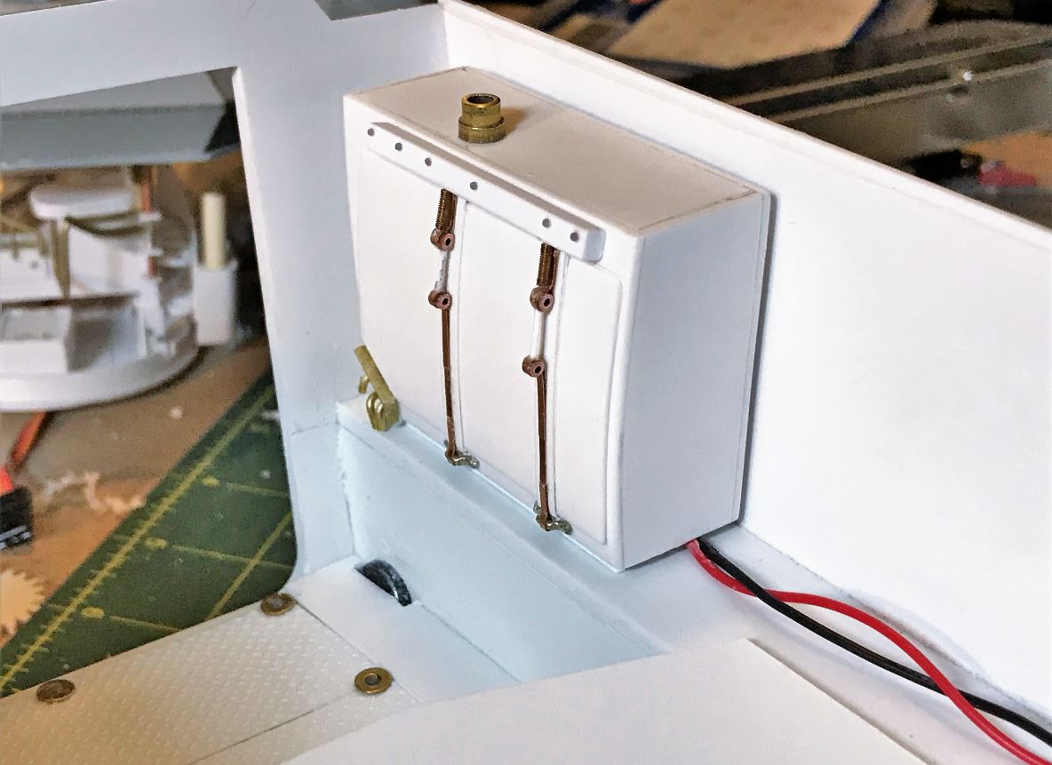

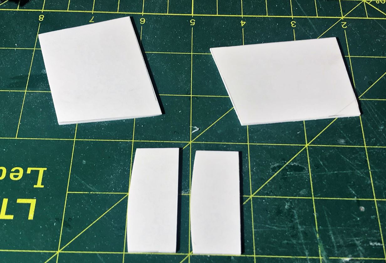

Continuing with the interior, this post is for the fuel tank.

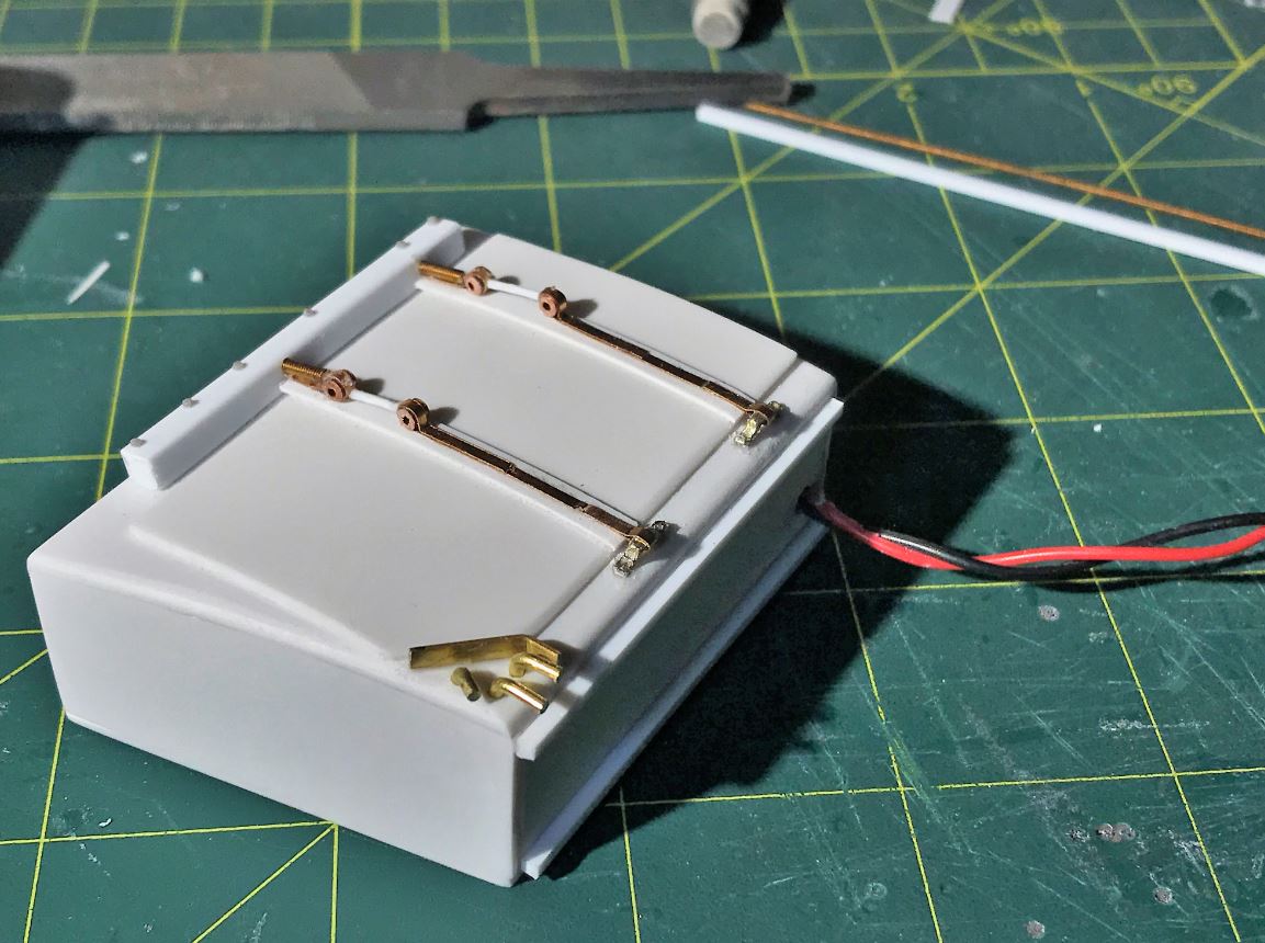

Dimensions and shapes for the fuel tank were taken from a Verlinden kit. It is assumed here that the MRV had a standard size M-113 fuel tank, but its always possible that the real one received a bigger one, hard to tell from the few available pictures and angles.

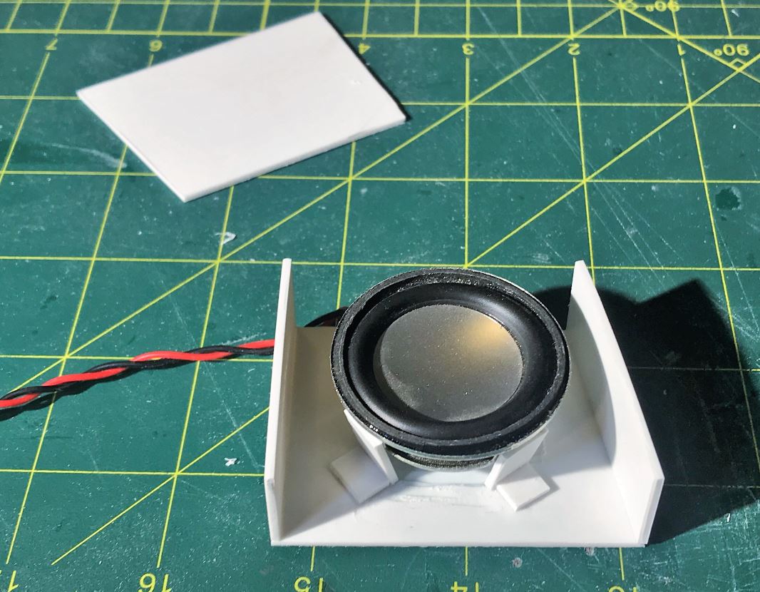

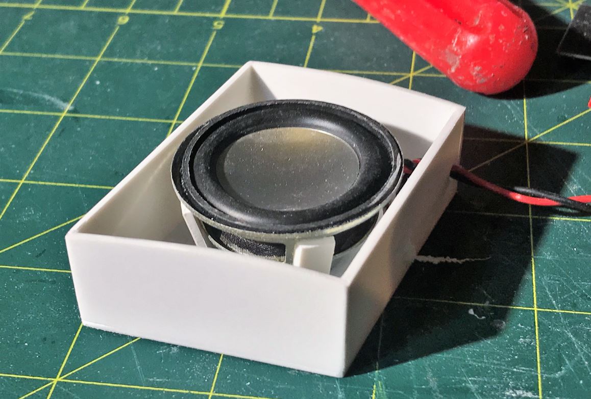

As real estate is a luxury on this build, this is where a small Heng Long speaker need to fit after having been taken out of its cage. There is no room elsewhere for it.
Perfect fit

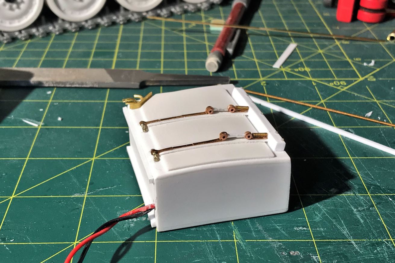

The detailing of the fuel tank is finished using references and Verlinden kit.
The fuel tank is temporarily positioned and loose because I will need room to install the tail lights and pull the wiring under the fuel tank.
