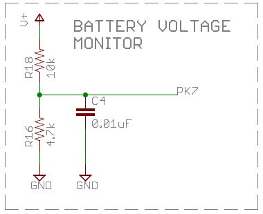

the low voltage detection is very easy to do by
two resistor and one capacitor:
this is a part of this schematic:
[The extension pdf has been deactivated and can no longer be displayed.]
