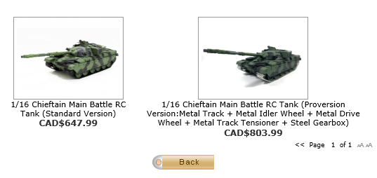

Ordered a regular version from Mato Mart with the Christmas Free Shipping offer, a significant saving. Strangely, the Chieftain for Canadian customers is at CAN $648 (which is about US $483) while it is more expensive at US 540 for US customers. I guess these might be due to Trump's tariff. One could basically make a profit by reselling these.
MatoMart chieftain
MatoMart chieftain
chieftain CAN.png (41.74 KiB) Viewed 2201 times
