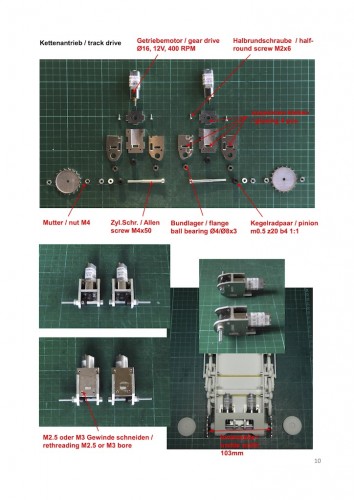

Does Ludwig offer these motor/gearboxe set for sale?
Panzerjaeger66
Posts: 396
Location: West of Austria
Re: New Takom tank
Post by Panzerjaeger66 »
http://www.ludwigs-hobby-seite.de/Panzer%201.html
Pos. 8 are the gear box aluminum parts. The sprocket is not included; you have to ask him about the price.
The rest are commercial parts.
