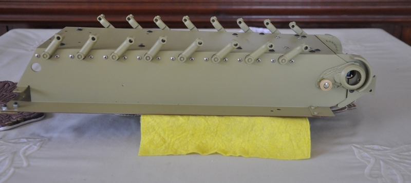

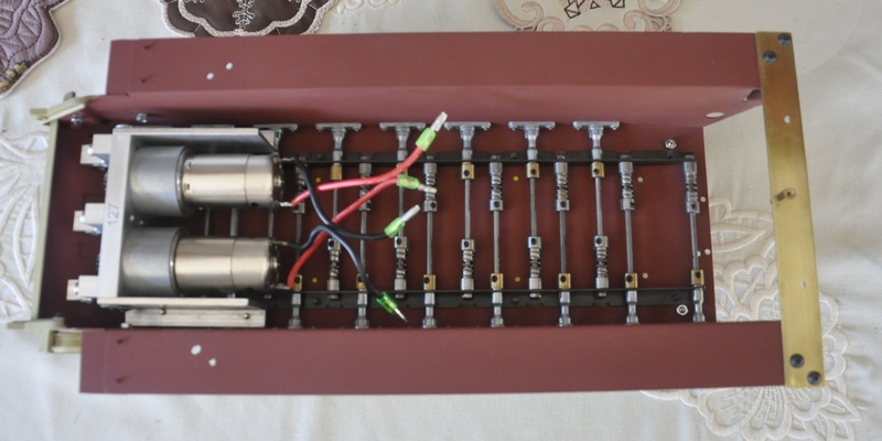

Got a little more done last eventide. Wecohe suspension system is a bear to adjust, but once properly set up, it's pretty grand. I use the stock Tamiya torsion bars for the front road wheels and the rest is Wecohe. Depending on how he sits, I may go with Tamiya rear torsion bars, too. I've found over time that when in combat the Wecohe springs can be a little weak, but using stock front and rear torsion bars to carry most of the weight, the supple Wecohe system really shines.
Transmission installation was straightforward. The motor wires will be replaced with copper wire and gold plated connections. Notice on the front side Daryl's final drive covers. This is missing in the kit, and Daryl will make them again shortly. I'll have them back on sight when he's finished them.

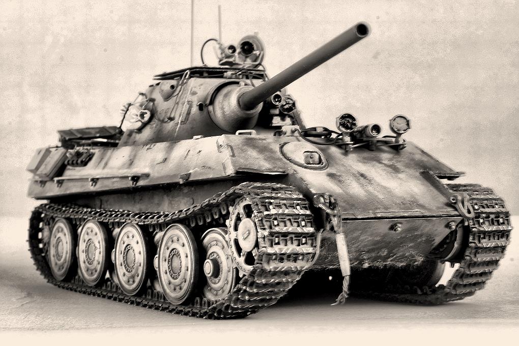

Here's the photo of spaced lower front hull armor. Looks not quite real to me, for instance the huge bolts holding on thin spaced armor on the lower hull front and what may be too much infrarot goodies. Also, the broken tow cable does not look real. Might be a model of a Panther 2, but I'm no expert. It is a Panther 2 turret.
jhamm
Posts: 1114
Location: Germany
Re: Tamiya Jagdpanther overhaul and new transmission
Post by jhamm »
sevoblast wrote:
This Picture shows a Panther F
It is´nt a Panther 2 turret!
A Panther 2 turret never existed, there were only drawings.
This is the well known "Schmalturm"
sevoblast
Posts: 170
Joined: Mon Jun 08, 2009 4:36 pm
Location: Krasnodar Krai
Post by sevoblast »
Ergo the photo is not the real thing. I suspected as much.
