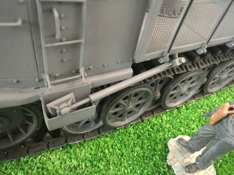

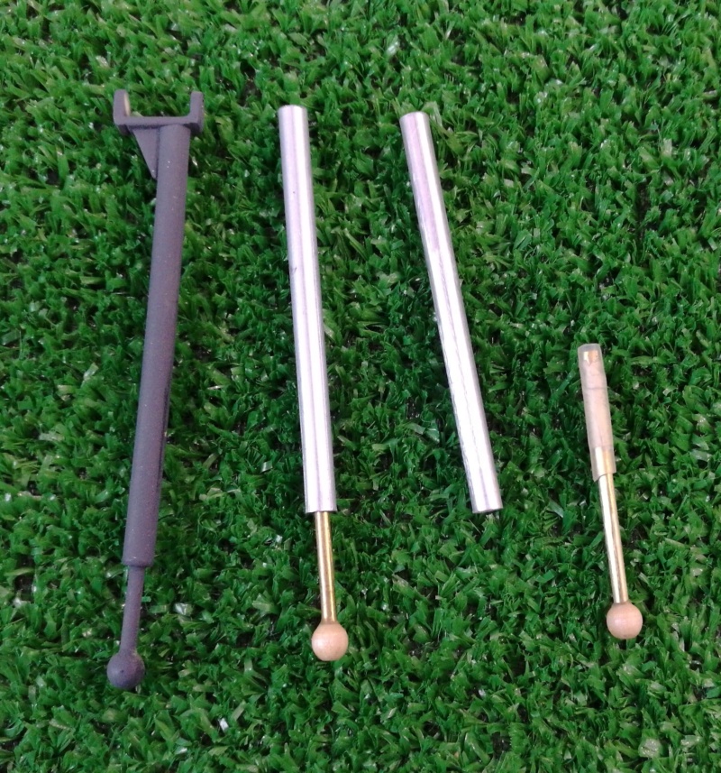

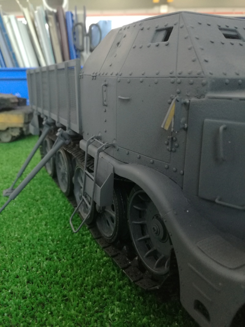

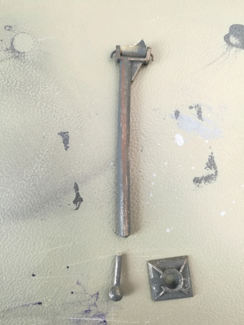

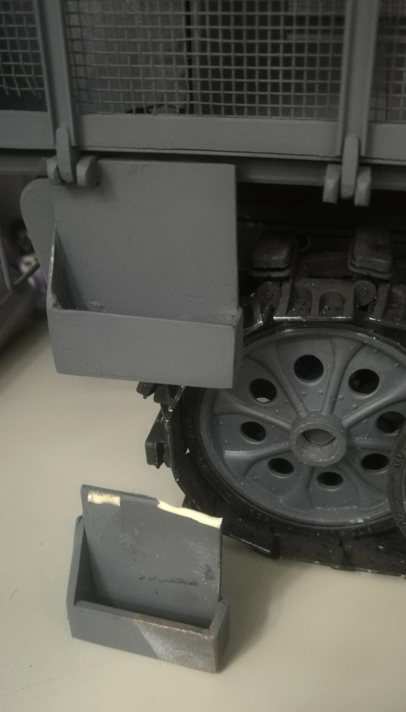

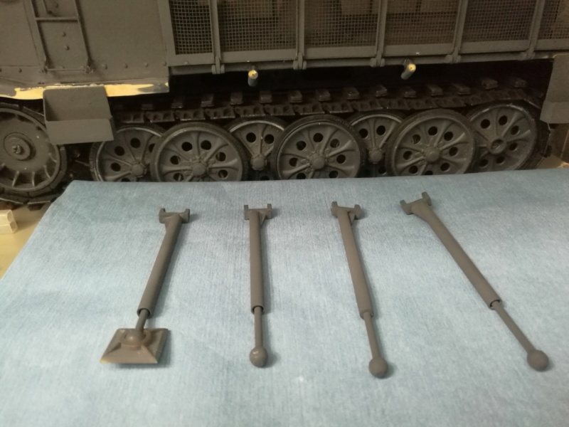

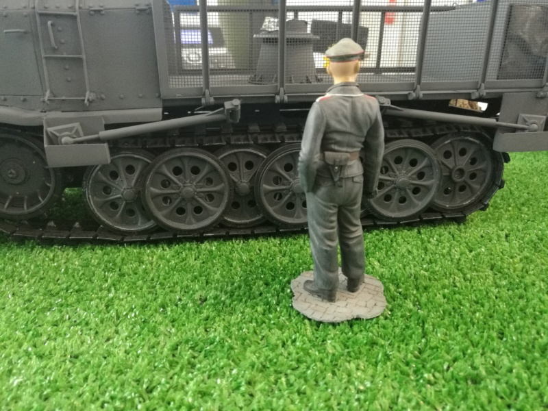

the work continues:

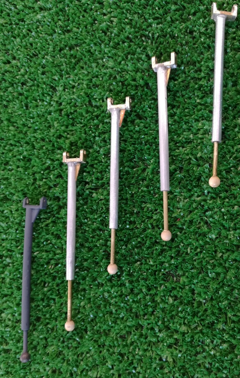

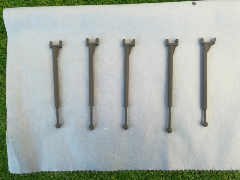

The soft rubber tube centers the cabinet stem and allows the stem to move in the outer tube

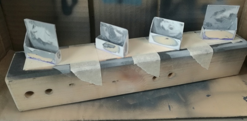

The various stages of assembly, we are close to industrial production

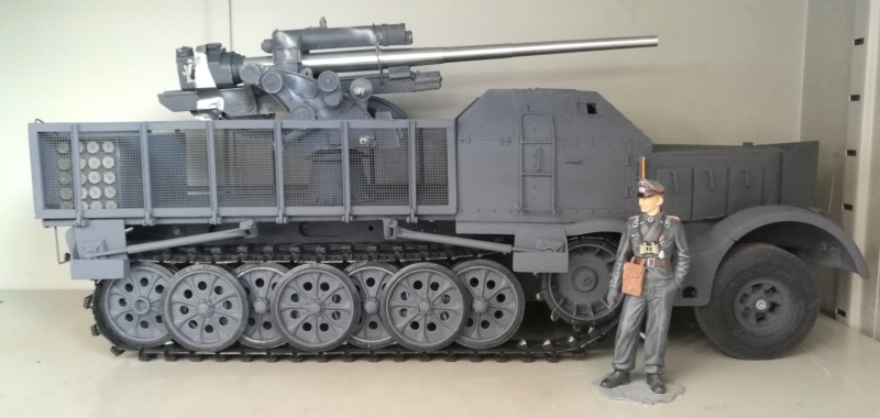

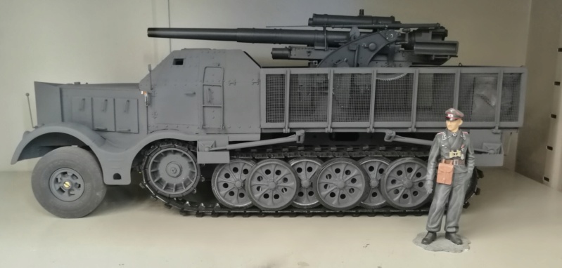

the first one on the right is the resin
The dimensions of the sphere satisfy the officer. Finally the stabilizing legs:
To gratify the soul of the spectators, the workers positioned turret & Rheinmetall. Definitely an imposing stuff: lol !:

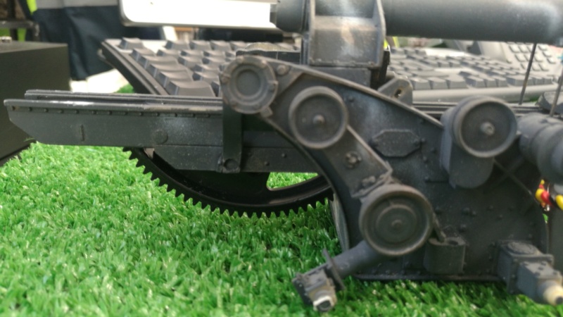

After a period of tribulation, looking for suitable servos for use, we finally found a valid solution:
the barrel of the 88 is held in position by paper tape but was indispensable for evaluating the reaction to the weight of the chosen servant
in the second video you can see the position of the servant who commands the elevation. It acts through a toothed wheel directly on the toothed arch which is located under the slide

The struggle continues, let's go back to the trenches:
The rotation of the turret had been brought home. Now the elevation. Recoil was missing. I was trying to convince myself that it was an acceptable sacrifice. After all, he doesn't have to shoot.
But the motto of "Patrie Officine Studios" is "Zero Tolerance". or compromises. No fallback solutions. Virtually three weeks of work. To think technically correct solutions, with acceptable impacts on the model.
There he is:
I thank Ivano for his splendid card (IBU2) and for the support he gave me.
It seemed impossible ..... also this time it seems to me that the result has been achieved.
Put the breech back in the correct position:
