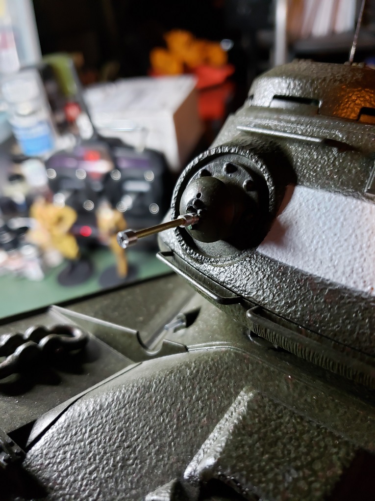

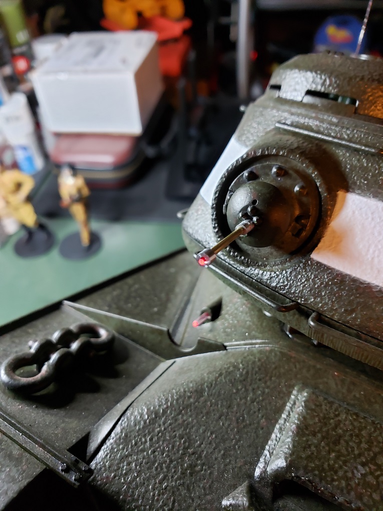

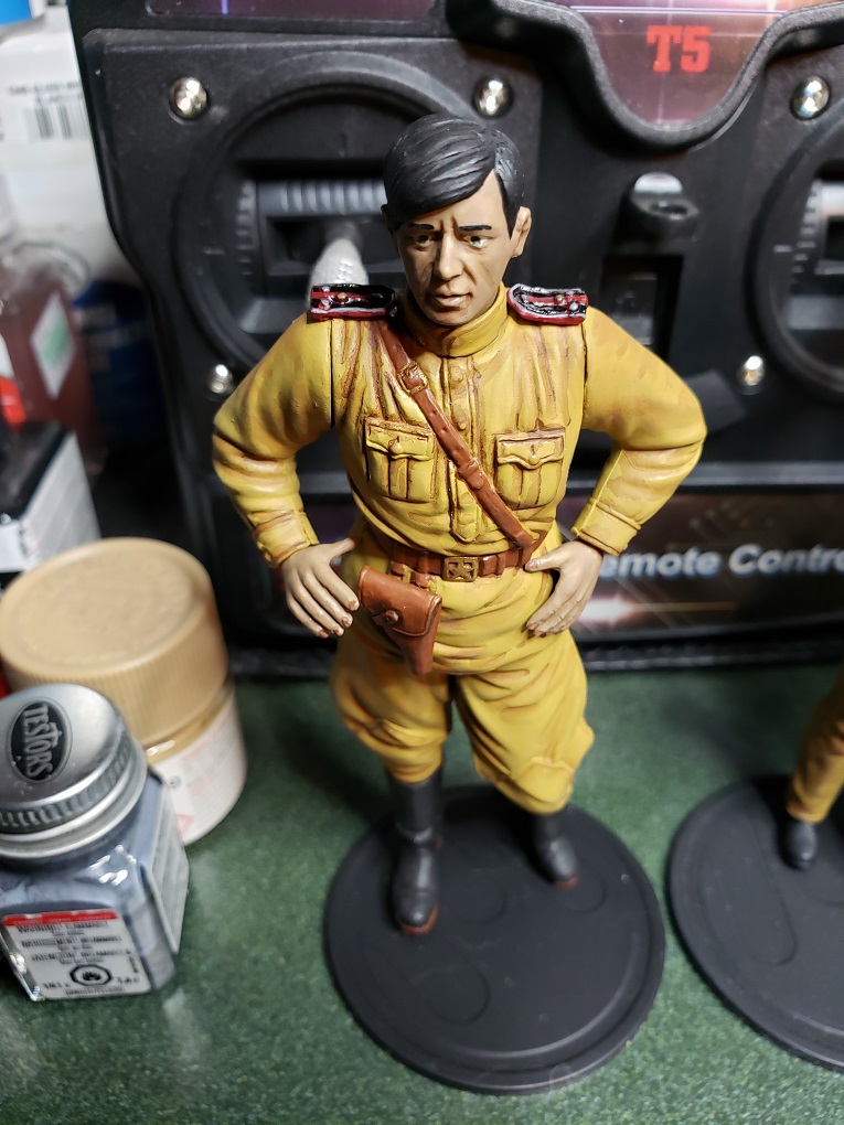

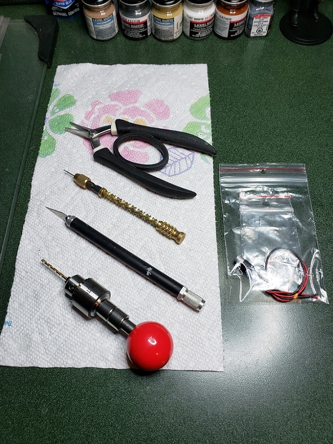

Tonight's work involved correcting the Commander's epaulets and that led to some paint touch up but he is finally done. After that bit of fun, I got to work on the tank...PICS ( Click to enlarge )
Purposeful barrel droop ready for paint
Success!
Success!
Test fit of the barrel
The bow fibre that simulates gunfire is thankfully intact.
Removing the broken fibre piece involved careful hand drilling with a couple of different bit diameters

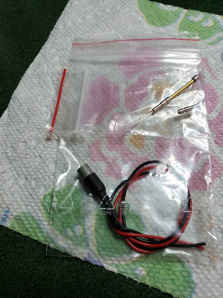

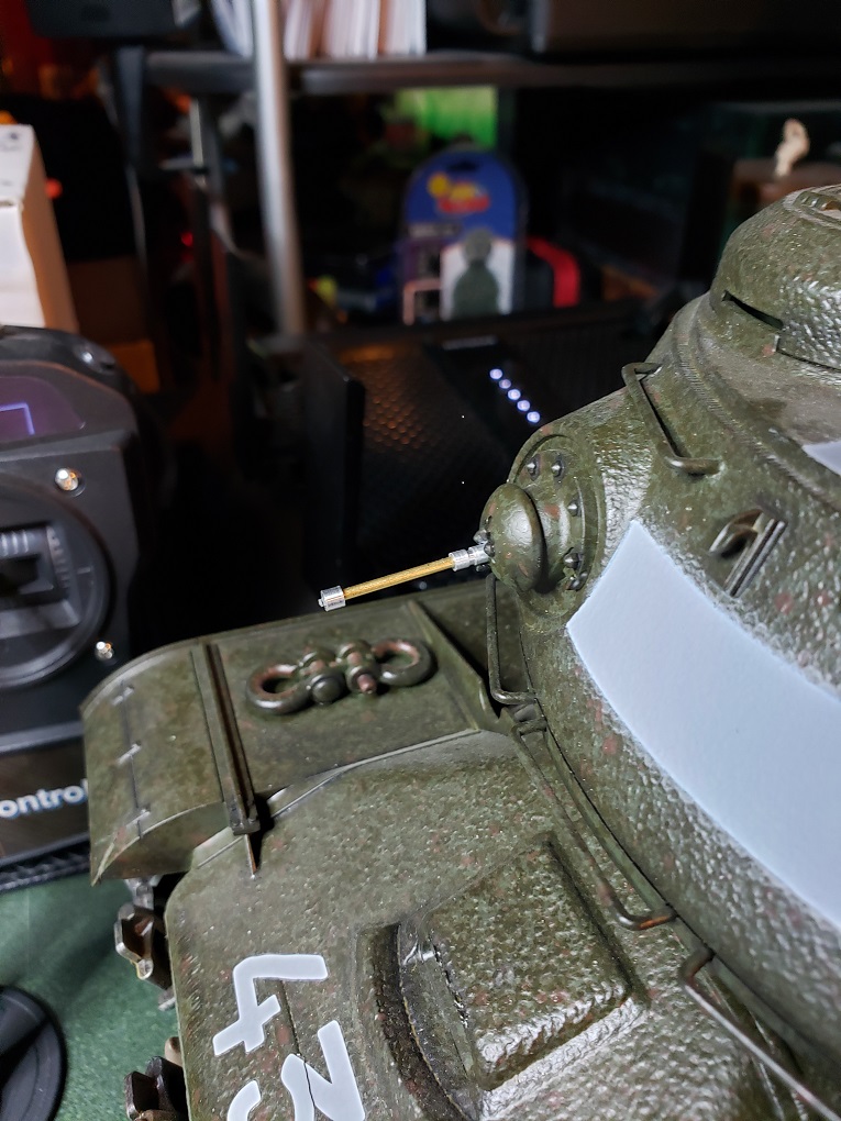

First work on the tank was to repair the broken fibre on the turret mg and install a brass BUG mg.
The swap called for paint touch up but he is finally done
Realized the Commanders epaulets were on backwards and swapped them around...

Agreed. Much better. Did you buy that MG or scratch it? If bought, can I please get a link, and if scratch, a more detailed tutorial would be much appreciated.
Posts: 7629
Re: 1945 WWII Soviet IS-2 ( TAIGEN\TORRO )
Good morning Gentlemen!
Apologies for the late reply. I slept in on Easter morning ( Happy Easter all, BTW ) and am now enjoying egg salad sammiches. Thank you, Carl! Gary, the complete MG is the one from RCTank.de and is originally a replacement for the KV tank bow MG. Drop the under barrel brace and it works perfectly for this tank. Here is the link:
https://www.rctank.de/KV-1-Bug-MG-with-accessories

Love the figures, what colour did you use for the uniform?
I need a commander for my bed spring T34 and if Mr 52 would consider letting one go, he would be just the hero I’ve been looking for !
Posts: 7629
Good afternoon, Herman!
Commander uniform colors are Model Masters Sand and Dunkelgelb light coat flats from a rattlecan over a coat of Tamiya Fine Grey primer. Shadows are Tamiya pre mixed Brown Detailer. Happy Easter Egg Sammies!

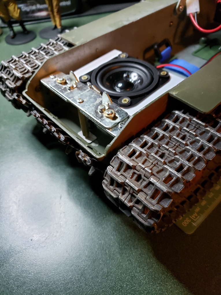

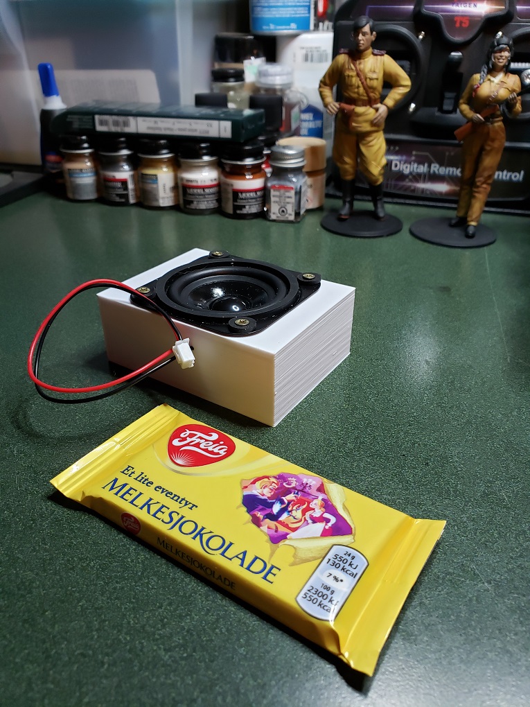

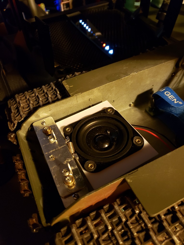

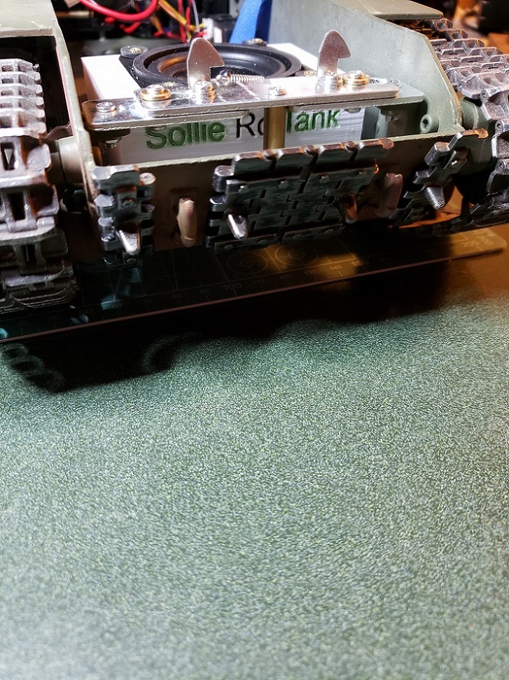

Yesterday, the improved speaker for the tank showed up from Maxmekker in Norway. I installed it last night and the tank sounds can now be described as 'Amazing!' The slightly larger size of the speaker housing has shown the need for a smaller or flatter battery. People I speak to have convinced me that NiMh batteries are going the way of NiCad types when it comes to Hobby applications. I am planning a visit this evening to one of those retail battery Shops to see if I can get a Li-Ion type one made up ( still don't completely trust LiPo batteries ) Pics: (Click to enlarge)
A better view of Max' handiwork.
Housing is a pretty good fit with .25 inch leeway on either side.
Speaker installed using the same mount screws as the stock TaiGen unit.  Embellishment colors added by me.
Maxmekkers Finest Chocolate and Speaker

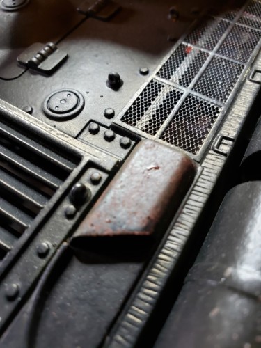

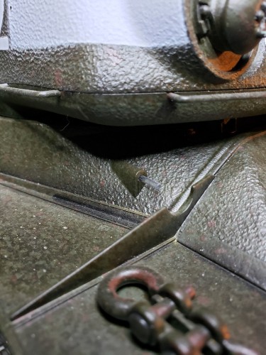

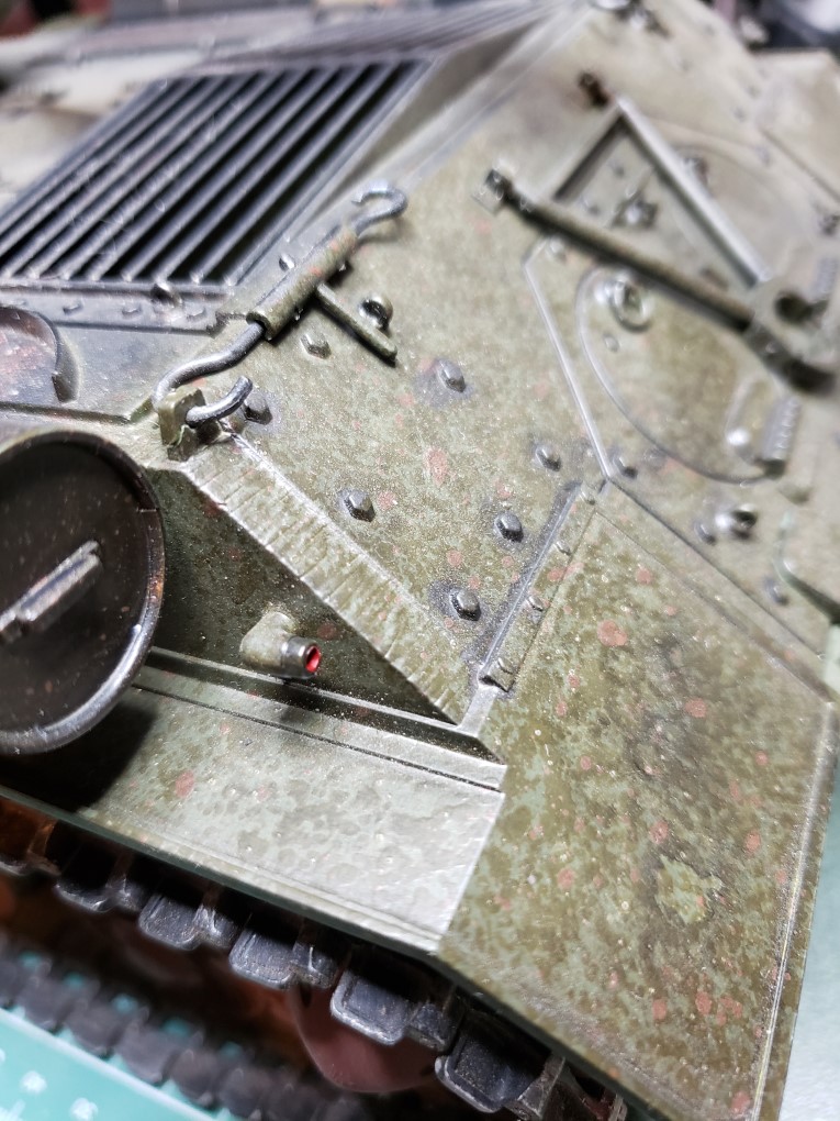

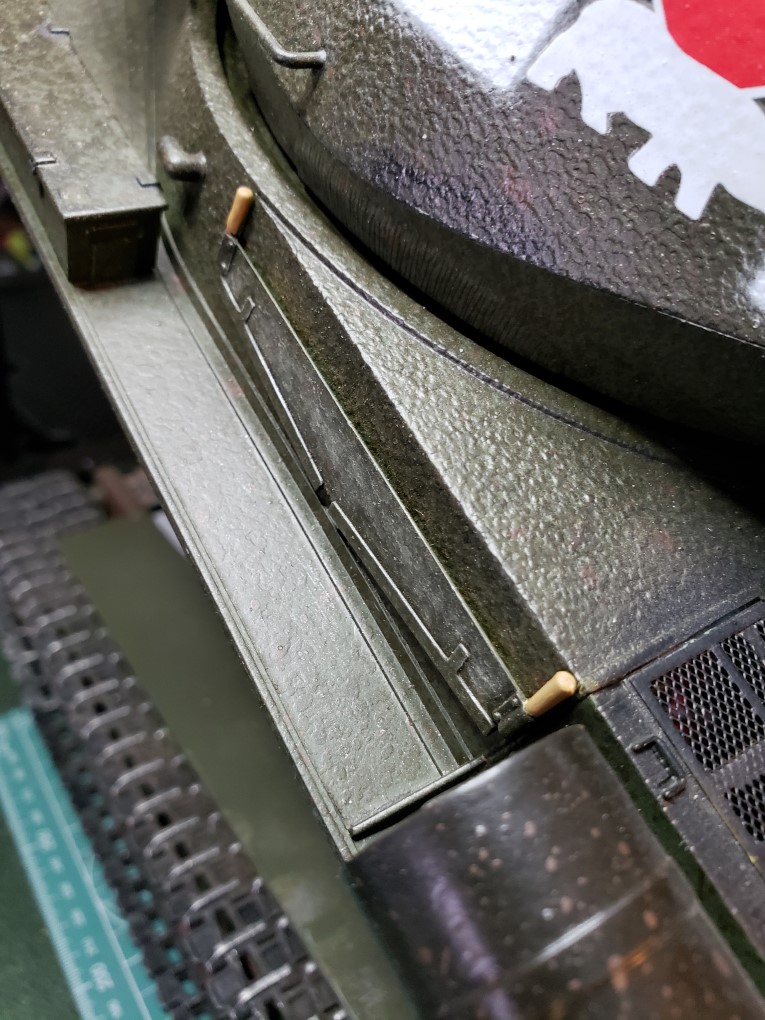

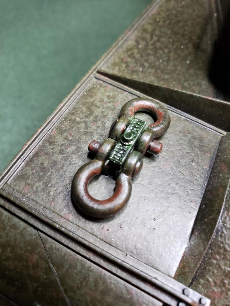

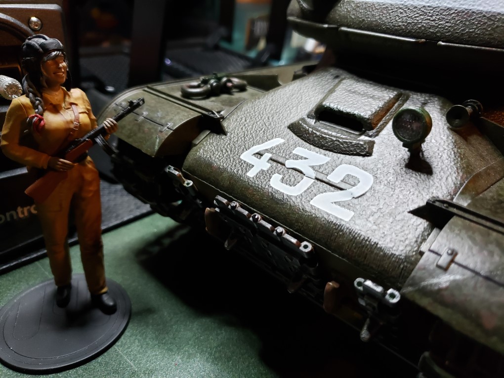

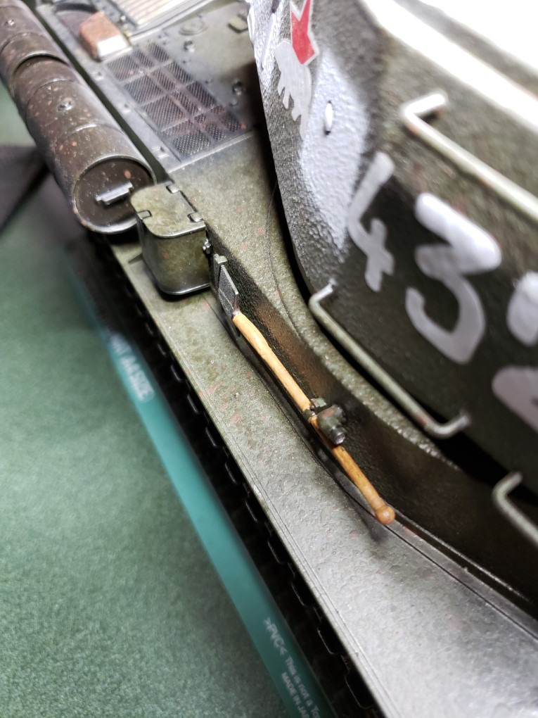

A little more detail work on the lower hull and deck. I still need to find or scratch some micro lenses for the marker lights but they are drilled out and painted inside for a start. Work is ongoing in drilling out the track pin runs for the spares up front. Pics: ( Click to enlarge )
Making progress
Making progress
The Loader approves...
Some of Taigens built in detail
Rear marker light
Rear marker light
Missing clamp added
Missing clamp added
Marker light closeup...drilled out and silver added
Detailing the hull underway
...Here for the Dawn...
