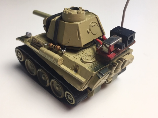

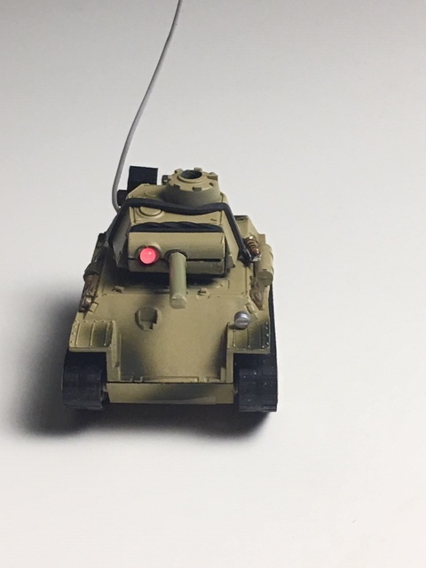

Recently rewired the tank so that the motors are in parallel drive as opposed to series wiring. added a gun barrel to the Tan Panther as well. And a power on LED. The Led is on when the switch is on and the tank is not moving.
The Tan Panther micro Tank can run in a very small area so a kitchen table is ideal. A small scale obstacle course can be set up on the table for a challenging run while sipping some morning coffee :)

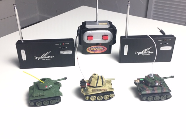

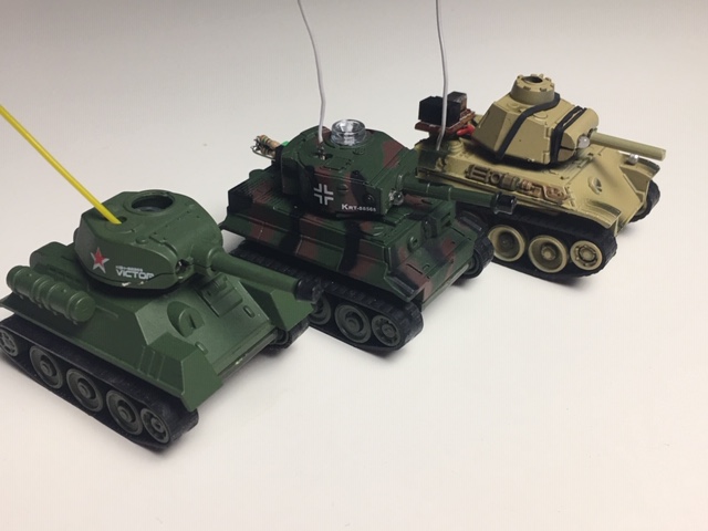

The T-34 is stock and runs well.

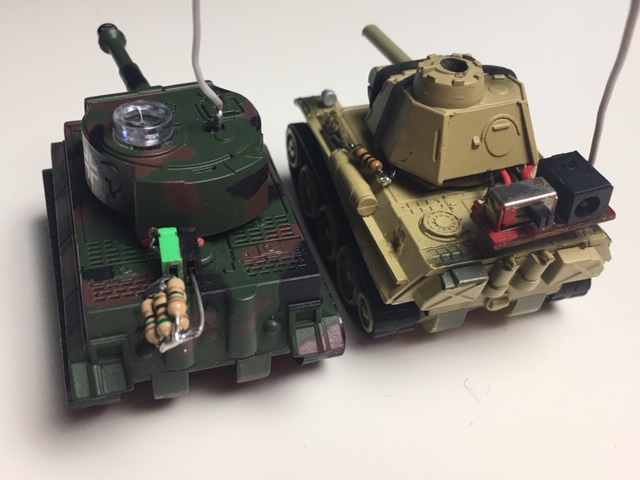

Tank on the left is being tuned for proper speed. The one on the right has been tuned with a 10 ohm resistor.  Both of these Tanks come with on\off switch and charge plug.
Charge plug and on off switch added. Powered by 1s lipo.

micro Panther is powered by a 1s 65mah lipo

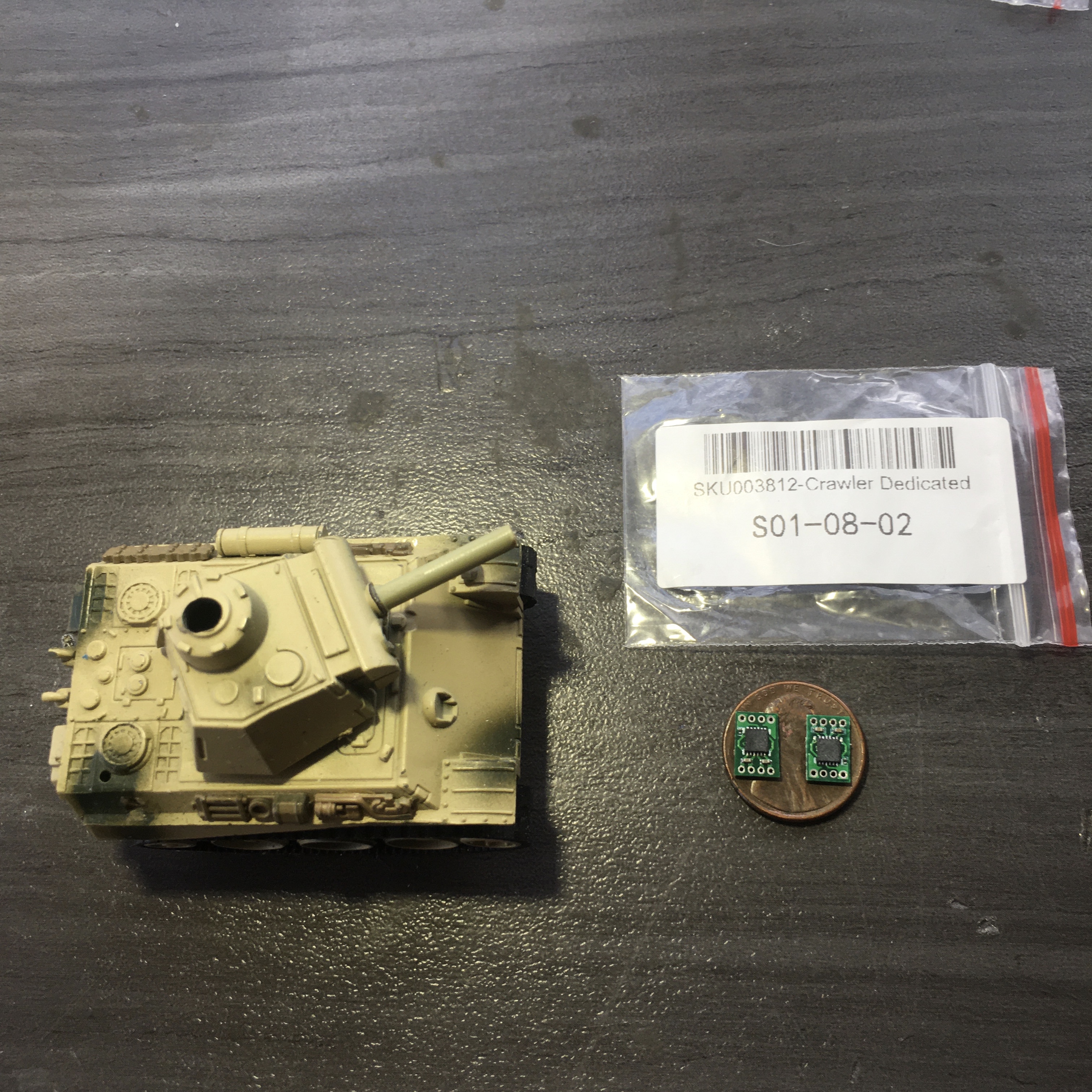

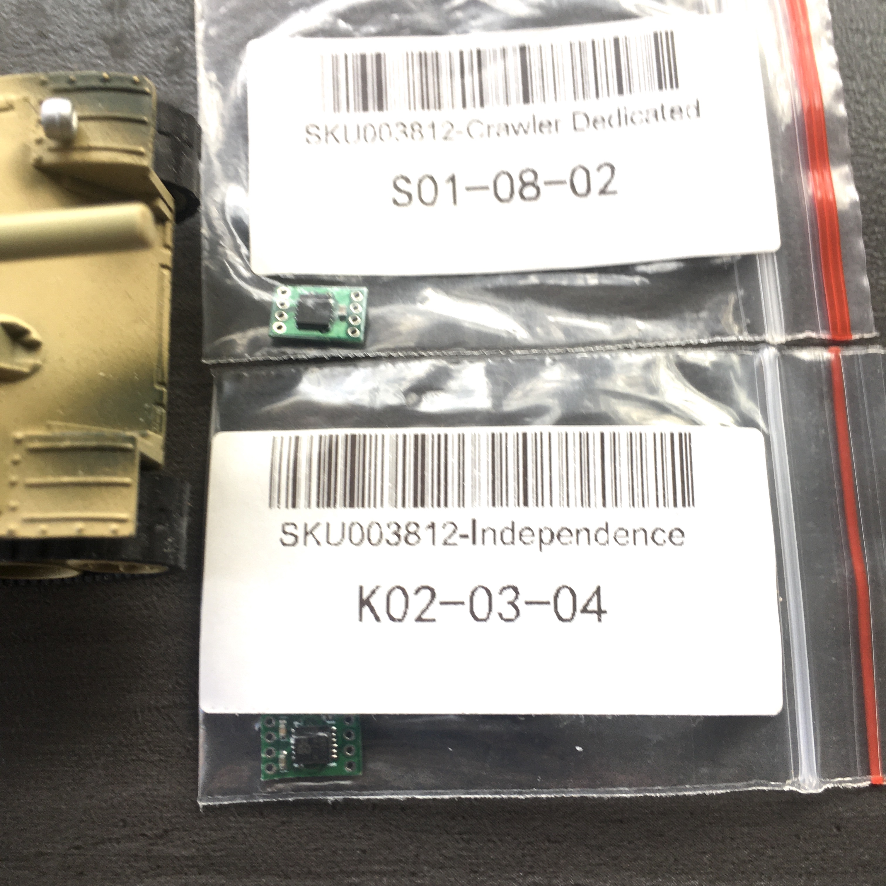

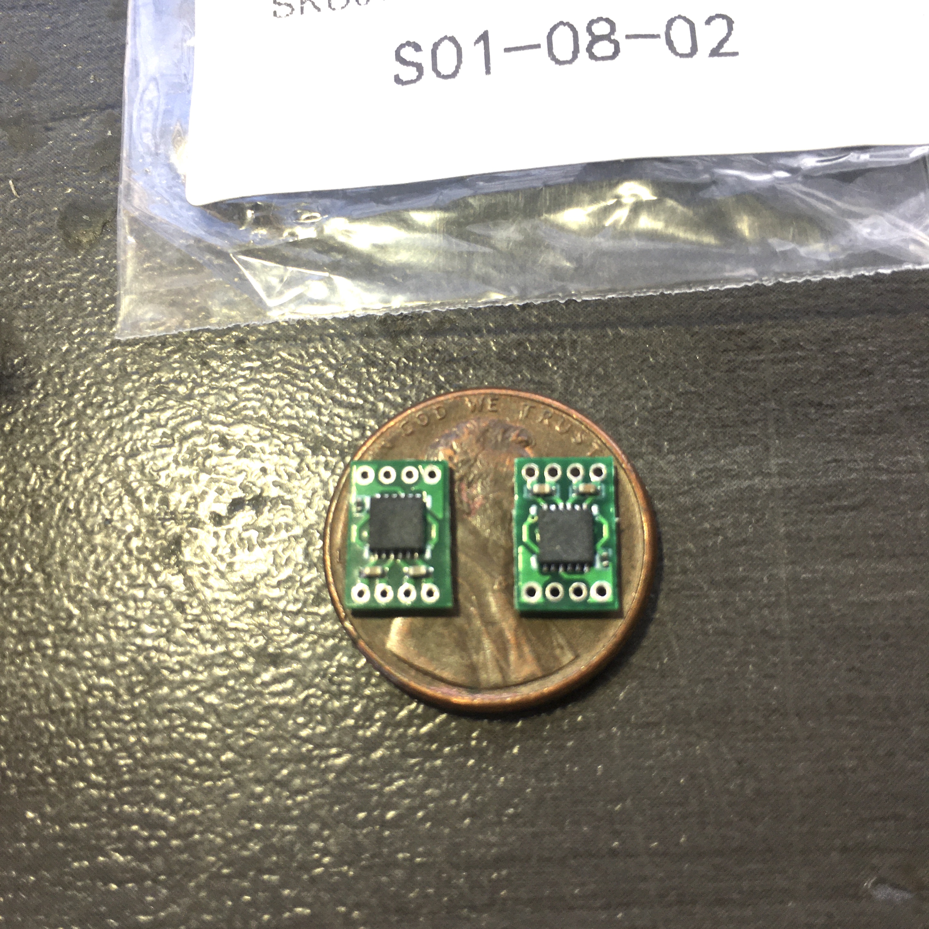

I just got some very small ESC's that may allow for these tanks to be upgraded to Hobby grade electronics 8)
This will require my smallest HG radio setup to date.

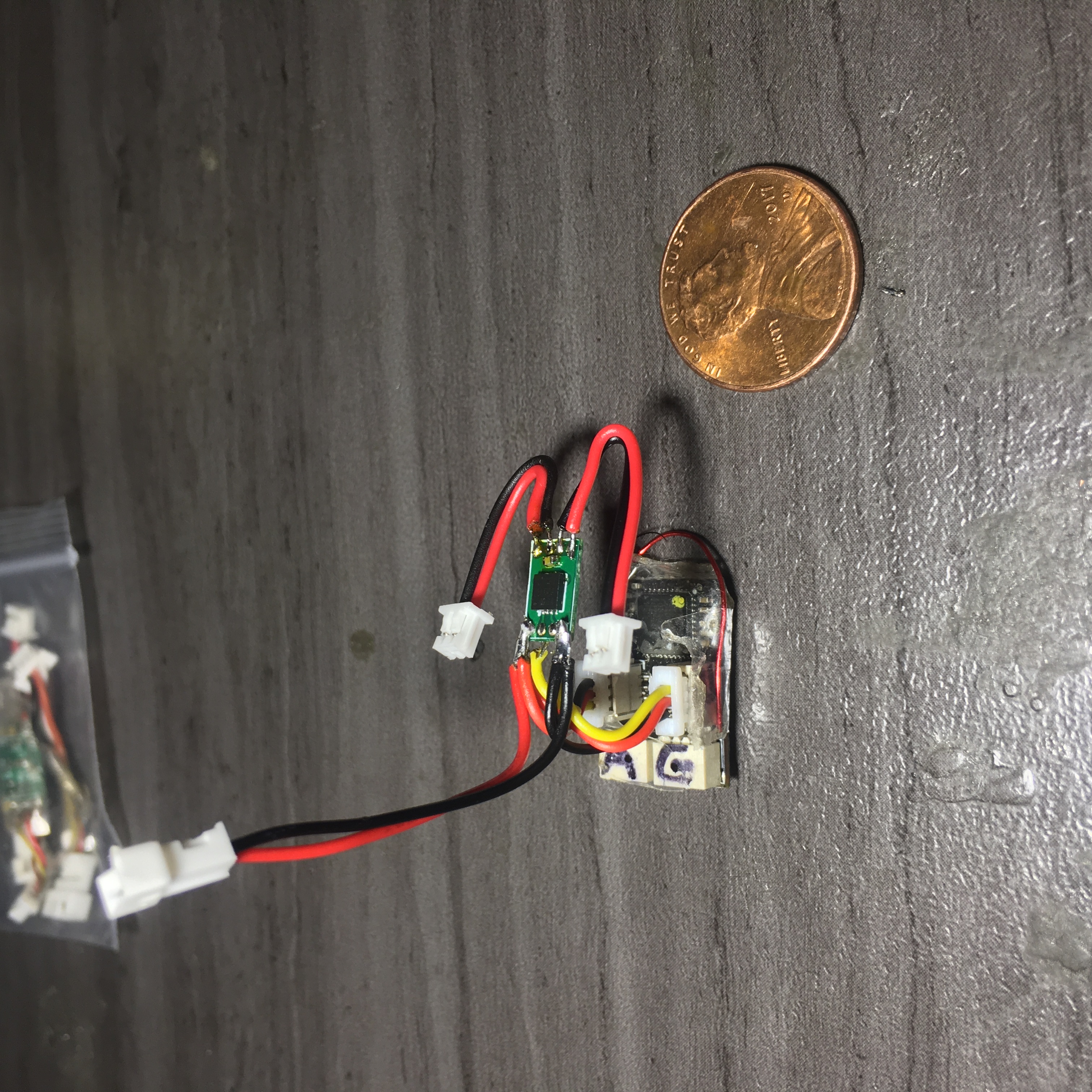

Unbelievable! 4 ESC's on a penny
Dedicated = track mixer. Independence = individual control both ESC's No track mixer

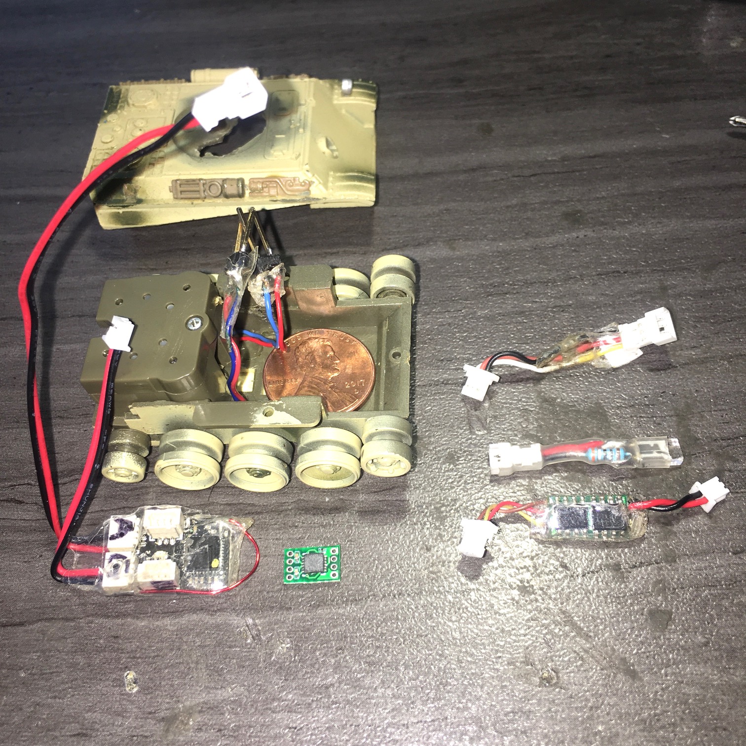

Ok boys, I am going for it, "World's smallest Hobby Grade RRC Tank @ 1:77" with DSMX 5 channel RX with Telemetry, dual motor track control.
I have a little time to make this happen. Thanks to the new Ultra micro ESC with Track mixer and a RX42 Ultra micro RX
Now comes the fun part, wiring it all together.
The Panther here is 1:77 scale. One thing that I do know is that this is the smallest RADIO CONTROL Tank available at this time even in its stock form with the Toy Grade radio control system
It will now get a upgrade to 5 channel DSMX Telemetry Receiver with the smallest dual channel ESC with mixer that is available at this time.
1:77 scale Panther with all the elements ready for wiring harness build.
This new Ultra micro dual ESC (bottom) is going to make this possible. It is almost half the size of the Das Mikro SINGLE CHANNEL ESC!

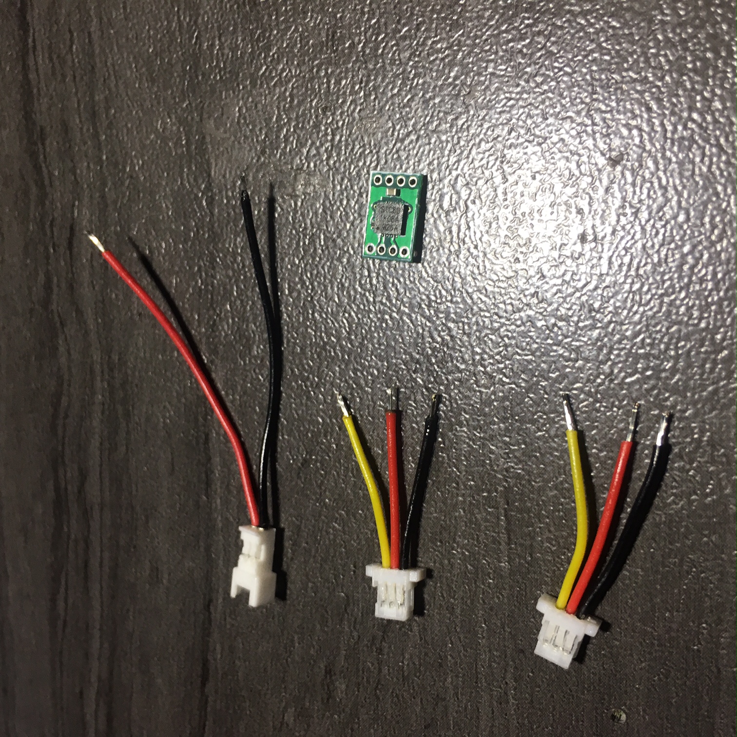

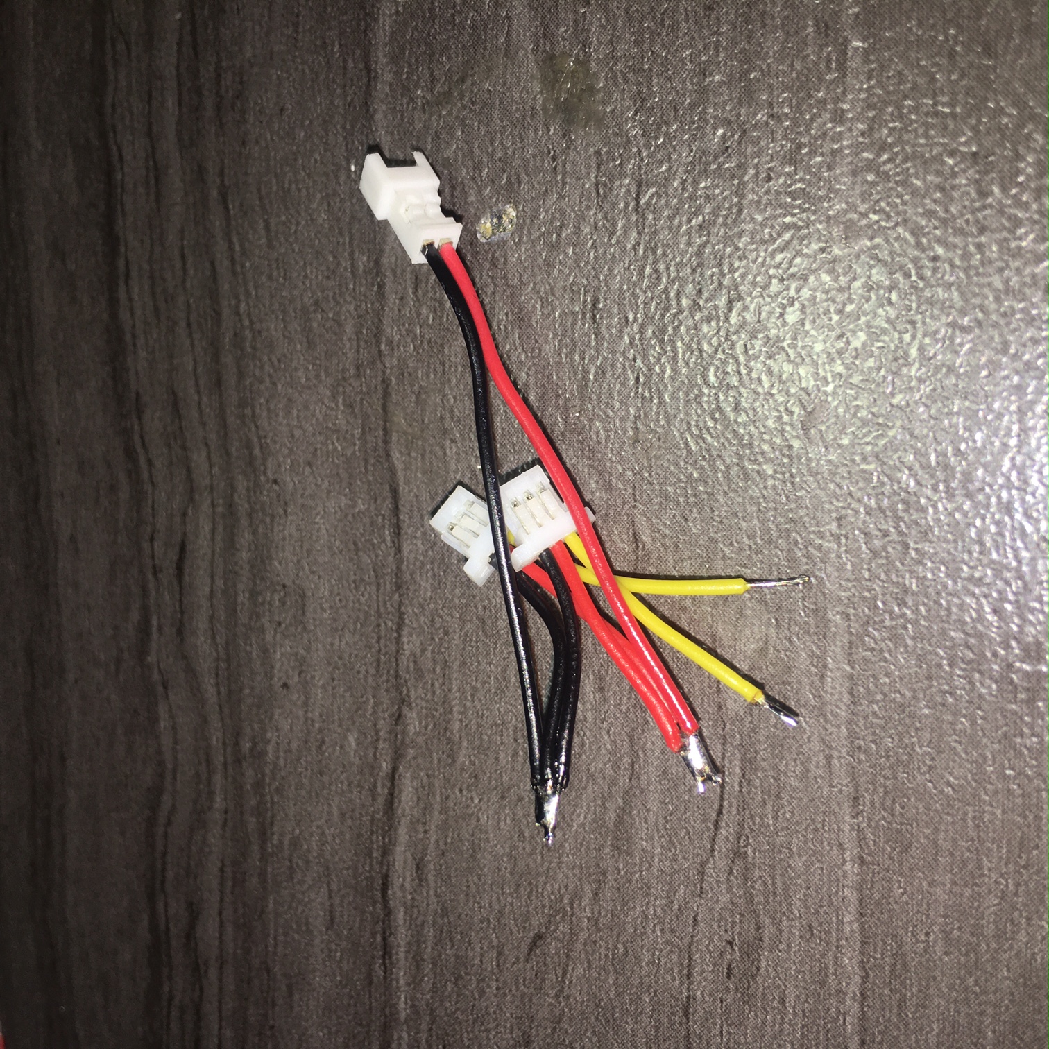

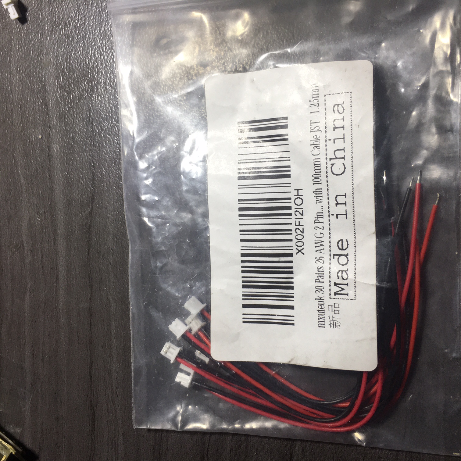

These are high quality 26 AWG connectors that I now use. I was using ~28 AWG but that is just not enough for these type of applications.
Two 1mm three pin female and One 1.25mm two pin male connectors trimmed to length and tinned with solder are ready for power supply\PPM signal harness configuration and installation. Are connectors shown here are High Q 26 AWG.

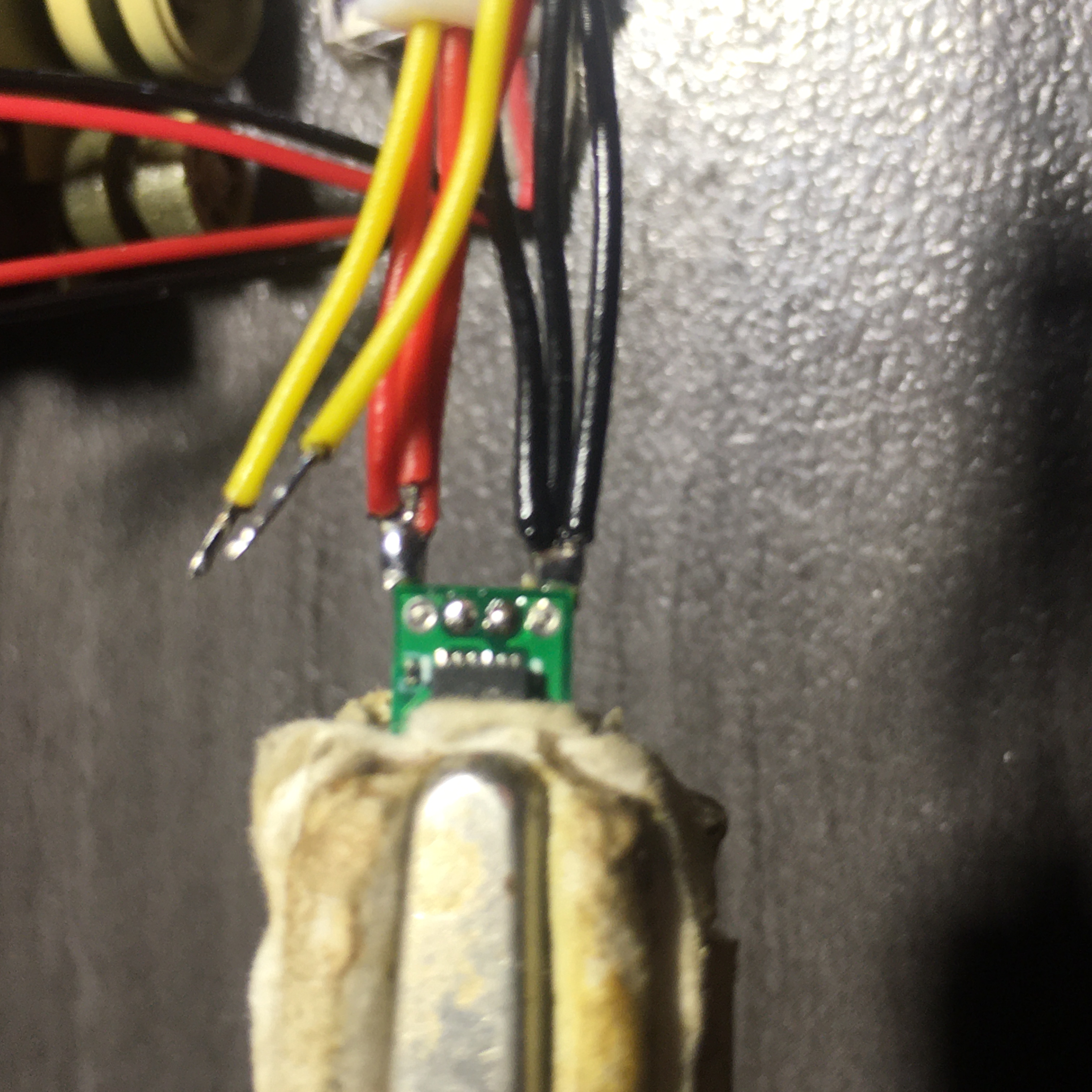

Harness configuration complete with soldering of parallel red\black power supply wires.

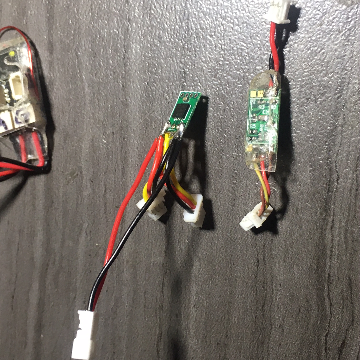

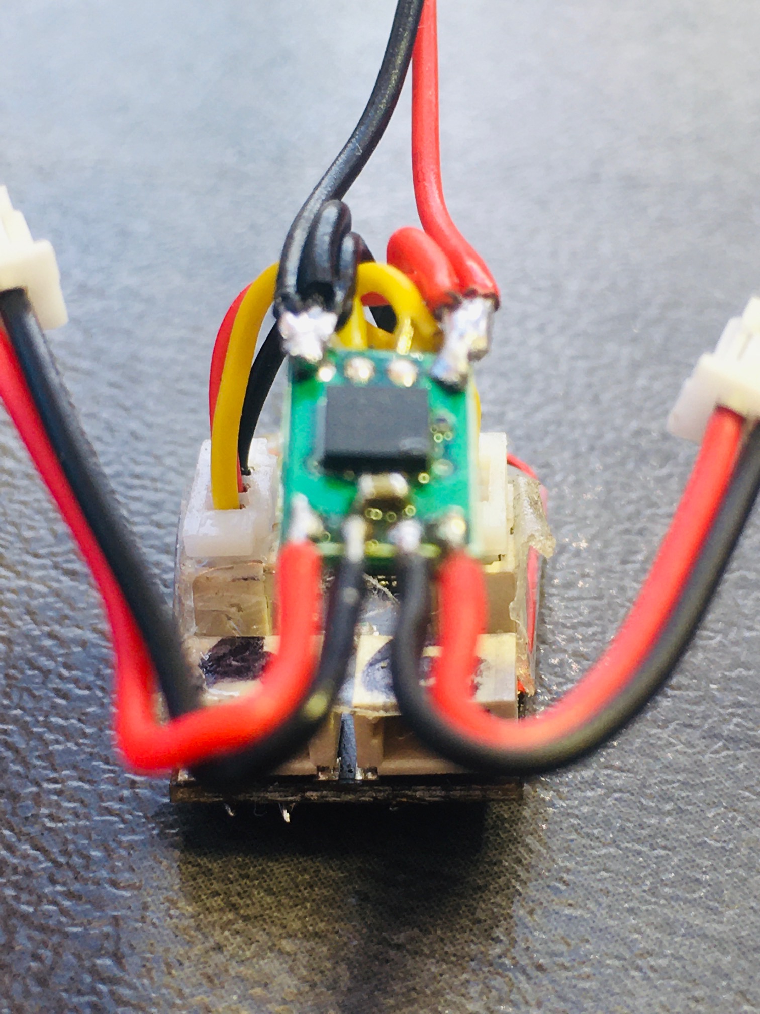

Power supply wires for the ESC and receiver (red\black) which are soldered in parallel are then soldered to the top side of the outer pads on the circuit board. The yellow wires are Aileron\Elevator output wires which go to ESC input  bottom side inner pads. These two connections are the only ones made on bottom side of the ESC circuit board.
Inputs to the ESC are complete, now for the output side.The connectors on this new ESC input side now is heavier gauge 26 AWD than what is on the Das Mikro. <br />The other ESC is a Das Mikro and has a SINGLE output. Uses the same connectors less 1 output.
Two 1.25mm 26 AWD female connectors for dual motor drive output are soldered to the output side TOP side of ESC CB. This must be done properly as a short circuit here will damage the ESC output circuits. Optional method, Solder one connector to the top left side output Top, Solder the other output to the opposite side Bottom. Less chance of short circuit using that method.<br />ALL WIRES ARE 26 AWD for best performance.

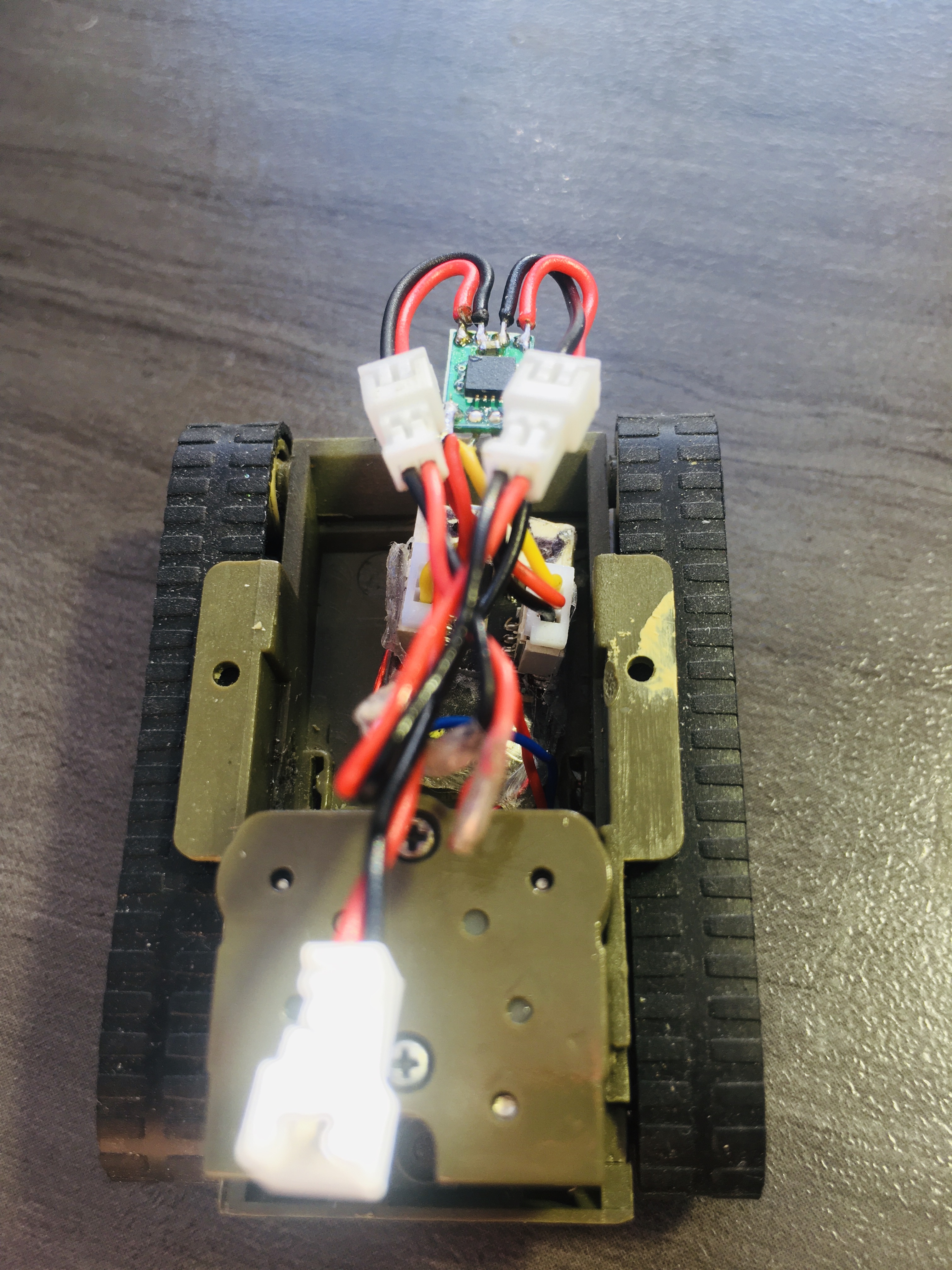

Next step will be to get the wires in position. The wiring has a little extra length and can be molded and bent into final position to allow the upper hull installation
