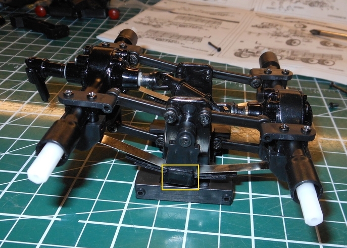

Thanks, I suspected it about the receiver. Just ordered a y cable for the split. Thanks. This is a good idea.
I did not find the small part marked with the yellow box in the pic. It sits on top of the leaf spring set. I do have a bunch of counterparts that do the same on the front axle. They have an oval groove on the bottom that fits nicely that on the axle housing. I understand they need to be different for the rear. Am I wrong?
They also look different in the instruction sheet. No trace of them in any of the bags so far.
As the leaf spring set is attached with two screws I figure it isnt going anywhere without that part. It might give a slightly different clearance at best. What say you?

Hi.
You should have 4 of those 2 for the front and 2 for the rear.
I think they are the same for front and rear.....if you have some front ones left over these are used for the rear as they are the same i believe.
You will need them as these hold the springs in place onto the housing stopping them twisting when the suspension moves up and down with the 2 screws.
From what i believe.
Sub.
Sub.
Re: Wpl ural truck
Yes. I did just that. The instruction gave me the impression that these are different parts. Now I see they use the same part in both places.

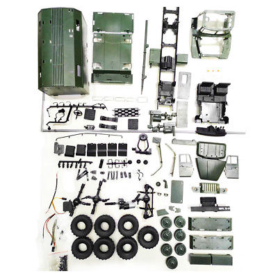

Hmm. makes me wonder. I have not found such a bracket yet. Any images what it should look like?Sub wrote:The servo provided for steering is of good quality and they even supply you with a bracket that screws down over the top of the servo to hold it in its place.
It is black, I assume?

Hi.
Yes its there....
It is black and square with 2 lugs on it that are offset to match up with the holes on the posts where the servo fits.
Sub.
Yes its there....
Sub.
Re: Wpl ural truck
Here you are
You can see the servo cover far left on the same line as the mud flaps. Below the long roof hand rail.
Sub
Sub
