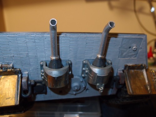

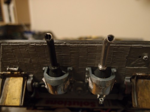

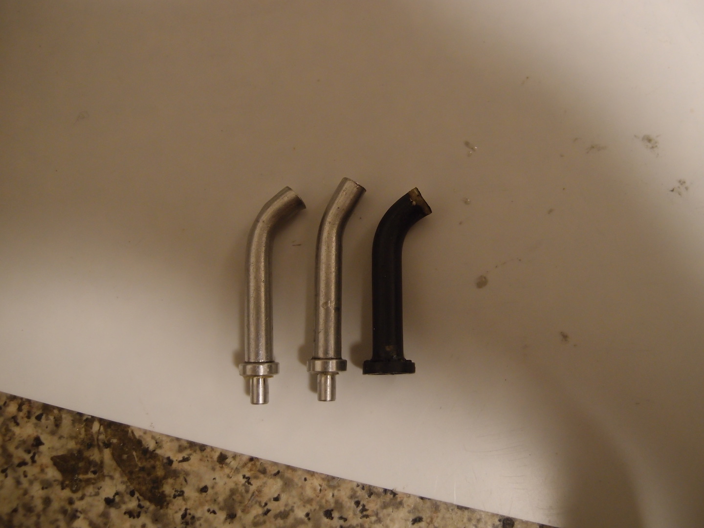

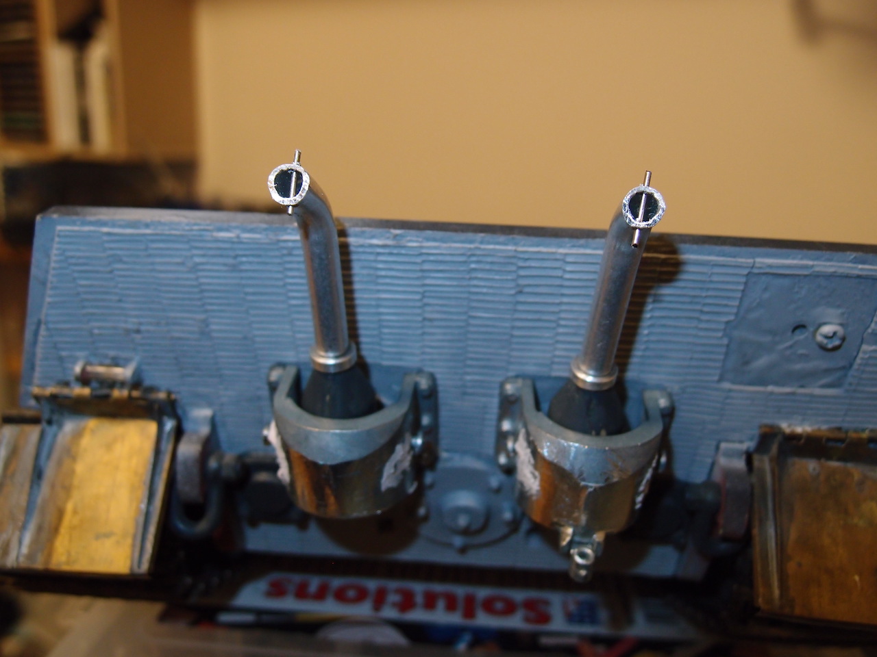

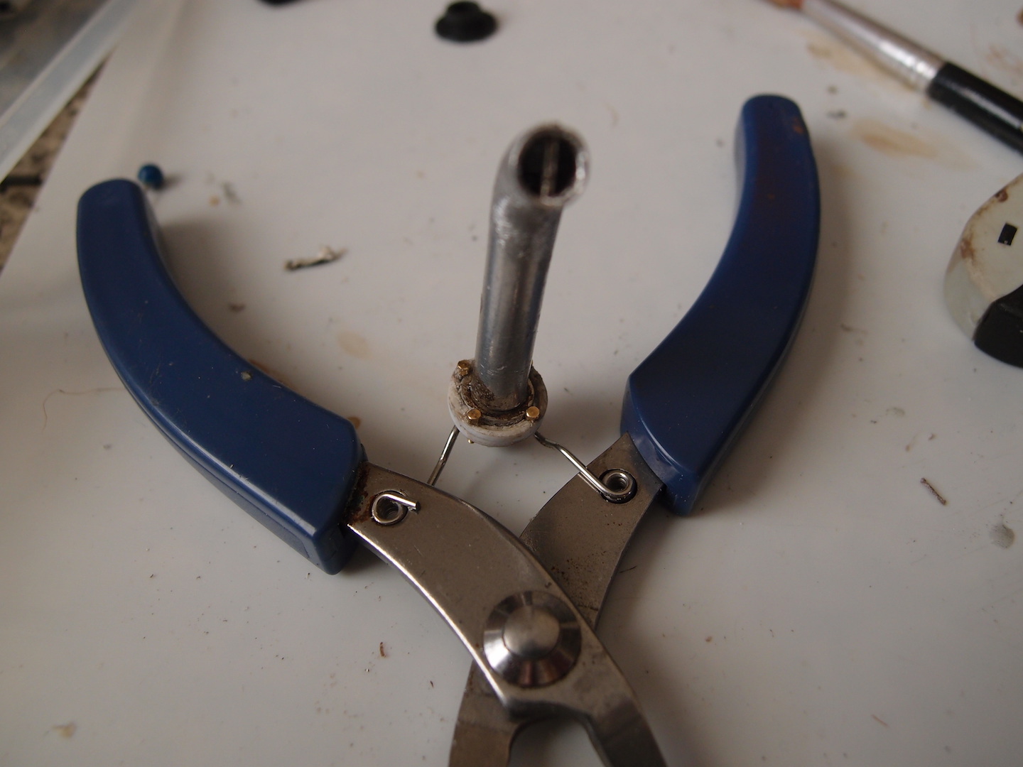

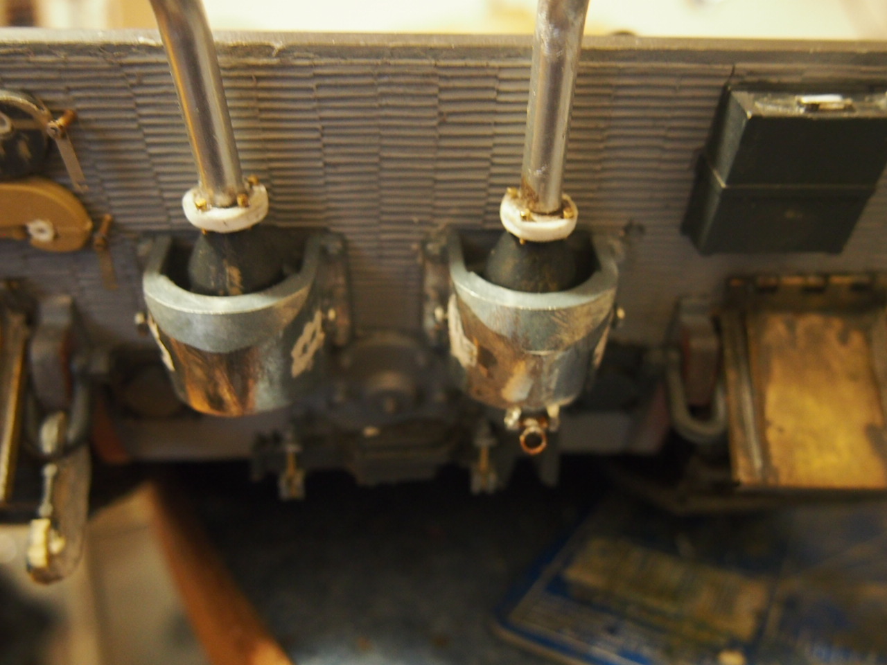

Back onto this for a change , starting on the rear hull
Exhaust tubes need a slight adjustment
armoured covers need filled to remove square section
4 holes to drill in hull and fill little slots at lifting points
drill for rod in exhaust
should thin out top of tube before cutting rod .

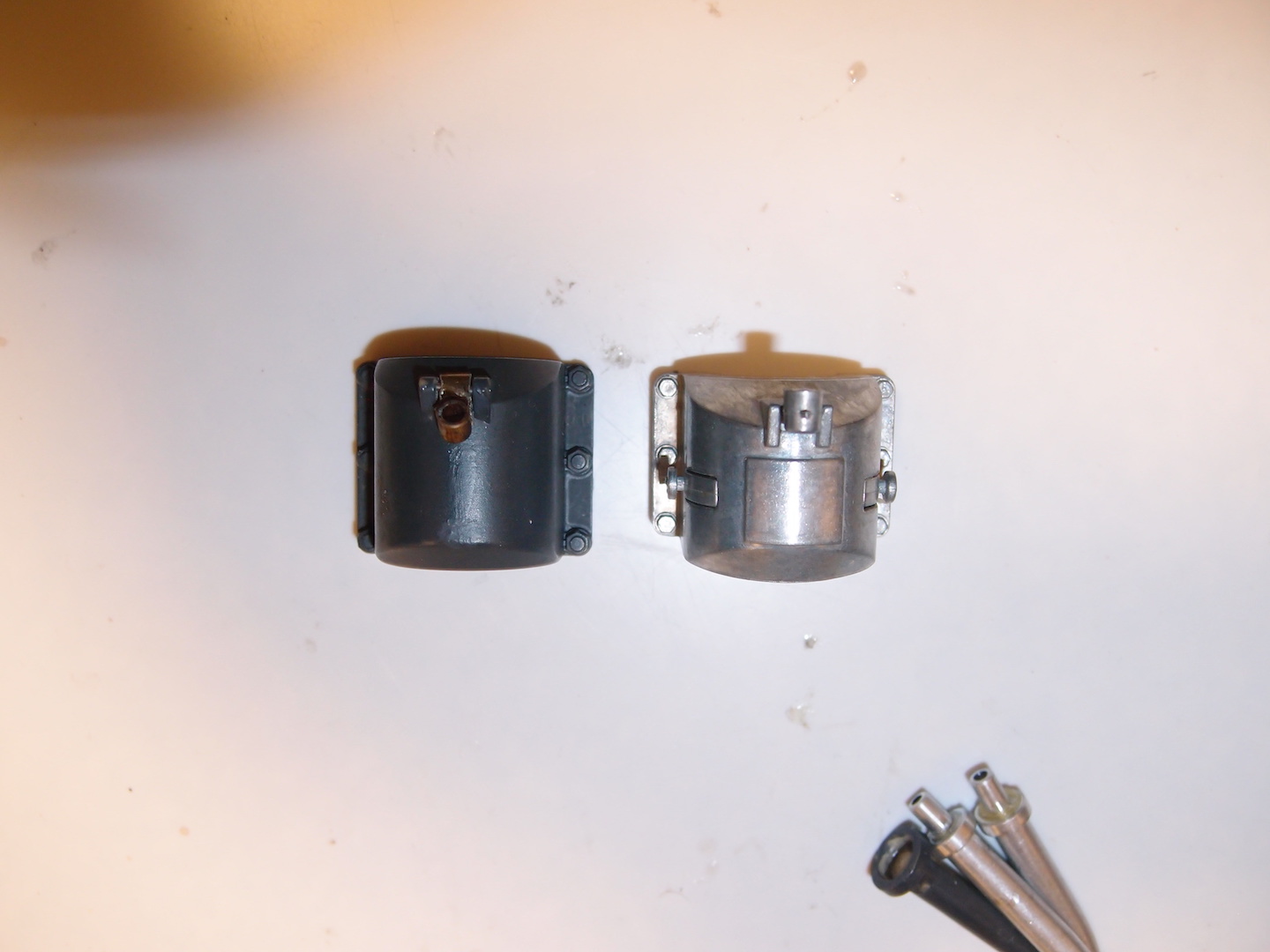

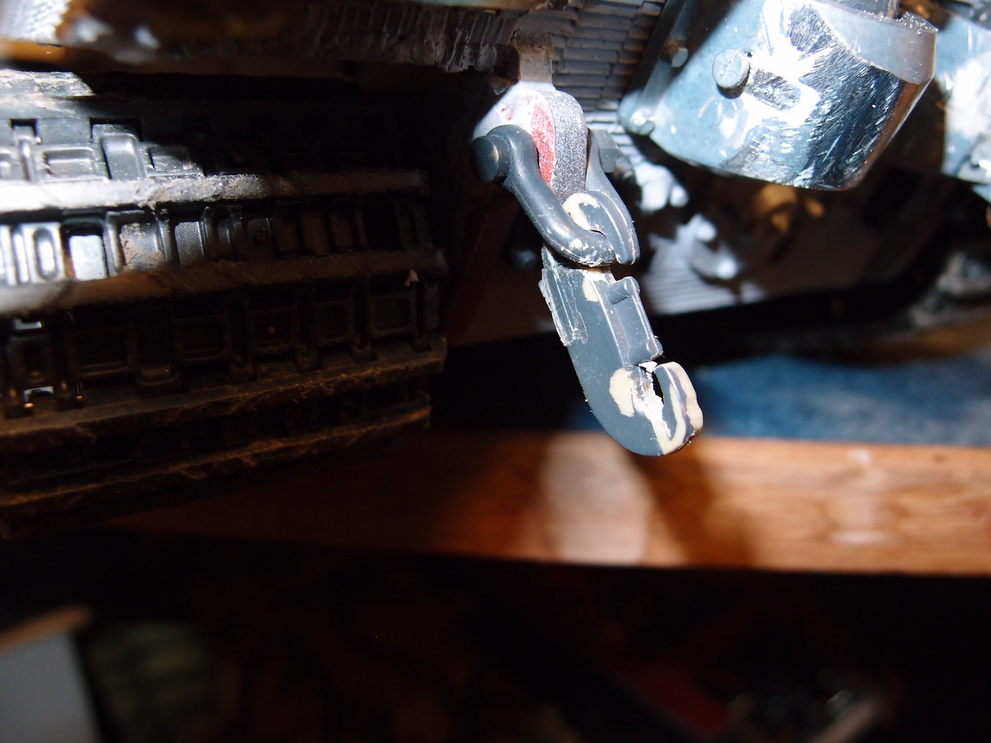

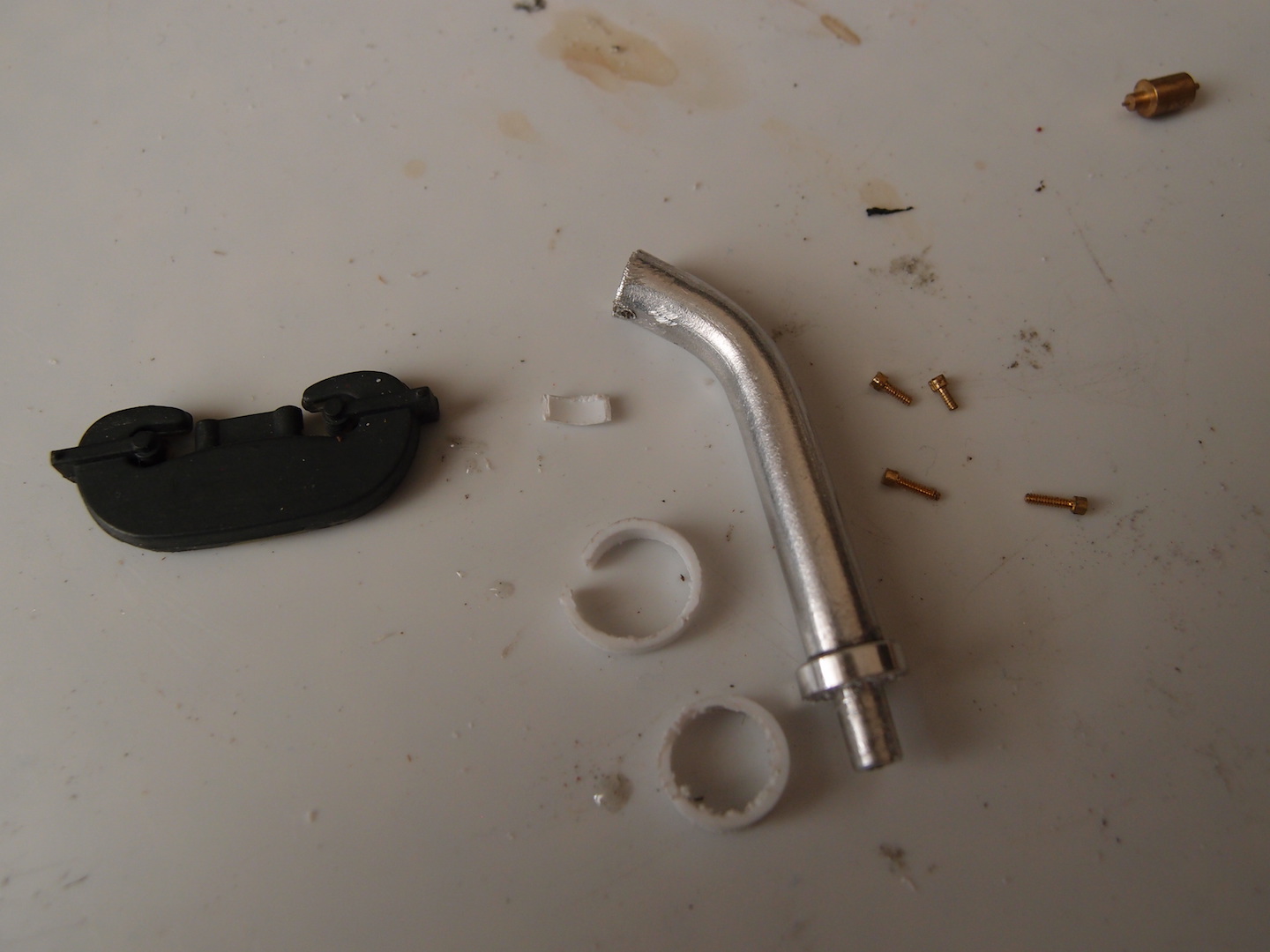

Thanks for the encouragement. Some more work on rear hull

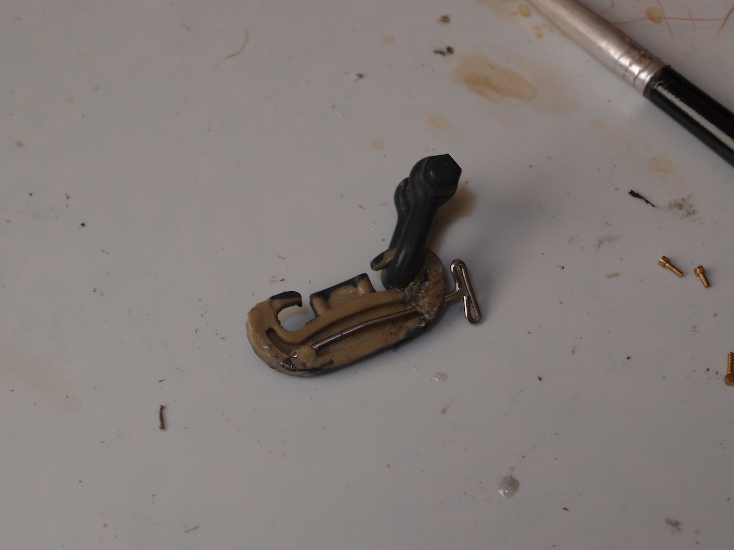

making the flange ring with bolts
making the c hook fit a shackle will fill void , the pin adds some strength after cutting
looks better now with wider flange and bolts
c hook fitted
c hook brackets started and fixed starter guide it can swivel now.

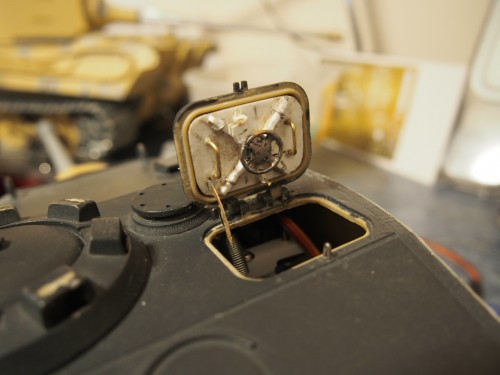

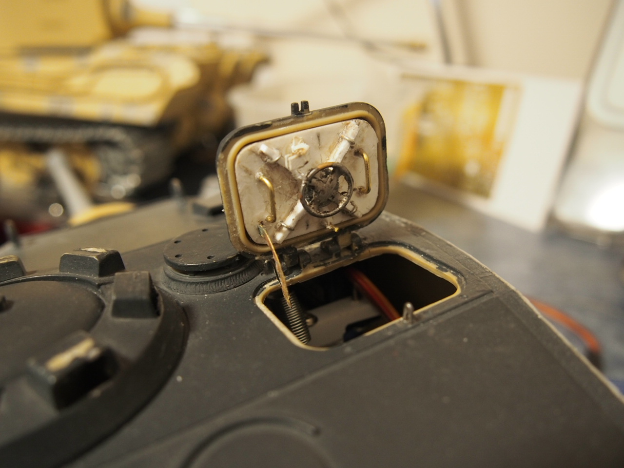

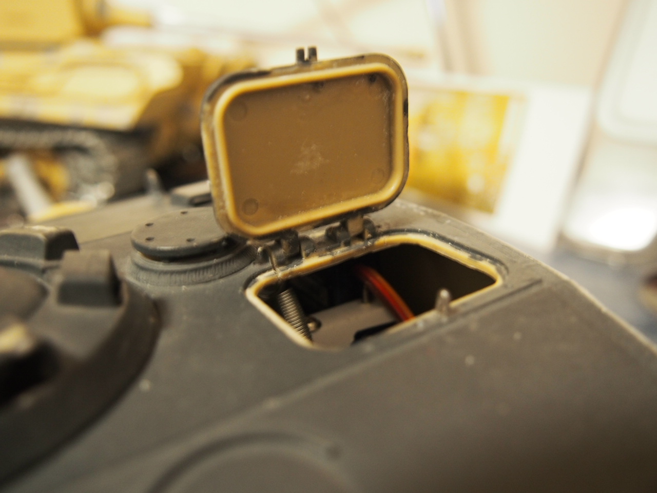

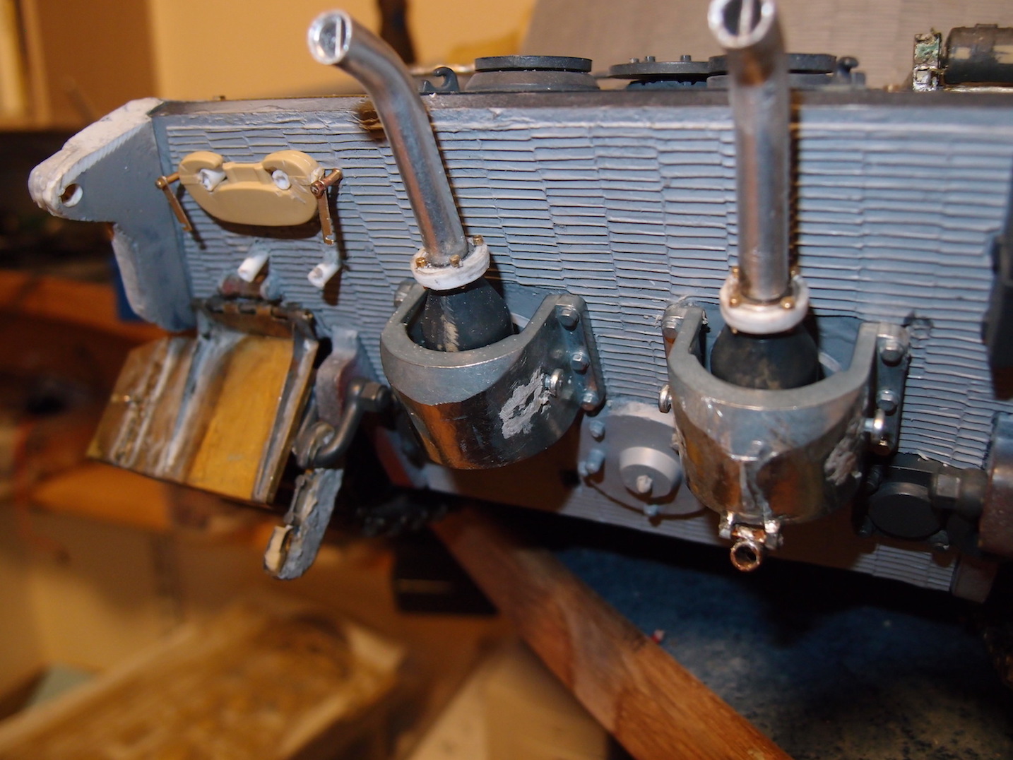

loaders hatch and rear hull almost complete

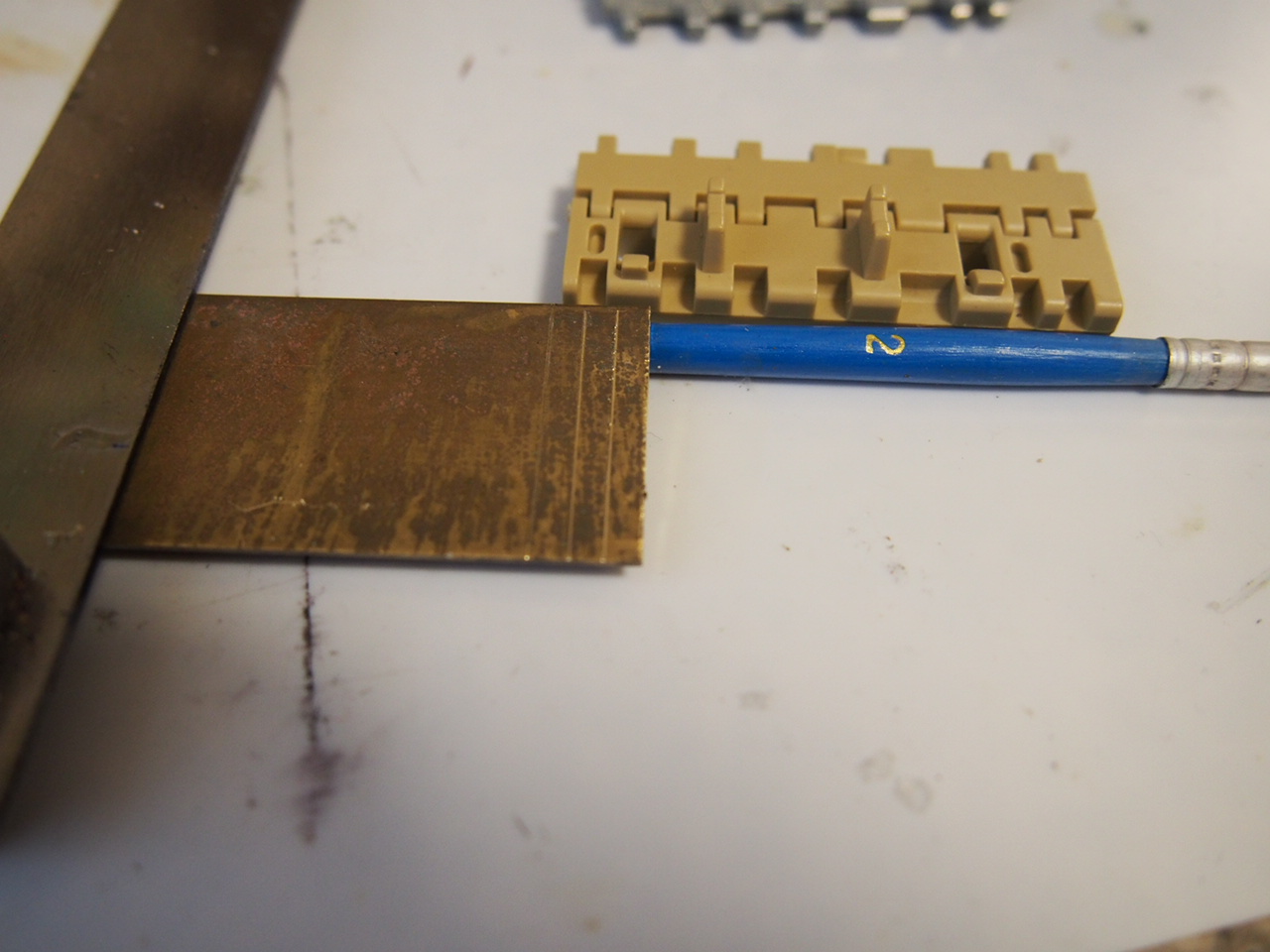

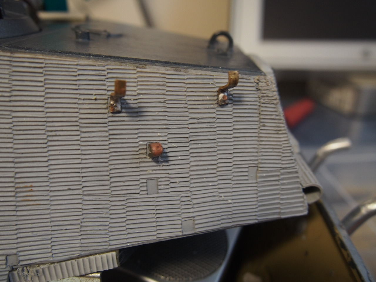

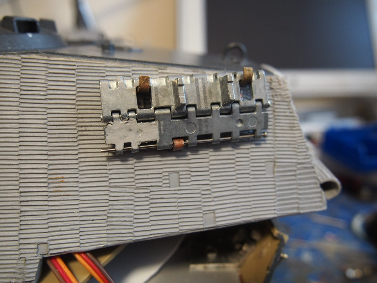

Been putting this off for ages , can't find track hangers anywhere. Does no-one do metal KT track hangers ? Plastic would be easy but i think i would be fixing them quite often as i want to use metal track links .
Will try brass, wish i could find 1.5 by 3 mm lengths .
ronnie42
Posts: 834
Re: 1st generation rc king tiger
Post by ronnie42 »
One down 8 to go , turned out ok just need to make the rest the same size.

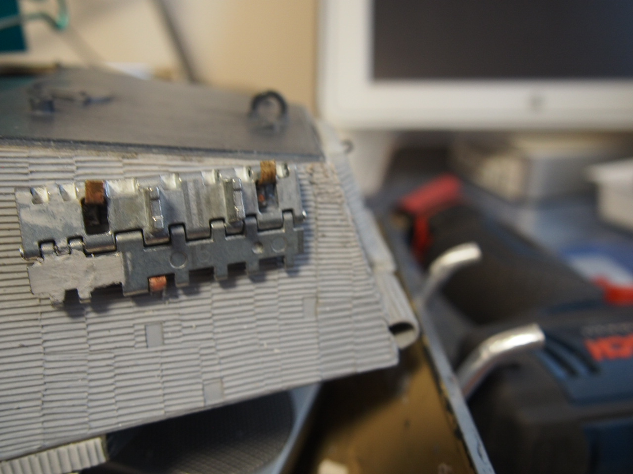

made up a test run
made up a test run
will the cutouts in the zimmermet line up
Glad i took a gamble and ordered the Trumpeter version instead of Tamiya as the Tamiya one only had the 4 slots cut in the zimmermet

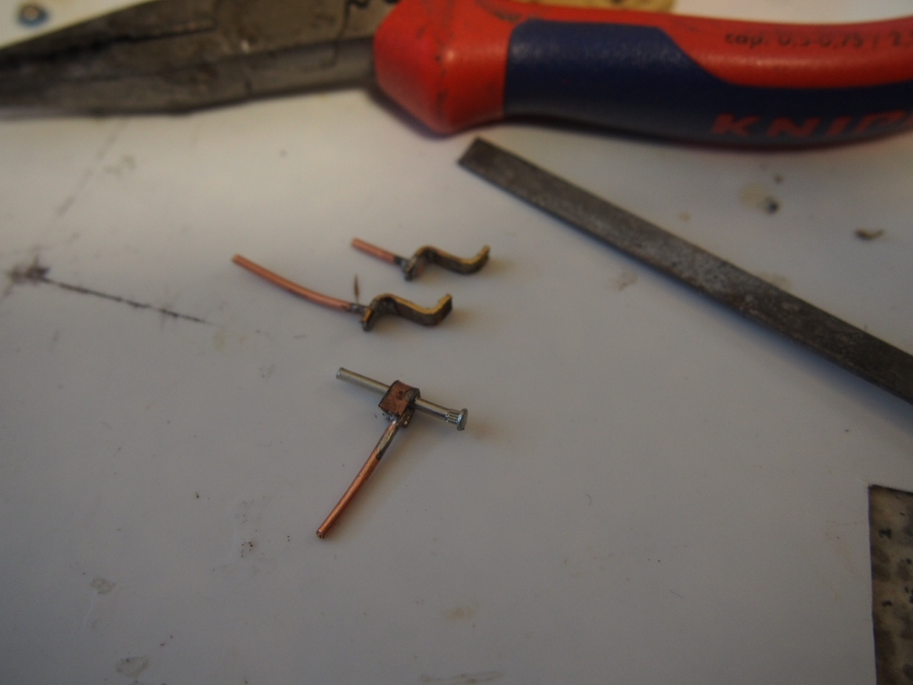

ronnie42
Posts: 834
Post by ronnie42 »

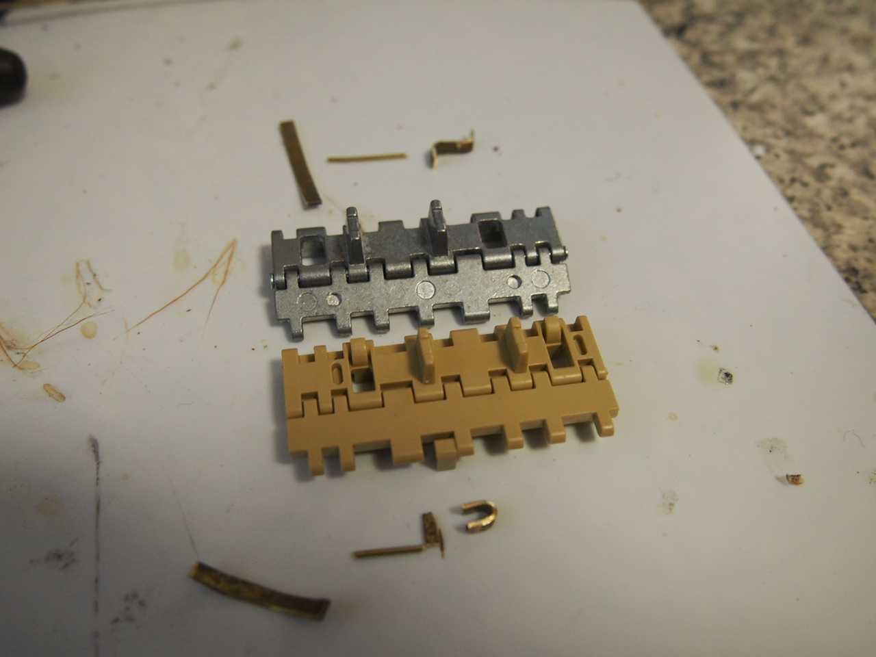

Used a Tamiya track pin as my metal tracks are only short 2 pin fixings.

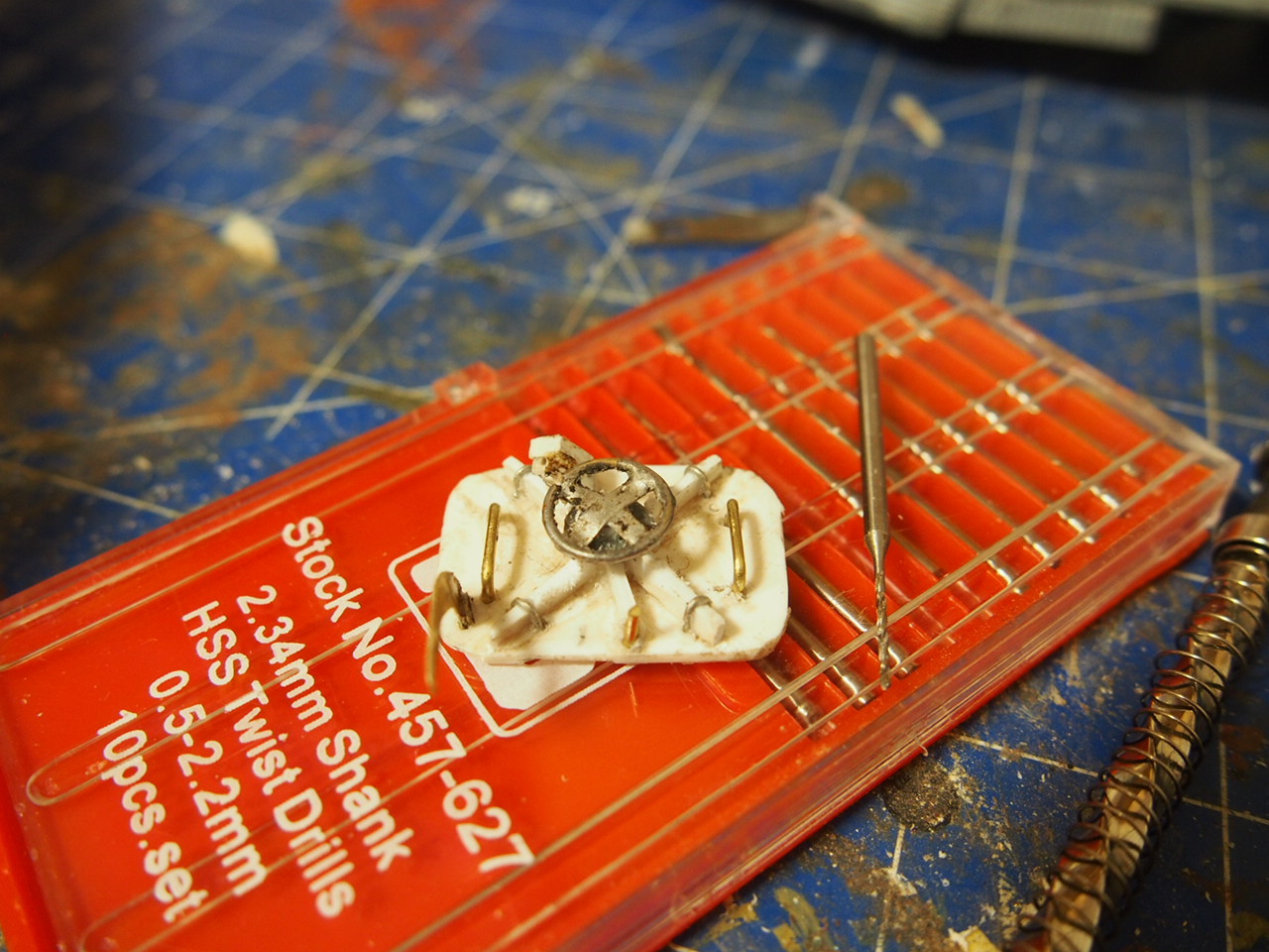

Just noticed a picture of a Kingtiger posted by Eastern Front , good view of track hangers and track pin . Done one , need some good drill bits now. Drill bit wants to clog up and jam , central section of track has no pin holes.
