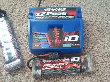

I spoke to my local hobby guys and we're going to attempt to adapt the Traxxas RC batteries to the tanks and scrap all together the hen long batteries they're going to take a look at them Friday and see what we can do and use my Traxxas charger it does all styles of batteries
I already have 3 of those chargers for the kids's / trucks they have they seem to be good quality and work well and they're fast they sense the type of battery and shut off.

Here's the charger heavy duty u.s. plugs good cabling on the batteries
- Traxxas IQ charger
- 13547.jpeg (35.23 KiB) Viewed 2894 times

No I agree those are the batteries we use in the RC trucks will be dropping down to the 7.2 slightly shorter battery after my measurements to fit into the tanks
Will definitely keep all of you posted after Friday and see where we end up could be a good idea for anyone else down the road thanks for all your help
