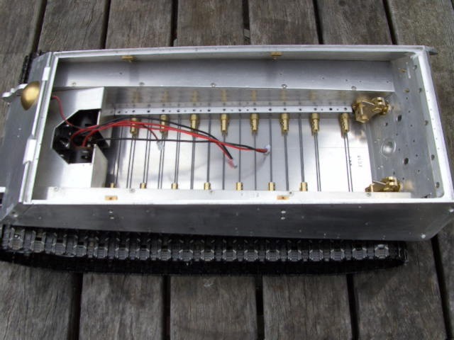

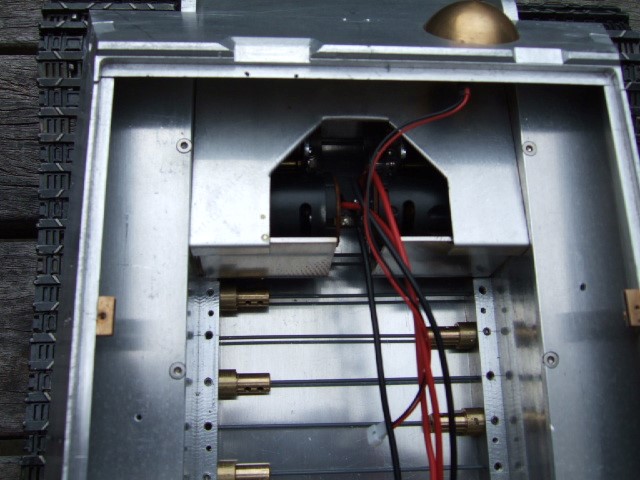

Gear box splash shield.
012 (Small).JPG (91.26 KiB) Viewed 3570 times

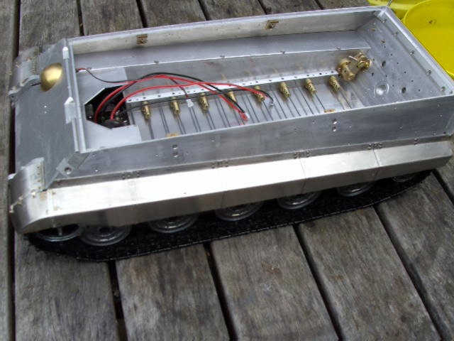

Hull view.
053 (Small).JPG (77.54 KiB) Viewed 3569 times

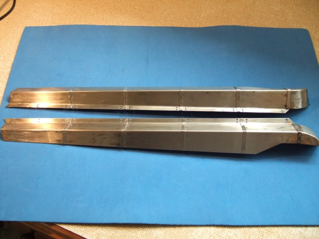

Post by walter »

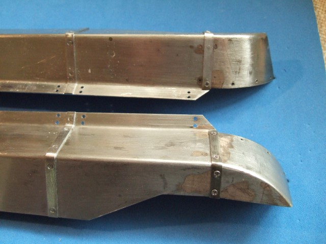

I bent the mud guards from one piece an d added strips to emulate guard sections.
131 (Small).JPG (75.9 KiB) Viewed 3569 times

Close up front. Curved front piece was made separately and soldered on. The guards are very strong that way.
130 (Small).JPG (72.06 KiB) Viewed 3567 times

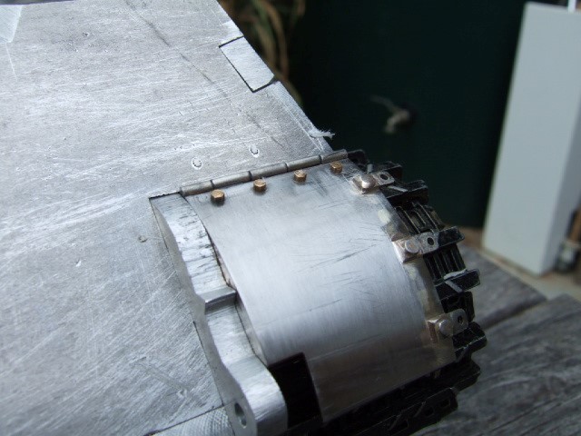

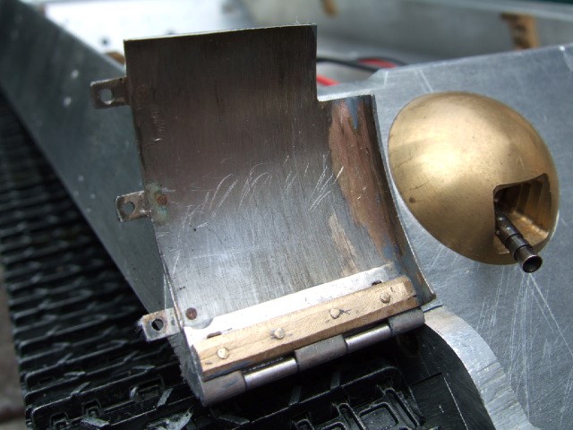

Post by walter »

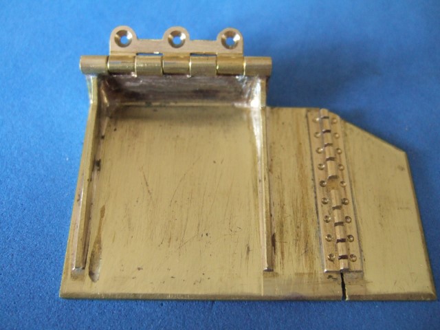

Movable front guard and MG dome.
028 (Small).JPG (91.53 KiB) Viewed 3566 times

Post by walter »
Fully assembled mud guards.
068 (Small).JPG (78.14 KiB) Viewed 3565 times

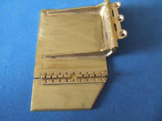

Rear movable mud guards.
014 (Small).JPG (70.62 KiB) Viewed 3563 times
