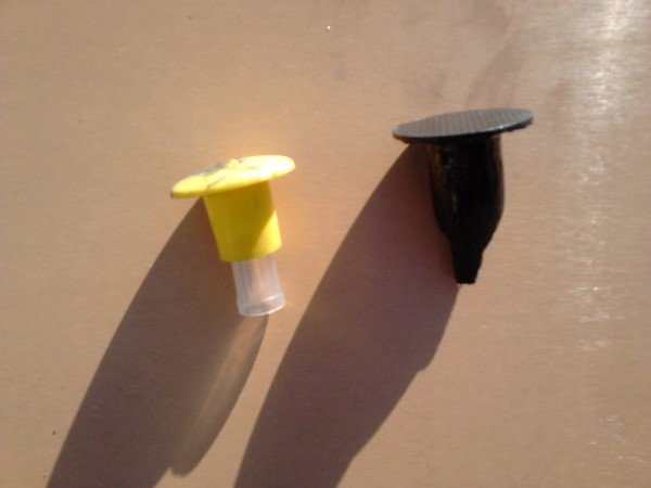

Using SP106 - CF with some colour, used some cf + kev. Wood/filler/spray plugs.FB molds

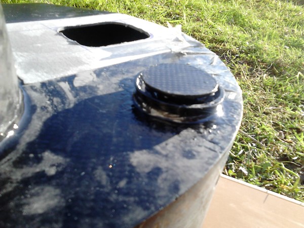

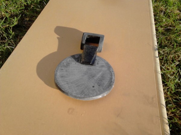

Built up back of covers and hinge . Placed on Turret, which had cellotape protecting surface, added CF+.re posistioned slightly, coz of bigger box.
Pulled plastic pattern from vent tube, added.
Layed up two layers of sock, for bearings.
Good job covered up with masking tape, grinder slipped twice so far! :/
Bearing holder.
Bearing holder.
^ Temp' fit.
^ Temp' fit.
Tube + pattern.
Tube + pattern.
Hinge + Cover.
Hinge + Cover.

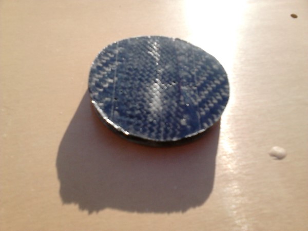

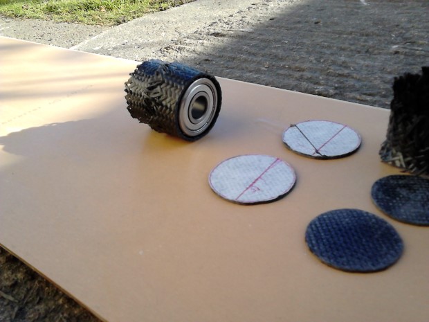

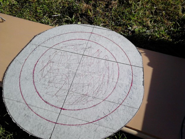

The bearing housings(Gun axle) still needs adding to inner, they hold bearing but its not complete. Cut some circles ready to add.

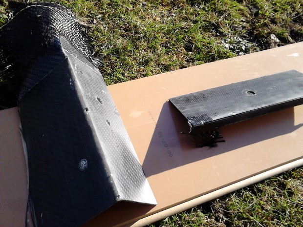

Thickened up gun mounting plate alittle, added edge, and need to cut some angle, to build on for pivots.
Turret lower plate, needs to be big enough to fix and add strengh to, but wanna keep things wide.

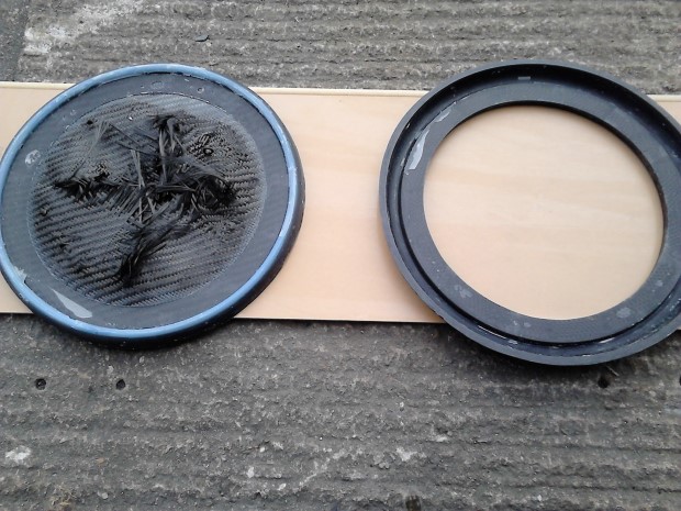

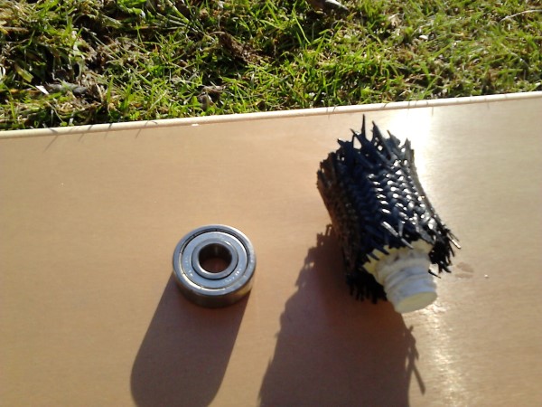

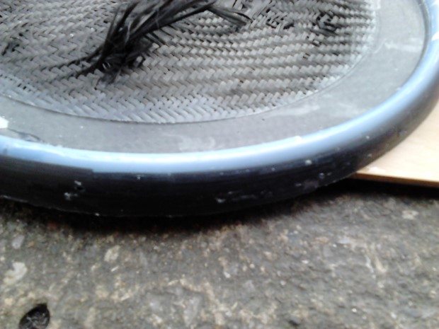

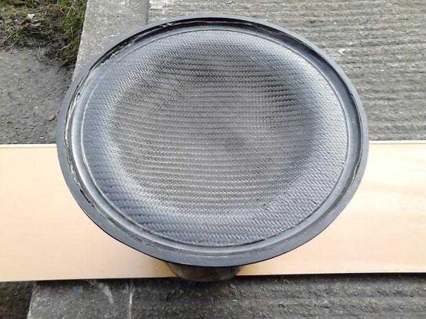

Polished turret main bearing, with four/five layers wax, added a tube (As pattern) buit up strands, layed up four layers, compressed alittle with new lid, which maybe wasnt such a good idea, may have promted some air, but gave me a line to work to.
Released bearing top half, which looks okay to continue with.
Pattern to be removed.
Released after lay up.
Upper bearing.
Upper bearing.

Bearing housings +.
Bearing housings +.
