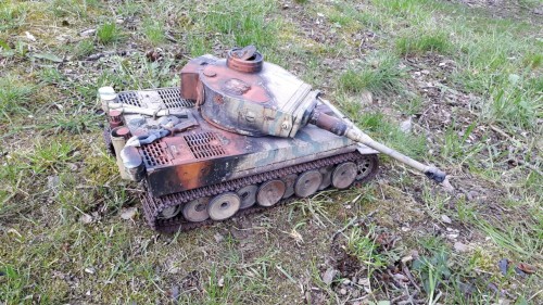

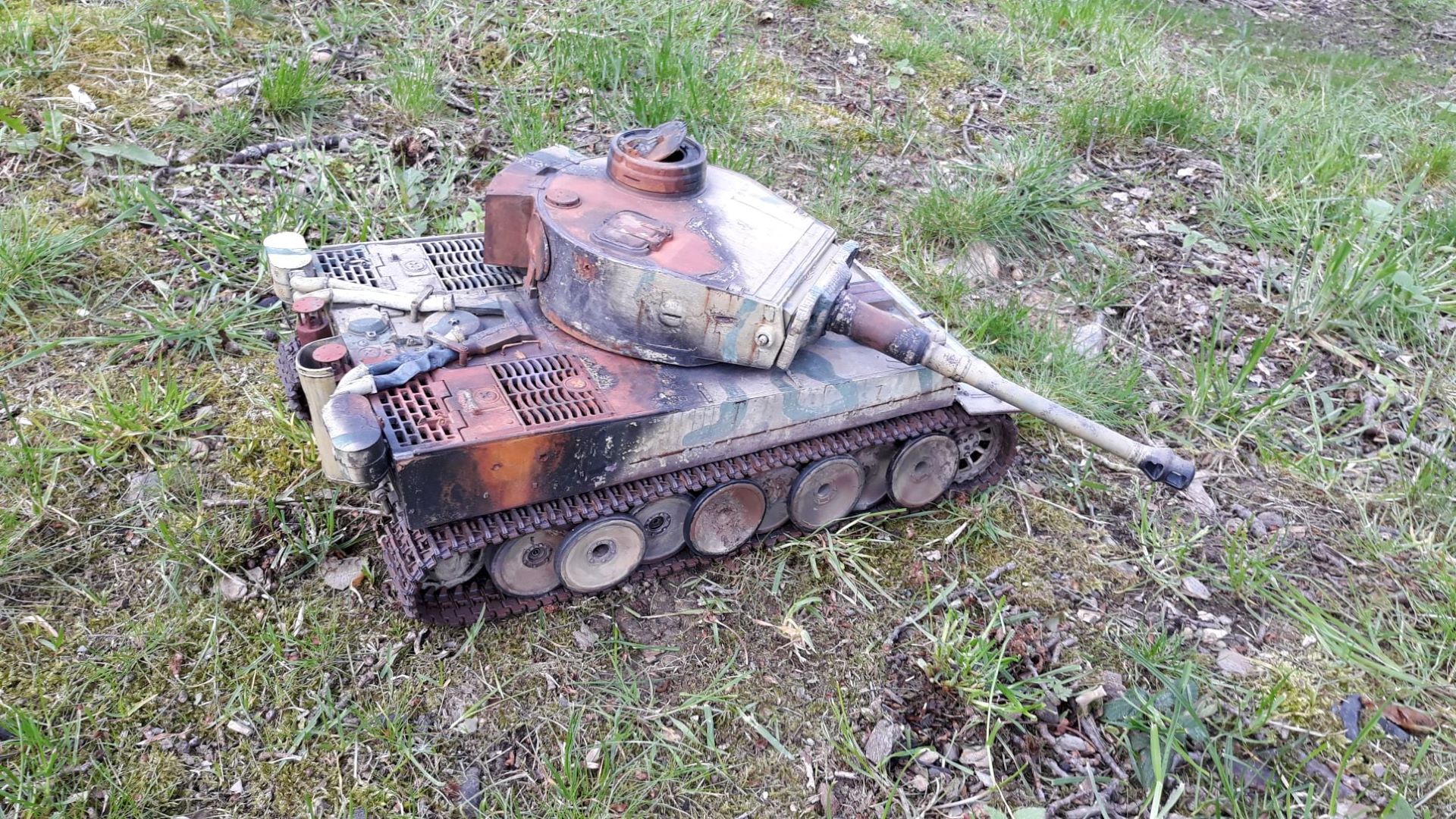

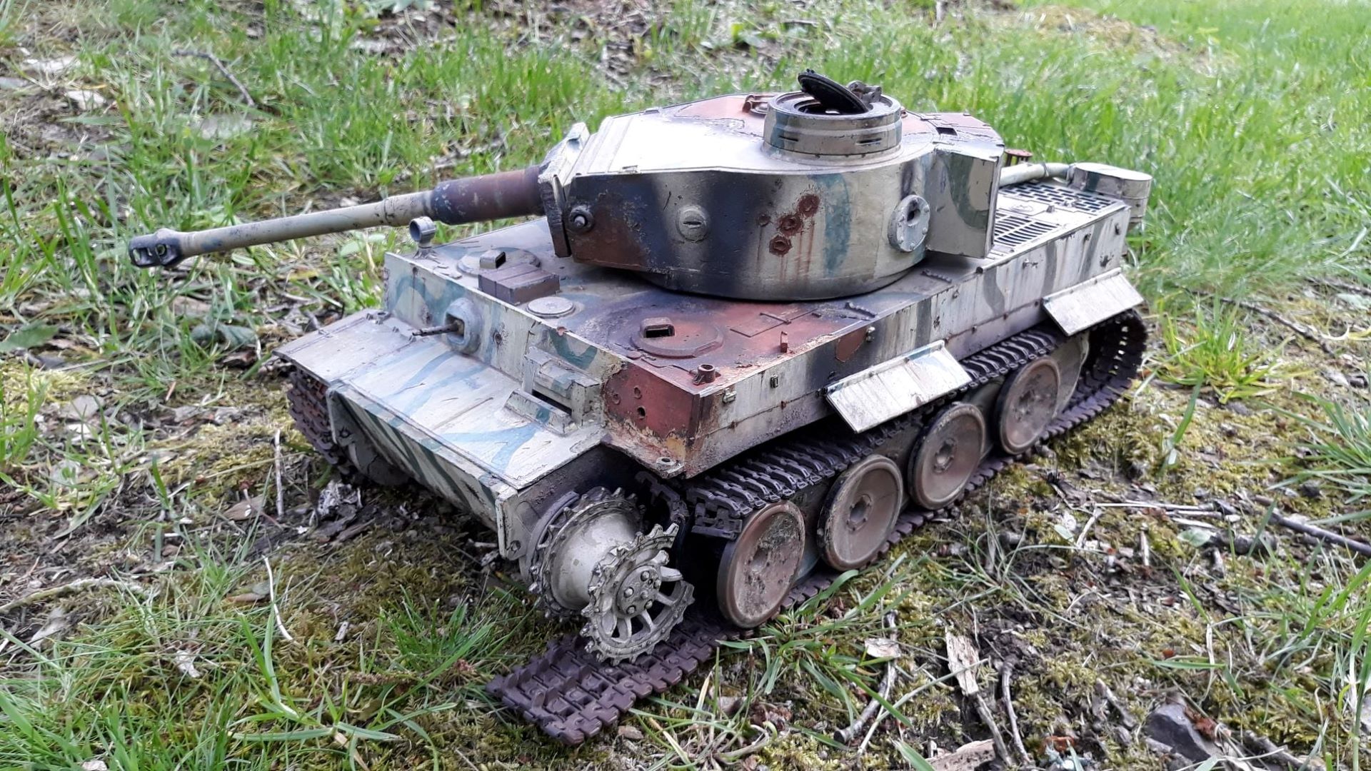

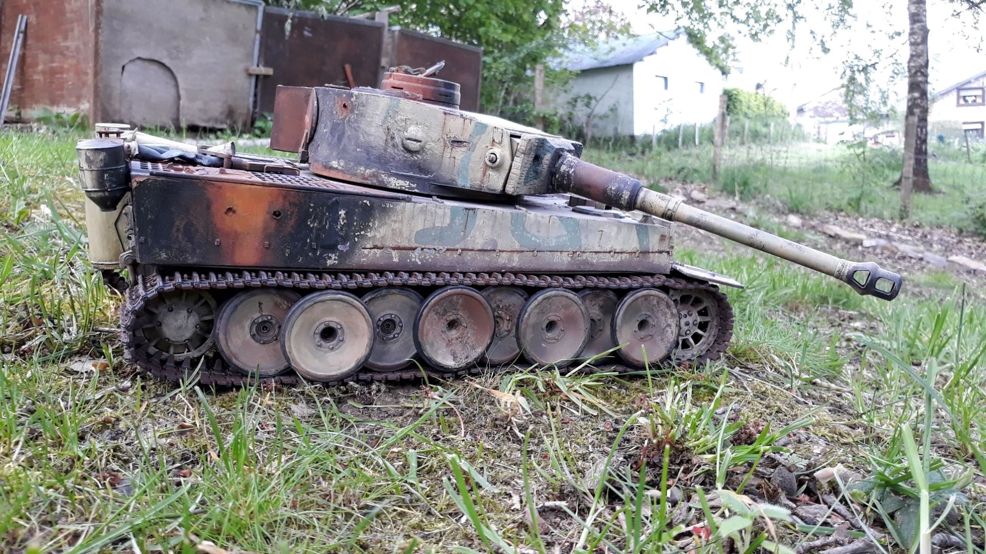

Right, sorry for the delay in posting more pictures but some health issues and busy work get me away from modeling for too long.
Here are pictures I took outside of the first Tiger, I let you judge the result on the outside natural light.

BarryC
Posts: 2492
Location: Savannah, GA. USA
Re: Burned out Tiger
Post by BarryC »
Bravo, looks fantastic! :clap: :clap: :clap: :clap: :thumbup: :thumbup:

Jimster
Posts: 3439
Location: Illinois
Post by Jimster »
Astoundingly realistic! I will steal some of your techniques for my future ghost Tiger project. Especially the burnt paint effects. Of course my projects move at the pace of glacier melting.
