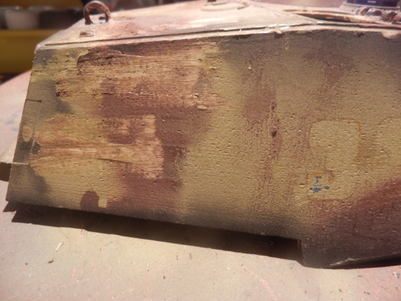

Oh I know I will get it in the end, its just a bit daunting not having basic experience with the Tamiya platform plus having to undo existing problems in order to get a start point.
I found the track tensioner system buggered as well.
The 4th picture of a model is actually the interpretation of this real machine before it was captured & remarked.
If I choose this version, at least I can hide much of the hull damage with Zimmerit!

A renovators dream !
Off with the fake mounting points for the spare track links. I have a top quality set from H/L to fit so it at least looks right !
I will hit the entire structure with the sanding tool tomorrow during the day.
Depending on the paint & excess glue & debris removal, this King Cat may get the melt-application of zimmerit.

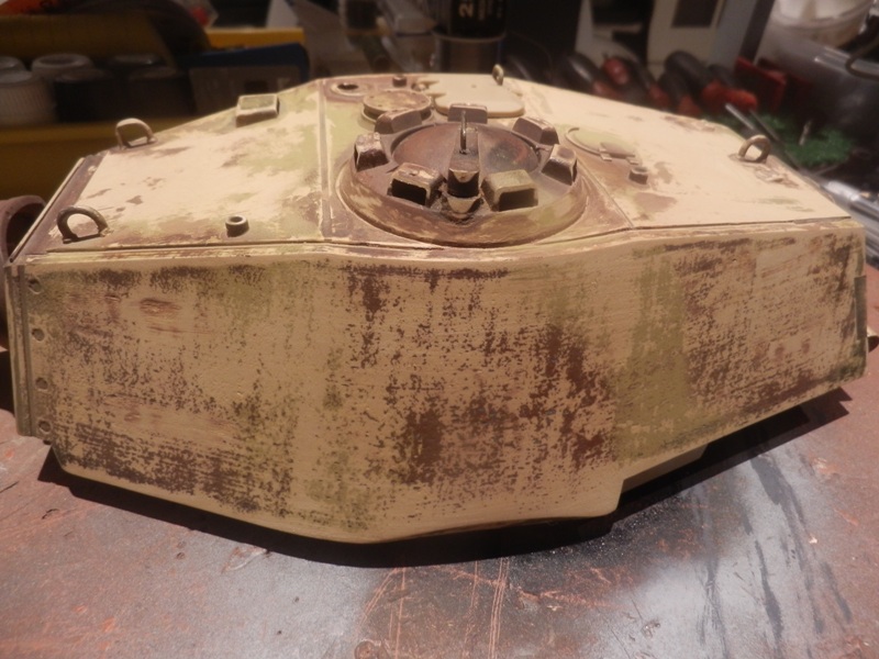

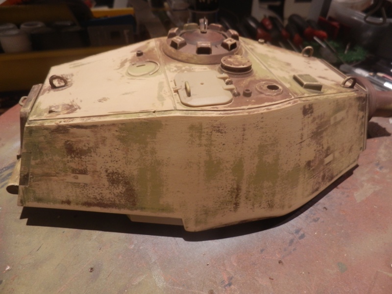

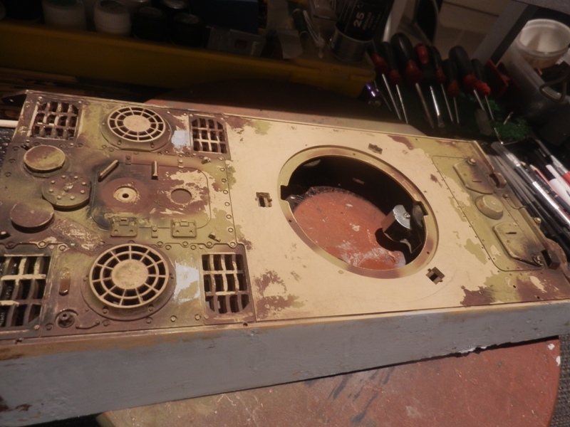

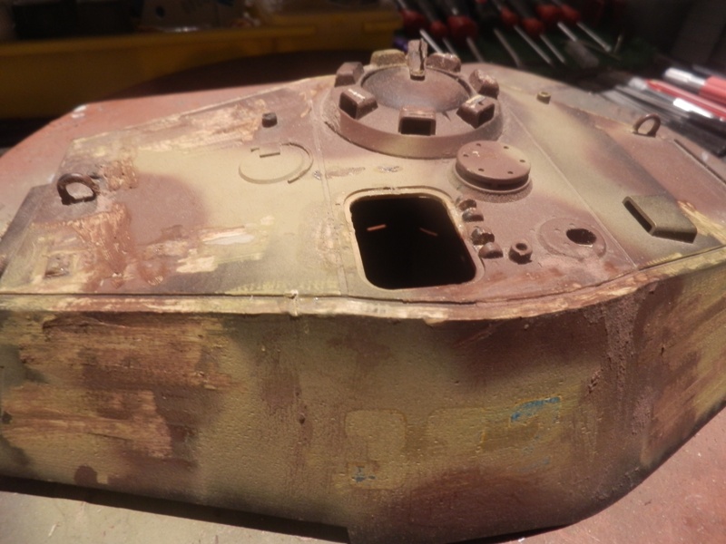

This sure is a restoration project. The old paint is enamel, & melts under the sanding tool !!
Got the turret clean and ready to place the spare track hangers. Loaders hatch replaced and hinged.

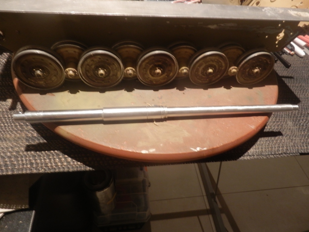

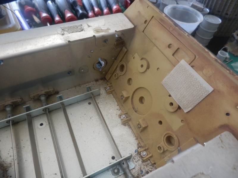

All the internals have been removed to allow tightening up of all relevant system components, and the barrel needed to be run across an industrial wire buffer to remove the paint !

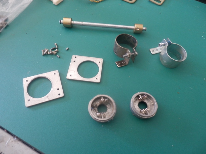

I've removed the failed track tensioner,busted almost all the puny philips head screws that retain it, and for the life of me cannot see how its supposed to work. Springs & key-hole idler arms
I am contemplating a better engineered solution from Taigen to get the idlers to adjust.

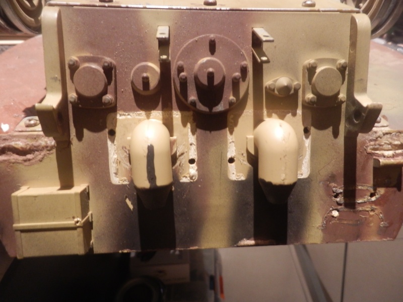

Removed the broken exhausts and will fit metal Taigen versions. Rear plate is partially cleaned, and the Taigen bits placed unsecured.

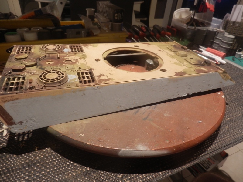

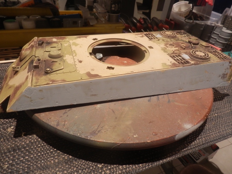

Hull is sanded, filled, and sanded again, still a bit to do on it, but its not far away.
Going to replace the lifting handles on the front hatches, and do all the required welds on all joints.
There is a lot more to this one than I figured, but all the basics are there.
Still got to get the roadwheels out of the suspension arms, but axle shafts are lavishly coated in Tamiya loctite.
Ahead is the zimmerit coating, handy to cover the mass of blemishes from old works.
Got a bit on
Got a bit on

Nice work Herman!
I can vouch for the Schumo king tiger idler adjust.
Not cheap but works well.
Henntec do one for Tamiya KT as well.

Hi Herman, great job there.
Im using a henntek track tensioner. Works good too, so you have more options.
In the king tiger I found a gearbox brace helps, and also the elevatior arm worths to replace it with metal.

Cheers Mr Rad, it does appear that a henntec adjuster is the best way to go.Rad_Schuhart wrote:Hi Herman, great job there.
