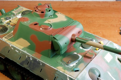

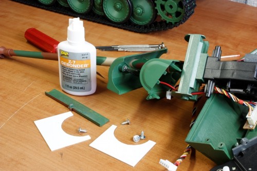

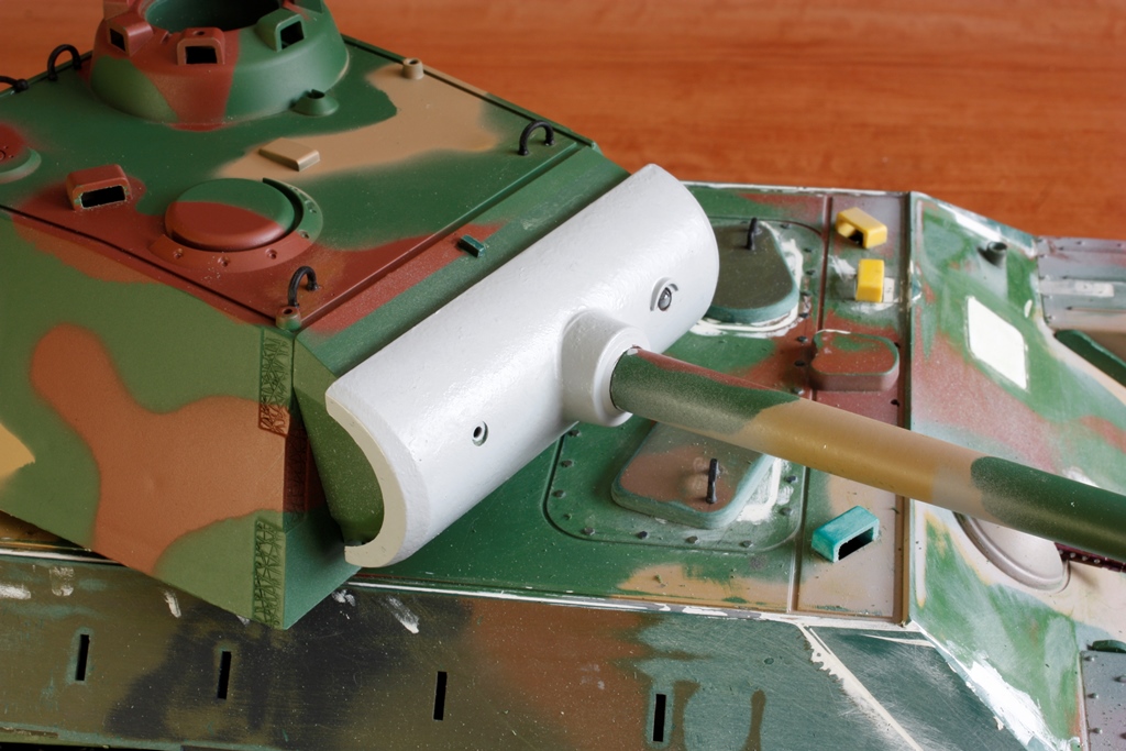

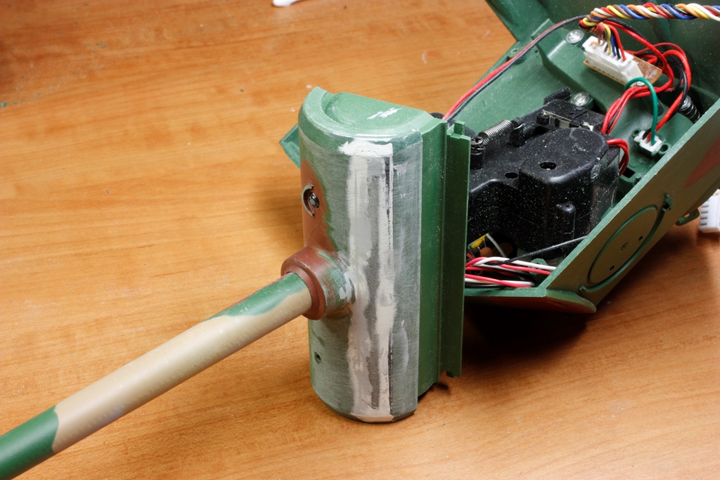

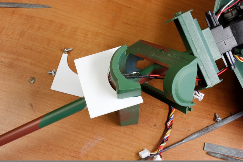

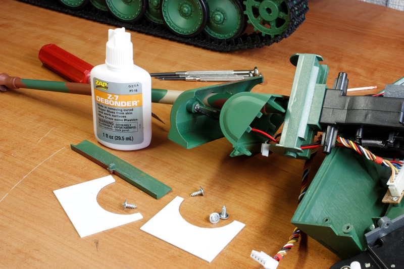

Moving on to the turret now. It’s the bit I thought might be hard work.
The chin mantlet is the feature that tells you it is an Ausf G. I could have bought a resin replacement mantlet outer from one of the German modelbaus, but by modifying the existing one I know it will all work with the existing barrel and mantlet inners.
The Ausf A didn’t come with the debris shield from the factory, so it had to go. I dismantled the mantlet into its parts and applied some super glue debonder to remove the shield. I was aiming to delete the chin without removing too much material, so I wanted to accurately profile the existing plastic. I made some profiles from plasticard in a circular shape.
Using the profile cards I made a series of cuts along the chin and then joined them up.
That left me a rectangular hole where the chin was. I had several attempts at bending a piece of plasticard to the correct curve but they never worked. Eventually I found a piece of cheap plastic vacuum cleaner tube that was the correct radius and glued it in, using the profile cards again to line it up.
There was still some filling of the joins, and then I stippled some Tamiya primer with a brush to give it the correct cast finish. It was the first time I’d used that technique and now I realise I should also do the cupola and MG Kugelblende.
