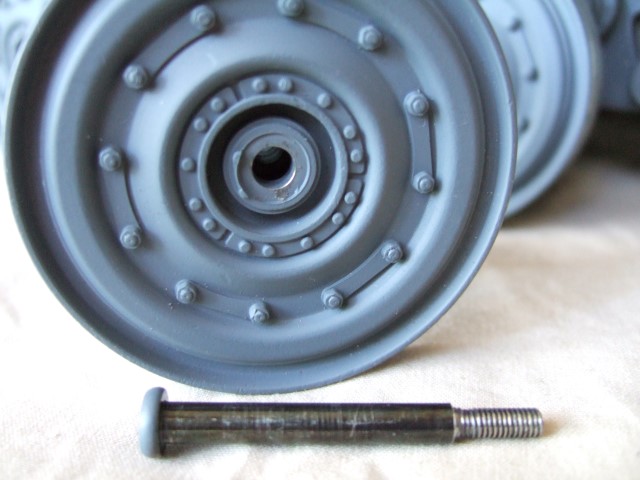

I drilled 4mm hole right through the road wheel and slightly countersunk it to accommodate the bolt head.
DSCF1330 (2) (Small).jpg (73.14 KiB) Viewed 4721 times

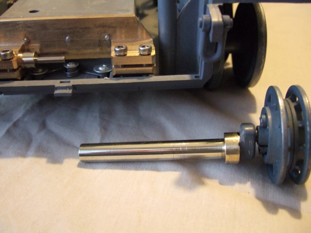

The main axle has a 5 mm offset arm with a 5 mm socked head bolt with a M 4 mm threaded end that screws into the offset arm. The idler wheel needs to have a 5 mm hole drilled through its back part.
DSCF1334 (2) (Small).jpg (69.92 KiB) Viewed 4717 times

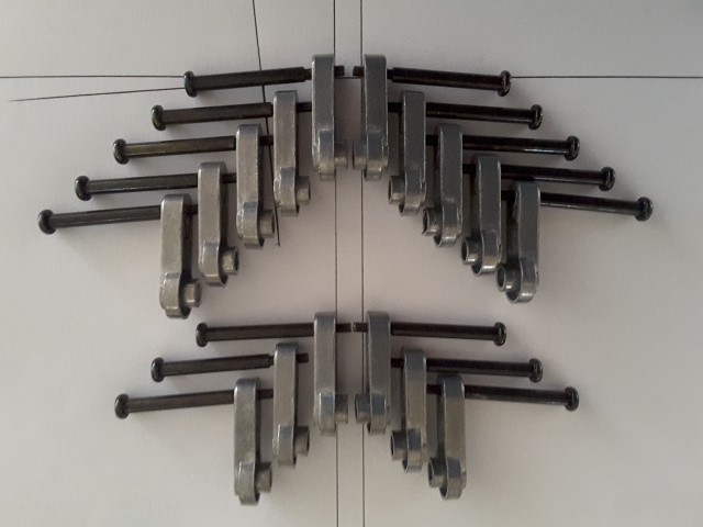

Here is a photo of the metal suspension arms that clearly shows they screw not in at right angle. They all needed to be re worked.
IMG_20170508_115905 (2) (Small).jpg (83.73 KiB) Viewed 4710 times

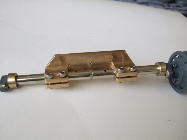

Complete view of the track tensioner. To do this tensioner you need to have access to a lathe,milling machine and drilling machine.
DSCF1355 (Small).JPG (40.39 KiB) Viewed 4588 times
