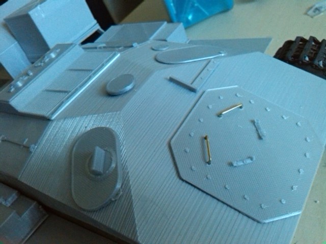

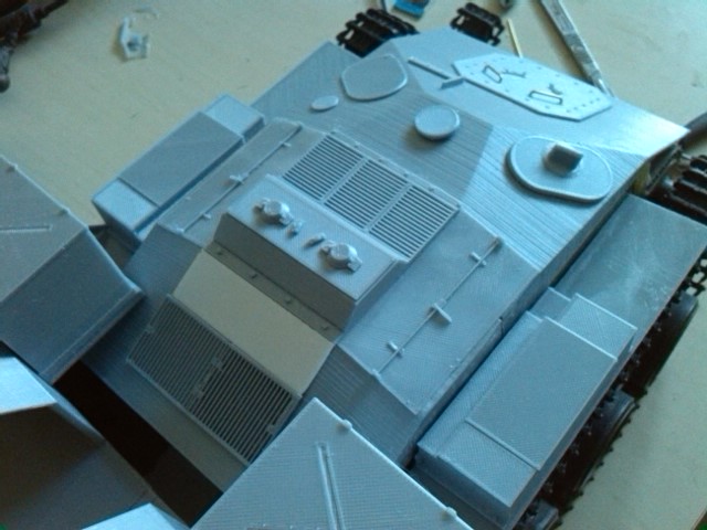

More detail parts going on each day. They take longer to design than print, and there are a lot of them...at least I can watch things on the internet while I am playing about.
- IMG_20170525_175933.jpg (91.61 KiB) Viewed 4010 times
- IMG_20170525_180006.jpg (85.46 KiB) Viewed 4010 times

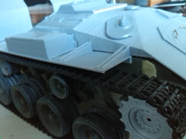

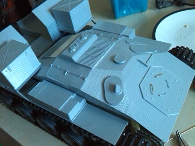

A few more parts done. Got waylaid shopping and dismantling a squeaky patio door handle. lol. It's also bl**dy hot out there. No cloud at all for 2-3 days which is 'very' unusual. I've done some handles for the side boxes but haven't stuck them on yet.
- IMG_20170526_195146.jpg (72.56 KiB) Viewed 3970 times
- IMG_20170526_195157.jpg (71.21 KiB) Viewed 3970 times

Looking at the last shot, will you need to sand the hull or will the paint cover the banding?
- wibblywobbly
- Posts: 6396
Re: M41 Gorilla
It's the shiny pla, and the way the light always catches it in digital pics. it's only fingerprint deep in reality. The lines you see are each horizontal layer which has been printed, they are slightly different shades so they all show up separately. Normal auto primer usually smooths it, and if it doesn't then a quick blast with high build primer will do it.
There are several methods of smoothing pla and abs. One is an acetone vapour treatment, another is a particular transparent resin that is brushed on. I guess I am fortunate as my printers are set up quite well, but I do wonder why so many people on the web are content to print heavily ridged items, and then spend a fortune on things to make them smooth??
