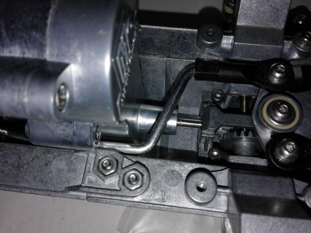

The one at right angles is the connection to the servo. I need to try it out. There are so many linkages. As I have no idea what I need to do, I am hoping for assistance at the BAD meeting on Sunday.

A couple of modification this morning. It was very noticeable yesterday that the power of the servo was moving itelf and the mounting brackets around, o that now has the addition of a piece of 3M double sided tape hoding it in place. It was also apparent that there was not a great throw on the arm linking the servo to the steering mechanism. The vehicle will not have a good turning circle at the best of times but this would have been appalling. I removed the linkage and adjusted it by screwing the steering linkage ball end up as far as it would go and slackening off the end closet to the servo. This had the effect of moving the angle away from the gearbox. Hopefully it is apparent in this photo.
