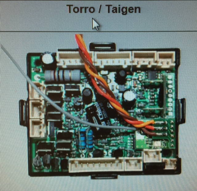

c.rainford73 wrote:Jussek I have a questionJussek wrote:Hi Carl, you are right, i'm using the old USM-HL, and yes, just took a look on the Beier website and this model is no longer referenced there. I didn't knew this.c.rainford73 wrote: Hi Jussek I'm assuming the sound card you are using is the usm-hl and the one that Tigrr is now using is the new version? The model you have is very nice but no longer available?
I am very impressed with the Beier sounds and am strongly considering one
Carl

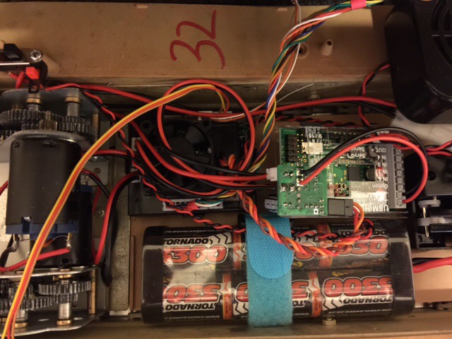

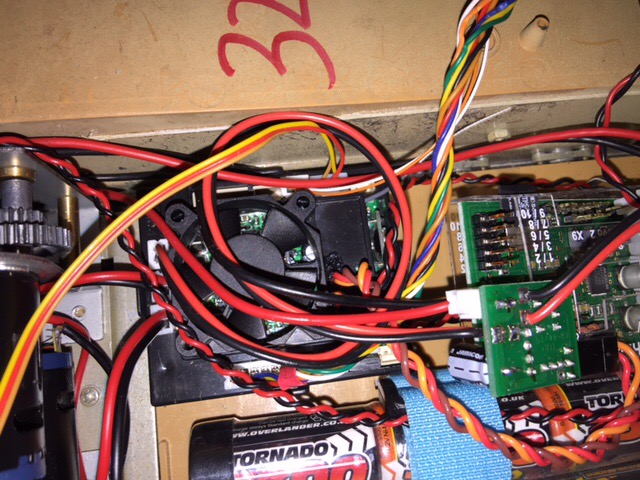

I am rebuilding a Taigen Tiger I. It currently is running an rx18 with rc5hl from Rc tanks Australia with a 6 channel transmitter. Can I add the Beier sound card to my rx18 and control it with the rc5hl?
I was thinking of doing something different with this tanks electronics.
Thanks in advance
Carl
