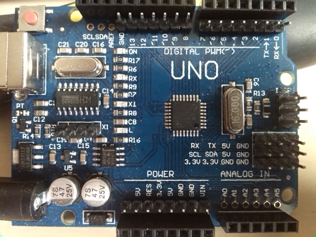

My tank build project is coming to a close so I picked up the Arduino Uno that I bought as a project to create an IR system. I looked at the GIThub and found that you guys have kindly done all of the hard work. Many thanks for that.
The schematic provided details the circuit for connecting seperate components, however I purchased separate boards for the IR led and sensor, as these theoretically have the transistors and resistors that will protect the main board. I may need to change the emitter, but that is an easy task. I have added additional pins strips to the board.
Could I ask you a small favour?
The boards have pinouts labelled GND, VCC and SIG. Could you clarify where these should be connected on the Uno? I would rather ask than create magic smoke.
One small detail, I tried using the provided Sketch using 1.8, but as I have found with the Arduino's that I use on my 3D printers, the code that 1.8 will recognise is different to 1.6, hence any attempt to upload the Sketch using 1.8 produces numerous errors.
Using 1.6 removes the errors, with the exception of the servo recoil code, it still rejects the code.
- IMG_20170324_090958.jpg (55.58 KiB) Viewed 7217 times
- IMG_20170324_091024.jpg (62.24 KiB) Viewed 7217 times
