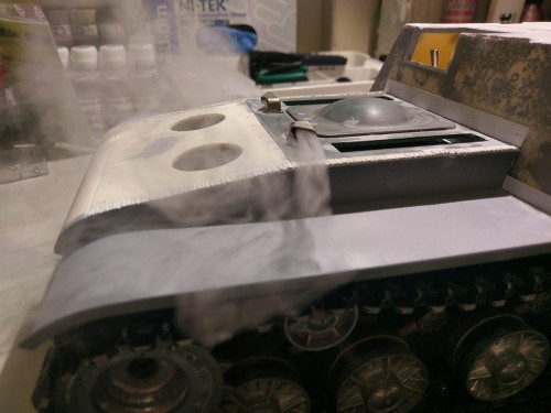

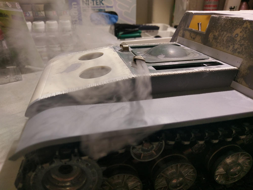

Been awhile since I've made any progress, too many days over 40° (up to 44° twice!) and our apartment isn't air conditioned. My workbench catches full afternoon/evening sun, too.
The weather's been a lot more favourable this weekend, so I broke out the soldering iron to get the Tarr working. What I expected to be a 30-minute job ended up taking over four hours. To cut a long story short, the voltage step-up was causing the heater element to get so hot it re-melted the solder joints! I ended up running the heater element directly off the battery instead, and it works fine.
So for some reason my 12 V Tarr wants to run on 7.4 V, and my 7.4 V Tarr wants to run on 12 V. Well whatever, they both work now I guess. :-<

Raminator wrote:Been awhile since I've made any progress, too many days over 40° (up to 44° twice!) and our apartment isn't air conditioned. My workbench catches full afternoon/evening sun, too.
Looking good! Where did you source those lovely exhaust for your Build? I could use a set for my kv-2. Smoking looks excellent

Damn you get a lot of smoke coming out of those exhaust's Ram. Did you change any of the settings on the SD card for the smoker? I can barely see the smoke coming out of my Kv.
