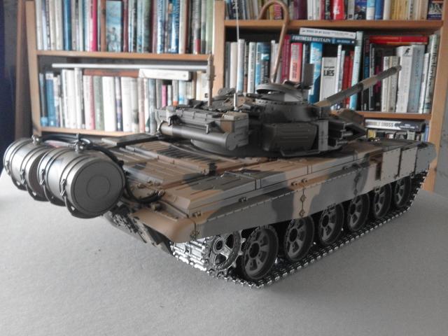

All the bits and pieces fitted, with the exception of the machine gun assembly, tow cables and the unditching log, the last because I have no suitable size dowel. I have a few pieces left over - 3 sections of what I assume to be turret armour and two tow hooks. The armour is because there are two sprues, but the tow hooks are different. They are part no G1, and I can see no reference to them in the instructions. If I have missed it or anyone has found where they belong I shall appreciate the information.
The only thing lacking is a tank commander. Again if anyone can recommend a sutable figure that doesn't cost an arm and a leg, I would love to know.
Richard

Take a look on page 21 and they go outside of the spare track on the rear panel

condorman994 wrote:Take a look on page 21 and they go outside of the spare track on the rear panel
Thanks - in fact I have just worked it out wen I tried to attach the tow ropes. Would have helped if they had identified it in the main instructions. Still - all done now.
Richard

This is my first experience of a Heng Long tank so I can't compare it with anything else they have made.. I have to say, I am quite impressed in the way in which it went together. My only complaint would be that the parts are attached to the sprues with quite thick joints, so no matter how carefully you cut them, you are left with little bright green patches. If the bits had actually been moulded in the same colour as the green of the tank, it would not have been an issue. Pretty much everything is push fit. It will be interesting to see what falls off when it starts trundling round the battlefield.
